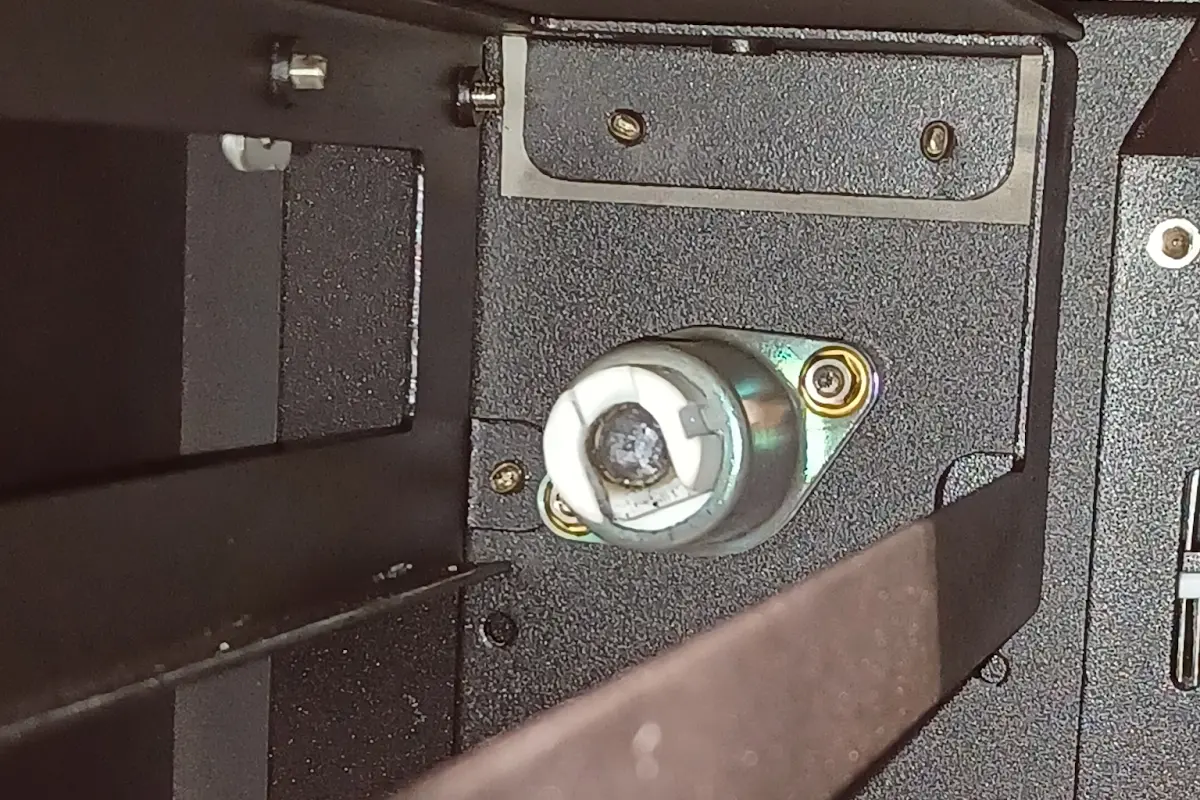

Inspect the quartz tube frame sockets where the quartz tube inserts into the printer. If the socket is damaged, the quartz tube frame may need to be replaced. Contact Formlabs Support or your certified service provider. Include your printer’s diagnostic logs with a photo of the damaged quartz tube frame socket to speed up resolution.
A damaged quartz tube frame socket
