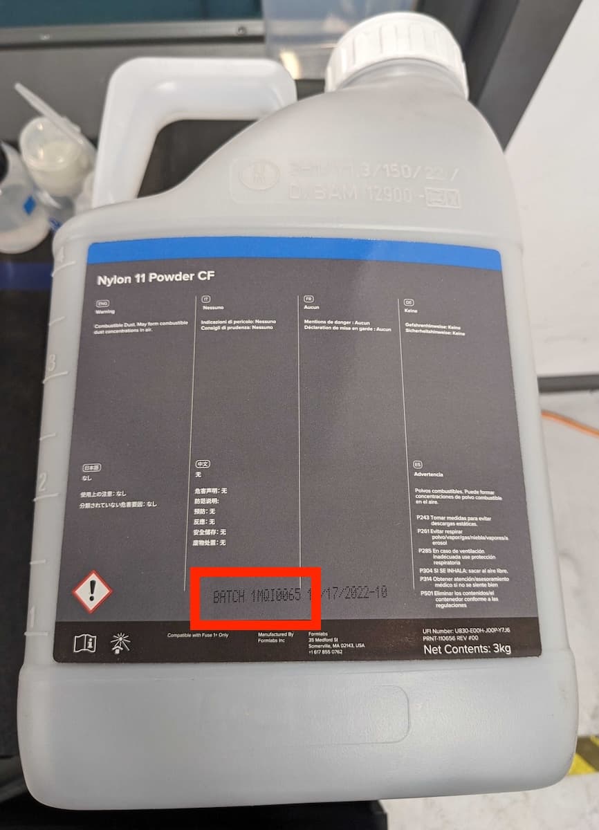

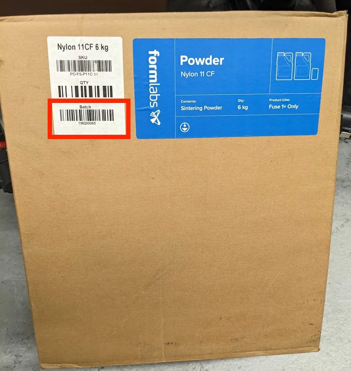

Lot number
Powder production batches can be identified by their lot number. Formlabs may ask you for the lot number when helping you troubleshoot an issue. The lot number can be found on the outer box or the powder jug (for materials packaged in jugs). The lot number format depends on the material; some examples are given below:
  • Nylon 11 Powder: 06KF933458
  • Nylon 11 CF Powder: 1MQI0065
  • Nylon 12 Powder: 952631
Example of a powder lot number on a powder jug
Example of a powder lot number on a powder box
Powder disposal
