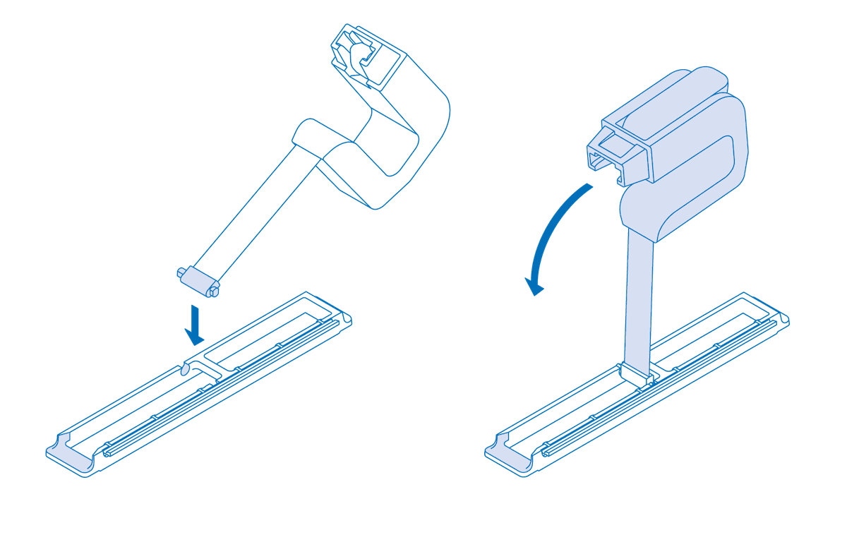

The Form 4 generation mixer is made of two parts: the mixer body (1), which sits in the resin tank, and the mixer arm (2), which connects the mixer body to the printer.
The Form 4 mixer
If the two parts of the mixer become separated, follow these steps to reassemble it:
  1. Place the mixer body on a flat surface with the two round notches facing up.
  2. Insert the posts at the end of the mixer arm into the notches in the top of the mixer body. The posts only fit into the notches in the correct orientation.
Reassembling the Form 4 mixer
  1. Rotate the mixer arm upright to secure it.
