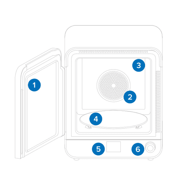

Form Cure components
  1. Door: Double walled chamber door insulates the chamber and allows it to heat quickly. Orange window treatment blocks curing light.
  2. Heaters: Two 450 W heaters can heat the chamber up to 100 °C / 212 °F.
  3. LEDs: Three arrays with a total of 48 405 nm LEDs help to post-cure parts. Secondary lights illuminate the turntable when the door is open and during heating.
  4. Turntable: Rotating glass plate ensures balanced post-curing across all exposed surfaces.
  1. Display: Shows status, time, temperature, and options for configuring the Form Cure, including pre-programming post-curing profiles with recommended settings for each Formlabs material.
  2. Knob: Turn or press to adjust time and temperature settings and to start, pause, or stop post-curing.
  3. Power cable (not pictured): Provides power to the Form Cure.

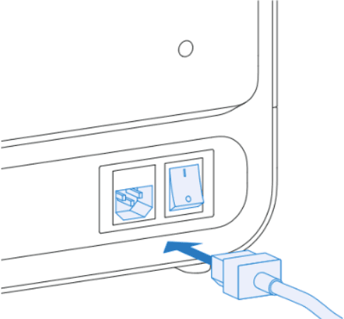

The Form Cure is ready to use once the turntable is installed and the power is connected. Each cycle requires time to preheat before the 405 nm lights begin post-curing. The preheating time depends on the current temperature and the target post-cure temperature.
  1. Find a clean, level surface with a nearby power source.
  2. Remove the thin plastic wrapper from the Form Cure exterior.
  3. Open the door.
  4. Insert the turntable on the circular wheel mount at the base of the cure chamber.
  5. Connect the power cable to the Form Cure and a power source. Power on the machine using the switch on the back of the unit. The Form Cure includes a USB port to facilitate firmware updates.
Connect the power cable.
Insert the turntable.
