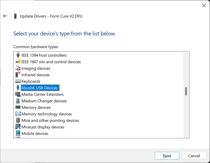

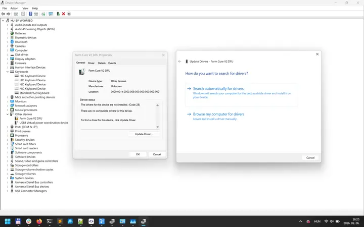

  1. Open Windows Device Manager.
  2. Expand Other Devices and double-click your Formlabs device. For example, Form Cure V2 DFU is shown here.
  3. Click Update Driver…. The Update Drivers window appears for the device.
  4. Click Browse my computer for drivers.

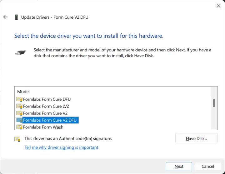

  5. Click Let me pick from a list of available drivers on my computer.
  6. Select libusbK, then click Next.
  7. Select your device. Again, the example shown here is Cure V2 DFU. Click Next and complete the installation process.
