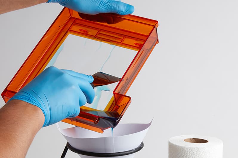

Left: Filtering resin from a standard resin tank with a 190 micron mesh filter into a storage container.

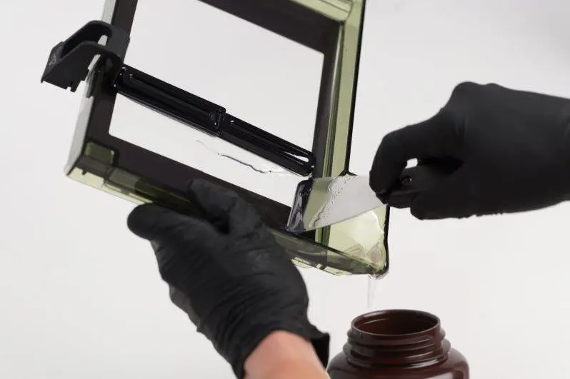

Right: Transfering resin from a Resin Tank LT into a storage container.
Pouring resin back into the original cartridge may contaminate it with cured resin pieces or debris, which can cause print failures. If there is debris in the tank, filter the resin before transferring it to a new tank or a storage container.
