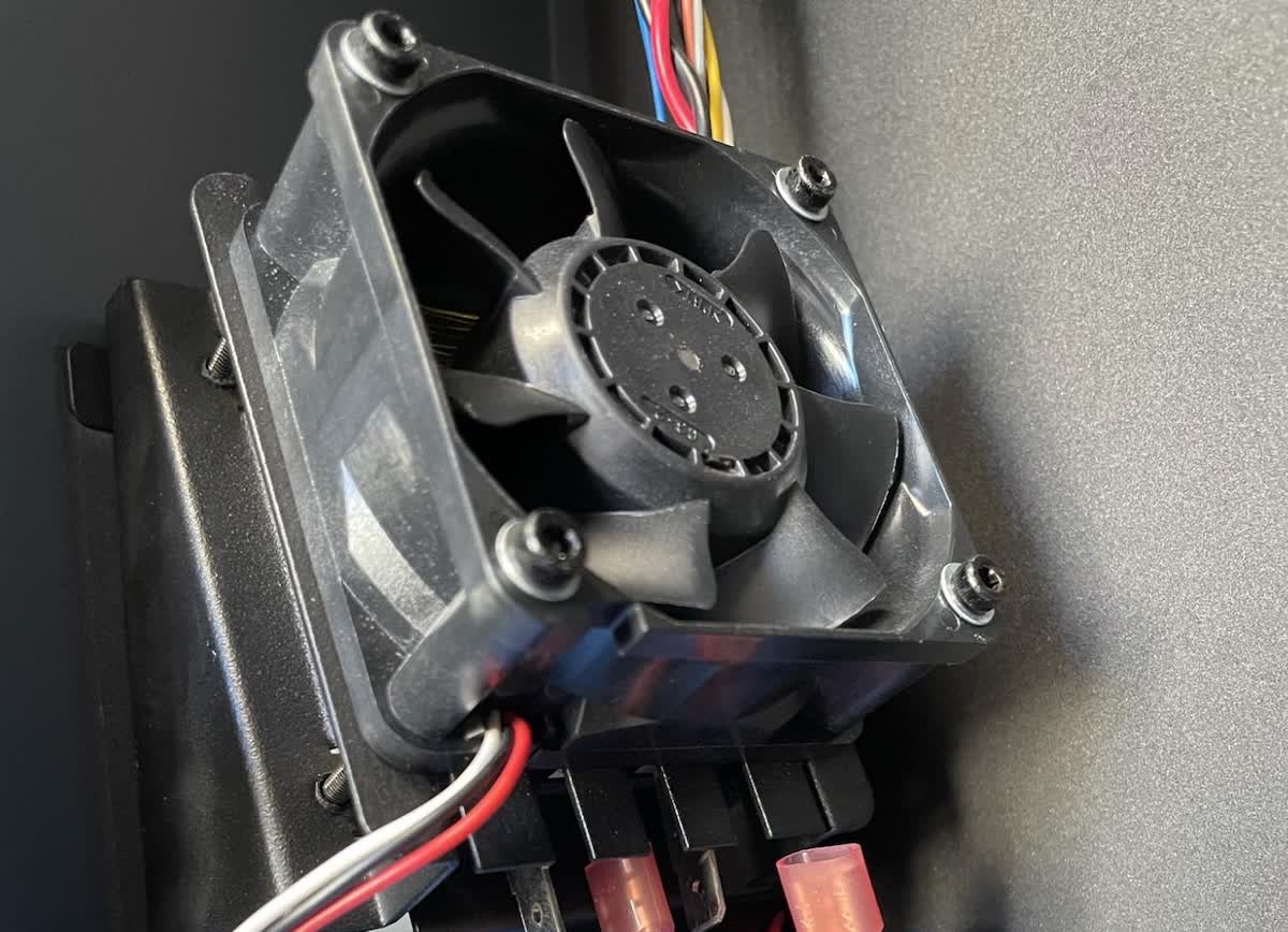

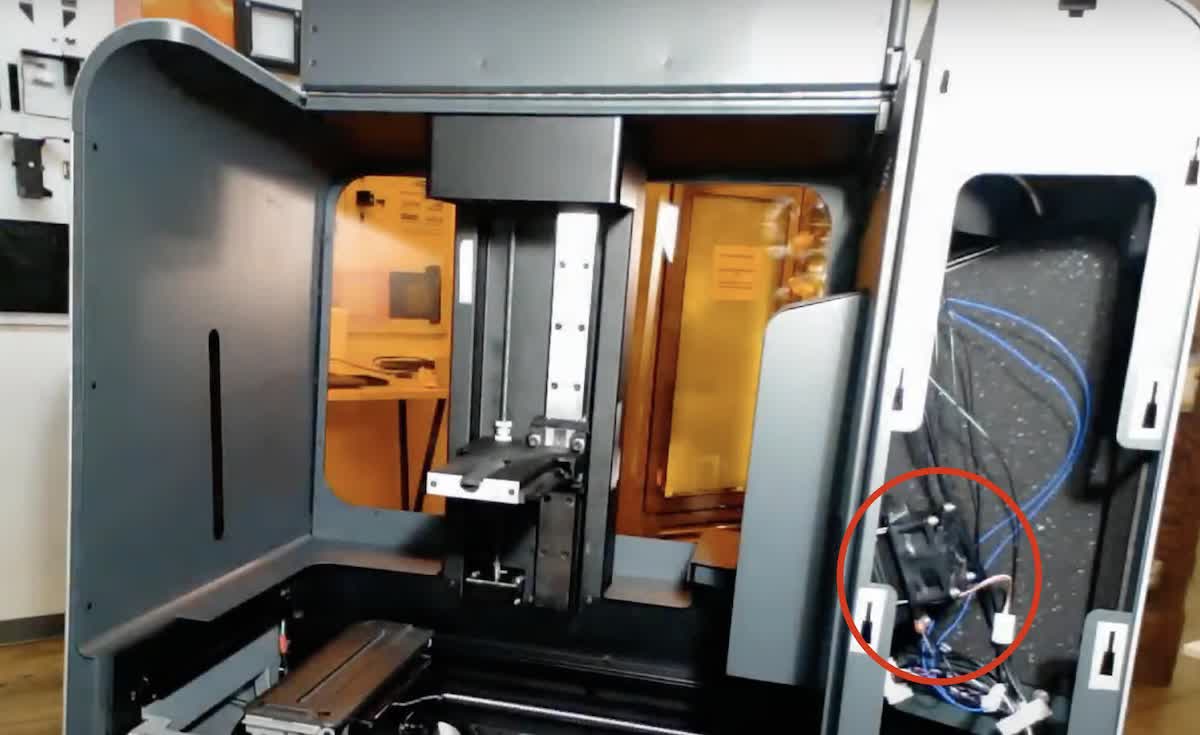

Step 1: Locate the front heater assembly
Locate the front heater assembly, positioned on the right side of the printer behind the display assembly. The heater can be identified by its fan and shroud.

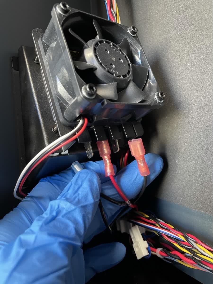

Step 2: Disconnect the fan cable
Unplug the 3-pin cable for the rear heater assembly fan (red, white, and black). When disconnecting the cable, grip the connectors and separate them from one another. Do not pull on the wires themselves.

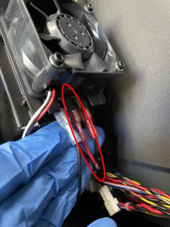

Step 3: Disconnect the front heater assembly wires
Disconnect the three crimped connectors from the front heater assembly. Grip the connectors themselves when disconnecting them from the heater assembly. Use a pair of needle nose pliers if necessary. Do not pull on the wires themselves. Note the order of the wires, particularly that the red wire is connected to the middle post.

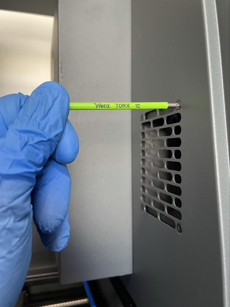

Step 4: Unscrew the front heater assembly
Using the T10 Torx driver, loosen and remove the four screws holding the front heater assembly to the printer frame. While loosening the screws, support the front heater assembly to prevent it from falling. Do not remove any gasket material from the frame of the machine.
