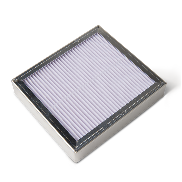

The Light Processing Unit (LPU) fan filter prevents dust and debris from contaminating the Form 4 optical system. A dirty filter can cause issues with print quality; replace it to keep printing and to prevent damage to your printer.

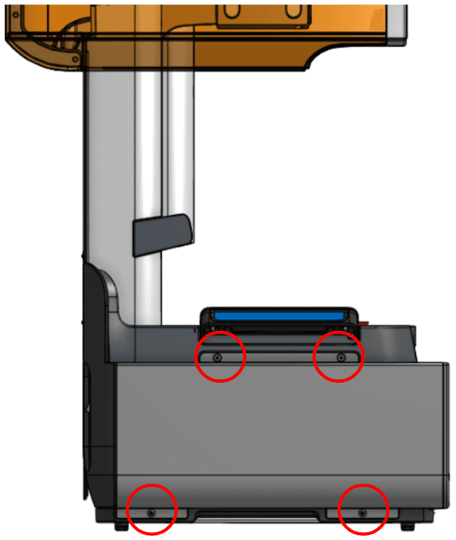

Remove the Form 4 left panel retention screws
Use a 2.5 mm hex driver to remove the four screws securing the left panel to the printer. Set the left panel and the screws aside.

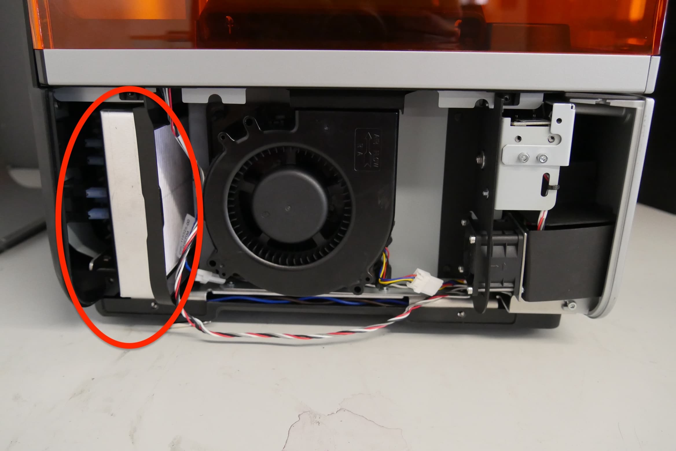

Step 2: Locate the LPU fan filter
Form 4 LPU fan filter location annotated in printer
The LPU fan filter sits in a housing next to the fan and includes a white pull tab on its side to allow for easy removal.

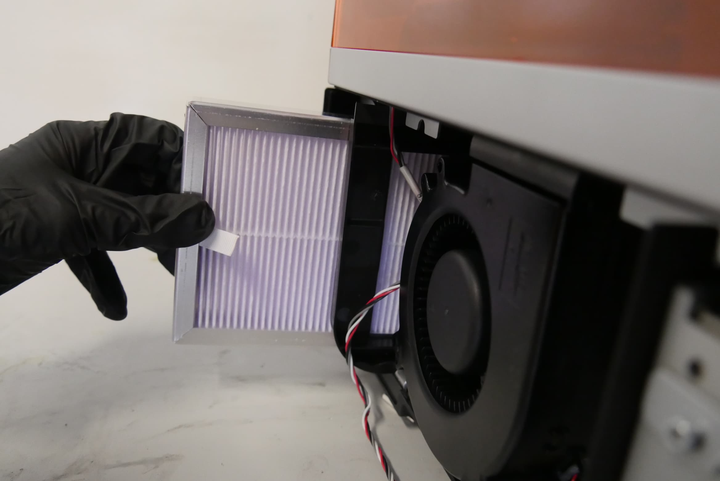

Step 3: Remove the filter
Removing the Form 4 LPU fan filter using the white pull tab
Using the white pull tab, carefully pull the LPU fan filter out of its housing. The LPU fan filter should come out easily. Set the LPU fan filter aside for disposal.

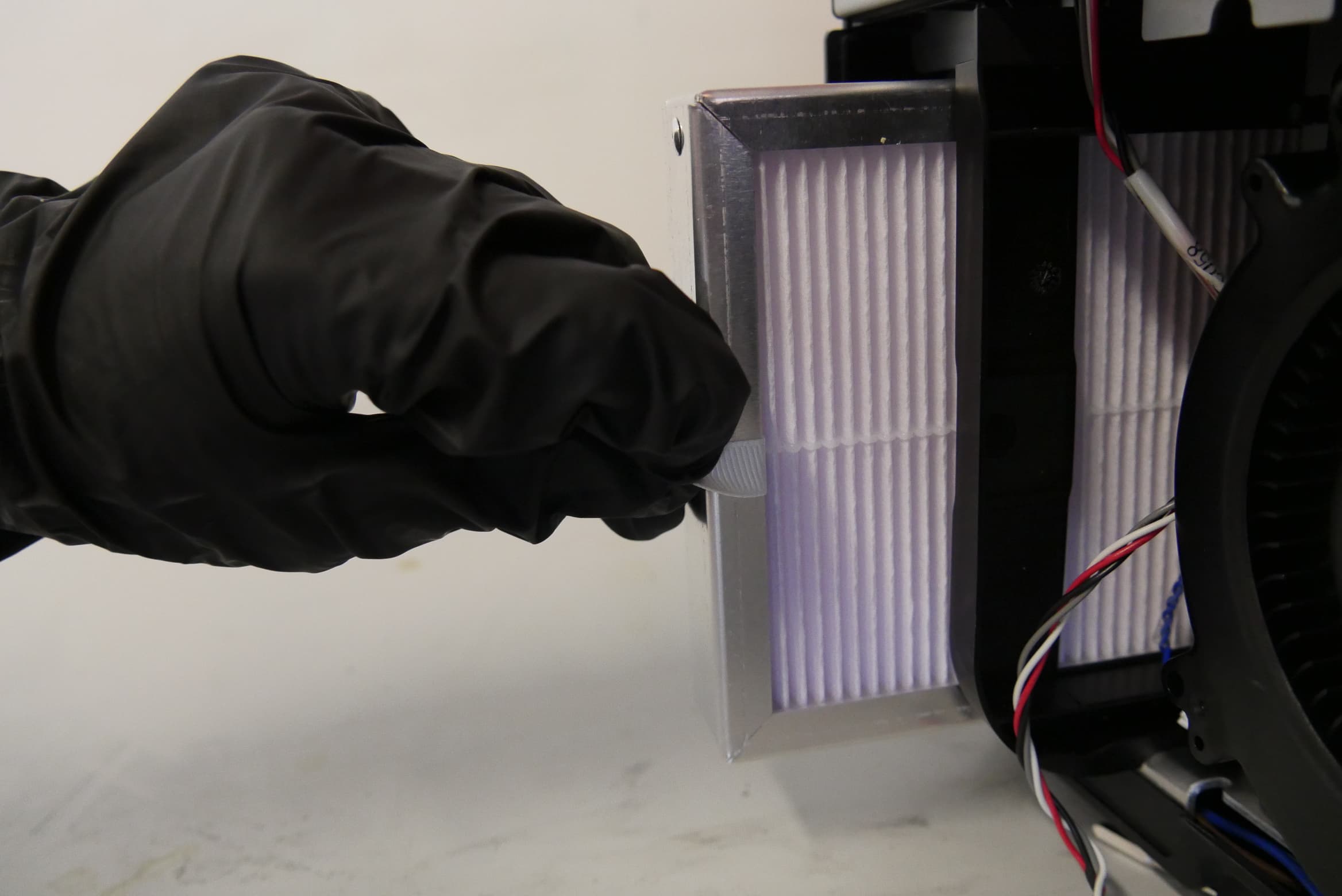

Inserting the replacement Form 4 LPU fan filter into its housing
Grip the LPU fan filter by its metal frame and insert it into its housing until fully seated. Take care not to touch the filter directly. The LPU fan filter should slide easily into its housing without any resistance.

Step 3: Install the left panel screws
Installing the Form 4 left panel screws
Use a 2.5 mm hex driver to install the four screws that secure the left panel to the printer. Tighten the screws until snug.
