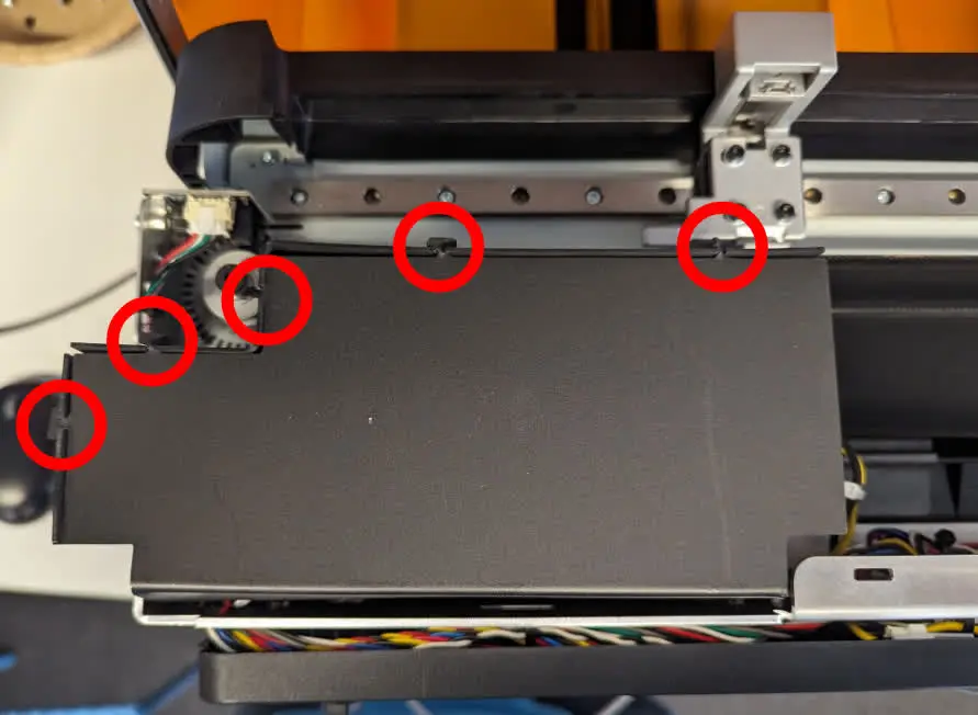

Step 1: Open the plastic shroud
Release the five tabs holding the shroud closed. Unfold the top of the shroud.

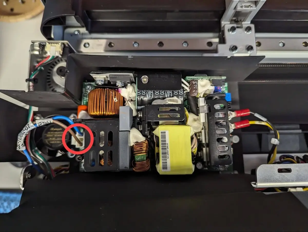

Step 2: Unplug the output cable
Hold the connector by its plastic housing and gently squeeze the plastic tab to unplug the output cable from the power supply. Do not pull on the individual wires.

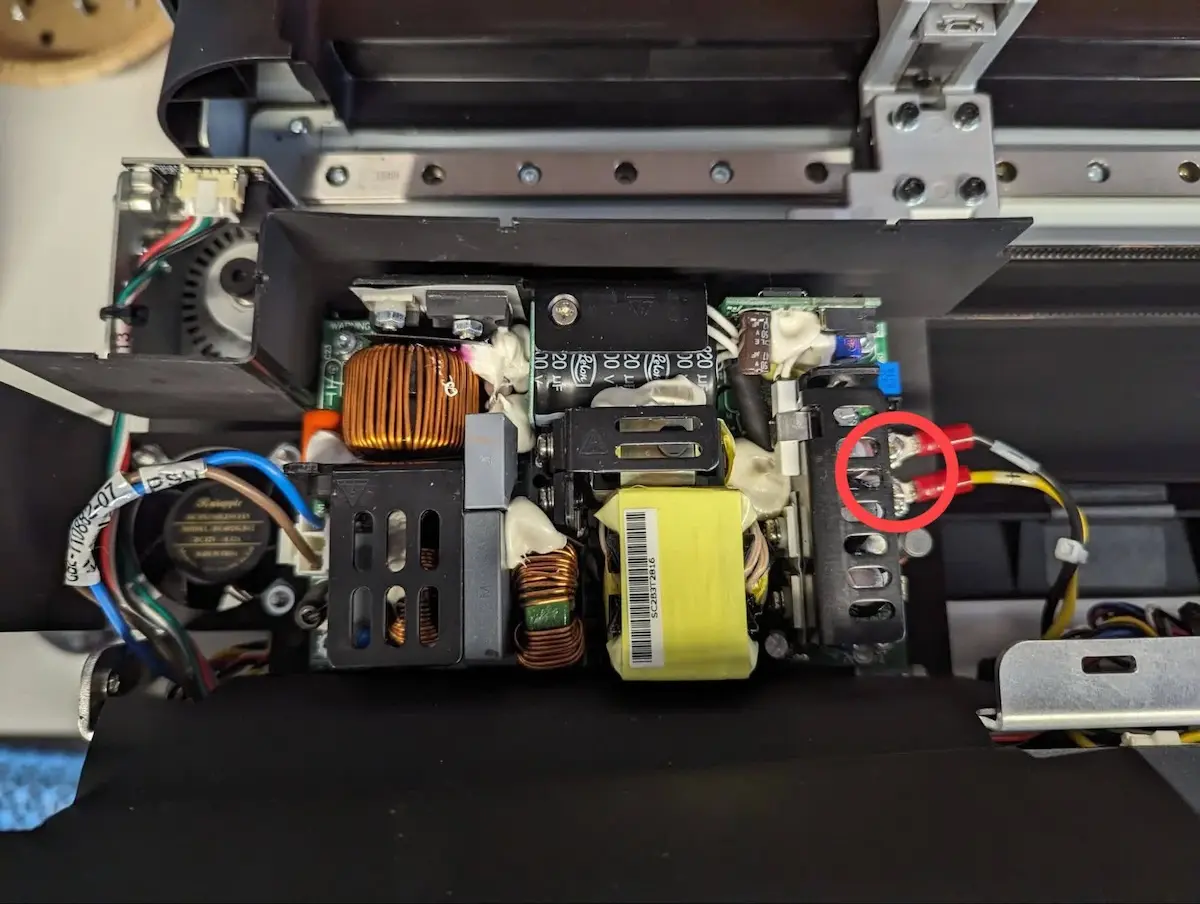

Step 3: Remove the input wire mounting screws
The input wires attach to the power supply with a ring terminal and screw. Using a Phillips screwdriver, remove each screw securing the ring terminal to the power supply. Set the screws aside. Do not remove the ring terminal from the input wire.

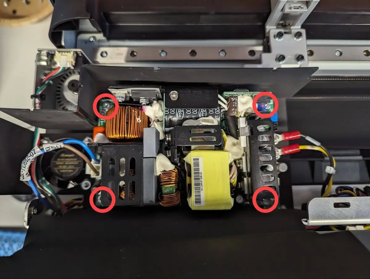

Step 4: Remove the power supply mounting screws
Use a 2.5 mm hex driver to remove the four hex screws that secure the power supply to the printer. Set the screws aside.

Step 2: Secure the power supply
Thread one hex screw into each screw hole. Using a 2.5 mm hex driver, hand-tighten the four hex screws to secure the power supply to the printer. Tighten the screws until snug.
Step 3: Connect the input wires
Match the correct input wire to the correct screw terminal. The black wire with the – label attaches to the upper screw terminal. The yellow wire with the + label attaches to the lower screw terminal. Thread a screw through the ring terminal into the screw terminal. Using a screwdriver, hand-tighten the two screws to secure the input cables to the power supply. Tighten the screws until snug.
Step 4: Connect the output cable
Connect the output cable to the power supply. The connector makes an audible and tactile click when secured.
Step 5: Close the plastic shroud
Fold the plastic shroud to cover the power supply. Reinsert the five tabs into the corresponding slots.
