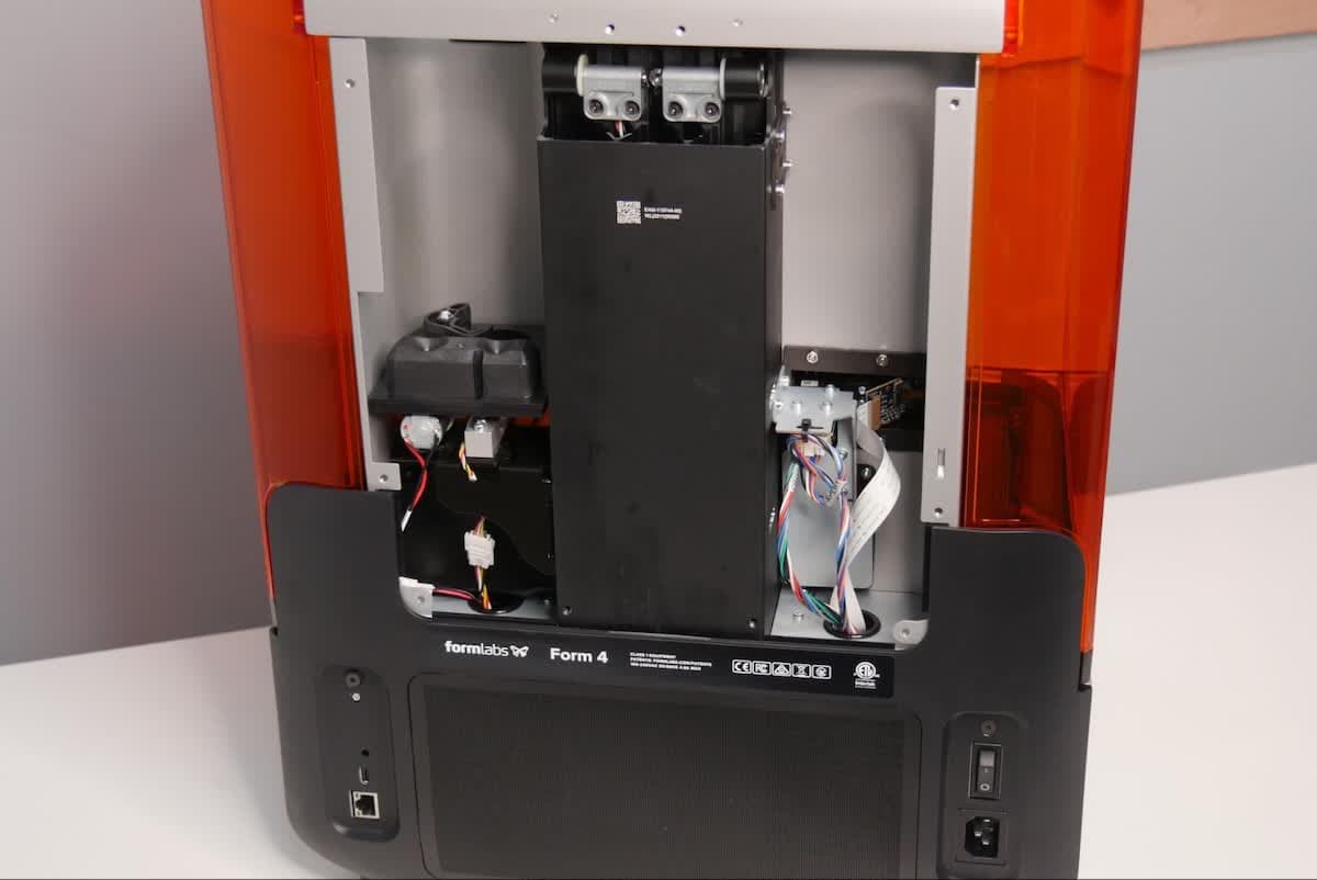

Removing the back panel
Overview: Remove the back panel to access the resin cartridge RFID board.
NOTICE:
Formlabs printers contain sensitive electronic components. Ground yourself before touching any electronics in the printer by using a grounding strap or touching a grounded piece of metal.

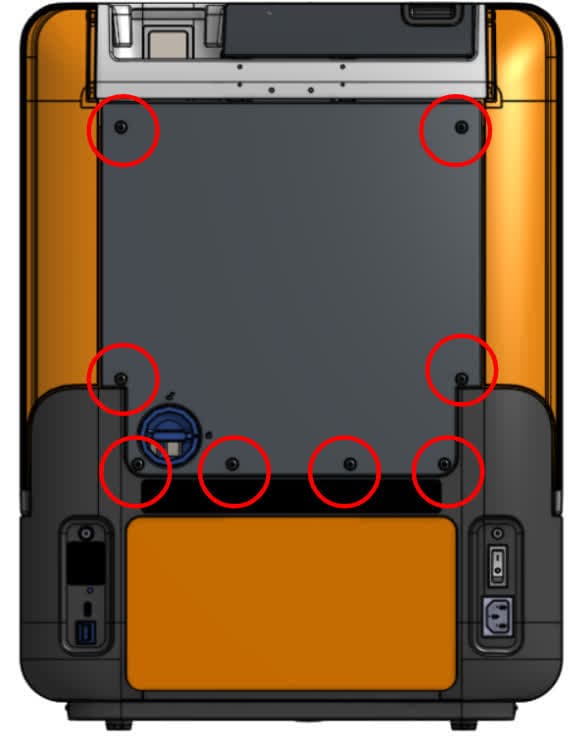

Step 1: Remove the back panel screws
Use a 2.5 mm hex driver to remove the eight screws securing the back panel to the printer. Set the screws aside.

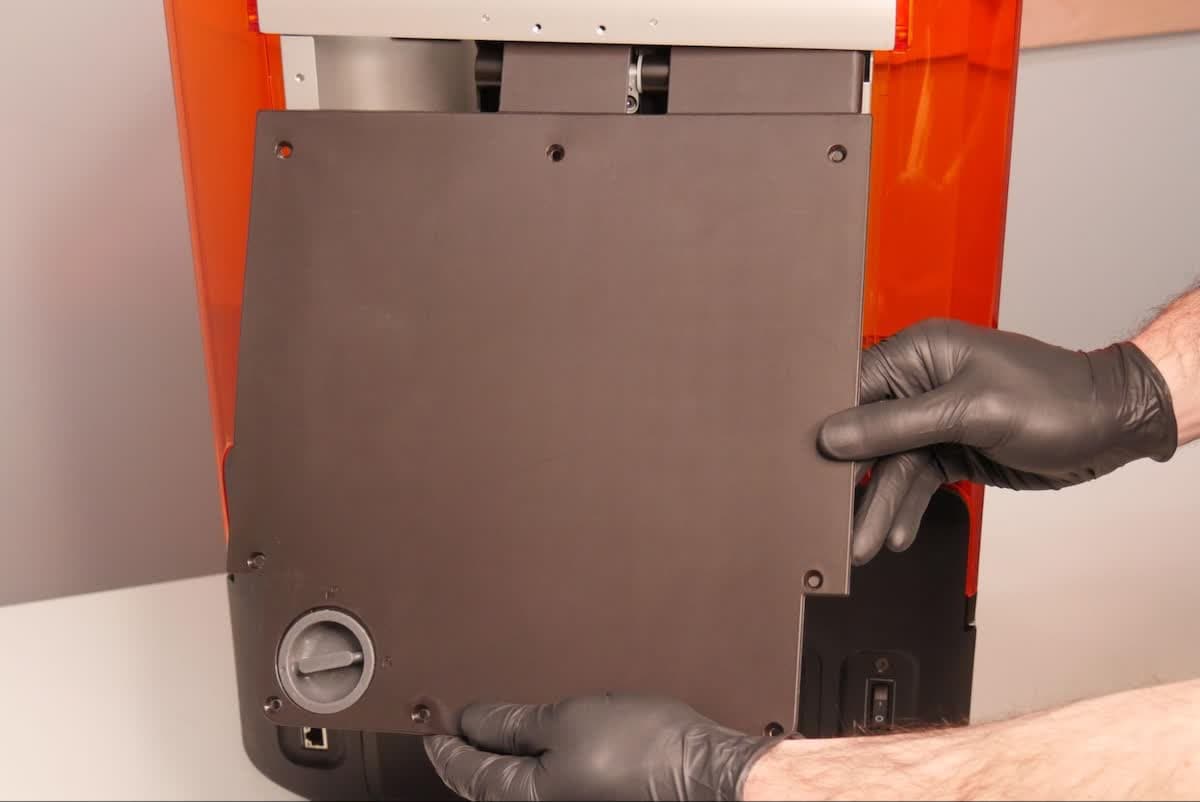

Step 2: Remove the back panel
Remove the back panel by sliding it down and away from the back of the printer. Set the back panel aside.

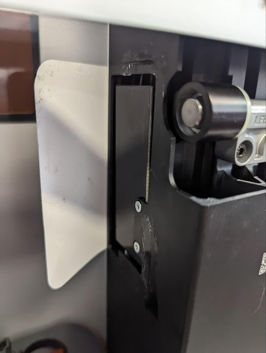

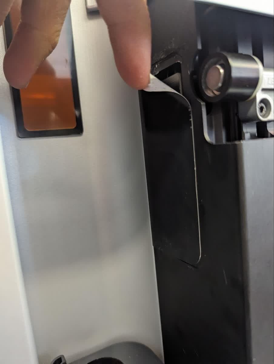

Step 1: Expose the resin cartridge RFID board
Locate the black sticker on the cartridge side of the Form 4 Z-tower. Use a fingernail to peel the sticker to the edge of the tower. Do not completely remove the sticker.

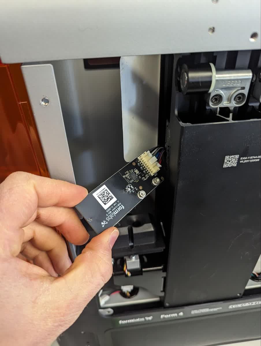

Step 3: Disconnect the resin cartridge RFID cable
Squeeze the plastic retaining clip and unplug the resin cartridge RFID cable from the board. Do not pull on the wires.
Step 4: Remove the resin cartridge RFID board
Once the cable is unplugged, the resin cartridge RFID board is separated from the printer. Set the RFID board aside for disposal with electronics waste.

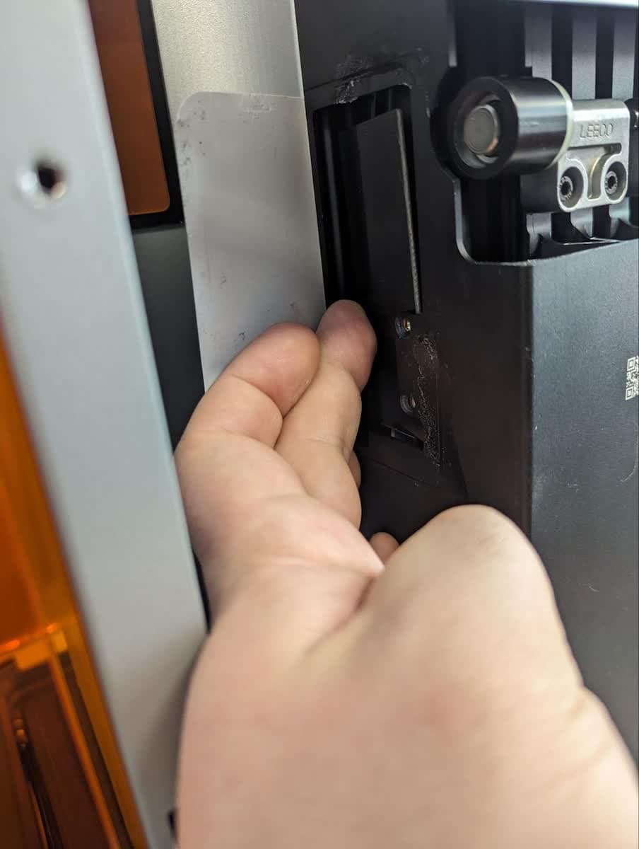

Step 2: Mount and secure the resin cartridge RFID board
Insert the resin cartridge RFID board into the cavity in the Z-tower. Make sure that the board sits behind the tab on the Z-tower and that the screw holes in the board align with those in the tab. Press on the far side of the RFID board with a finger to pivot the threaded side of the board against the screw holes.
Thread the resin cartridge RFID board retention screws into the screw holes. Use a 1.5 mm hex driver to tighten the two screws until finger tight.
Step 3: Reposition the sticker
Fold the sticker back over the resin cartridge RFID board and press into place. If necessary, use a piece of adhesive tape to secure the sticker.
