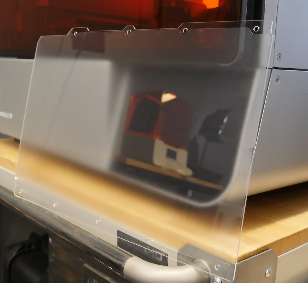

The diffuser panel lies sandwiched between the Backlight Unit and the Light Processing Unit (LPU) on Form 4L generation printers. It evenly distributes the light from the Backlight Unit and is necessary for a functioning optical system. A damaged diffuser panel may prevent the printer from printing properly.
Use this guide to replace the diffuser panel on a Form 4L generation printer.

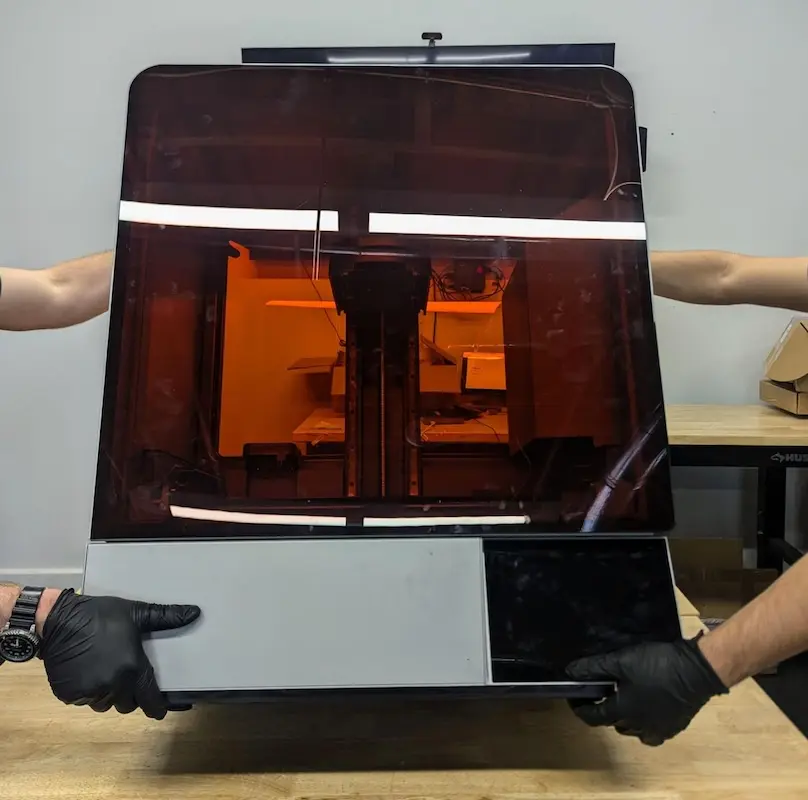

Ensure that the build platform, resin cartridge, resin tank, and mixer have been removed from the printer to prevent damage. With the help of another person, grip the Form 4L by the bottom front and top rear corners. Carefully rotate the printer so that it is resting on the back surface with the bottom facing you. Leave at least 30 cm (12 in) of clear tabletop in front of the printer when it is lying down.

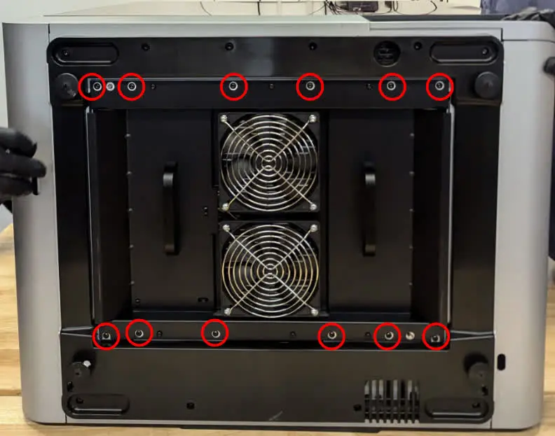

Step 3: Remove the Backlight Unit screws
Use a 3 mm hex driver to remove the 12 screws that secure the Backlight Unit to the bottom of the printer. Do not remove the Torx screws. Set the screws aside.

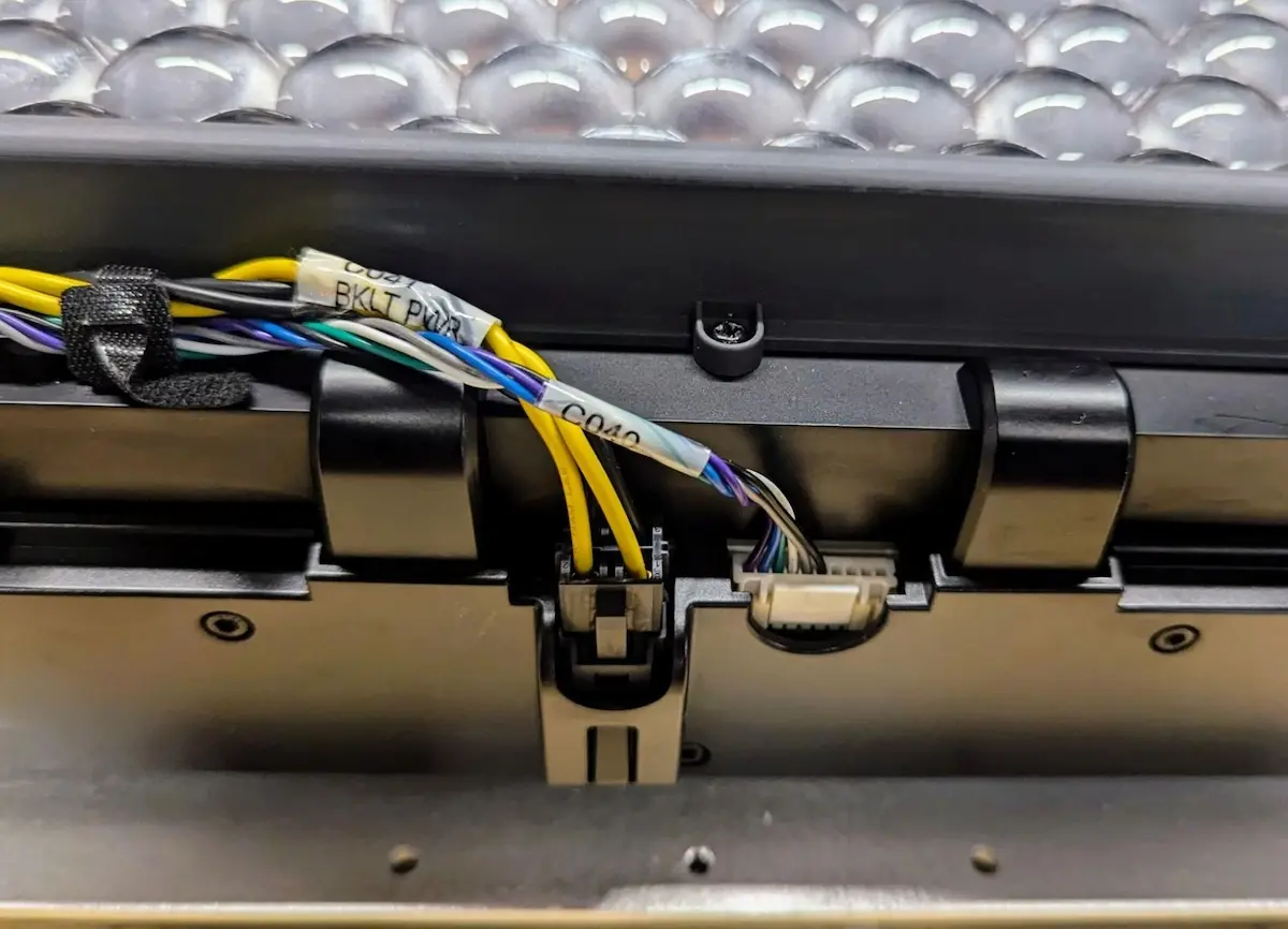

Step 5: Unplug the backlight cables
The backlight cables are located at the front of the Backlight Unit. Gently squeeze the plastic tabs to unplug the backlight cables from the Backlight Unit. Do not pull on the individual wires.

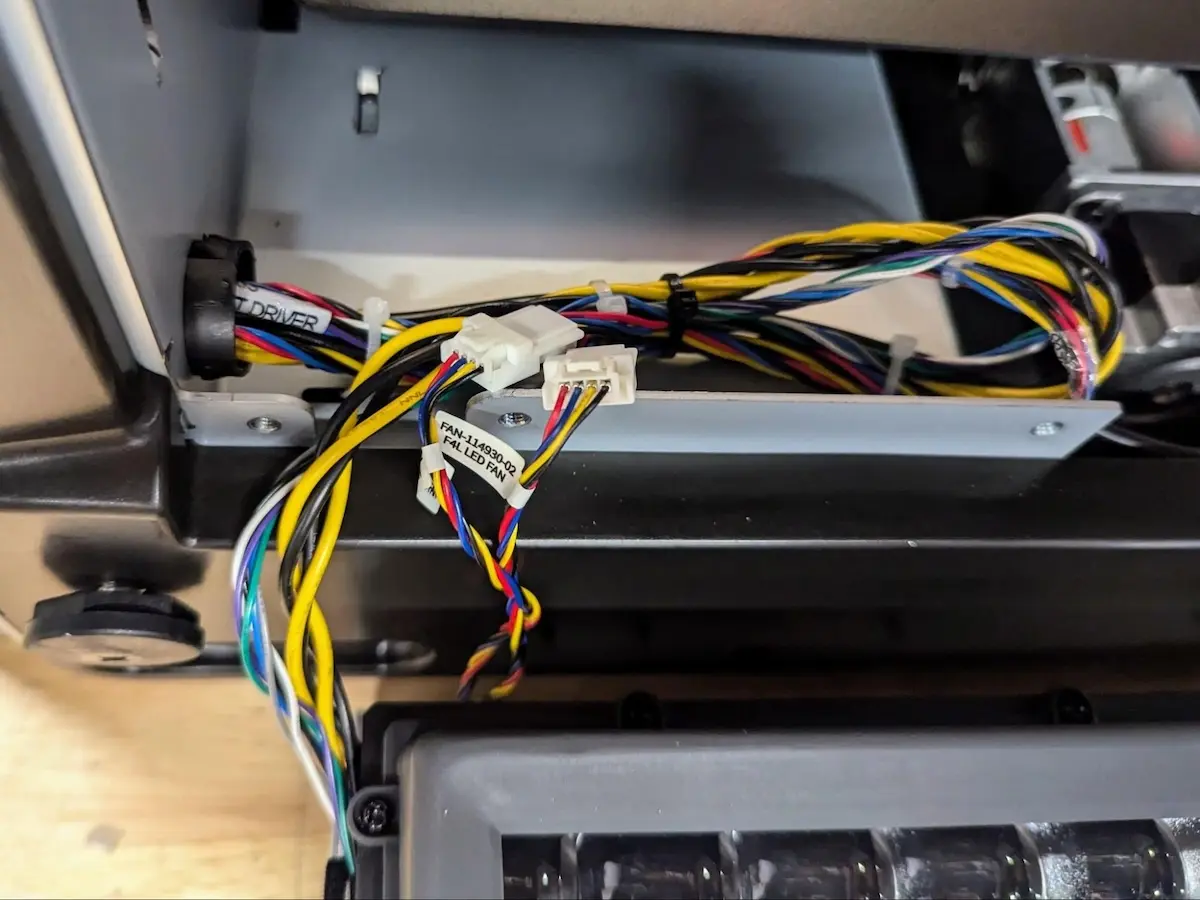

Step 7: Disconnect the LED fan cables
The LED fan cables are located in the bottom-left of the optical cavity. Squeeze the plastic retaining clips and unplug the LED fan cables from the printer. Do not pull on the wires.

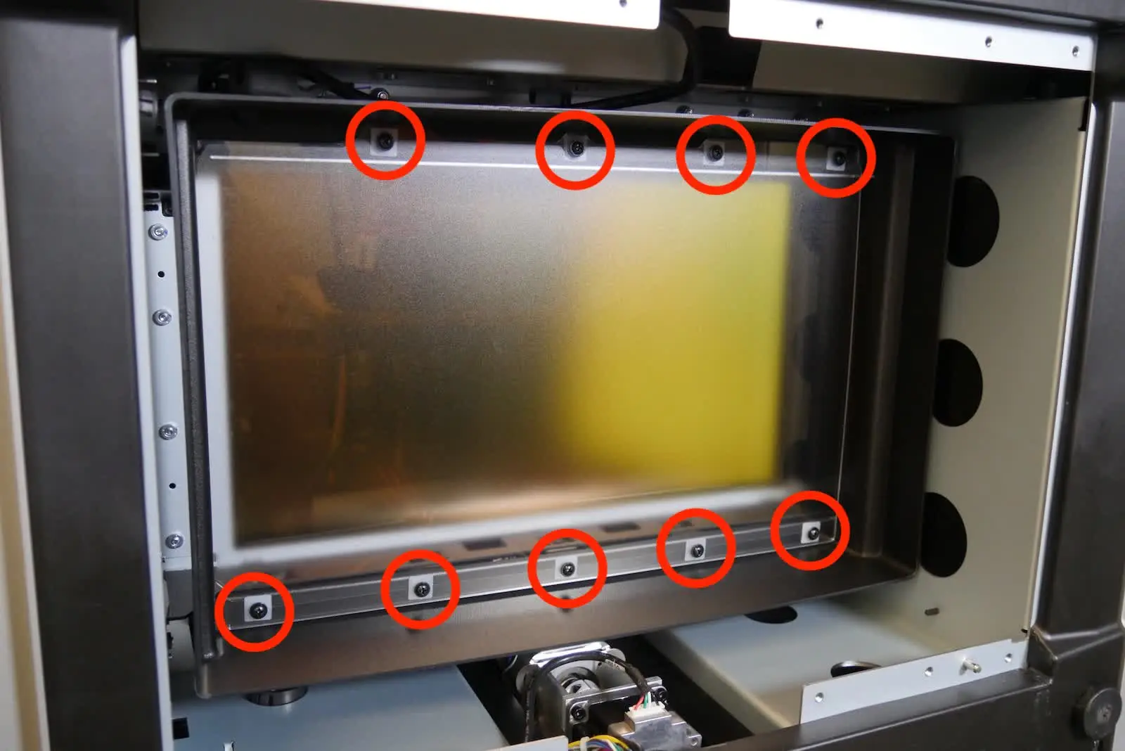

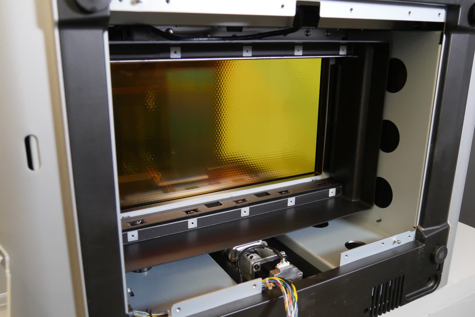

Step 1: Remove the diffuser panel screws
Form 4L diffuser panel mounting screws
Use a Phillips head screwdriver to remove the nine screws that secure the diffuser panel to the printer. Set the screws aside.

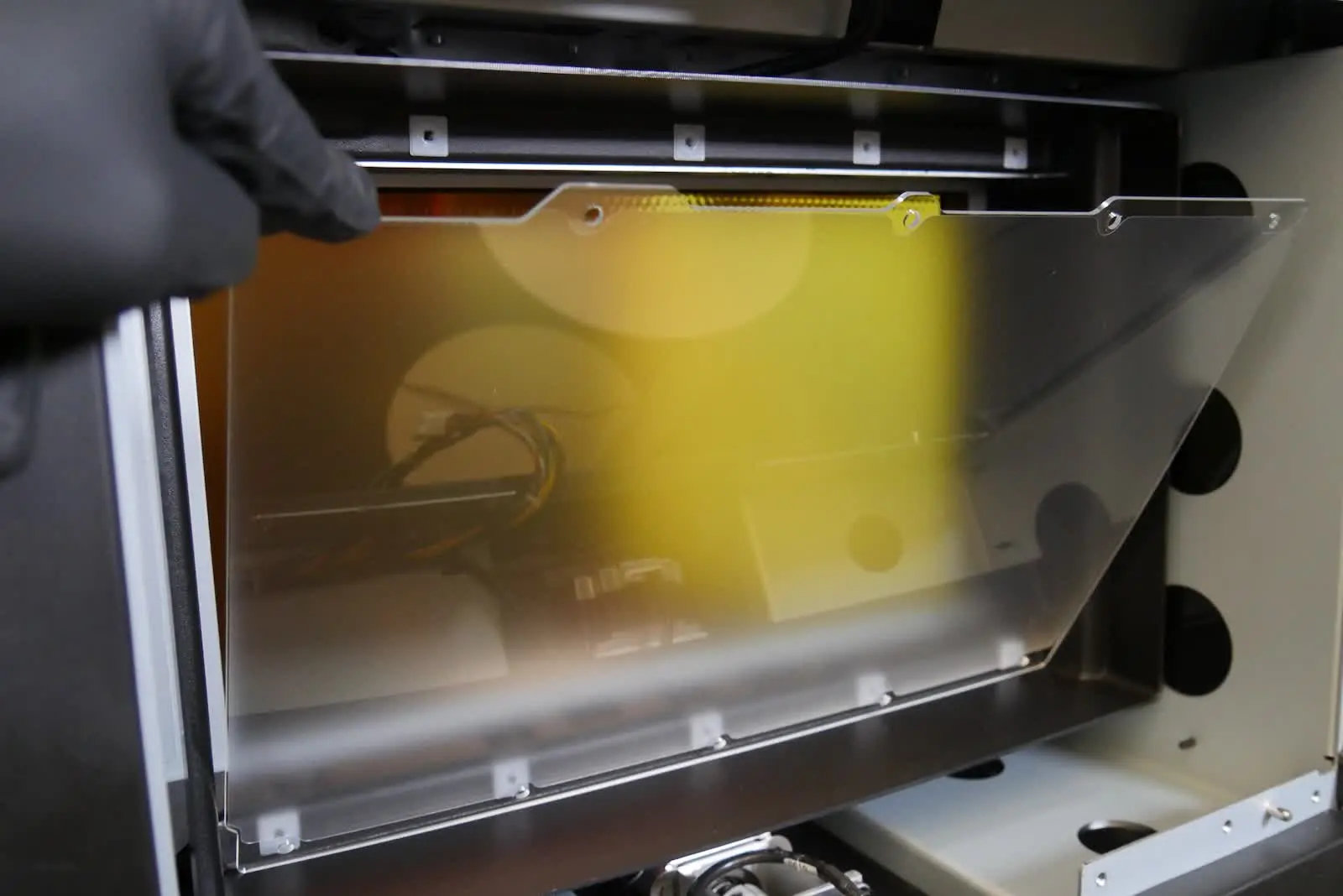

Step 2: Remove the diffuser panel
Remove the diffuser panel from the printer. Set aside for disposal.
Form 4L printer with diffuser panel removed
Notice:
Take care not to touch the components inside the exposed optical cavity. Doing so may contaminate the LPU and lead to repeated print failures.

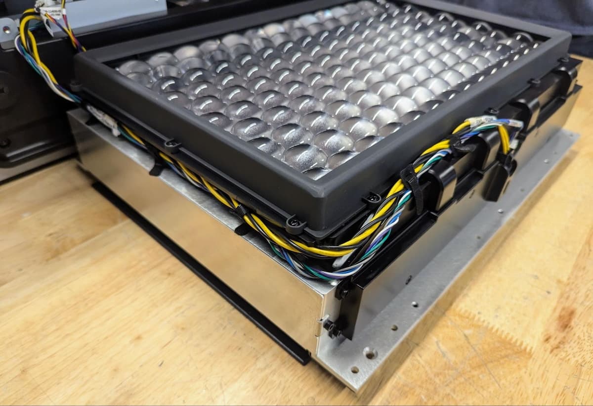

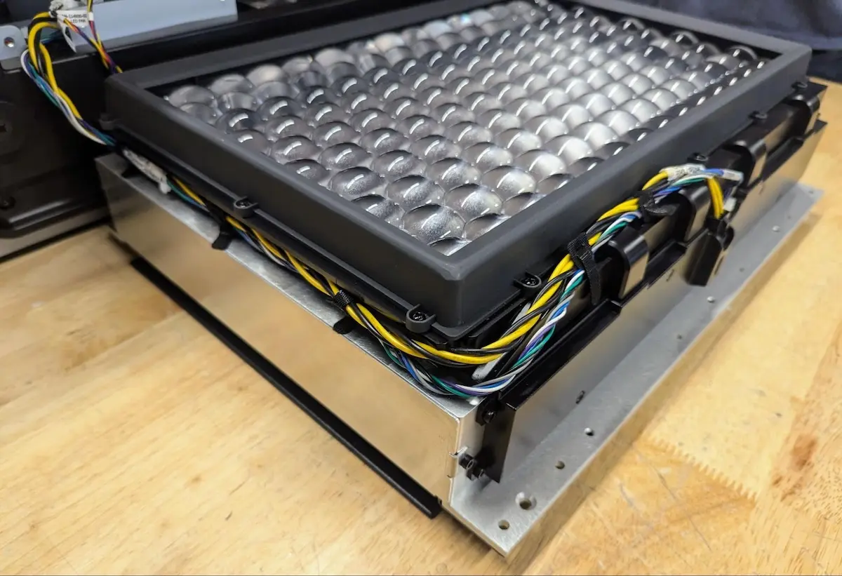

Step 1: Position the Backlight Unit in front of the printer
Place the Backlight Unit on the workspace in front of the printer with the lens array facing up. Orient the Backlight Unit with the backlight cable connectors at the front.
NOTICE:
Do not touch the exposed lenses. Doing so may contaminate the lenses and lead to repeated print failures.

Step 3: Connect the backlight cables
Connect the backlight cables to the Backlight Unit. The connectors make an audible and tactile click when secured.
Step 4: Route the cables
Route the backlight cables along the edge of the Backlight Unit and secure them with the cable management straps.

With the help of another person, grip the Form 4L by the bottom front and top rear corners. Carefully rotate the printer upright so it sits on its leveling feet.
