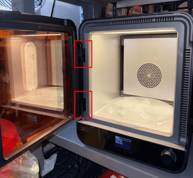

Form Cure (2nd Generation with door open and door hinges annotated.
Form Cure (2nd Generation) with door open and door hinge screws annotated.

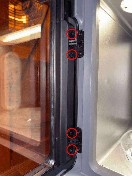

The Form Cure door is mounted to the machine’s frame with two hinges on the left side of the unit. Using a 2.5 mm hex driver, unscrew and remove the four screws securing the door to its hinges. Set the screws aside.
Thread one screw into each of the four hinge screw holes. Use a 2.5 mm hex drive to tighten the screws until finger tight.
