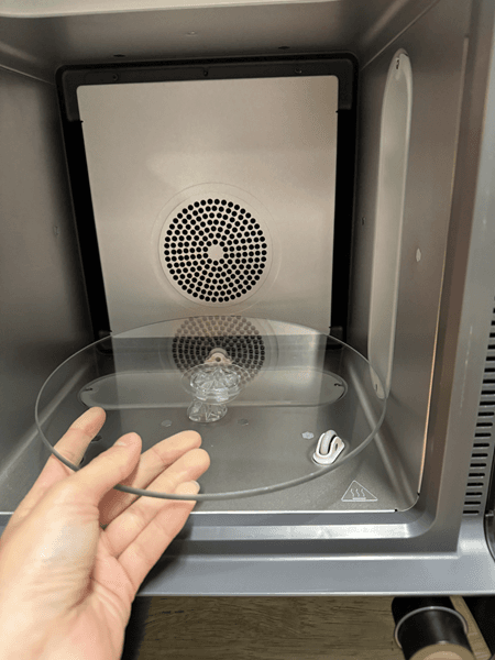

Lift the turntable directly upwards off the rollers and set it aside.

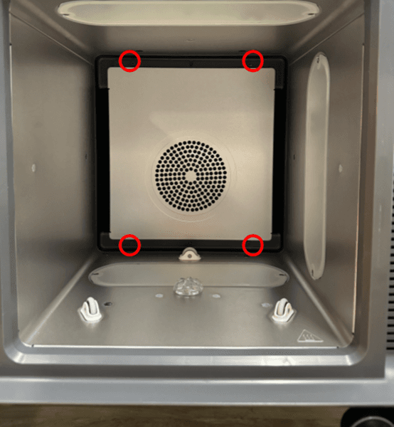

Step 1: Remove the heater cover panel screws

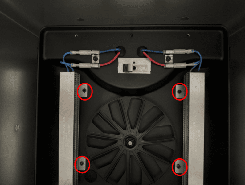

Use a 2.5 mm hex driver to remove the four screws that secure the heater cover panel to the machine. Set the panel and the screws aside.

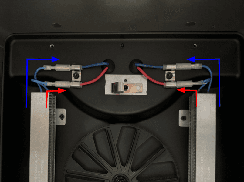

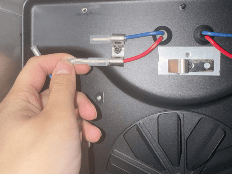

Each heater connects to the machine with one blue cable and one red cable. Gently pull the plastic housing on each of the four cables to disconnect the heaters. Do not pull on the individual wires.

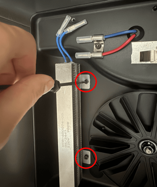

Step 3: Remove the heater retention screws
Use a 2.5 mm hex driver to remove the two heater retention screws that secure each heater to the machine. Set the four screws aside.

Each heater has two cables that connect to the machine. Attach the inner cable to the red cable. Attach the outer cable to the blue cable. The cable makes an audible click when properly connected.

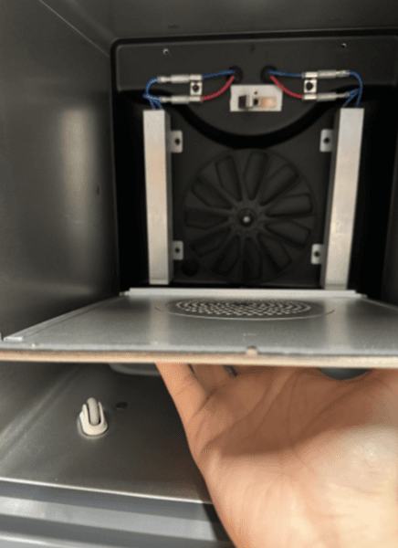

Step 4: Align the heater cover panel

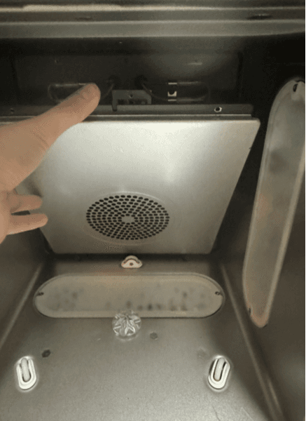

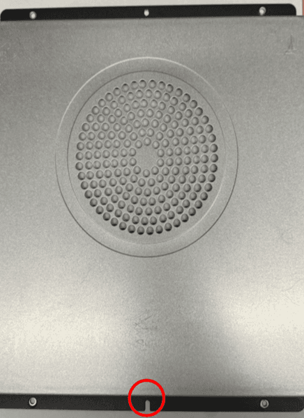

Align the heater cover panel in the correct orientation with the notch on the bottom and the black mounting brackets facing out into the curing chamber. Tilt the heater cover panel at an angle to insert into place without interfering with the fan.
