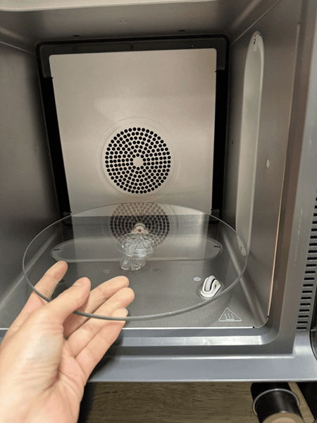

Step 3: Remove the turntable
Lift the turntable directly upwards off the rollers and set it aside.

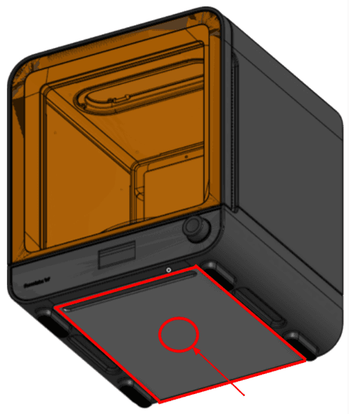

Locate bottom access panel
Ensure that the turntable has been removed from the machine to prevent damage. Carefully rotate the machine so that it is resting on the back surface with the bottom facing you. Leave at least 15 cm (6 in) of clear tabletop in front of the machine when it is lying down.

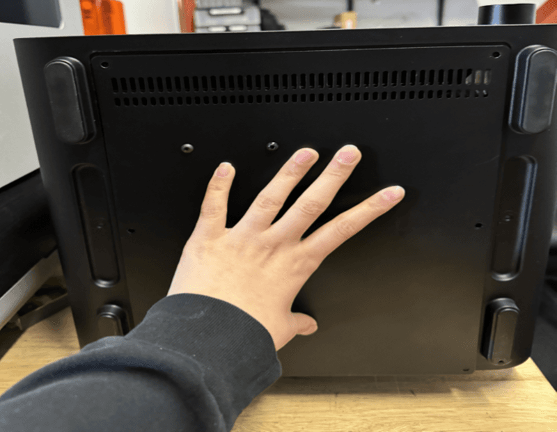

Step 2: Remove the bottom access panel screws

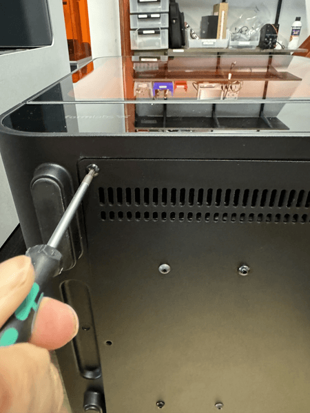

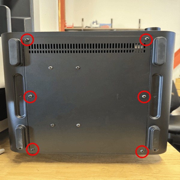

Use a 2.5 mm hex driver to remove the six screws that secure the bottom access panel to the machine. Set the panel and the screws aside.

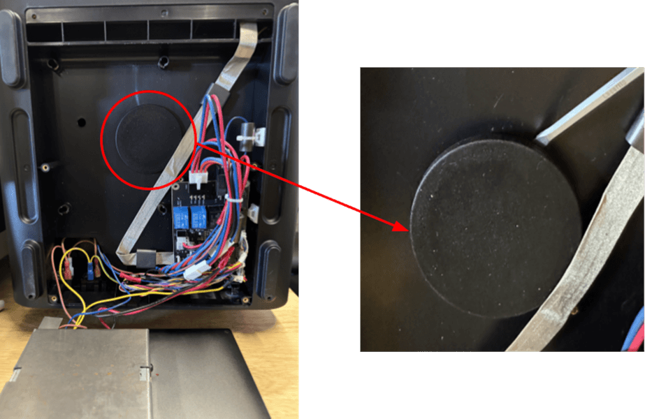

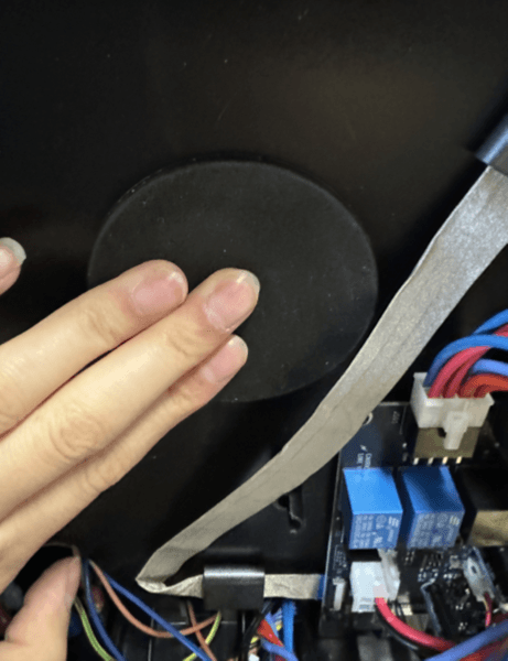

The turntable motor is located underneath a cap seal. Use a flat-head driver to remove the cap seal. Set the cap seal aside for later reinstallation.

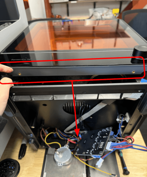

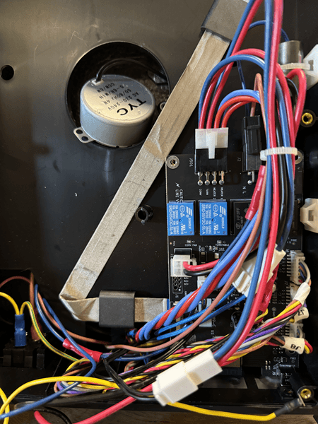

Step 4: Locate the motor cable
Close up of TURN on control board

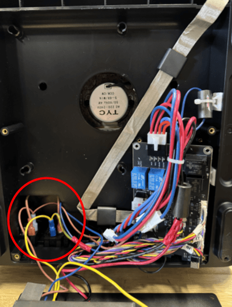

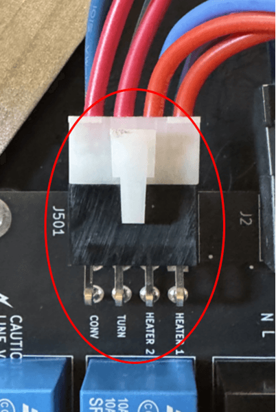

Locate the control board on the bottom right side of the machine. The motor cable connects to the control board in the port labeled TURN near the top left side of the board.

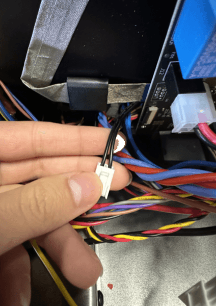

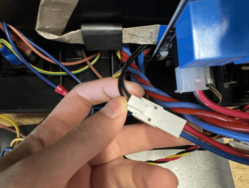

Step 5: Disconnect the motor cable

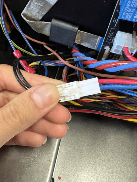

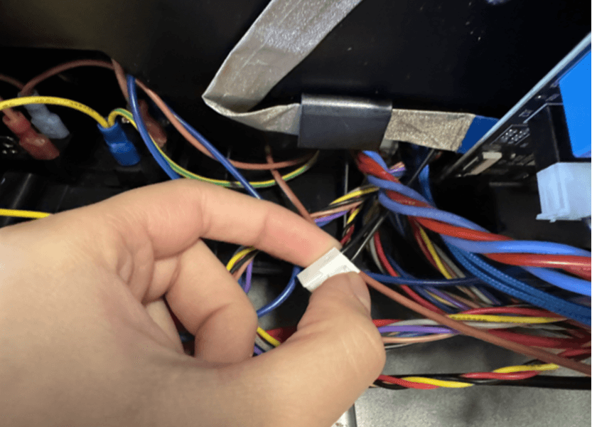

Follow the red and blue motor cable to the plastic housing connecting it to the black motor cable. Hold the connector by its plastic housing and gently squeeze the plastic tab to unplug the motor cables. Do not unplug the red and blue motor cables from the control board. Do not pull on the individual wires.
Step 6: Remove the control board screws
Using a 2 mm hex driver, unscrew and remove the four screws securing the control board to the machine. Set the screws aside. Allow the control board to hang loosely in front of the machine. Do not pull any cables. Do not remove any cables.

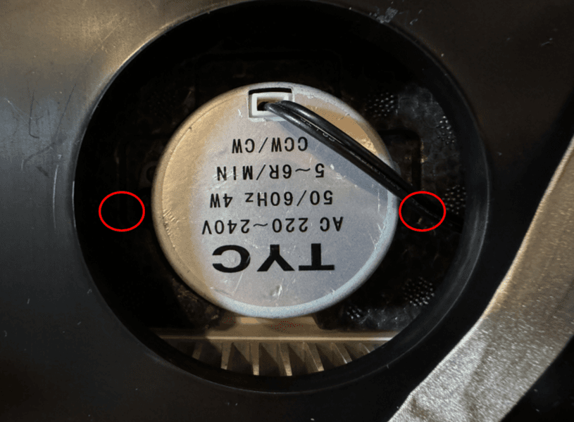

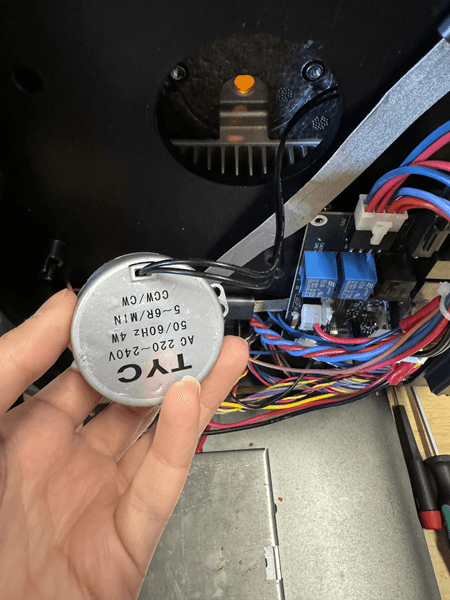

Step 7: Remove the turntable motor screws
alttext

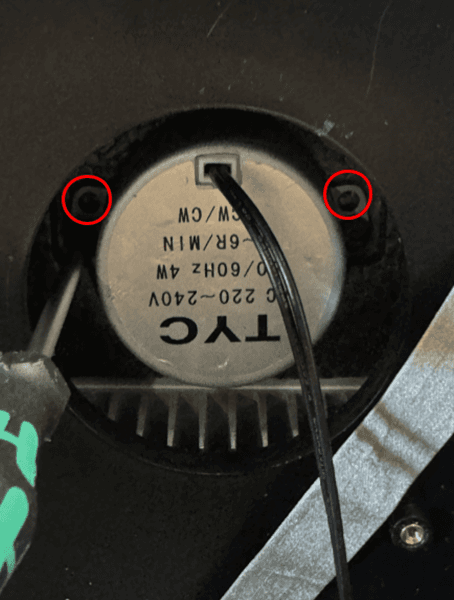

Using a 2.5 mm hex driver, unscrew and remove the two turntable motor screws securing the turntable motor to the machine. Take care not to drop the screws in the machine. Set the screws aside. Allow the turntable motor to rest along the machine. Do not pull the turntable motor away from the machine until the motor cable is disconnected.

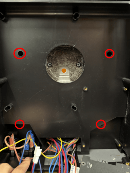

Step 7: Remove the bottom shell screws
Using a 2.5 mm hex driver, unscrew and remove the four screws securing the bottom shell to the machine. Set the screws aside.
Step 8: Tilt the bottom shell
Gently tilt the bottom shell away from the machine to access the internal cavity. Do not force the panel open, as it is still attached to the machine.

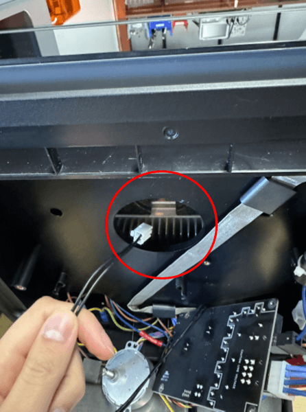

Step 9: Remove the motor cable
Reach into the machine and free the black motor cable from the machine.
Remove the motor cable through the opening in the bottom shell.
Reach into the machine and free the black motor cable from the machine. Remove the motor cable through the opening in the bottom shell. Remove the turntable motor and motor cable from the machine. Set aside for disposal with electronic waste.

Step 1: Mount and secure the turntable motor
Secure the turntable motor
Mount the replacement turntable motor through the opening in the bottom shell, aligning its screw holes with those in the panel. Take care that the motor is oriented with the label upside down. Thread one motor retention screw into each of the screw holes. Use a 2.5 mm hex driver to tighten until snug.

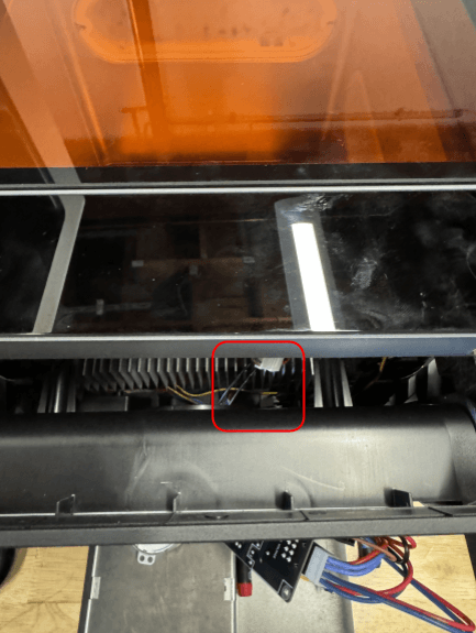

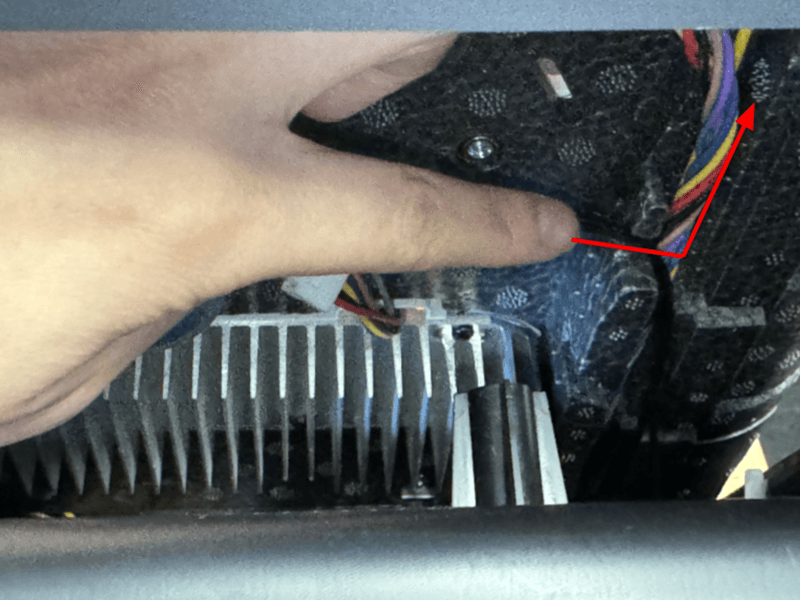

Step 2: Route the motor cable through the machine
Gently pull the bottom shell away from the machine to access the insulation below.

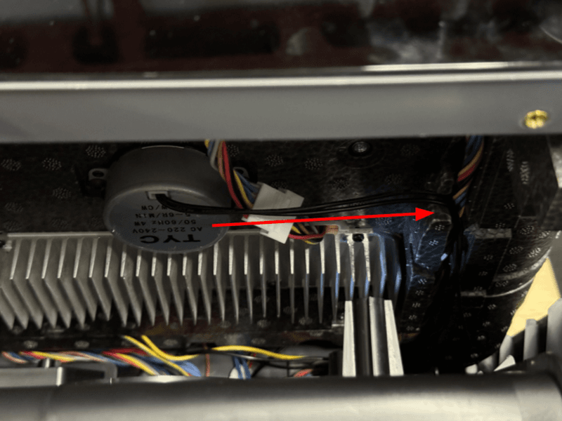

Press the motor cable through the grooved pathway alongside the multicolored LED module cable harness.
Route the motor cable through the opening in the bottom shell. Gently pull the bottom shell away from the machine to access the insulation below. Press the motor cable through the grooved pathway alongside the multicolored LED module cable harness.
Route the motor cable through the slot at the bottom of the internal panel.
Gently pull the motor cable by the plastic housing through the slot.
Route the motor cable through the slot at the bottom of the internal panel. Gently pull the motor cable by the plastic housing through the slot.
Step 3: Connect the motor cable to the control board
Press the plastic housing to connect the motor cable to the red and blue wires connected to the control board in the port labeled TURN.

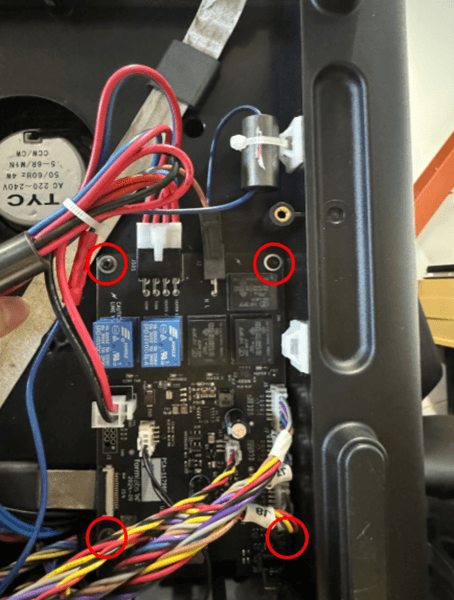

Step 5: Mount and secure the control board

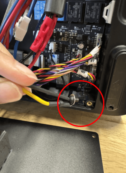

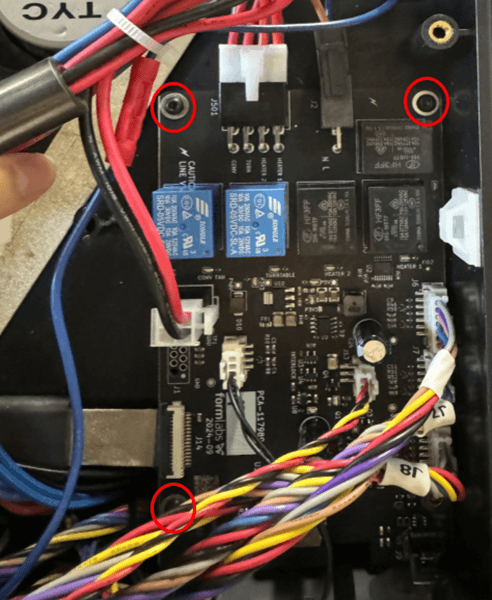

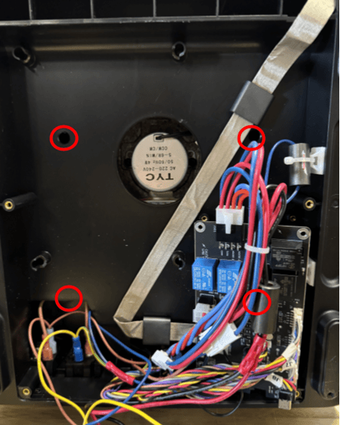

 Thread one control board screw into each of the three screw holes highlighted in red.
Thread the yellow cable ring terminal through the remaining screw into the lower right corner.
Thread one control board screw into each of the three screw holes highlighted in red. Thread the yellow cable ring terminal through the remaining screw into the lower right corner. Use a 2 mm hex driver to tighten until finger tight.

Lift the bottom access panel and mount it on the machine. Ensure that the six bottom access panel retention screw holes are aligned.
Step 7: Secure the bottom access panel
Thread one screw into each of the six screw holes in the bottom access panel. Using a 2.5 mm hex driver, tighten the screws until finger tight.

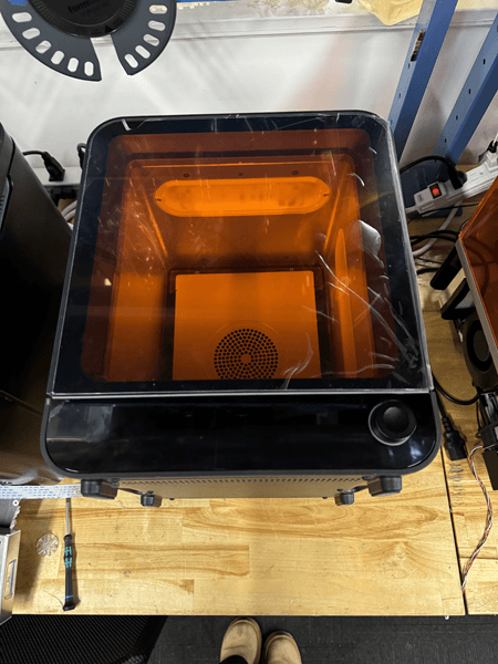

Step 2: Power on the machine
Close the Form Cure door. Connect the power cable to the Form Cure and the power supply. Flip the breaker switch on the back of the unit to the ON position to turn on the machine. The Form Cure initializes.
