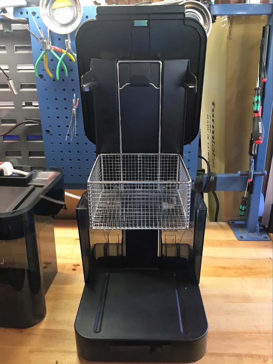

Step 3: Lift the outer lid
Lift the outer lid to expose the wash bucket and platform mount.
Step 4: Lift the platform mount
Lift the platform mount until it rests at the top of the lead screw. Some friction or shaking while lifting the mount is normal and should not affect the unit.

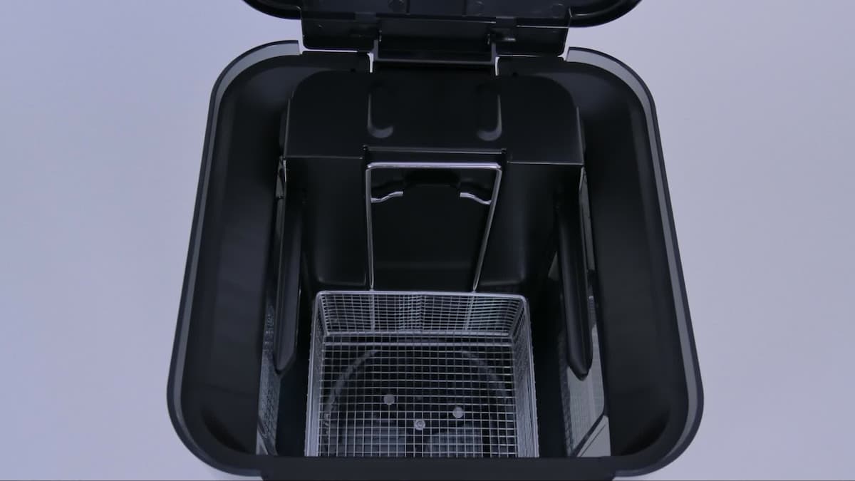

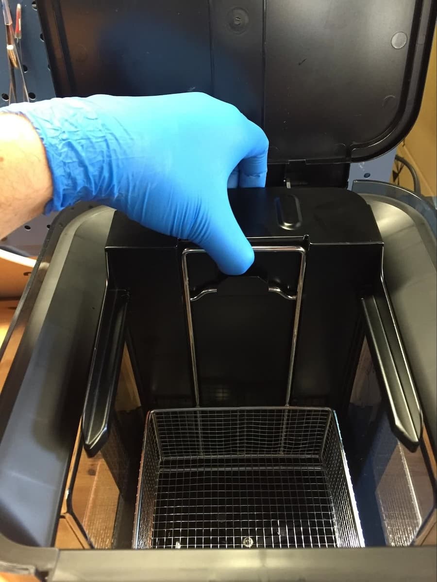

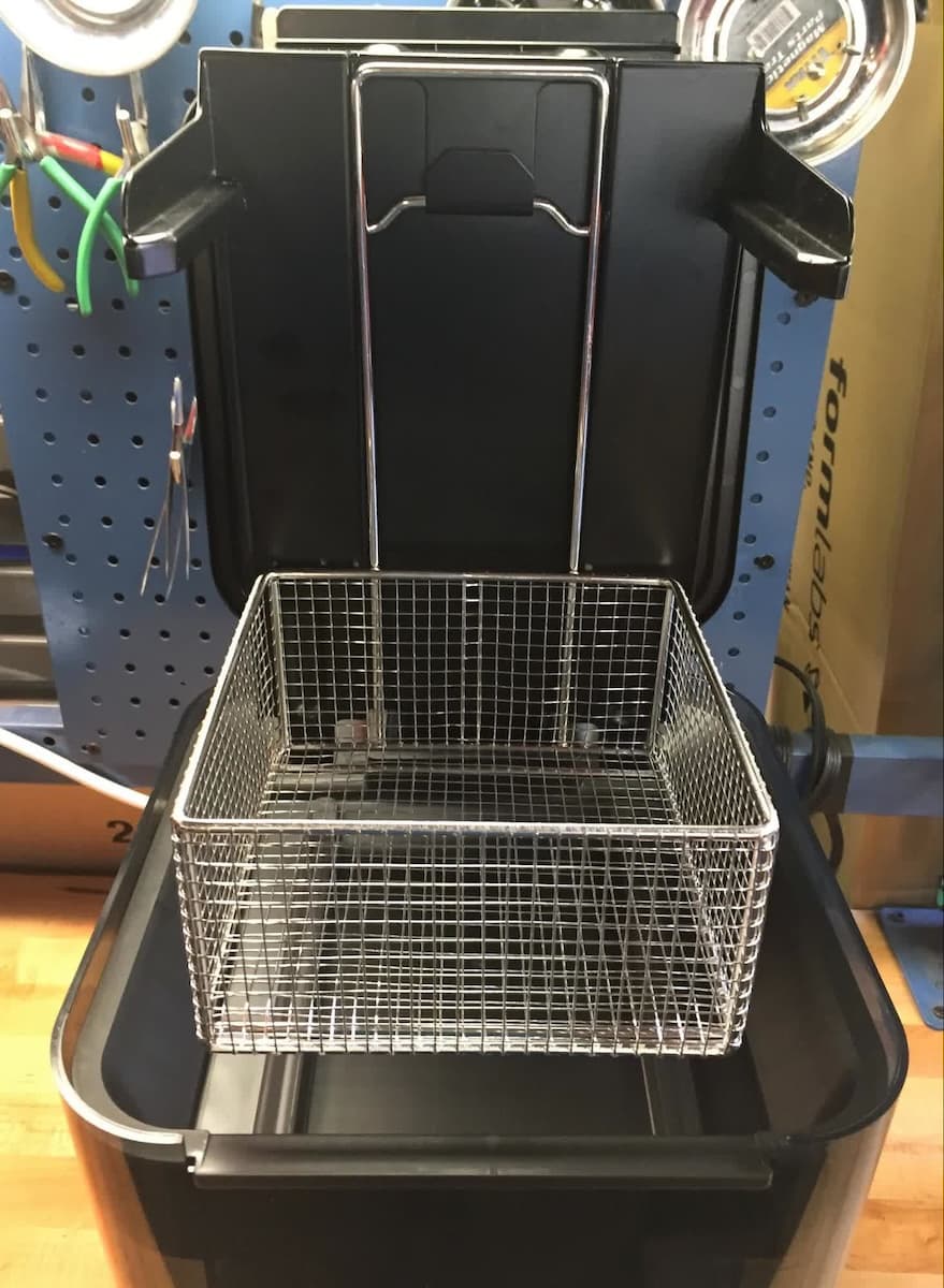

Step 5: Remove the wash bucket
Remove the wash bucket from the base and set the bucket aside on a stable, flat surface. To reduce the likelihood of spillage, remove the solvent from the wash bucket with a siphon pump.

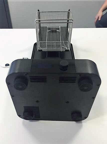

Step 1: Turn the unit over
Close the cover and turn the unit over so that it rests on its top and the bottom plate faces up.

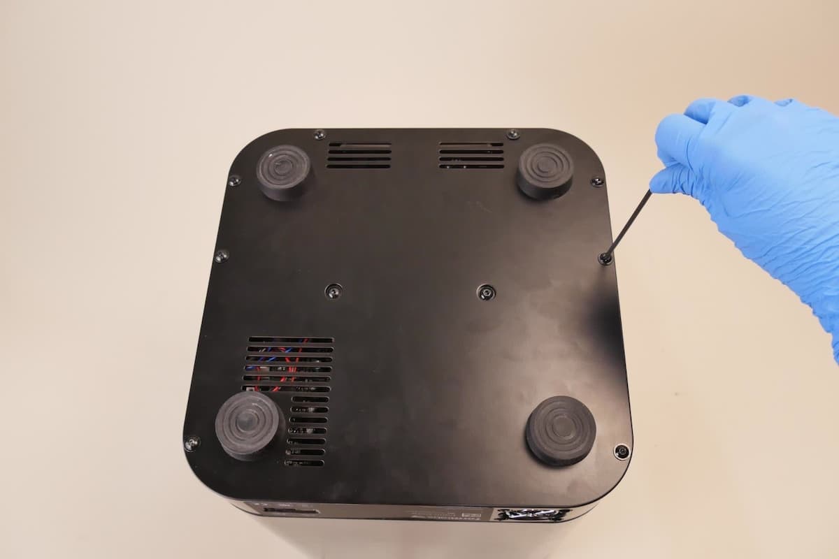

Step 2: Remove the outer screws
Turn the 2.5 mm hex driver counterclockwise to remove the eight screws around the bottom plate edge.
NOTICE:
Do not remove the two screws in the center of the bottom plate. The center screws secure the base assembly.
There are two screws along the top edge, three screws on the left edge, and three screws on the right edge. Set aside the bottom plate and the eight screws for reassembly.

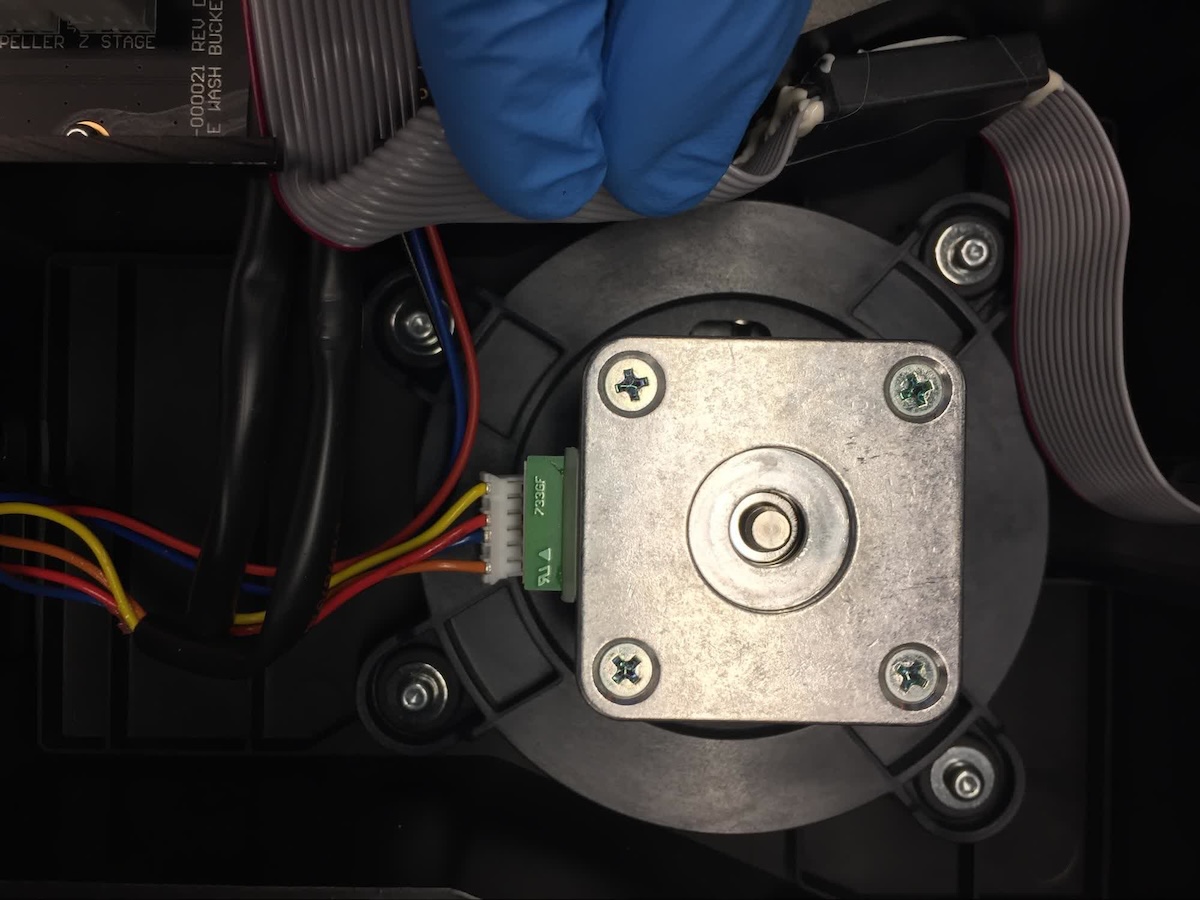

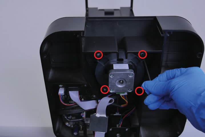

Overview: Disconnect the cable from the motor. Remove the four screws holding the motor to the base, and then remove the motor.

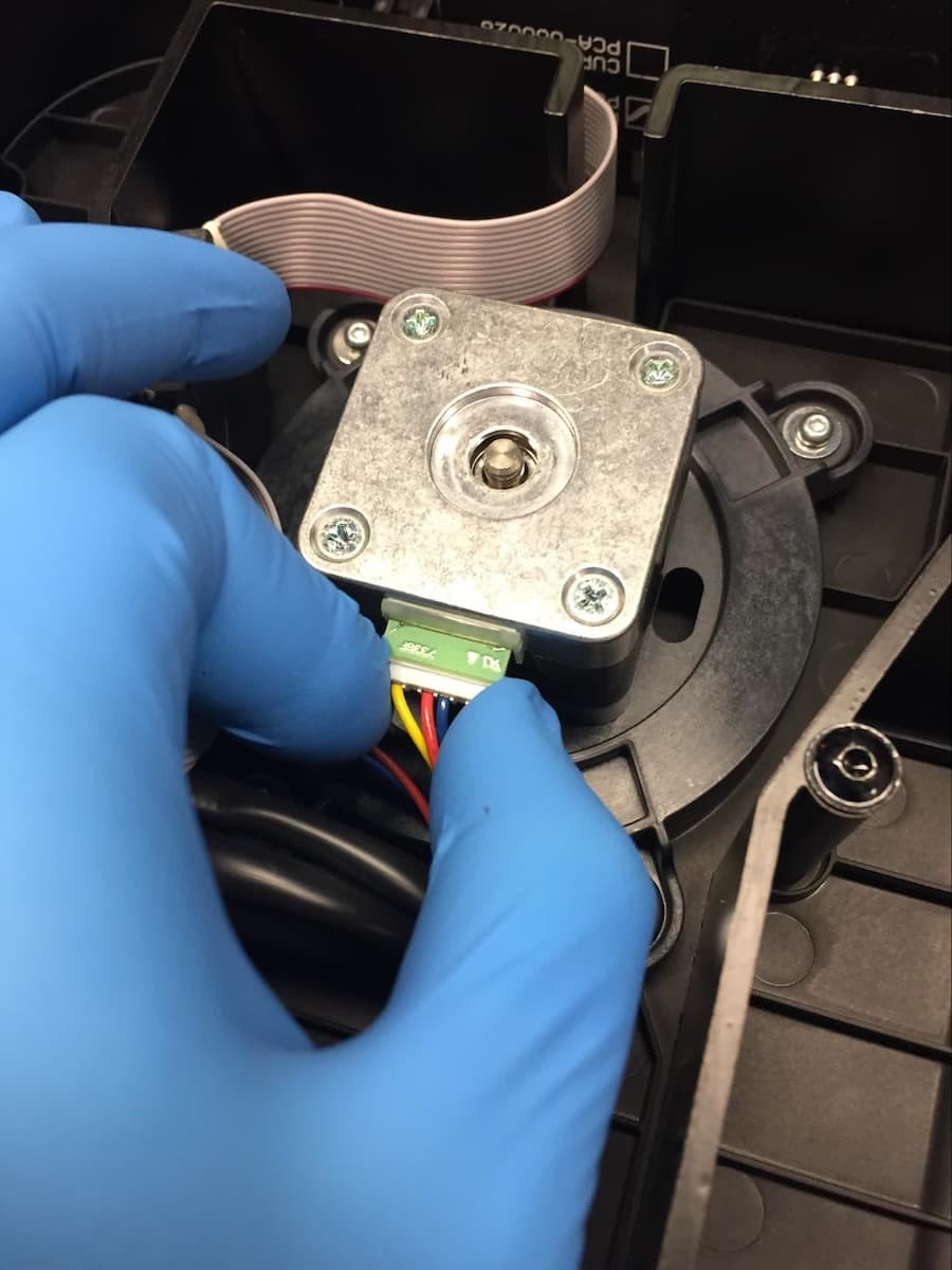

Step 1: Disconnect the cable from the motor
Disconnect the cable from the motor. Pull on the plastic connector and not the wires to avoid damage.
Step 2: Remove the screws and washers holding the motor in place
Using the 2.0 mm hex driver, remove the four screws and four washers that connect the motor to the base. Do not unscrew the four screws on the motor body itself. Set aside the screws and washers for reassembly.

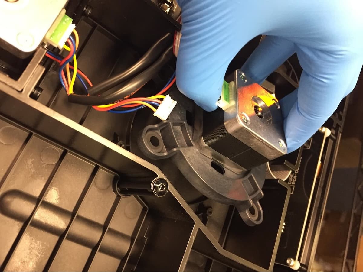

Step 3: Remove the motor assembly from the base
Pull evenly to remove the motor assembly. If you are replacing the impeller motor and magnetic clutch, proceed to step 6 to install the replacement assembly. If you are reseating the magnetic clutch without replacing the motor, process to step 4.

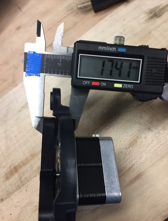

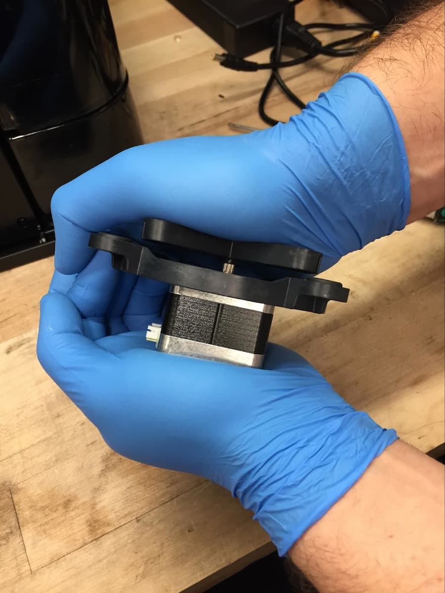

Step 4: Measure the distance between magnetic clutch and motor mount
Measure the distance from the top of the magnetic clutch to the underside of the motor mount.
If the distance is greater than 17.70 mm, the magnetic clutch is likely to prevent the motor from rotating properly and should be reseated.
Step 5: Press the magnetic clutch down
Using both hands, press together firmly the back of the motor and the magnetic clutch to remove any excess space between them. The clutch is seated correctly when it cannot be pressed down further.
Step 6: Reinstall the motor assembly
Reinstall the motor assembly by aligning the holes in the motor assembly with the holes in the base, If any cables obstruct the reinstallation, hold them to one side. Use a 2.0 mm hex driver to reinstall the four washers and four screws.
Step 7: Reconnect the motor cable
Connect the motor cable to the motor.
