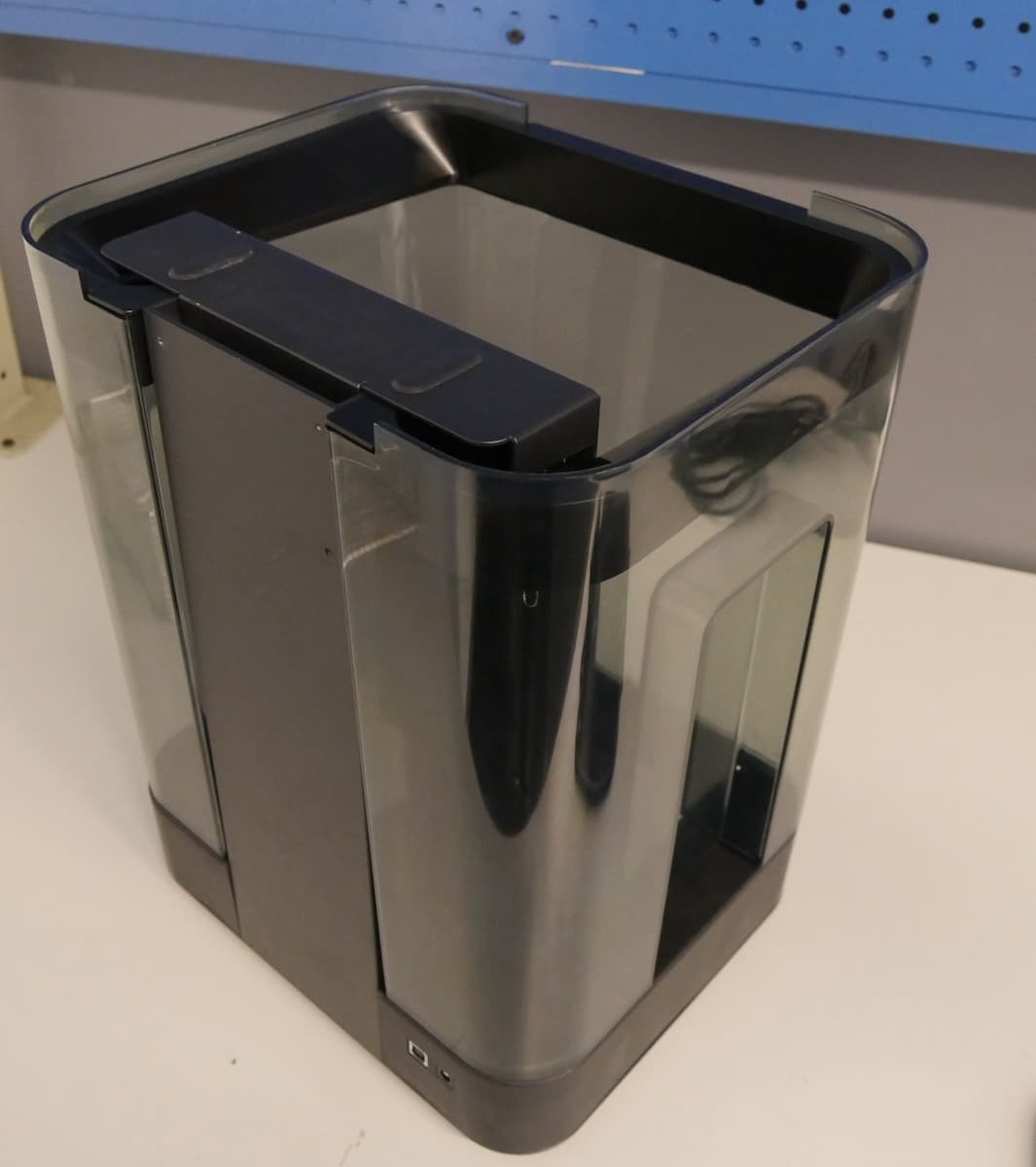

Step 2: Rotate the unit
Rotate the Form Wash so that you can access the back of the machine. If necessary, lift the Form Wash by gripping its base, not the wash bucket.

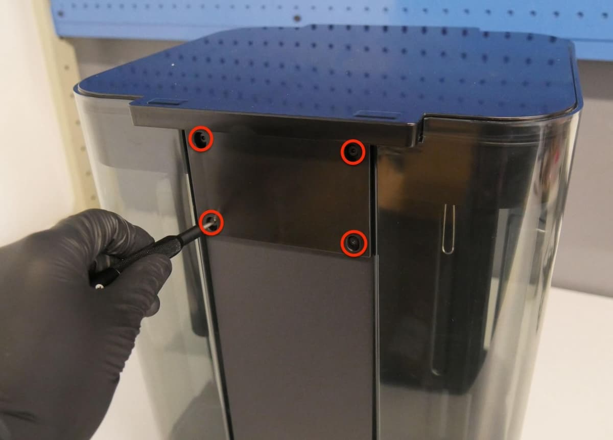

Step 1: Remove outer lid retention screws
The outer lid assembly is secured to the Form Wash with four screws. Using a 2 mm hex driver, remove the screws and set them aside.

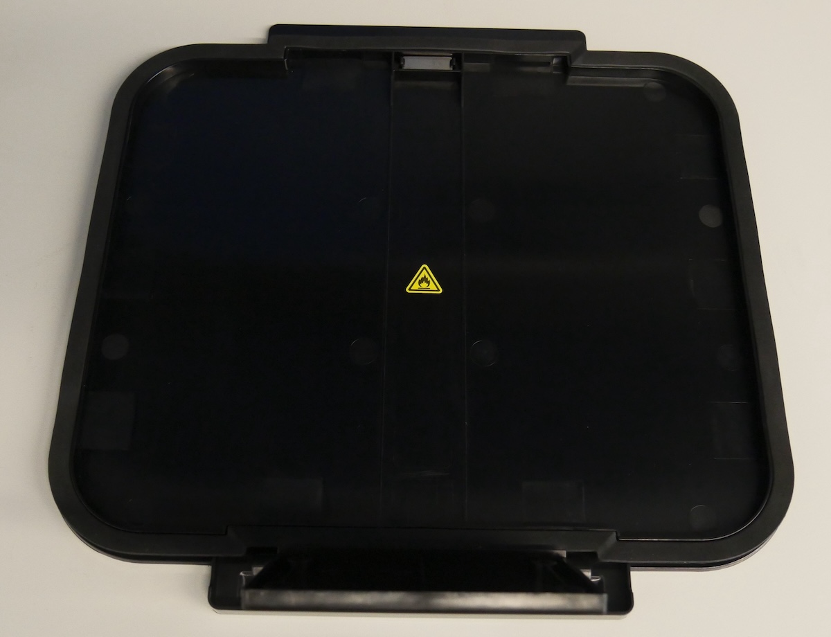

Step 2: Remove the outer lid assembly
Grip the outer lid assembly and lift it. The outer lid assembly should detach from the Form Wash without any resistance. Set the outer lid assembly aside for disposal.

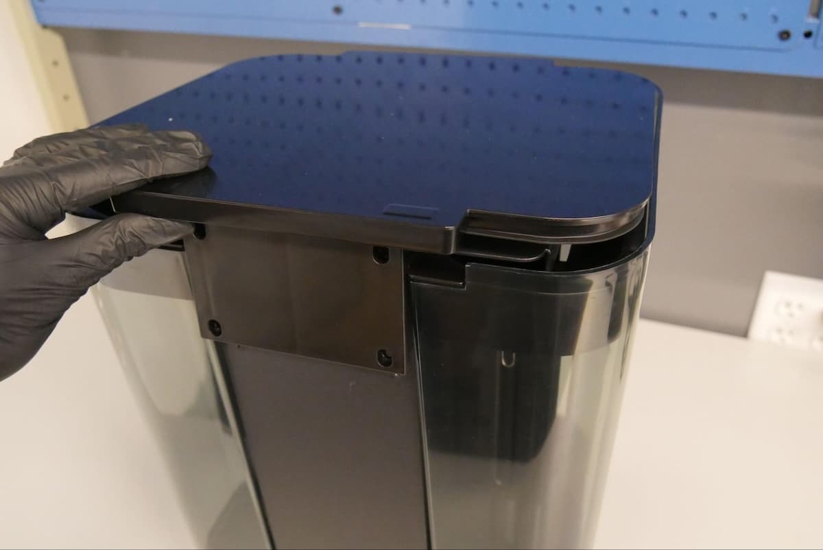

Step 1: Install the outer lid assembly
Place the replacement display assembly on top of the wash bucket. The outer lid assembly is installed correctly when the four screw holes on the back of the unit align with the screw holes on the back of the machine. The assembly should fit on top of the wash bucket without any gaps or resistance.
