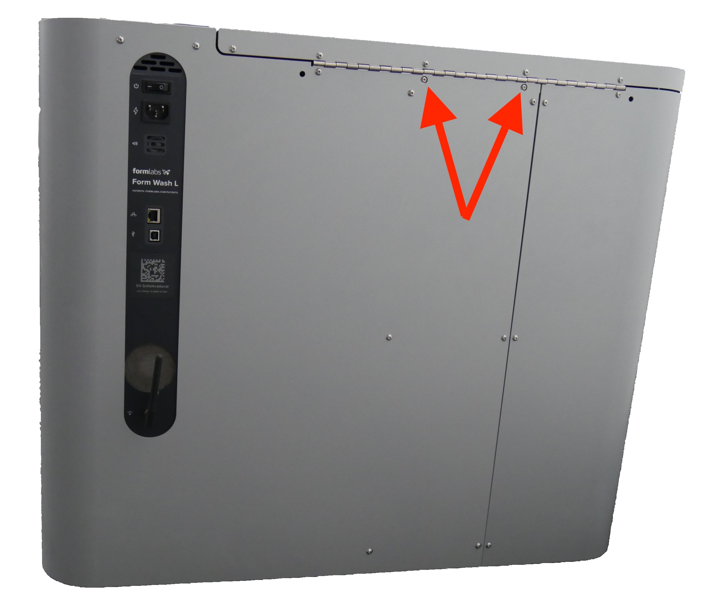

Use the 2.5 mm hex driver to loosen and remove the 12 screws holding the right shell to the frame of the Form Wash L. Three countersunk screws are located on the right side of the machine and nine button head screws are located on the rear. Set the screws aside.
Form Wash L lid screws
NOTICE:
There are two screws, accessible through cutouts in the right shell, that secure the lid to the frame of the machine. Do not remove these screws during this procedure.

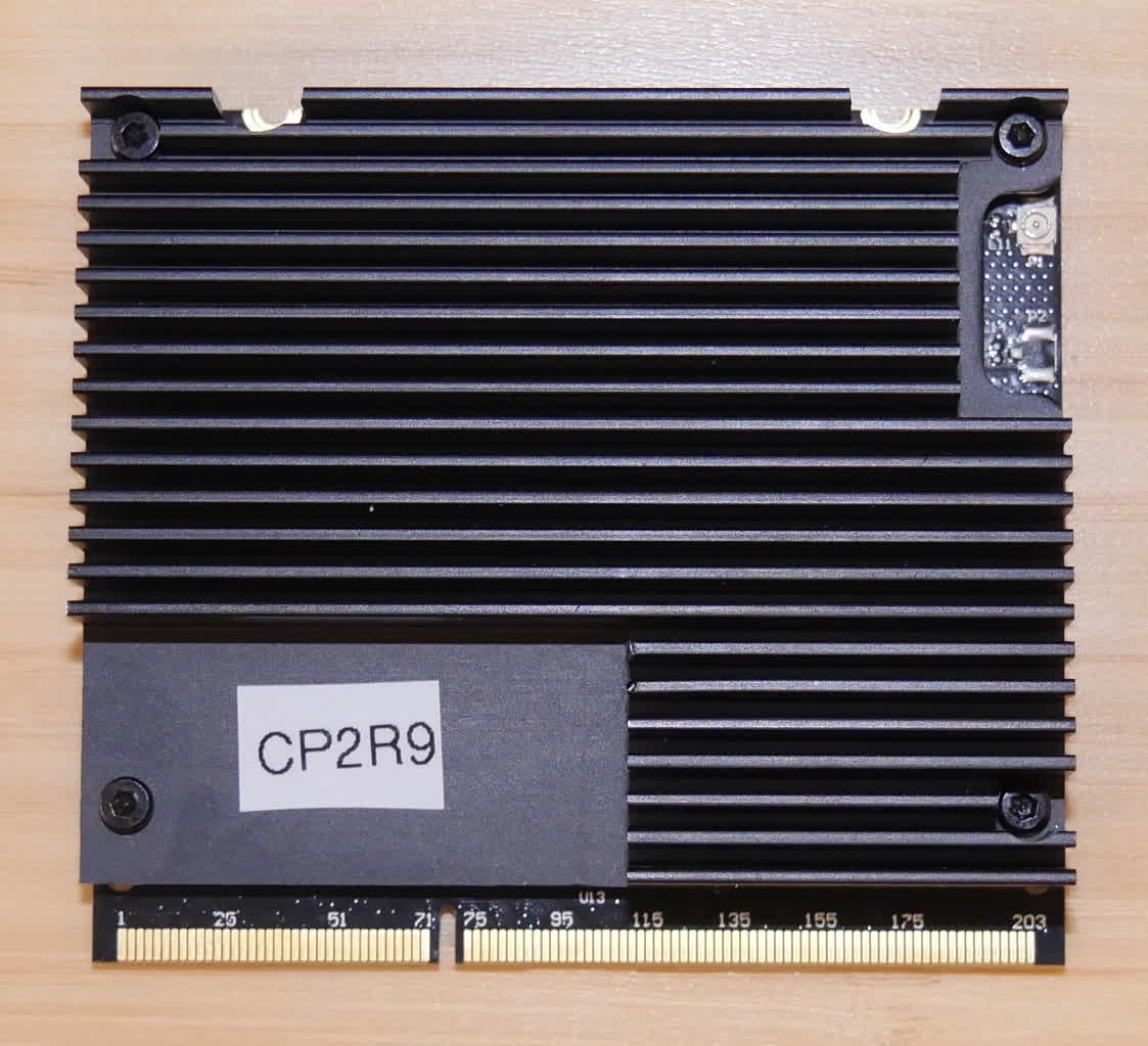

The Wi-Fi antenna is plugged into the SOM at the top-right corner of the board. The connector is accessible through a cutout in the heatsink. Grip the antenna’s connector by its housing and disconnect it from the SOM. Do not pull on the antenna itself.
Step 2: Unscrew the SOM retention screws
The SOM is plugged into the motherboard and secured with two screws on the top side of the module. Using a 1.3 mm hex driver, loosen and remove two SOM retention screws. Set the screws aside.

The SOM is additionally secured via two latches: one on the left side of the board and one on the right. Using fingernails or a small flat-blade screwdriver, open the two latches securing the SOM into its socket. The SOM may tilt forward once you have opened both latches.
