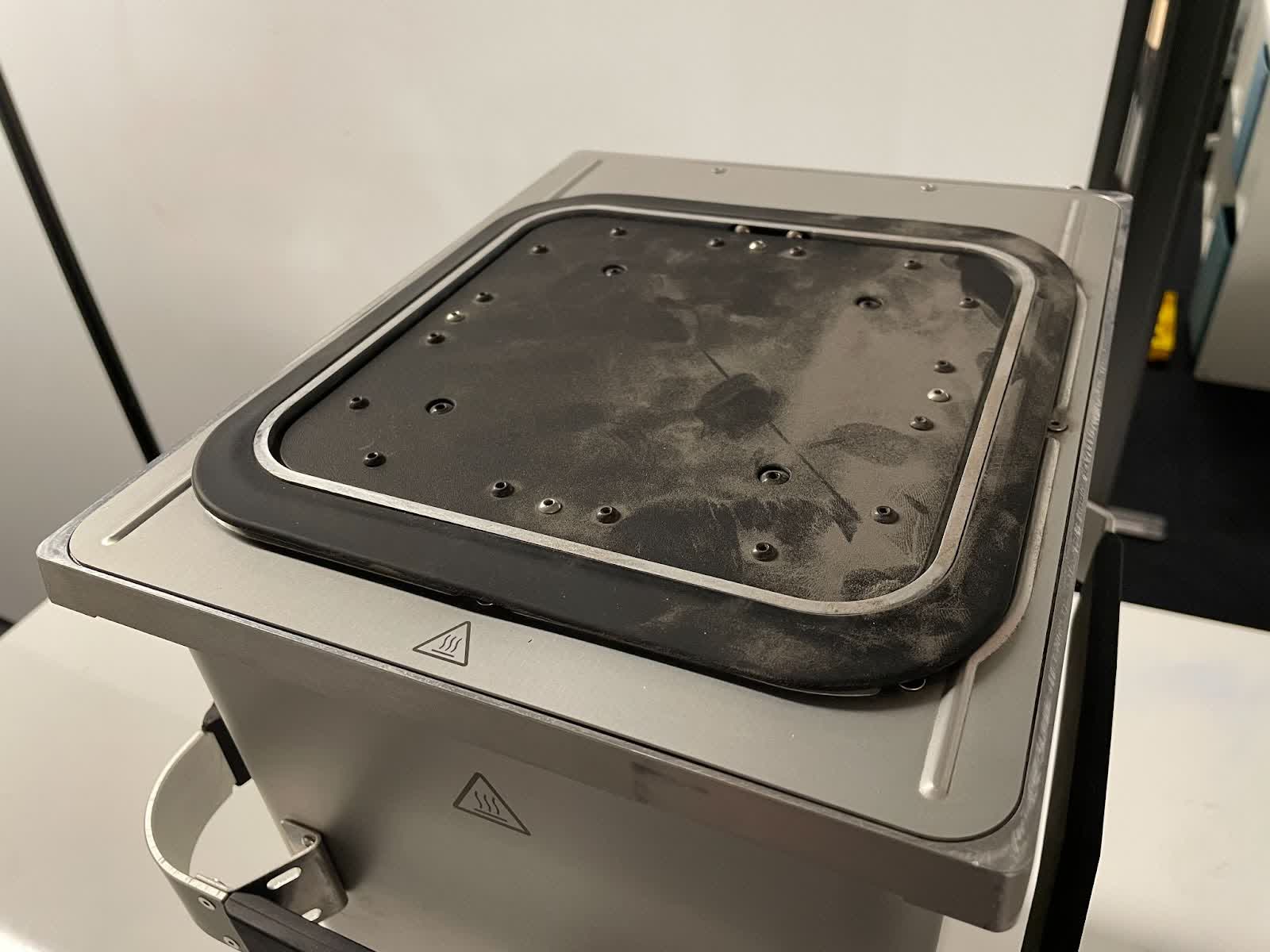

Removing the build chamber print bed
Overview: Remove the print bed from the build chamber.

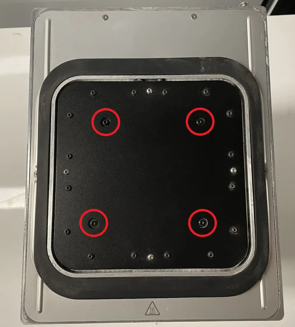

Step 1: Remove the build chamber print bed screws
Using a 2.5 mm hex driver, loosen and remove the four M4 × 12 mm button head screws securing the build chamber print bed to the build chamber piston.

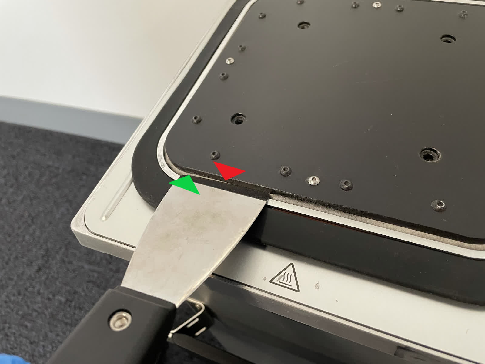

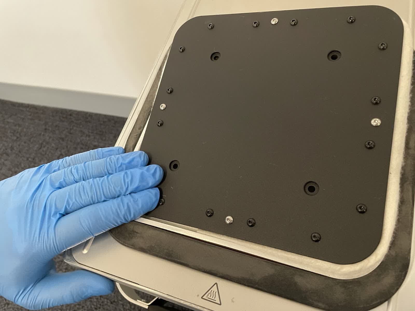

Step 2: Lever the print bed upwards
Carefully wedge the putty knife into the gap between bottom of the print bed and the white felt seal. Gently lift the edge of the print bed upward.
Fuse 1 generation build chamber print bed screws
Removing the Fuse 1 generation build chamber print bed
CAUTION:
Do not force the putty knife into the gap. Do not use a slotted screwdriver or other narrow tool. Either method can damage the inner build chamber wall.

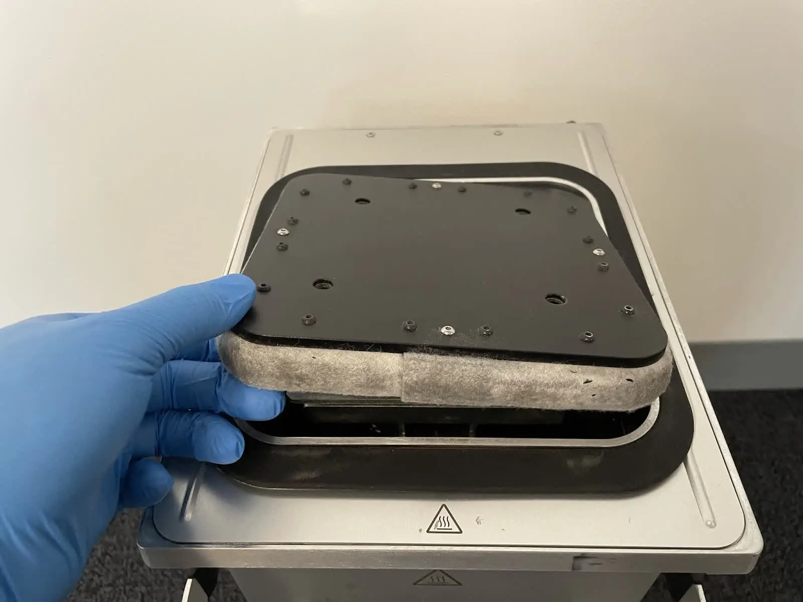

Step 3: Rotate the build chamber
Rotate the entire build chamber 90°.
Step 4: Repeat steps 2 and 3 for each side
Repeat steps 2 and 3 on each side of the print bed. carefully wedge the putty knife into the gap between the print bed and the felt seal, gently lift the print bed up, and rotate the build chamber until the print bed can be lifted off the build chamber.
Step 5: Remove the print bed
Remove the print bed from the build chamber. Set the print bed aside.

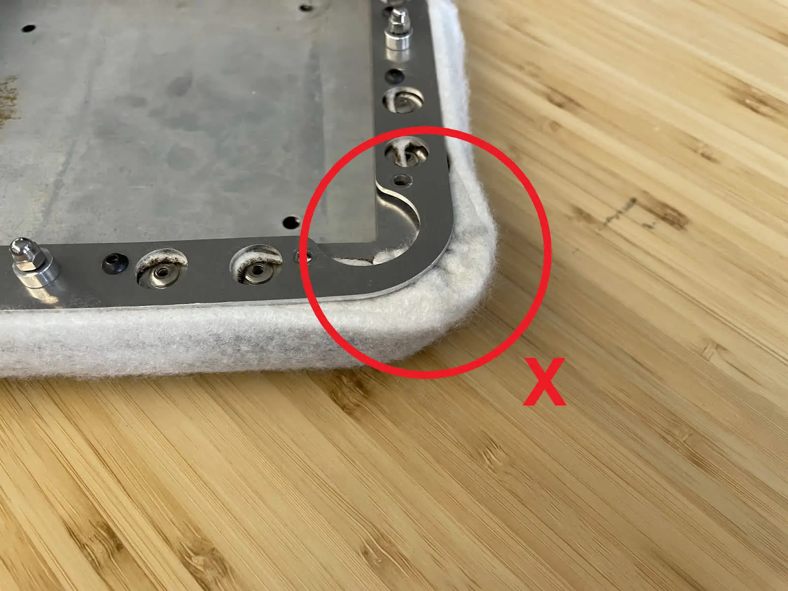

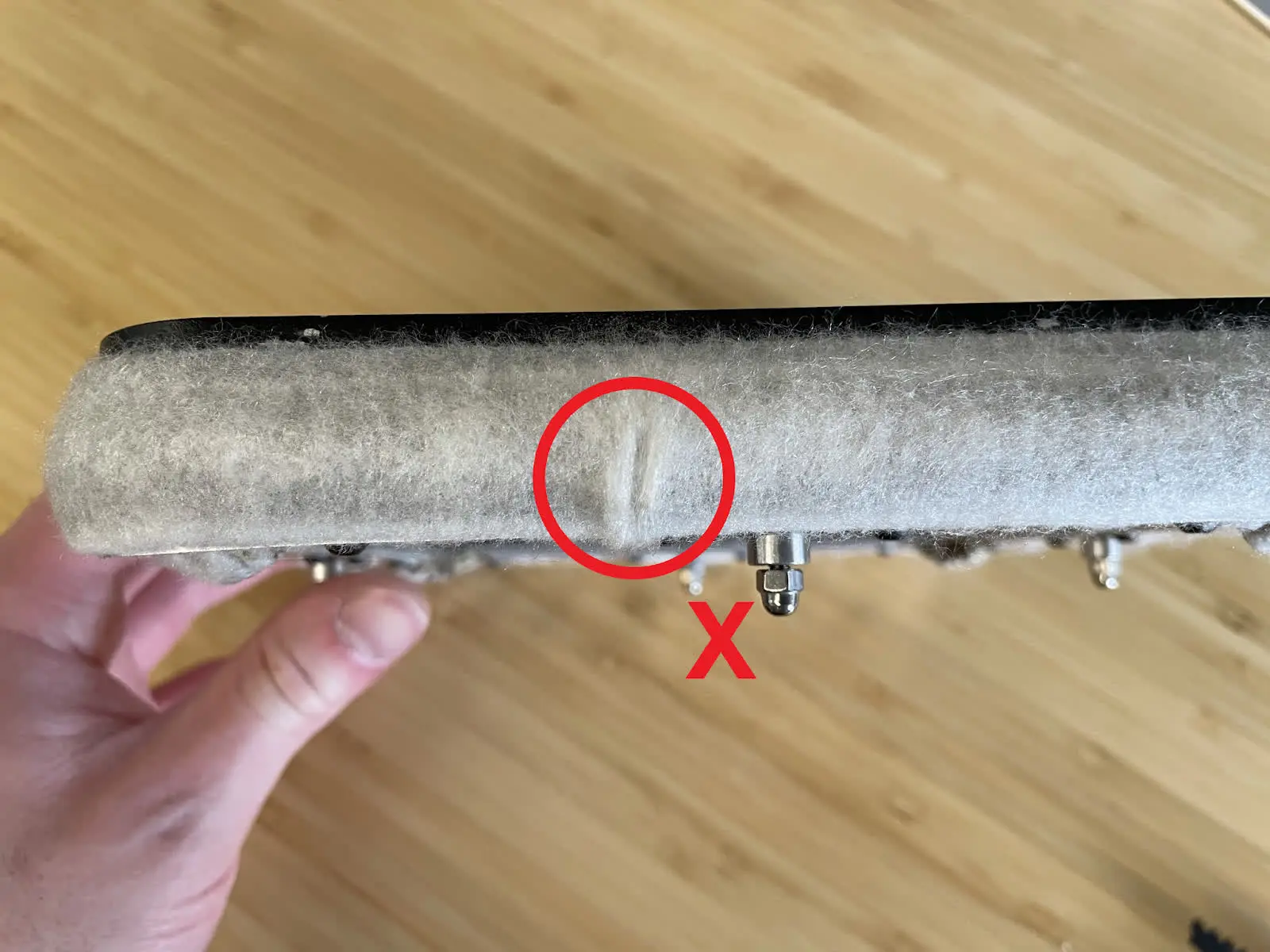

Step 1: Inspect the new build chamber print bed felt seal
Inspecting the print bed
Inspect the build chamber print bed felt seal for any cuts or tears. Ensure that it is properly secured to the print bed.
NOTICE:
Do not use the replacement print bed if the felt seal is damaged or detached from the assembly. Contact Formlabs Support or your certified service provider if the replacement print bed felt seal is damaged or detached from the assembly.

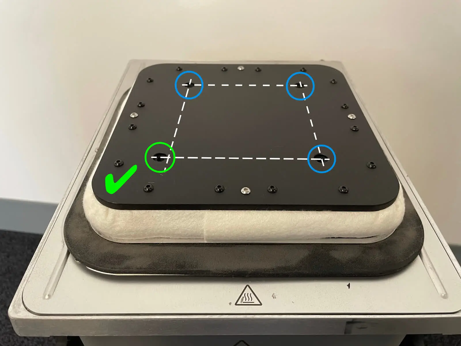

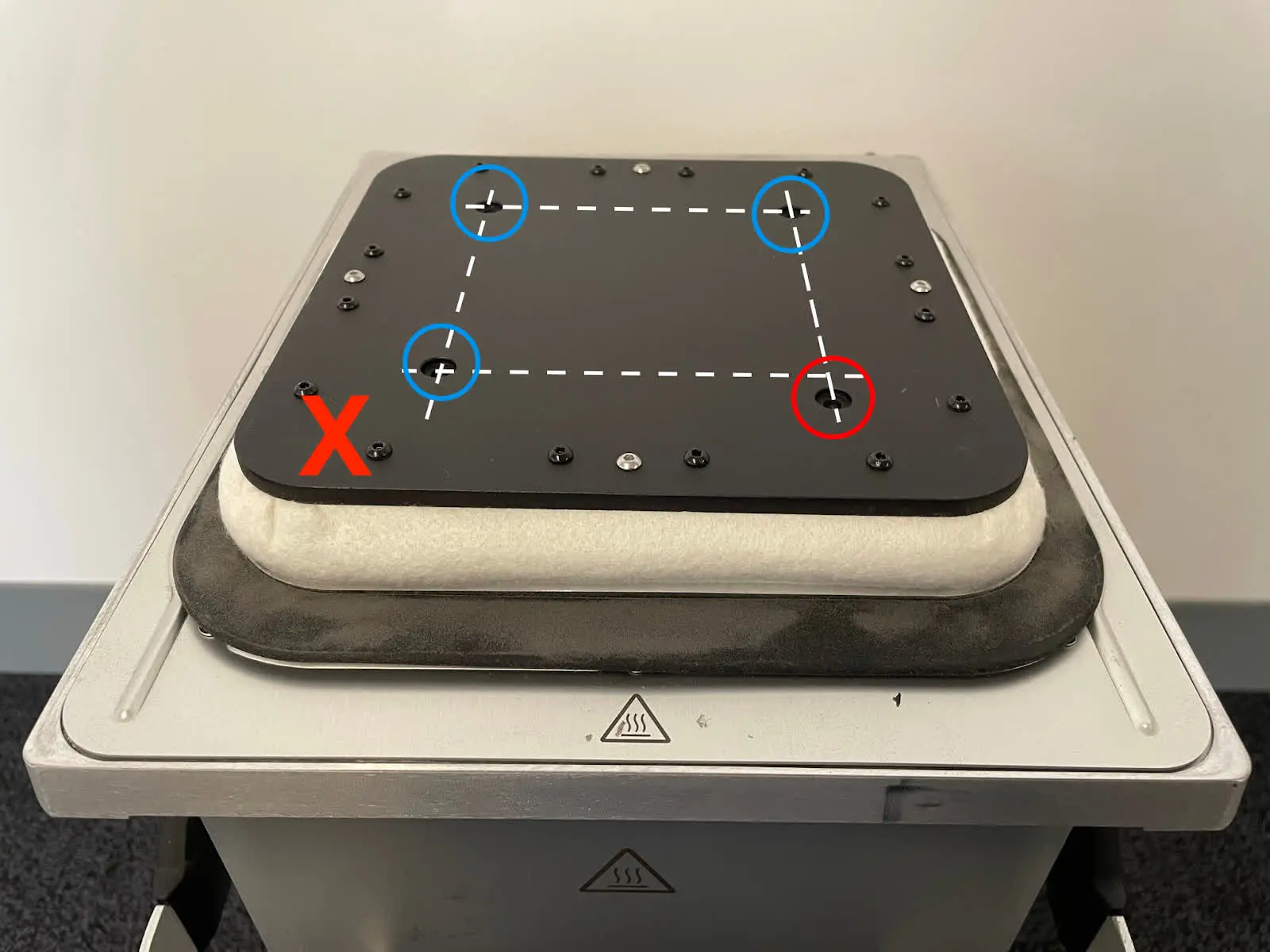

Step 2: Place the new print bed on the build chamber piston top
Correct print bed orientation
Incorrect print bed orientation
Place the new print bed on the build chamber piston top. Take care to orient the print bed correctly. The only offset screw hole should be located in the front-left corner of the build chamber.

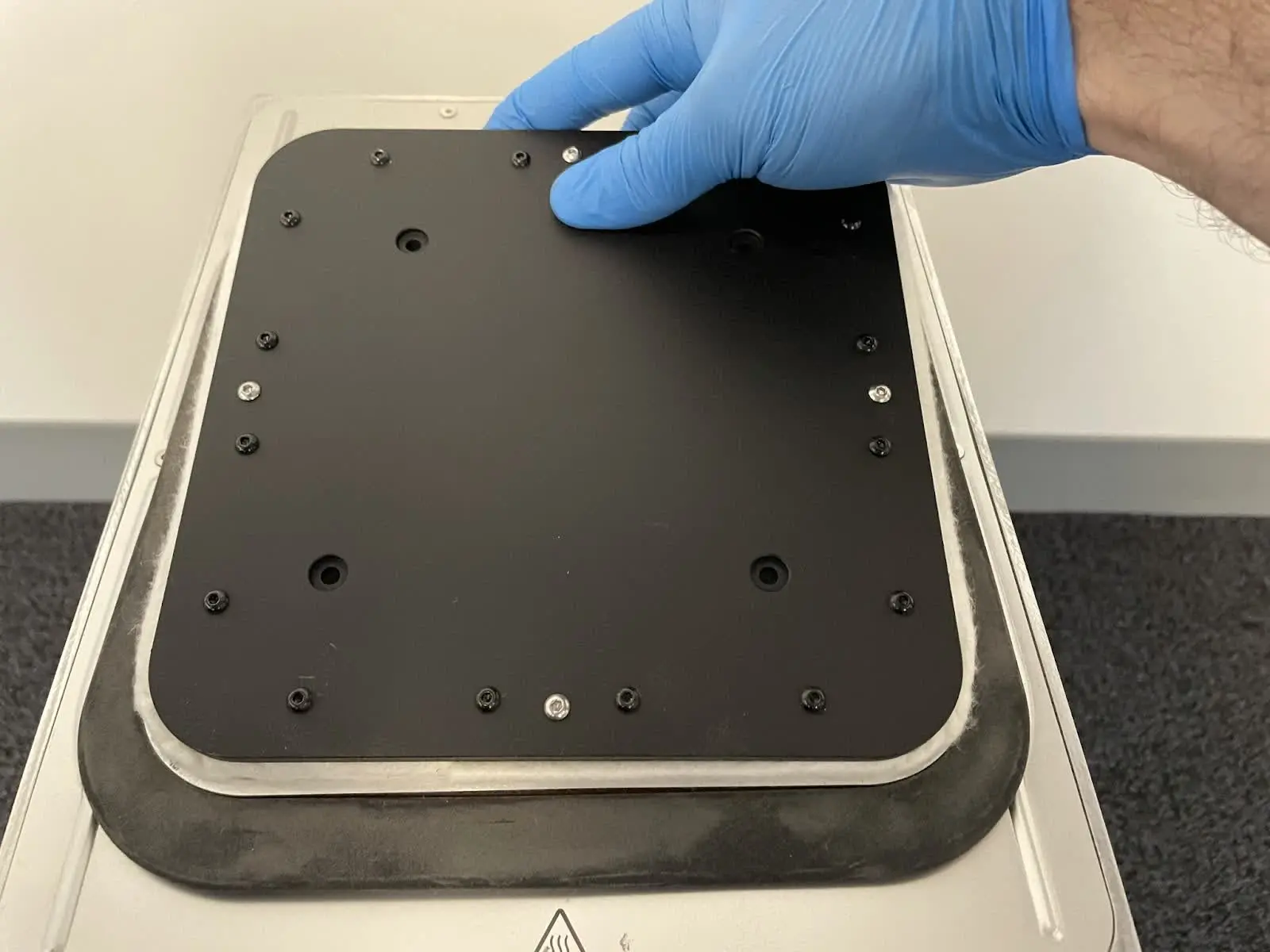

Step 3: Press the print bed into place
Pressing the print bed into place
Firmly press the print bed into the build chamber by pushing down on each corner one at a time.

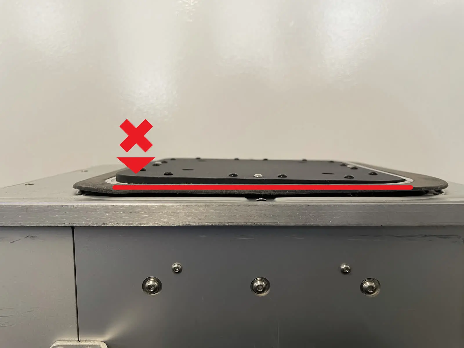

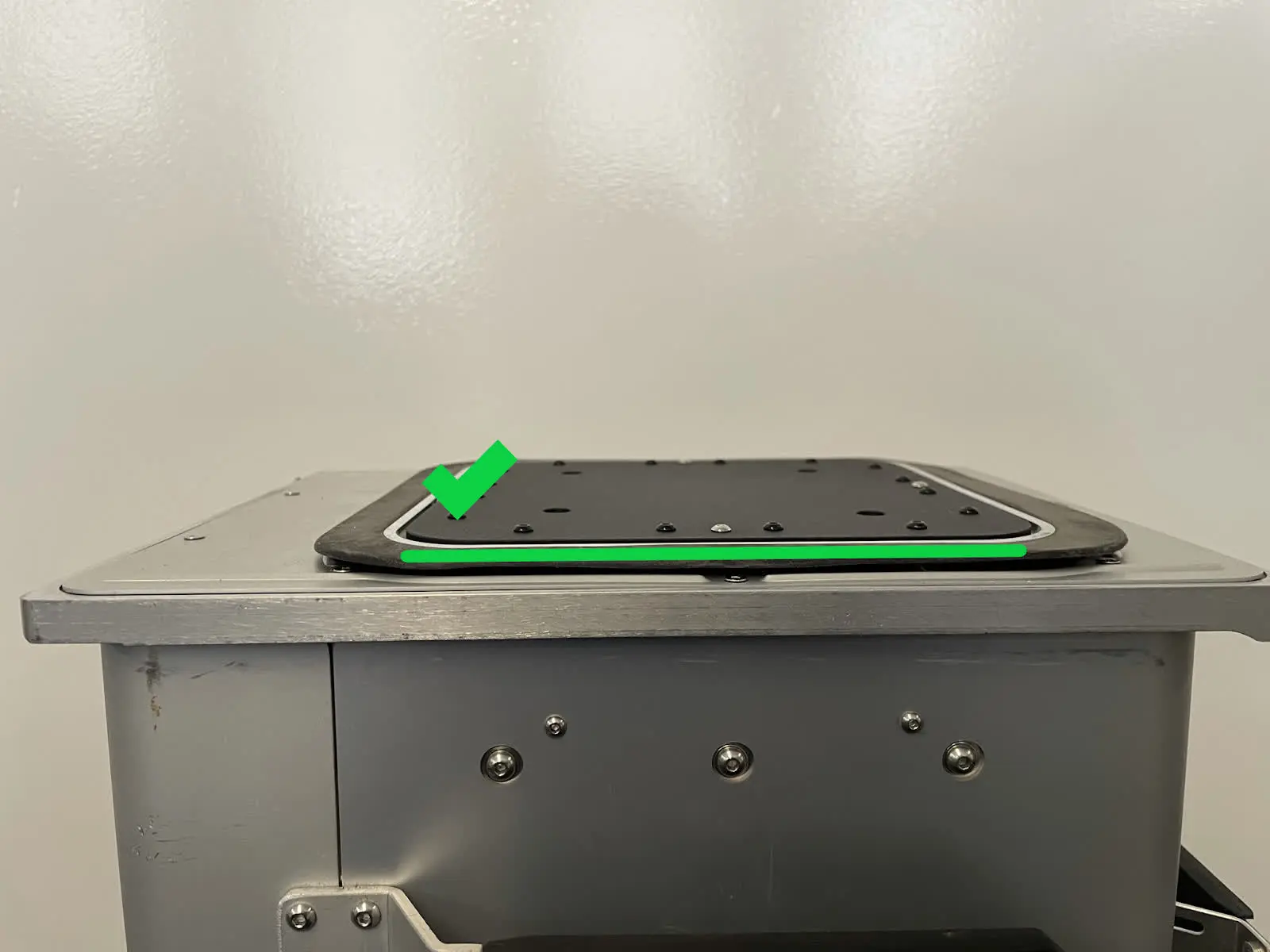

Step 4: Inspect the print bed
Inspecting the print bed installation
Inspect the print bed to ensure that it is flush to the top of the build chamber. If the print bed is not flush with the build chamber, firmly press down each corner of the print bed until it is properly aligned.
