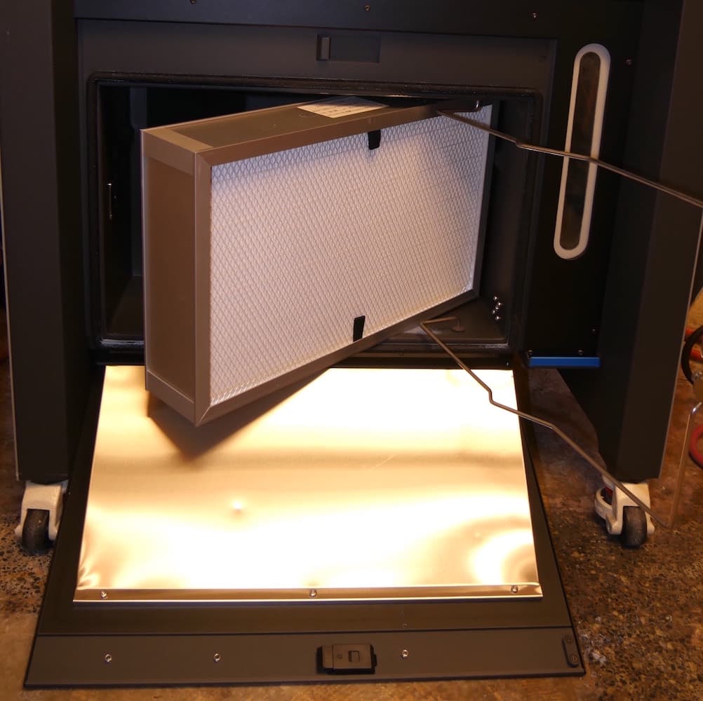

  1. Unlatch the HEPA filter door at the bottom front of the Fuse Blast.
Fuse Blast HEPA filter door open
  1. Unlatch the wire retainer and swing it outward.
Unlatching the wire retainer on the Fuse Blast HEPA filter
  1. Remove the HEPA filter from behind the wire retainer.
Removing the Fuse Blast HEPA filter
  1. Dispose of the used HEPA filter.
  2. Install the new HEPA filter by inserting it behind the wire retainer with the pull tabs facing out. Ensure that the filter is fully and evenly seated in its housing.
  3. Swing the wire retainer inward and latch it.
