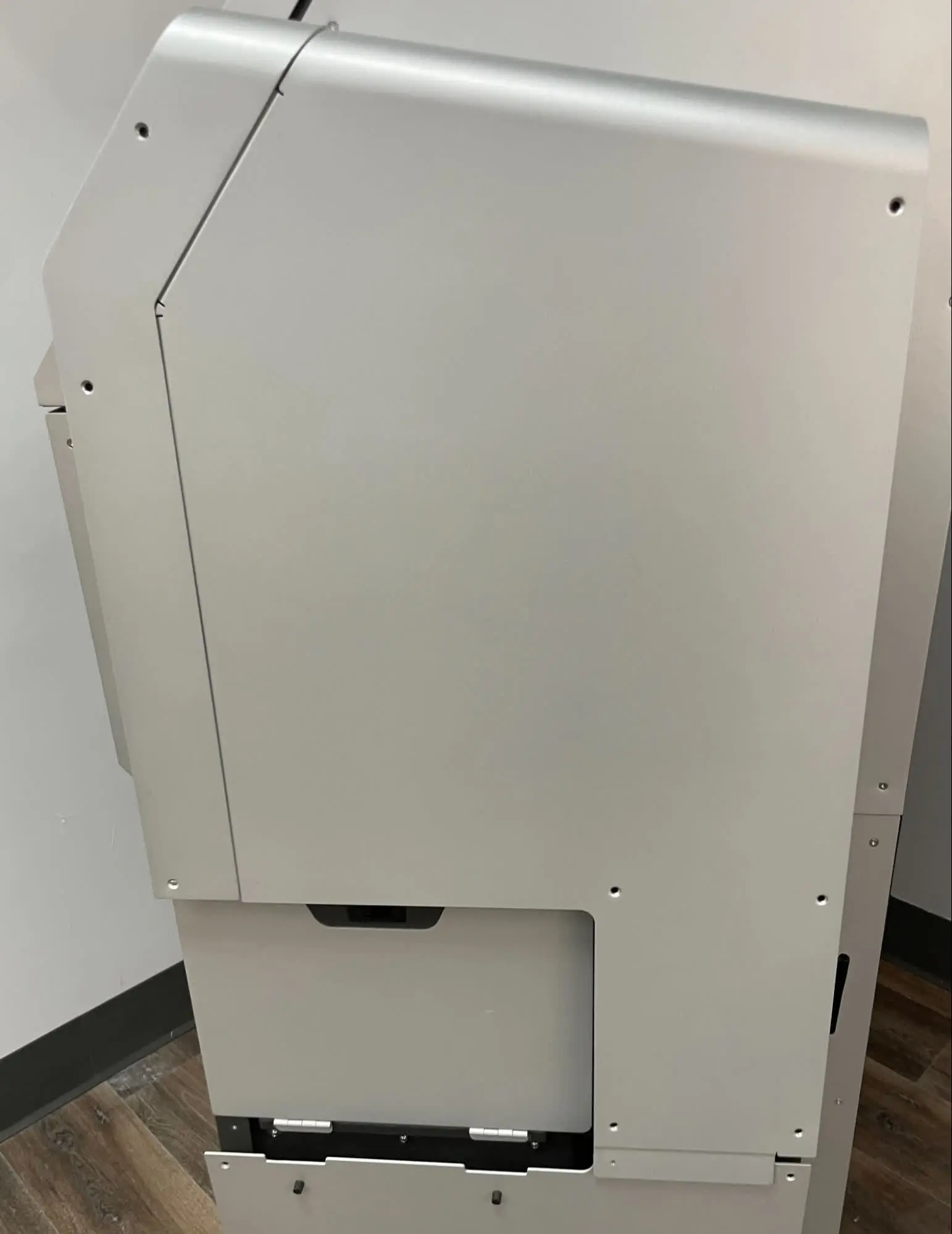

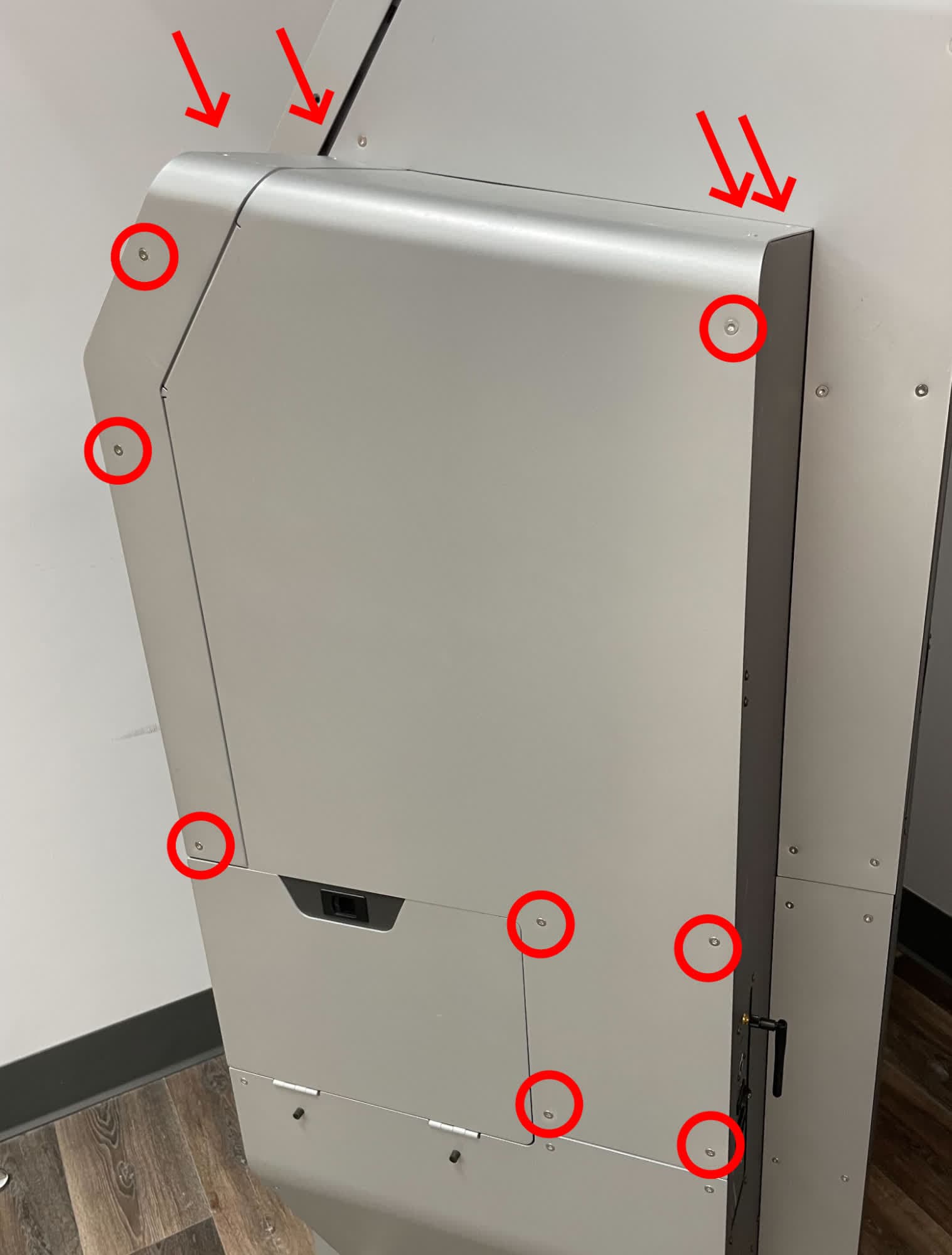

Step 1: Remove the upper sidecar panel retention screws
The air metering valve is located in the sidecar on the right side of the machine. Using a T20 Torx driver, loosen and remove the 12 T20 Torx screws securing the upper sidecar panel to the Fuse Blast. Set the screws aside.

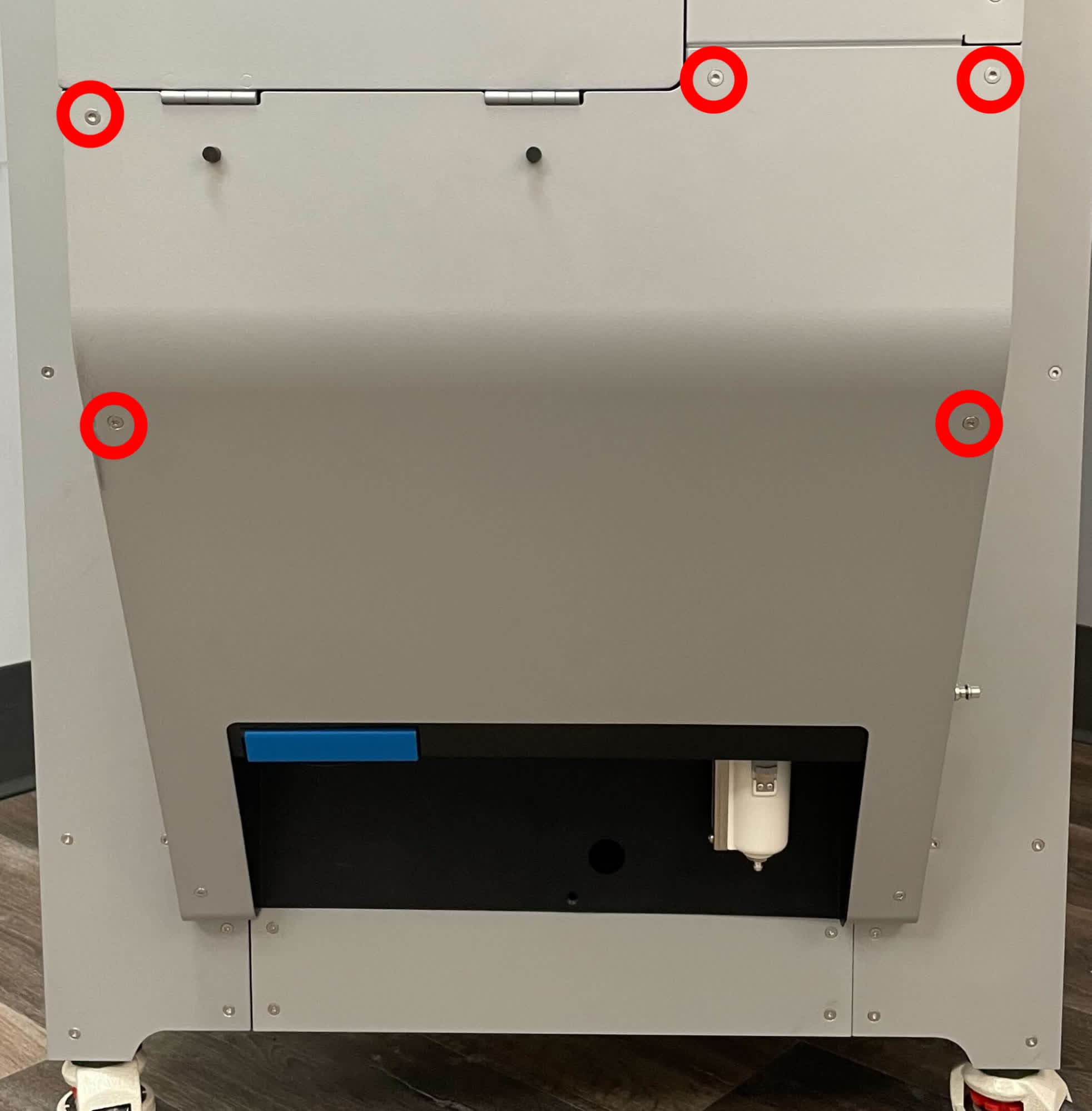

Step 2: Remove the lower sidecar panel retention screws

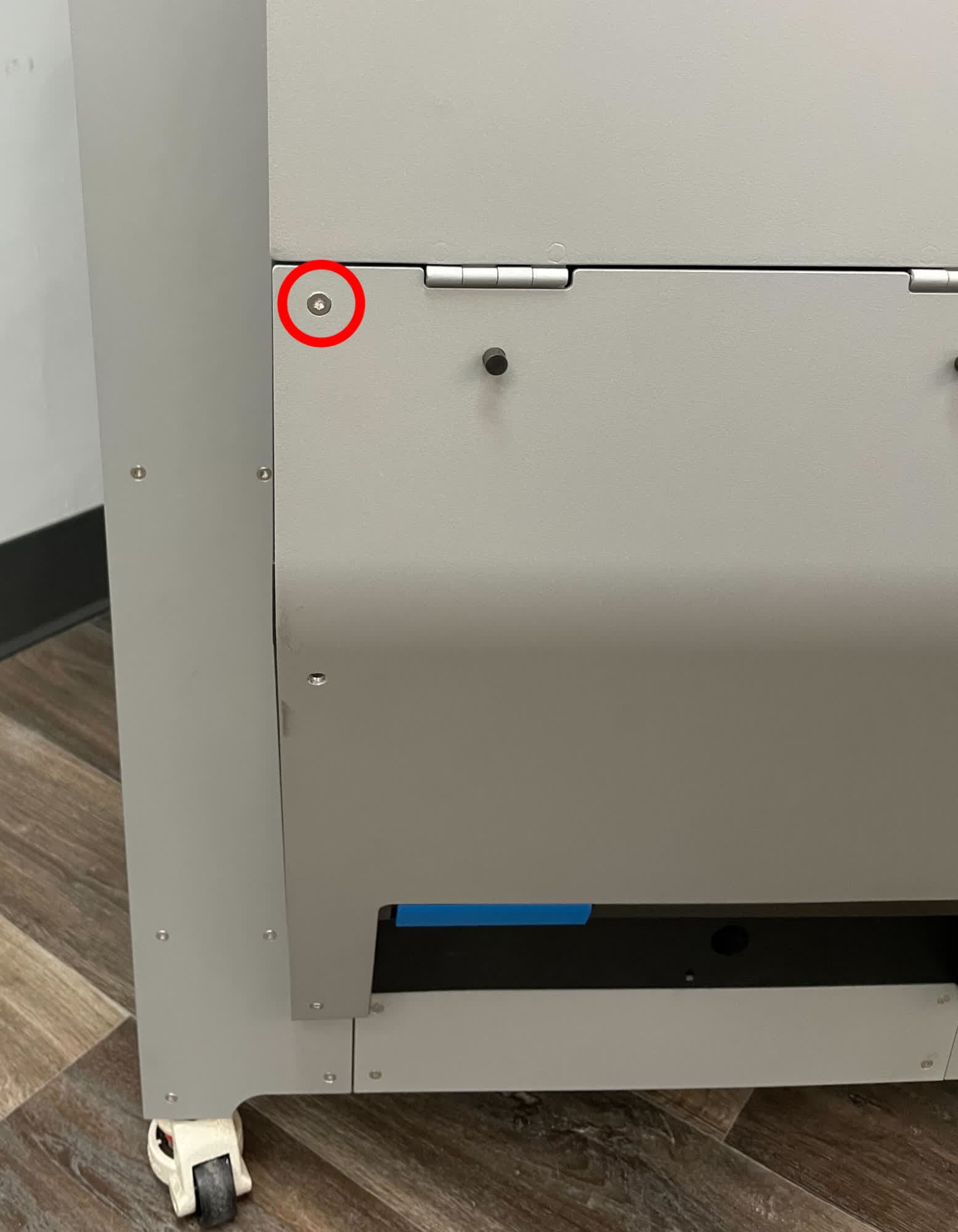

The lower sidecar panel must be moved slightly to free the upper sidecar panel. Using a T20 Torx driver, loosen and remove the five T20 Torx screws shown above. Set the screws aside. Do not remove the two screws at the bottom of the lower sidecar panel.

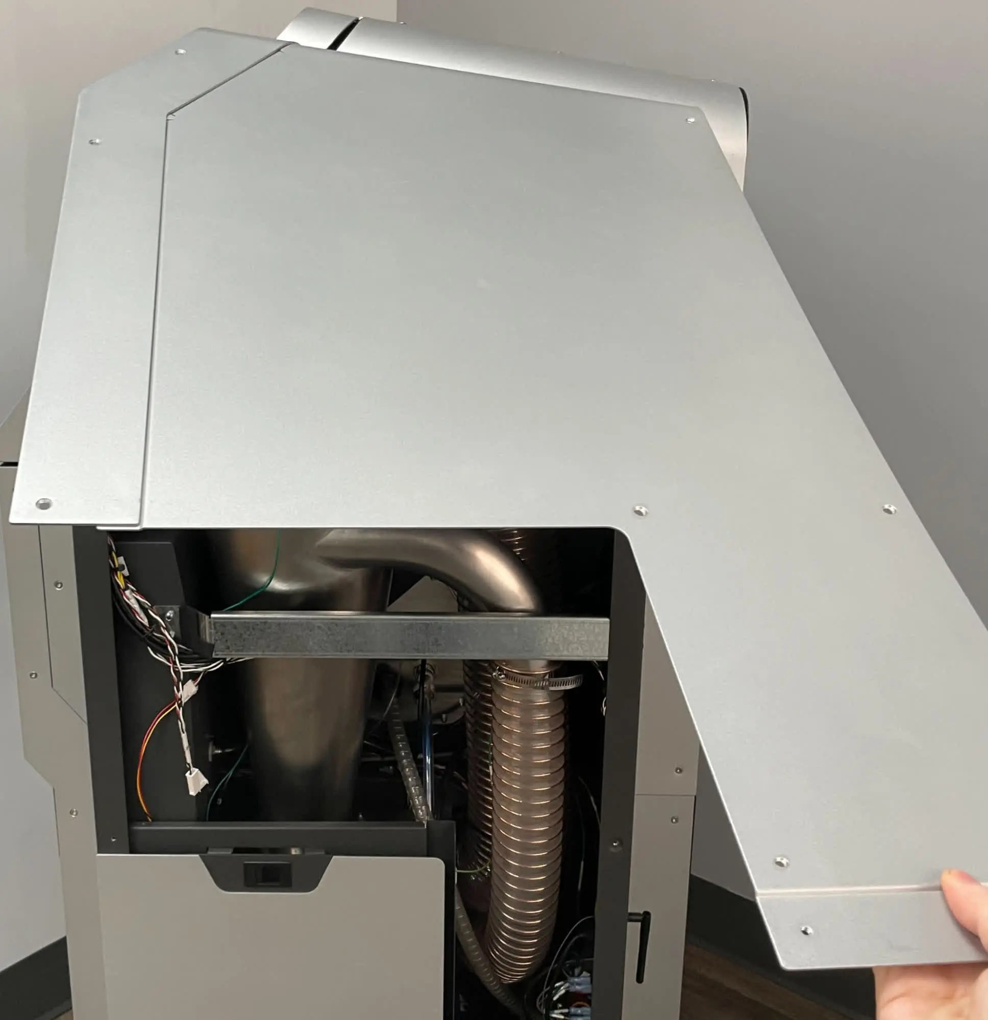

Step 3: Remove the upper sidecar panel

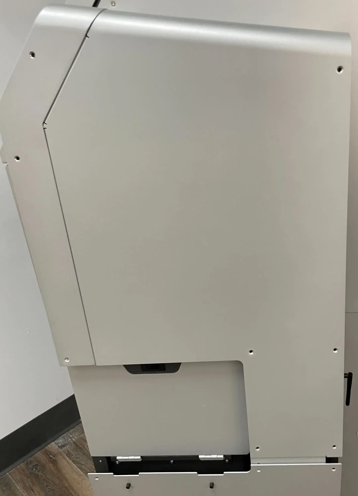

Untuck the bottom of the upper sidebar panel from behind the lower sidecar panel. Rotate the panel upwards until it is horizontal. Once it is horizontal, pull forward to disengage it. Set the upper sidecar panel aside.

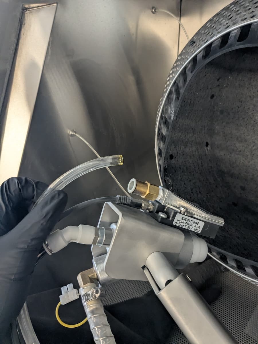

Step 1: Disconnect the part rinse tubing

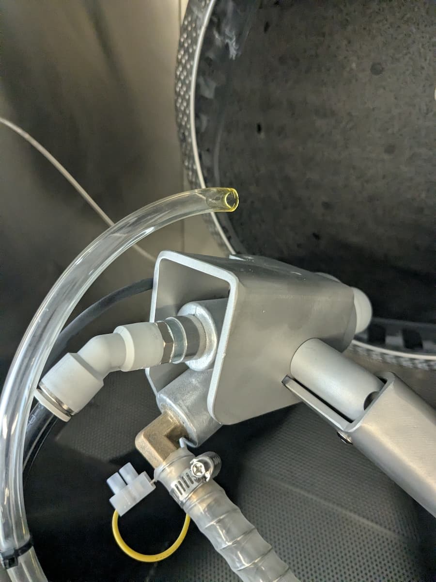

Open the blasting chamber door. Disconnect the part rinse tubing from the ionizer by pressing on the push-to-connect fitting and pulling out the tubing.
Step 2: Disconnect the ionizer cable from the ionizer

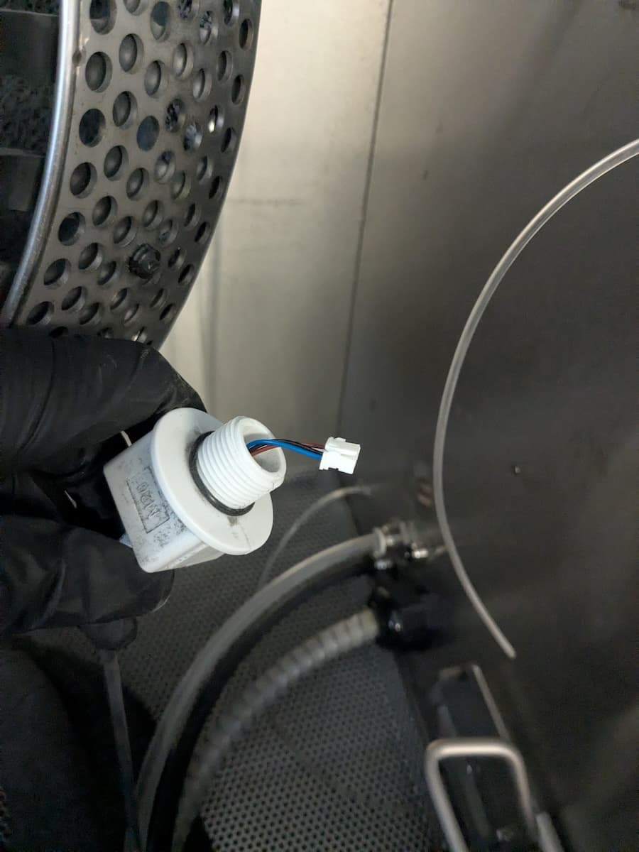

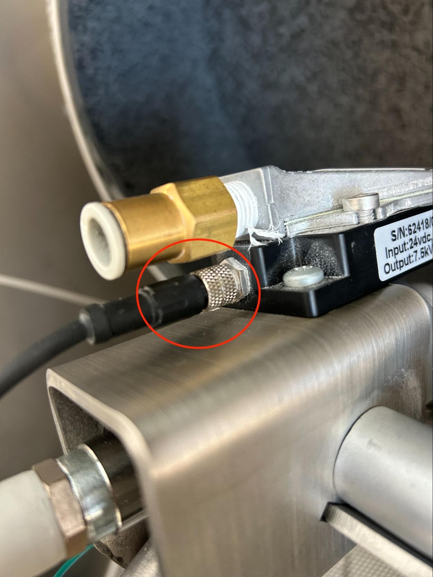

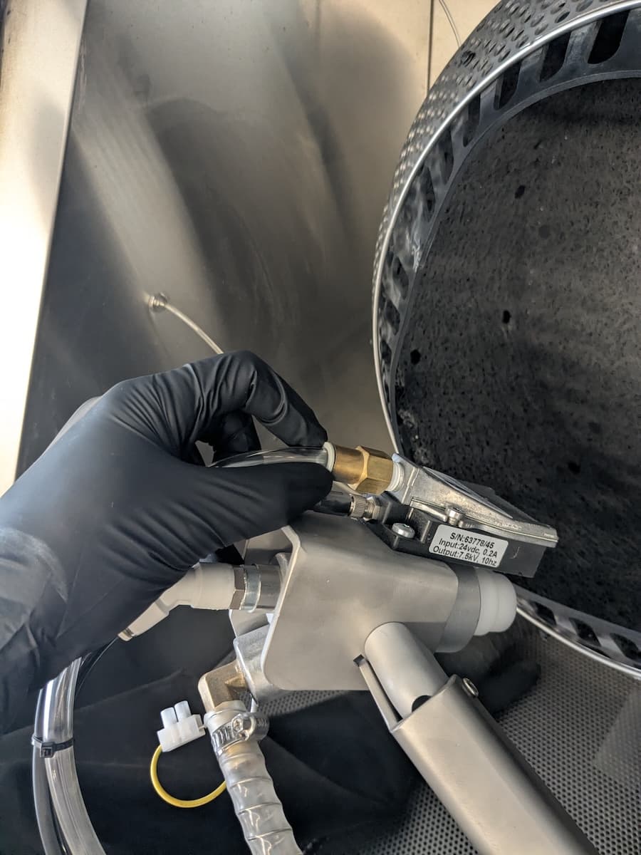

Disconnect the ionizer cable by unscrewing the threaded connector completely and pulling out the cable. It may be easier to access the threaded connector after separating the ionizer from the blast gun.

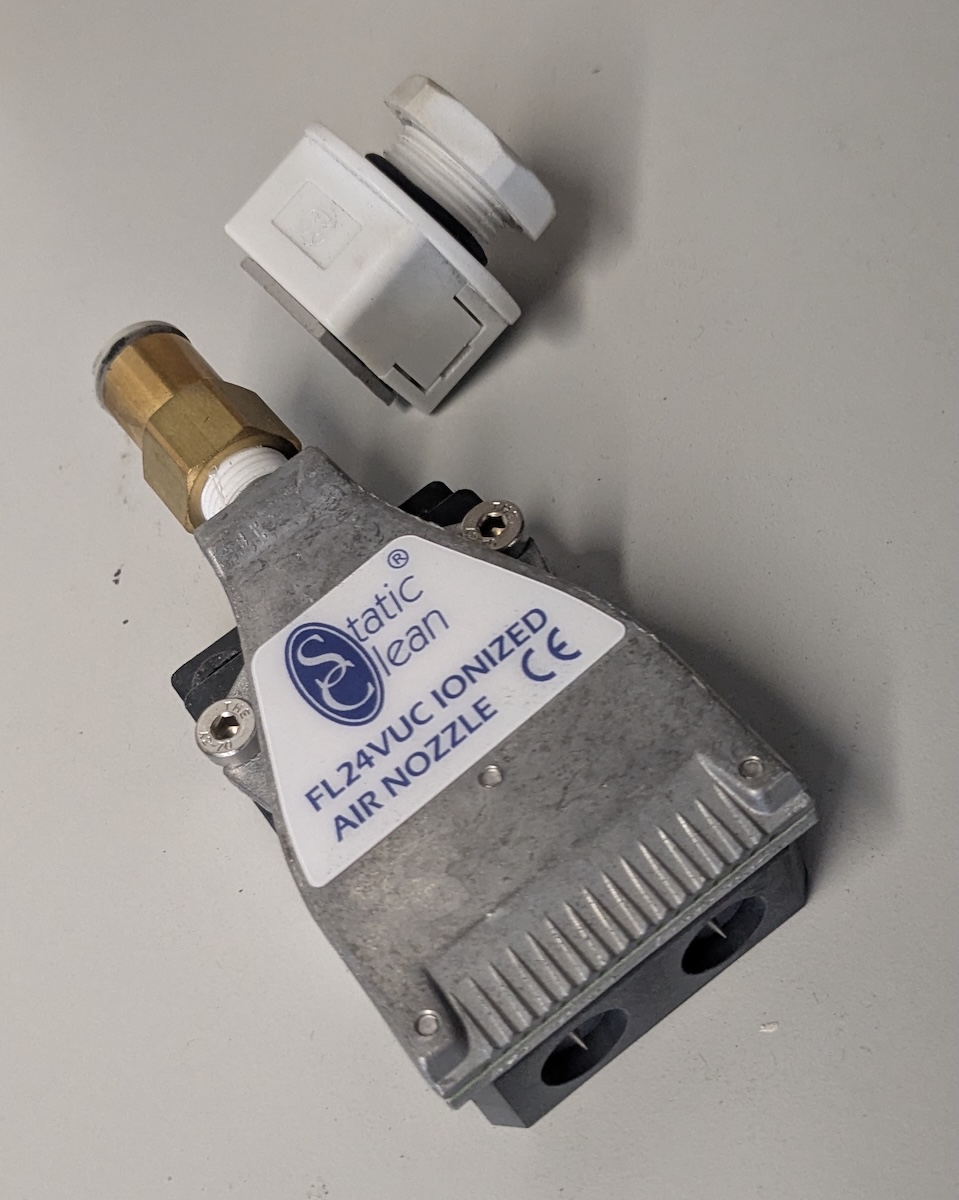

Step 3: Remove the ionizer

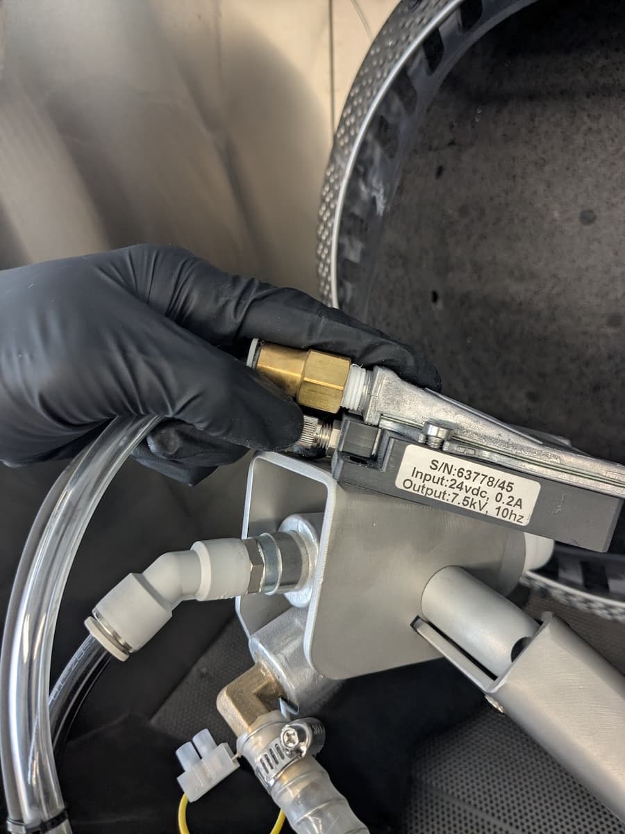

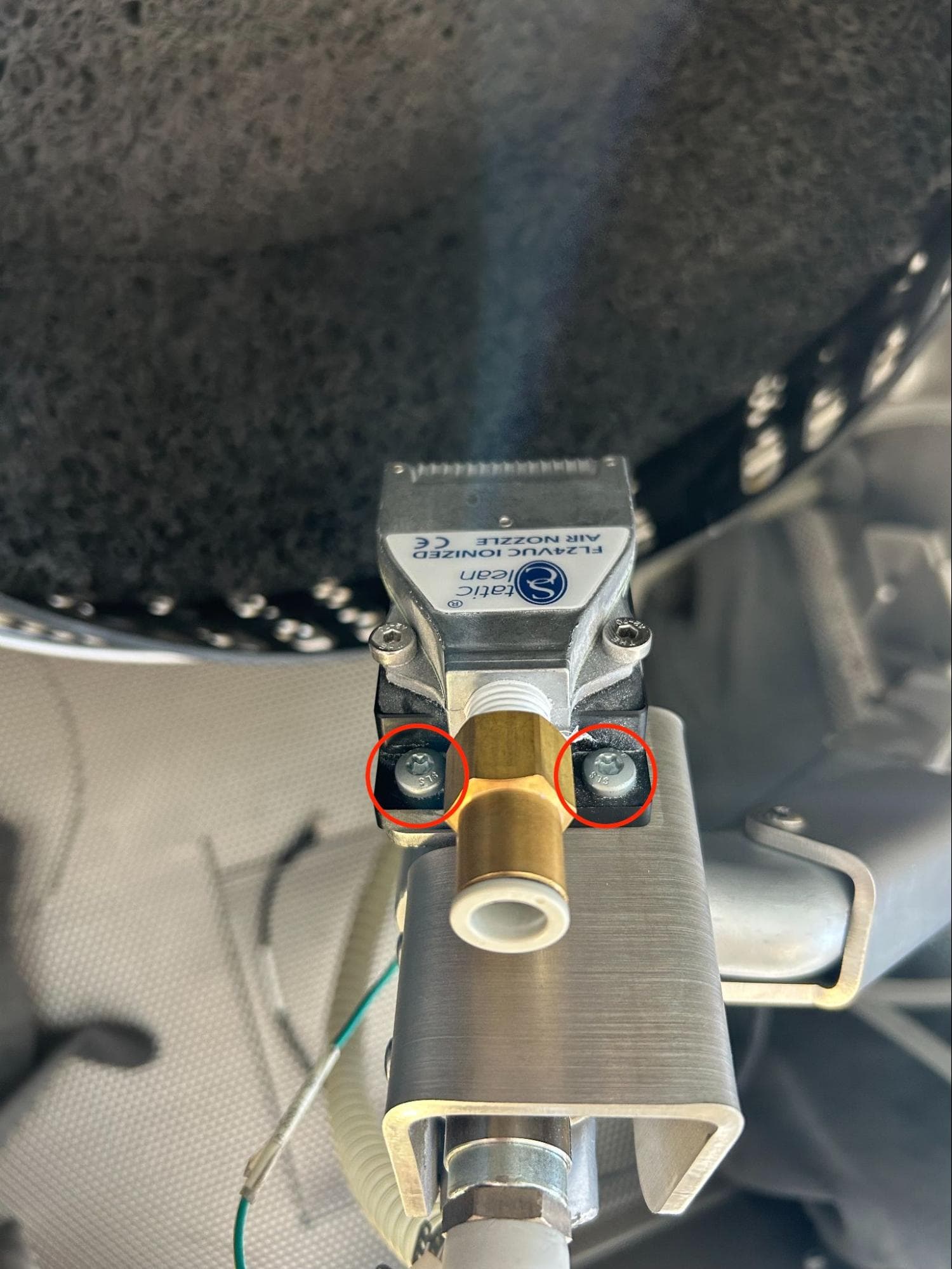

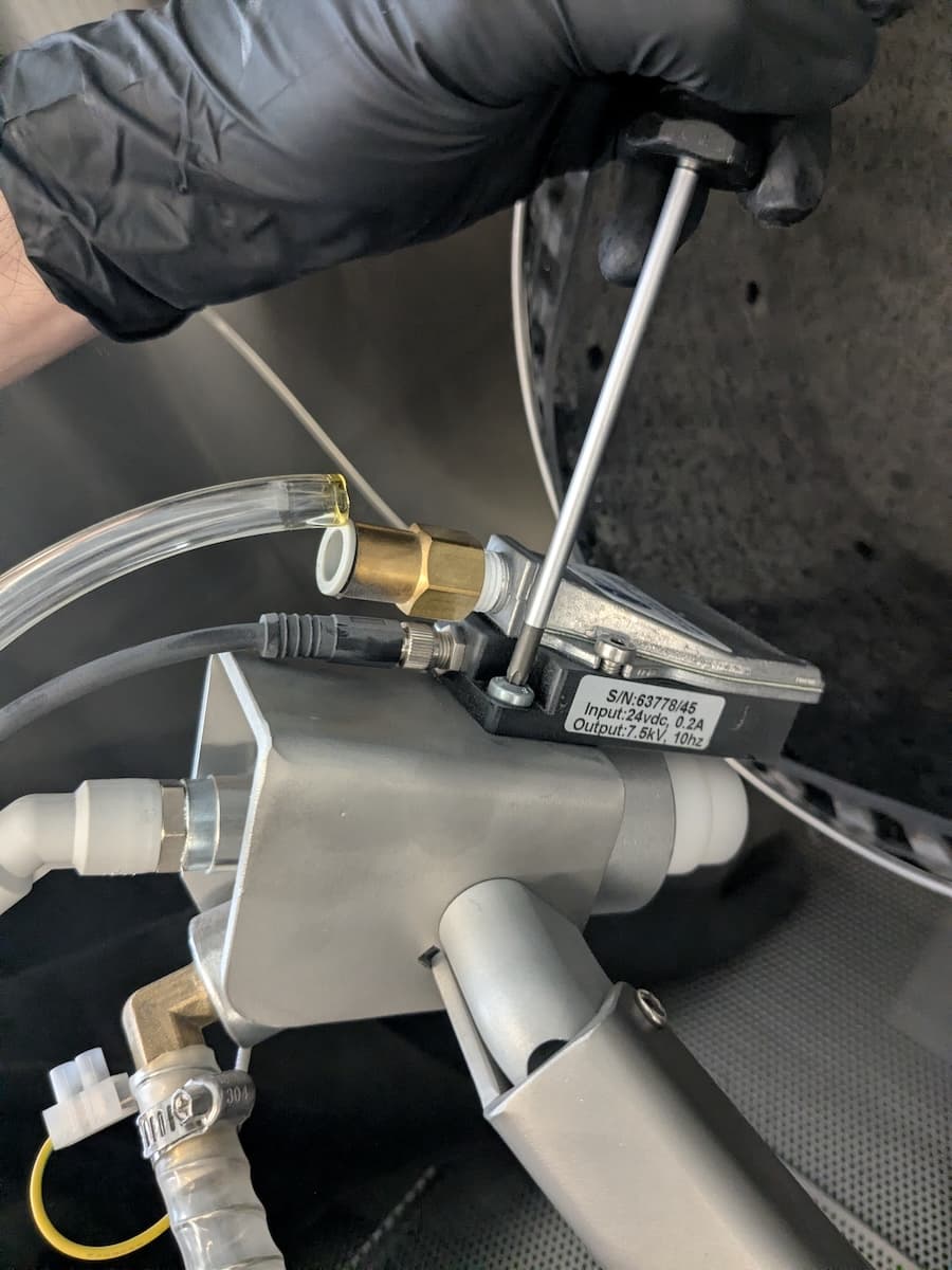

The ionizer is secured to the blast gun with two screws. Using a T25 Torx driver, loosen and remove the screws. Set the screws and ionizer aside for disposal with electronic waste.

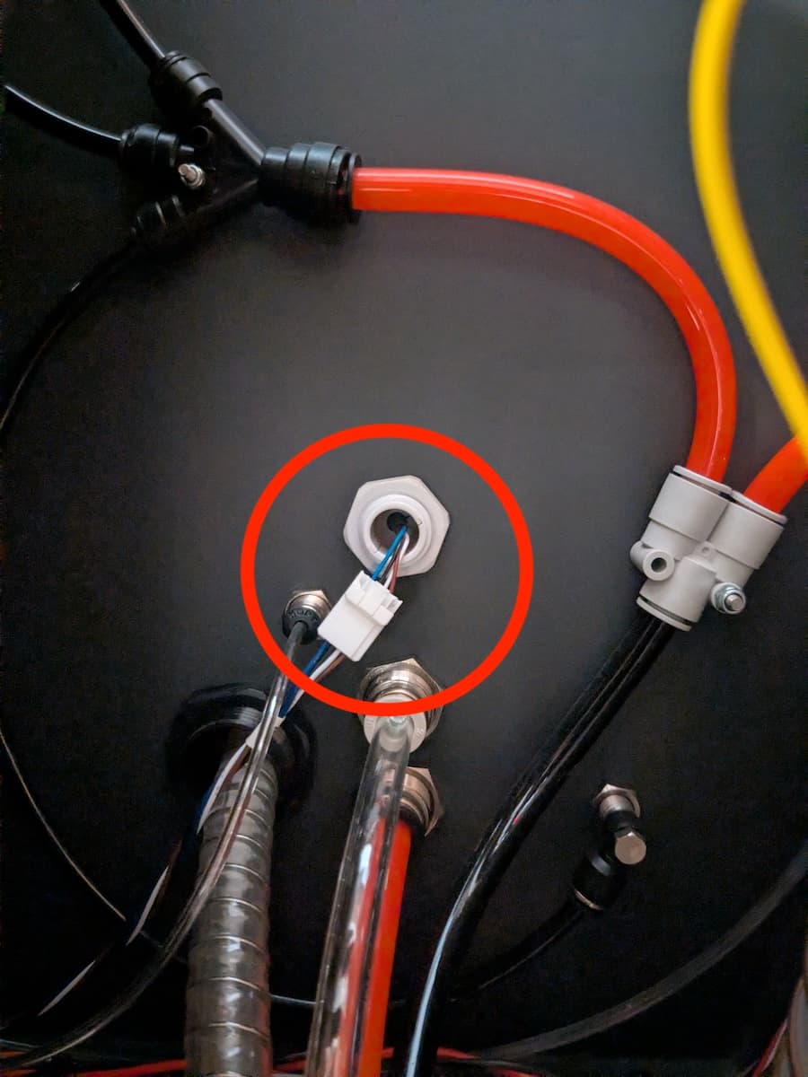

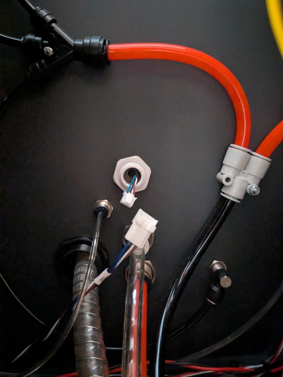

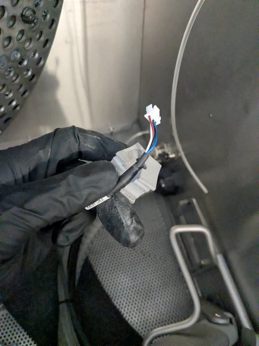

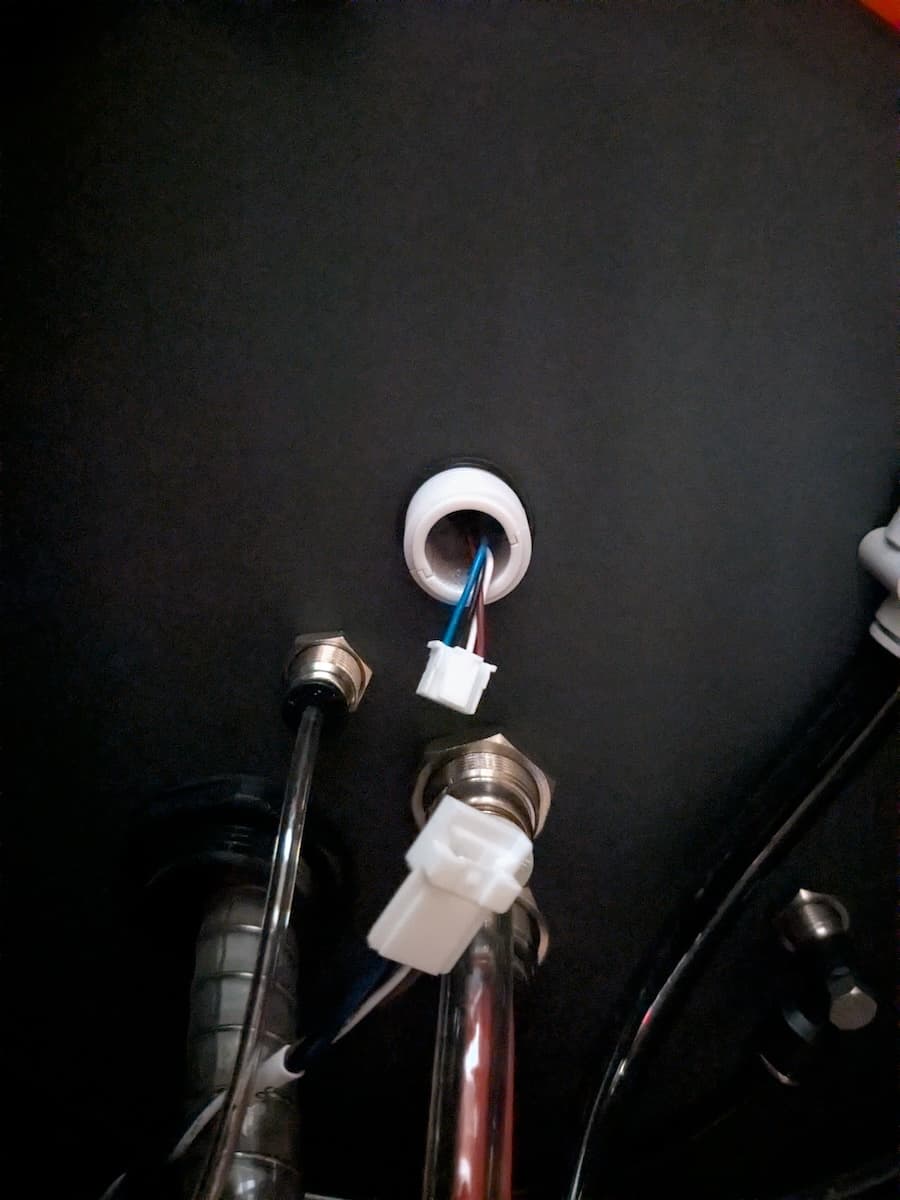

The ionizer cable passes through the right wall of the blasting chamber and connects to an extension cable, which in turn connects to the Fuse Blast motherboard. Follow the cable and locate the end behind the upper sidecar panel. Squeeze the clip and separate the cable connectors. Do not pull on the wires themselves.

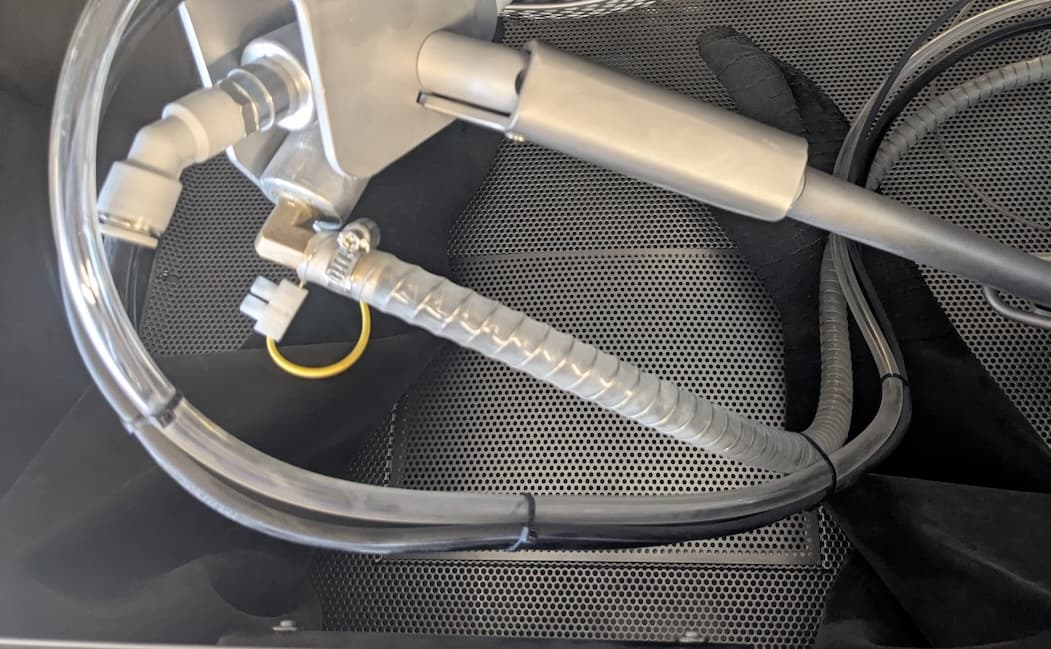

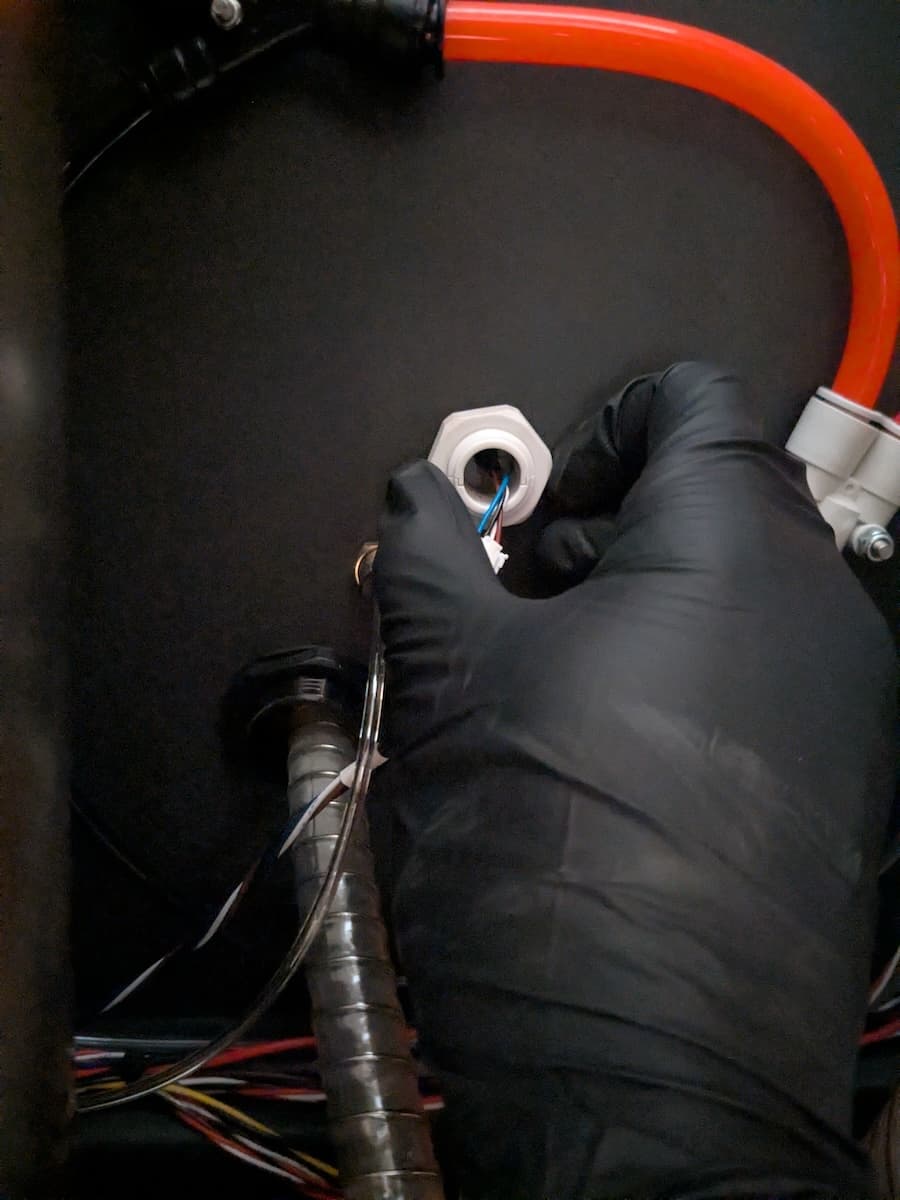

The ionizer cable is held in place by a cable clamp that passes through the right wall of the blasting chamber. Unscrew the cable clamp retention nut, then pull the cable clamp into the blasting chamber. Use a pair of pliers to loosen the nut, if necessary.
Carefully cut the zip ties securing the ionizer cable to the part rinse tubing. Set the cable and clamp aside for disposal.

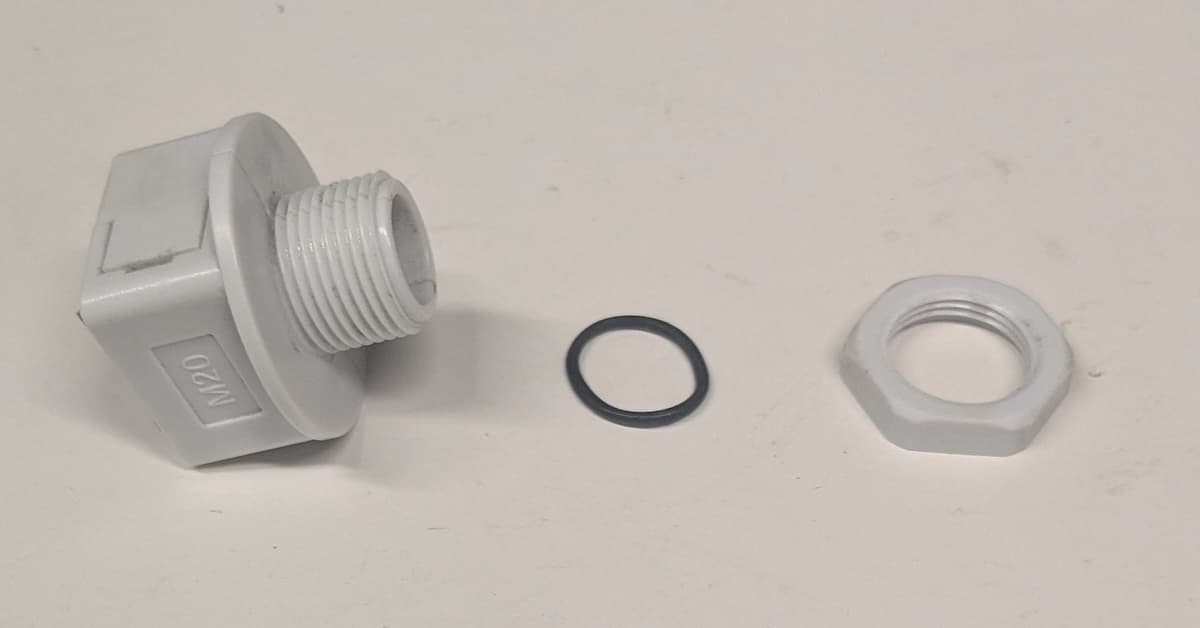

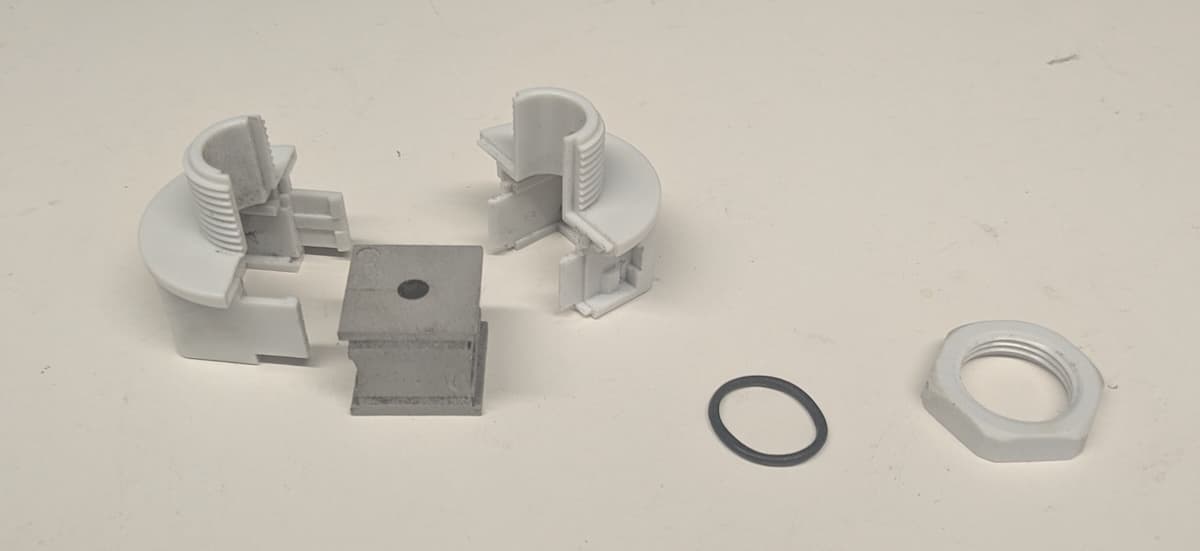

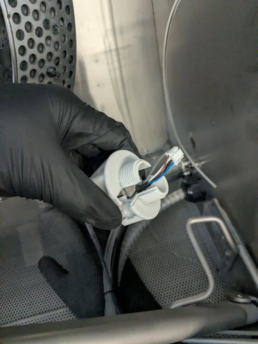

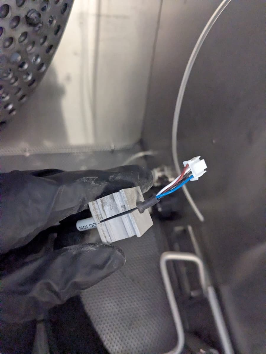

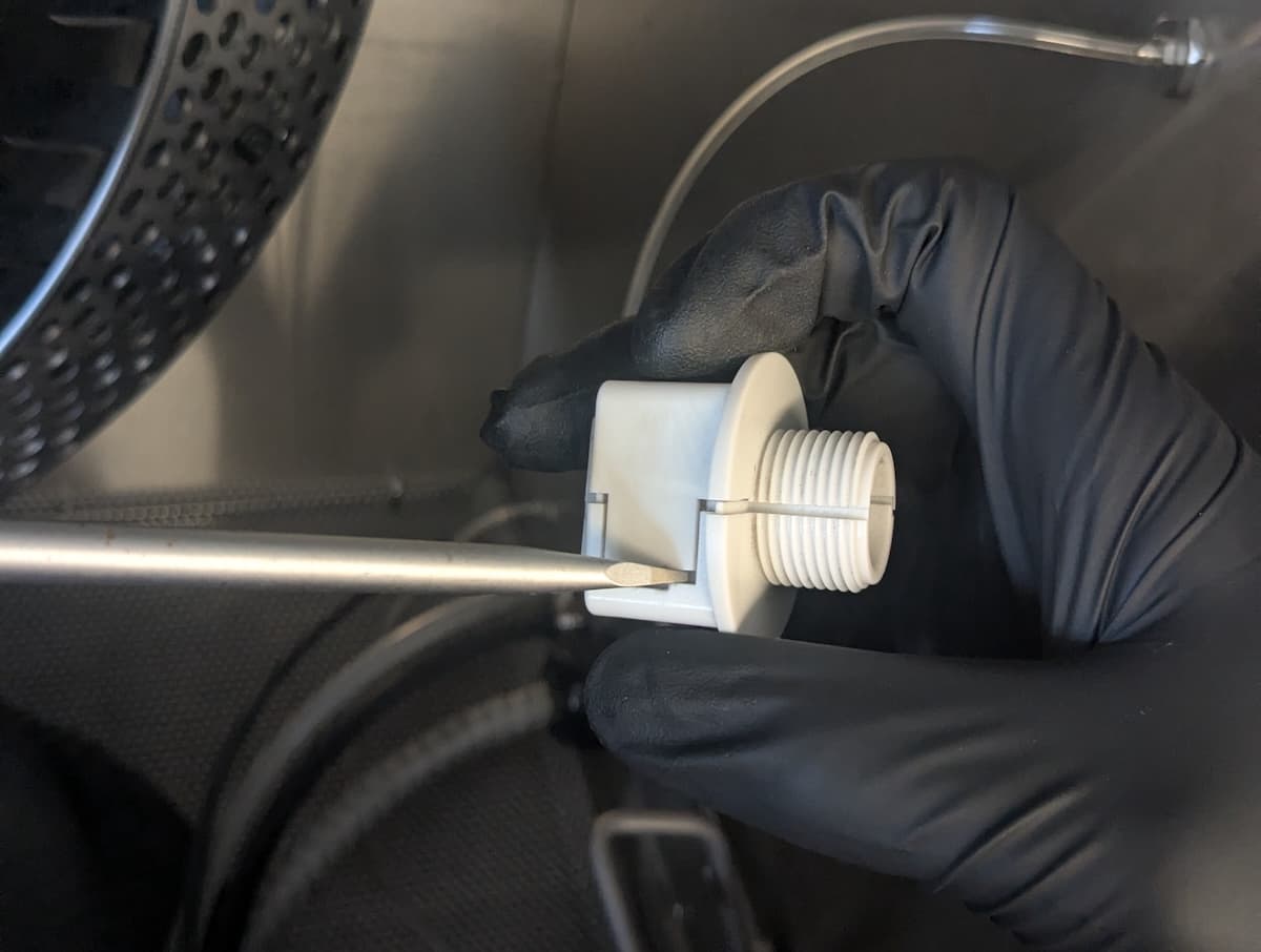

Remove the new ionizer, cable, cable clamp, and fasteners from the kit packaging. If they are installed, unscrew the nut from the cable clamp and slide the O-ring off the threads. Insert a slotted screwdriver or other similar tool into one of the two slots on the side of the clamp. Gently pry the clamp open. Repeat with the other slot on the other side of the clamp. Separate the two halves of the clamp and remove the insert in between.
Step 2: Secure the ionizer cable in the clamp
Gently open the cable clamp insert and insert the end of the new ionizer cable with the JST connector. Align the thicker portion of the cable with the front face of the clamp insert.
Place the insert into one of the halves of the cable clamp so that the JST connector extends out from the threaded section of the clamp. Place the other half of the clamp on top and squeeze it shut until it makes an audible click. Slide the O-ring over the threaded portion of the clamp.

From the inside of the blasting chamber, insert the threaded portion of the cable clamp through the hole in the right wall of the chamber. Secure it with the cable clamp nut on the other side of the blasting chamber wall.
Step 4: Connect the ionizer cable to its extension cord
Connect the ionizer cable to its extension cable. The connectors only fit together in the proper orientation. Press the connectors together until the latch makes an audible click.

Orient the ionizer cable connector so that the four pins align with the corresponding holes in the port on the new ionizer. Plug the cable into the port, then tighten the threaded connector until the cable is secure.

Place the ionizer on top of the blast gun, aligning the screw holes through the ionizer with the corresponding screw holes in the top of the blast gun. Thread one of the included Torx screws into both holes. Using a T25 Torx driver, tighten until snug.

Press the part rinse tubing into the push-to-connect fitting on the back of the ionizer.
