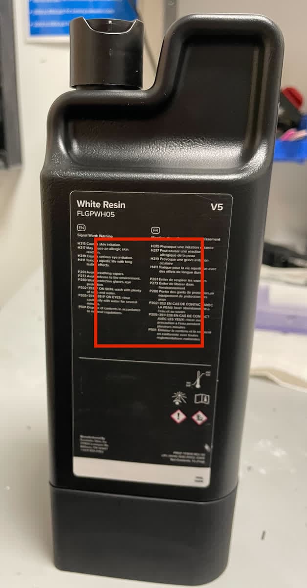

- If the resin cartridge is not detected properly in any printer or there are no other printers available, check that the RFID sticker is present. You should be able to feel the small square sticker underneath the cartridge label, roughly in the position shown here.
- If the RFID sticker is not present, contact Formlabs Support or your authorized reseller. Be sure to include the resin lot number, found on a sticker on the bottom of the cartridge, in your message.
