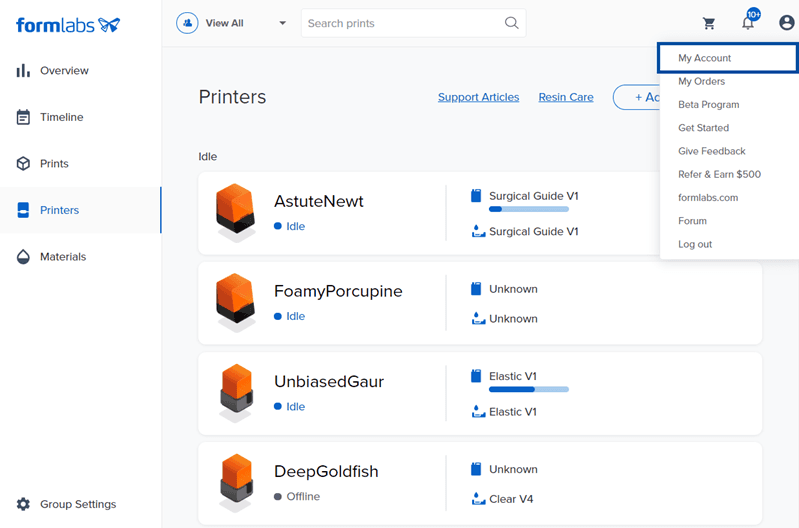

To opt in to receiving custom notifications:
  1. Log in to your Formlabs account.
  2. Click the account icon in the top-right corner. A dropdown appears.
  3. Click My Account. The Account Overview page appears.
  4. Click Notifications. The Notification Settings page appears.
