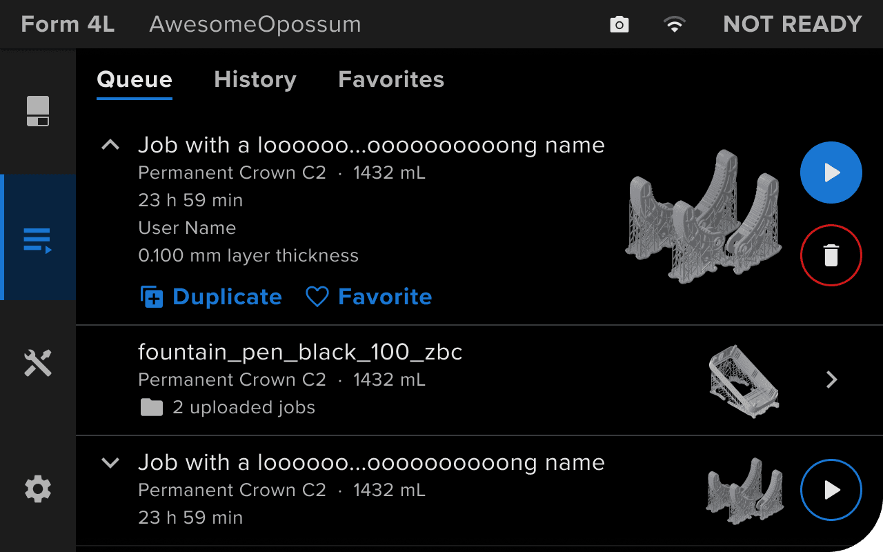

Starting from the Queue
When you send a job from PreForm, the job is automatically added to the Queue.
  1. Locate the print job you want to reprint.
  2. Tap the play button next to the job in the Queue. The Printing screen appears and the print starts.
Print queue on a Form 4L printer

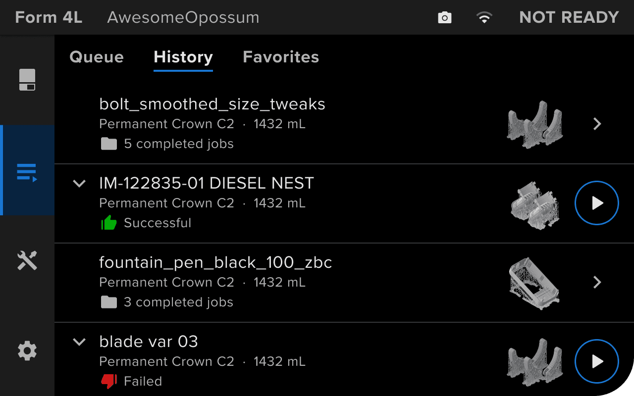

Starting from the History list
Previously-completed jobs can be viewed in the History list.
  1. From the Queue, tap History to view the History list.
  2. Locate the print job you want to reprint.
  3. Tap the job name to view more information about the print.
  4. Tap the Add to queue button. The job is added to the bottom of the Queue.
  5. Tap the play button next to the job in the Queue. The Printing screen appears and the print starts.
Print history on a Form 4L printer

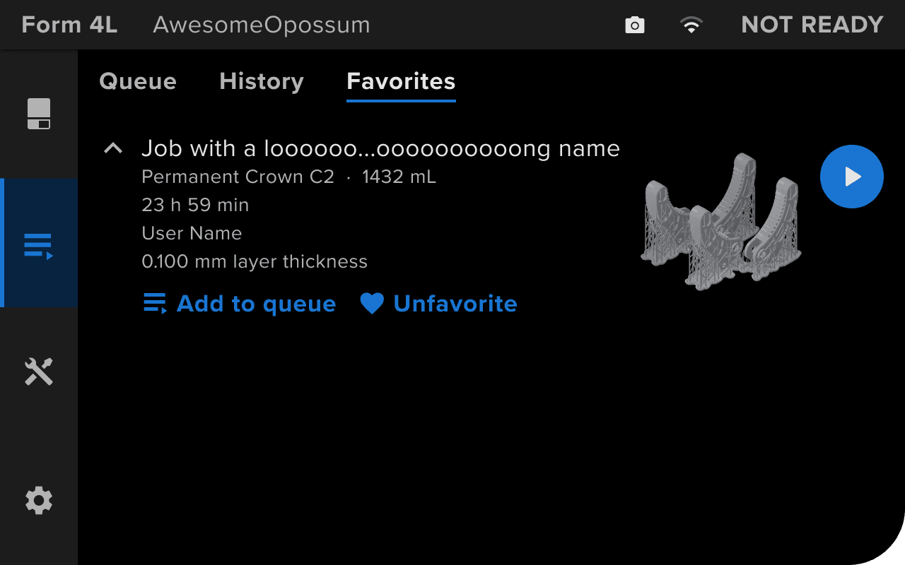

Starting from the Favorites list
You can mark print jobs as a favorite to easily reprint them in the future. In the Queue or History, tap a job to view more information about the print, then tap Favorite to add it as a favorite.
  1. From the Queue, tap Favorites to view the Favorites list.
Favorite prints on a Form 4L printer
