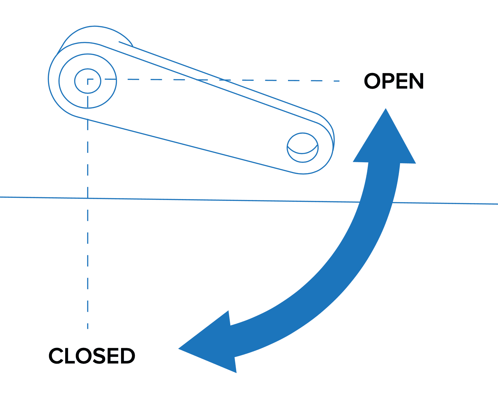

  2. With the blast gun running, fully close the gray media metering valve underneath the media hopper. You can observe media flow by looking at the media hose leading to the blast gun.
alttext
  1. While watching the media hose and blast gun, open the media valve in small increments.
  2. Between each increment, wait ten seconds for the flow of blasting media to improve.
  3. Continue to slowly open the media metering valve until the media flows in low-frequency waves or a consistent stream.
