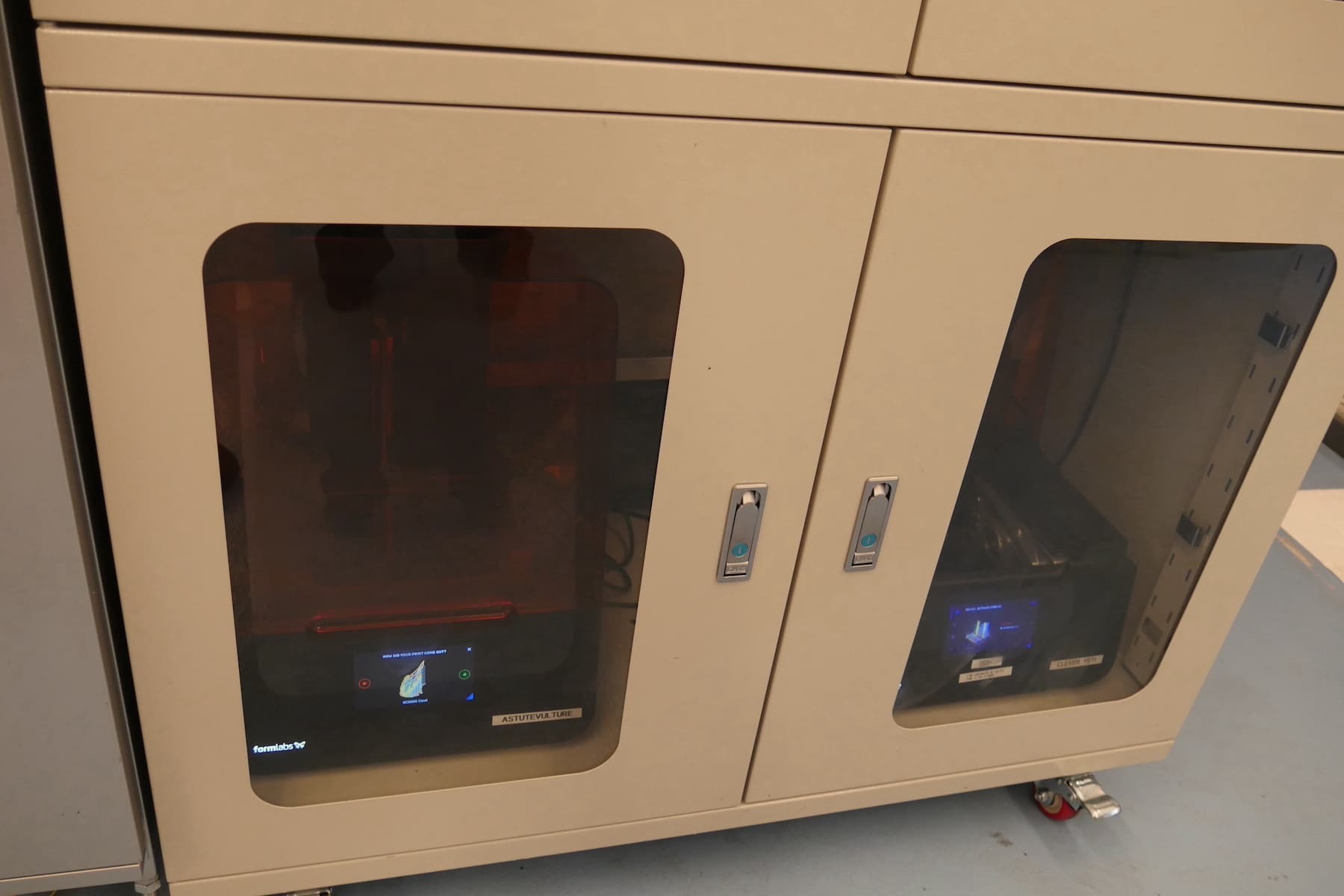

Formlabs recommends the use of a dry cabinet for improved climate and moisture control while printing and storing PU Rigid 650 Resin and PU Rigid 1000 Resin.
There are multiple possible workflows when printing with a Formlabs PU Rigid 1000 Resin, depending on your needs and available resources. You can print with a dry cabinet or in ambient conditions, and you can print using automatic resin dispensing (as with other Formlabs resins) or by manually filling your resin tank (not available on the Form 2).
| Workflow | Method | Advantages | Considerations | When to use |
| Recommended | Automatic filling in dry cabinet | Best results and easy workflow | Requires dry cabinet | Frequent printing with PU Rigid 1000 Resin |
| Low cost | Automatic filling in ambient conditions | Low cost and simple | Short pot life | Printing in ambient conditions |
| Modified | Manual dispensing in dry cabinet | Extends resin pot life | Requires dry cabinet and fine tuning may be necessary | Printing intermittently or printing the same part repeatedly |
Note:
If you elect to use the Recommended or Modified workflow, you can leave your printer in the dry cabinet when printing with other resins. All Formlabs resins can print successfully in low humidity conditions.

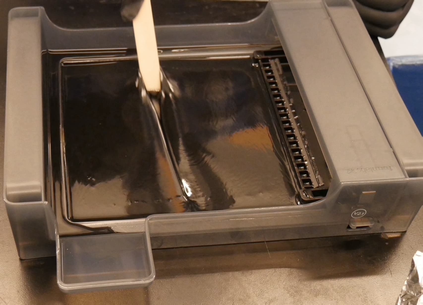

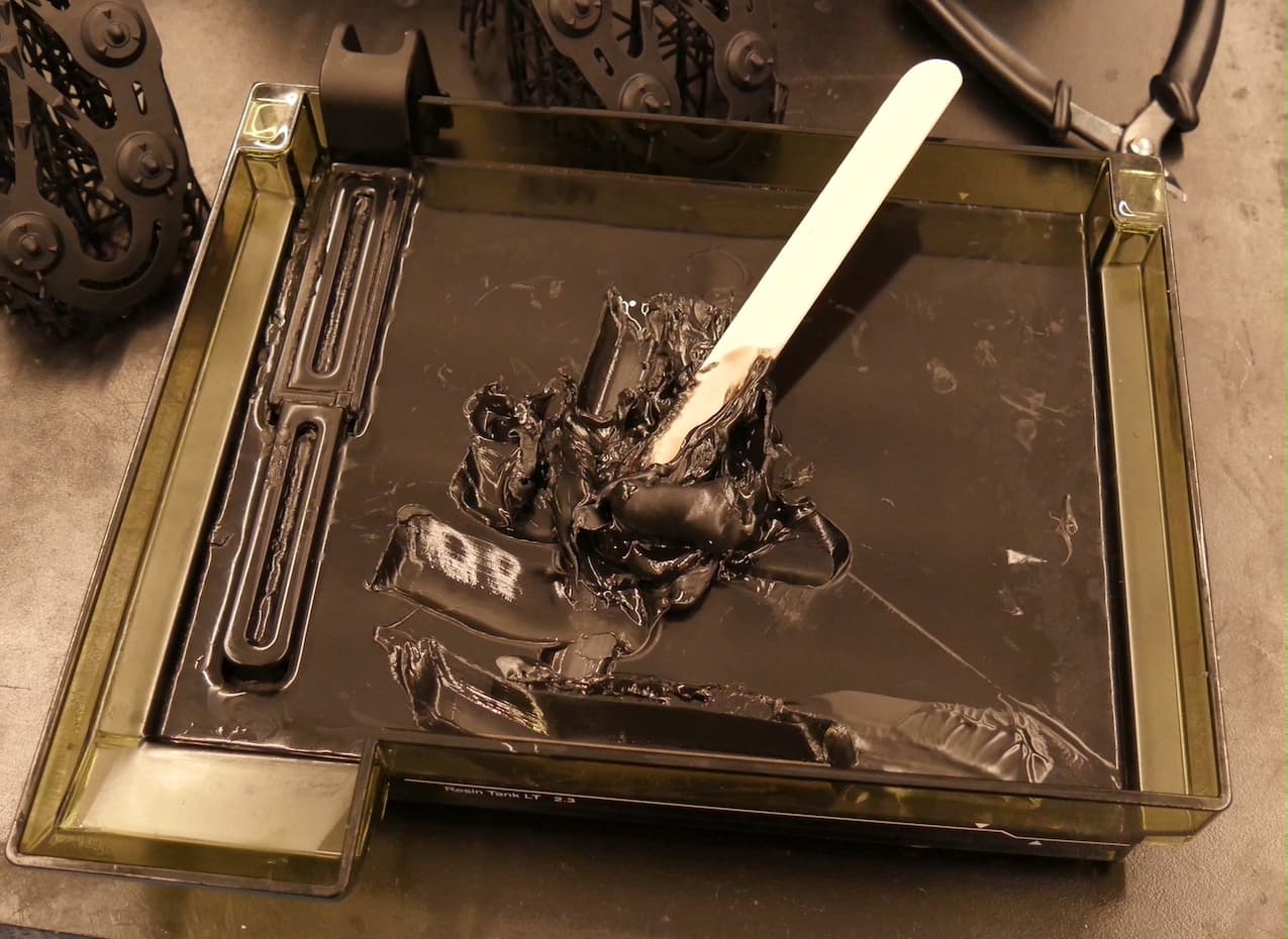

Left: PU Rigid 1000 Resin that is still viable. Right: PU Rigid 1000 Resin that is no longer viable.
To determine whether the PU Rigid 1000 Resin in a resin tank is usable, drag a spatula or other flat, blunt tool along the bottom of the tank. If the resin pours into the gap left by the tool, it is still usable. Alternatively, use a Zahn cup #5 viscometer to determine if the resin viscosity exceeds 2000 cPs. Change the resin in the resin tank or add fresh resin from the resin cartridge if the viscosity exceeds 2000 cPs.

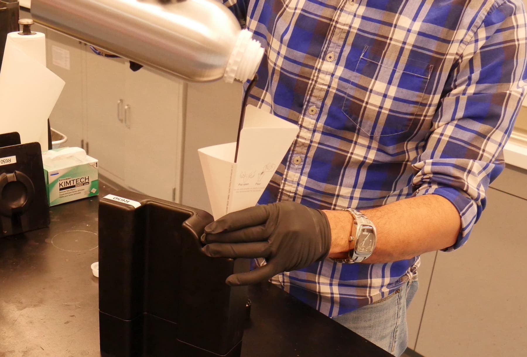

If you are planning to print using Automatic filling, fill the resin cartridge:
If you are using the Recommended or Modified workflow, install your printer in your dry cabinet:

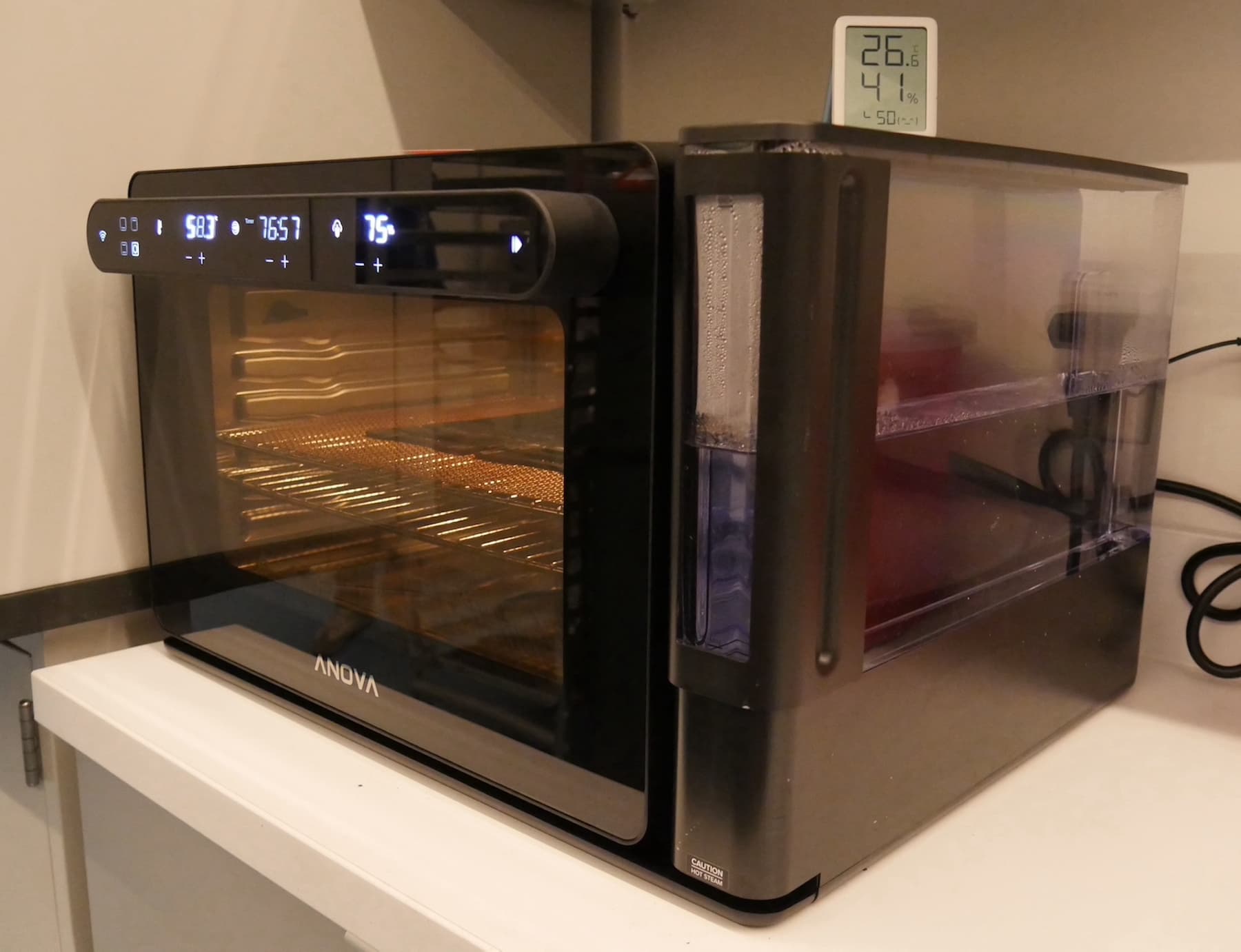

PU Rigid 1000 Resin must be post-cured in a humidity cure chamber. For more information about recommended third-party supplies, see the support article Recommended tools and supplies (PU Resins).

Some Anova Precision humidity ovens may need to be calibrated to achieve the target temperature and humidity. Monitor the temperature and humidity inside the oven using a thermometer and a humidity sensor. Adjust the controls on the oven as necessary to achieve a reading of 46 ºC & 70% relative humidity (RH) inside the oven.
| Post-cure times at 46 ºC & 70% Relative Humidity (RH) | ||
| Part Thickness | PU Rigid 650 | PU Rigid 1000 |
| 2 mm | 3 days | 3 days |
| 3 mm | 3 days | 4 days |
| 6 mm | 4 days | 5 days |
| 9 mm | 12 days | 9 days |
| 12 mm | ~14 days | ~14 days |
