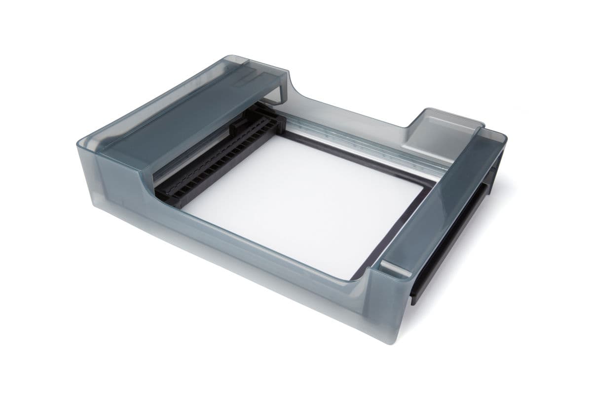

Form 3/Form 3B Resin Tank
Inspecting resin tanks
Place the resin tank on a clean and even surface before inspecting the film with the tank tool. Keep the resin tank—especially the top and underside surfaces of the film—clean and free of cured resin and other debris to ensure print quality and extend the lifetime of the printer.
Notice:
  • Resin may spill over the tank walls if the resin tank tilts more than 5–10°. Hold the resin tank level with two hands. To inspect and clean the underside of the tank, empty the resin tank and take care to avoid spilling resin outside the tank.
  • Sharp and metal tools can damage the dual-layer film in the resin tank and affect print quality. Do not use sharp or metal tools in the resin tank. Use only the tank tool to clean the inside of the resin tank.

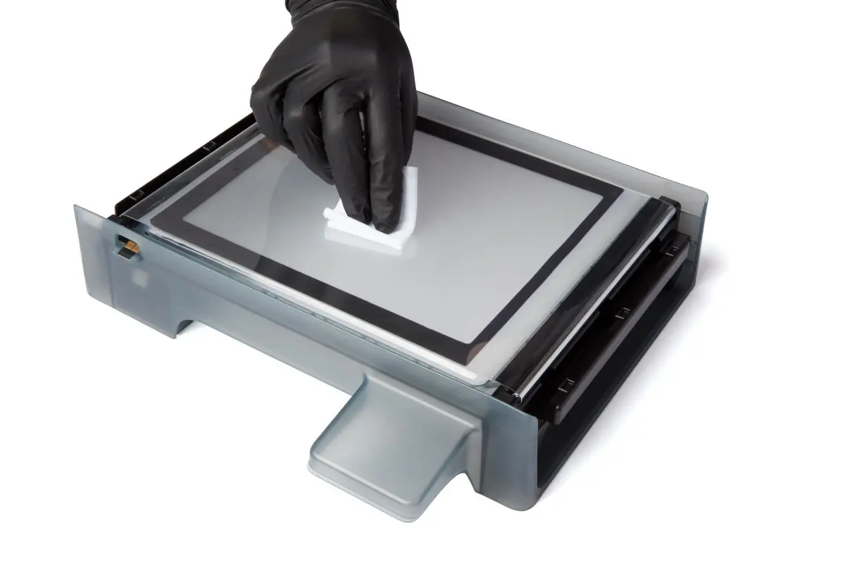

Clean the film underside
To clean the underside of the protective film:
  1. Empty the liquid resin from the resin tank into an opaque container.
  2. Place the empty resin tank upside-down on a clean, flat surface.
  3. Apply a small amount of clean IPA to a PEC*PAD.
  4. Wipe the surface of the film to remove contamination or resin.
Form 3/Form 3B tank, underside
