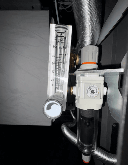

Connecting a nitrogen source and adjusting nitrogen flow to the printer
With the nitrogen generator set up, the flow into the printer is set with a manual rotameter and pressure regulator.
To adjust the nitrogen flow:
  1. Using an 8 mm hex driver, unlatch and open the air handling access door, on the right side of the printer.
  2. Locate the rotameter and pressure regulator, on the right side of the air handling cabinet.
  1. Ensure the rotameter is closed initially by turning the knob clockwise to tighten.
  2. Ensure the pressure regulator is closed initially by pulling up on the knob and turning counterclockwise.
  3. Connect the outlet of the nitrogen generator to the inlet at the back of the printer using either the provided quick disconnect fitting or a suitable alternative.
  4. Loosen the rotameter knob, turning counterclockwise, until the float reaches 48 SCFH (equivalent to 0.8 SCFM).
  5. Turn the pressure regulator knob clockwise until it reads 0.3 MPa. Press the knob down.
  6. Close the air handling access door. Latch it shut using an 8 mm hex driver.
