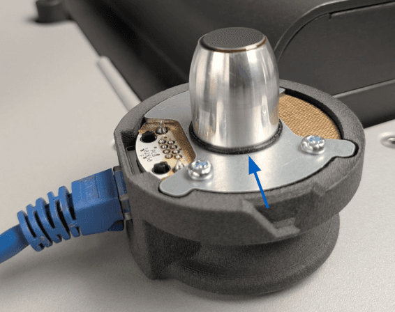

The primary cause of temperature-related issues is contamination on the IR sensor or IR sensor cone. Before adjusting the bed temperature, inspect and clean the IR sensor and its housing:

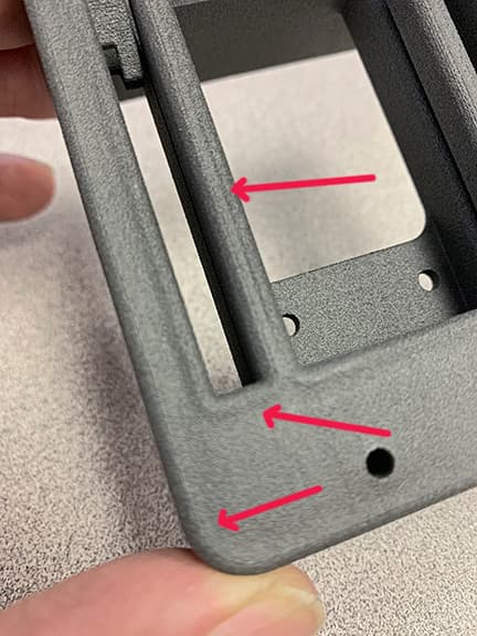

Layer curling
Layer curling can indicate that the temperature is either too high or too low, depending on the context.
Curling on the Surface Armor of a printed part may indicate that the bed temperature is too high. Surface Armor layer curling usually occurs very early in the print process, on the first few lased layers. Lower the Bed Temperature Target by 0.5 °C and run another print job. Continue to adjust the bed temperature in 0.5 °C increments if needed.
Curling within fully-sintered layers may indicate that the bed temperature is too low. Raise the Bed Temperature Target by 0.5 °C and run another print job. Continue to adjust the bed temperature in 0.5 °C increments if needed.

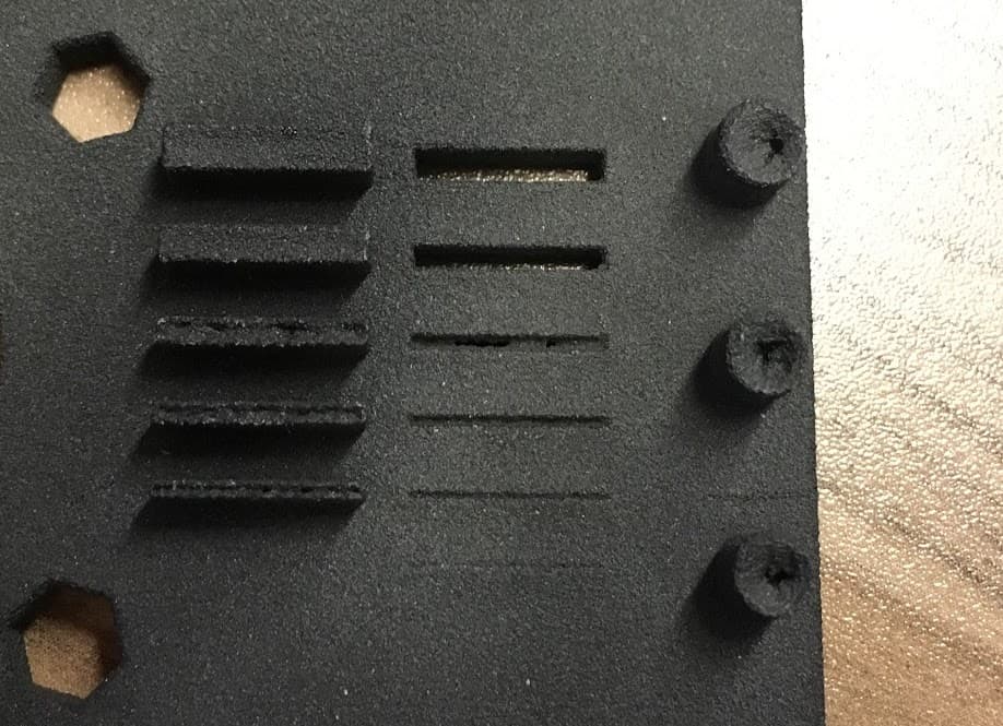

Dimpling or pitting
Some amount of dimpling on the top surface of parts is typical of parts printed on Fuse 1 generation printers and can generally be addressed with orientation and layout changes within the FORM file. Severe dimpling or deeper pitting may indicate that the bed temperature is too high. Lower the Bed Temperature Target by 0.5 °C and run another print job. Continue to adjust the bed temperature in 0.5 °C increments if needed.
