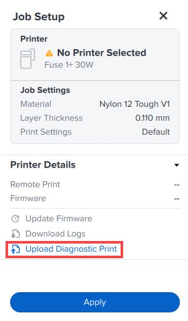

  4. Download the FLZ file for your printer.
  1. In PreForm, select your printer. In the sidebar on the right, click Upload Diagnostic Print. The Upload Diagnostic Print window appears.
  2. Click Browse and select the downloaded FLZ file.
  3. Click OK to send the print file to the selected printer.
