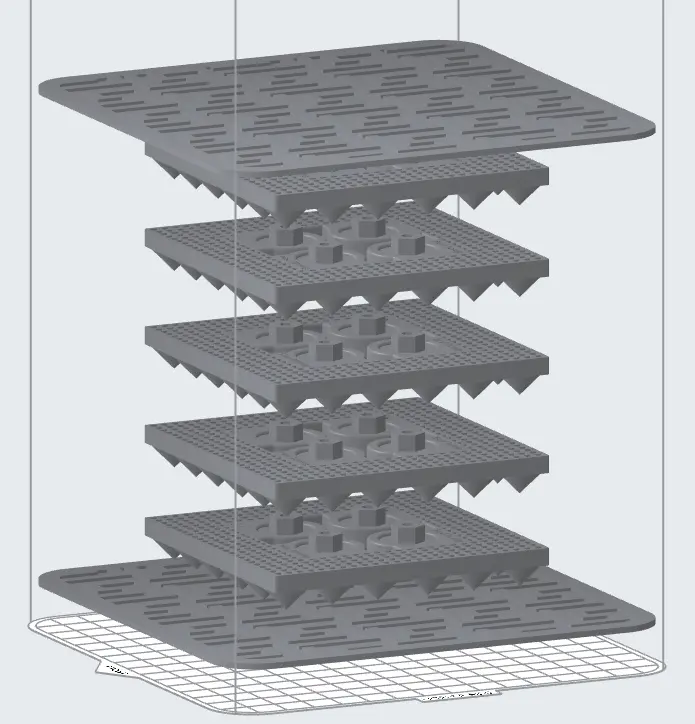

Bed Temperature Tuning print in PreForm
Run the Bed Temperature Tuning Print

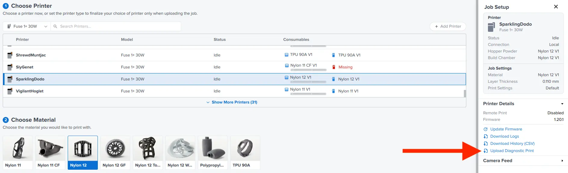

  4. Open PreForm and select Job Settings.
  5. In the Job Setup window, make sure the correct printer is selected.
  6. Select Upload Diagnostic Print.

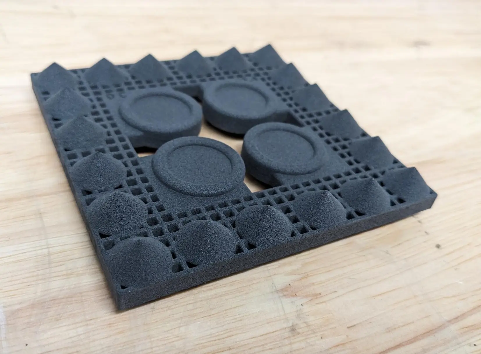

Clean parts prior to inspection either using the Fuse Blast or other media blasting solutions. Extract the five plaques with cones. The additional flat plaques in the build create equal cooling and separation between the cone plaques during the print and can be discarded.
alttext
Example of a cleaned cone plaque ready for inspection.
Each plaque lists the temperature offset it was printed with (-2 ºC, -1 ºC, 0 ºC, +1 ºC, +2 ºC). Line the plaques up from -2 ºC to +2 ºC to prepare them for inspection.

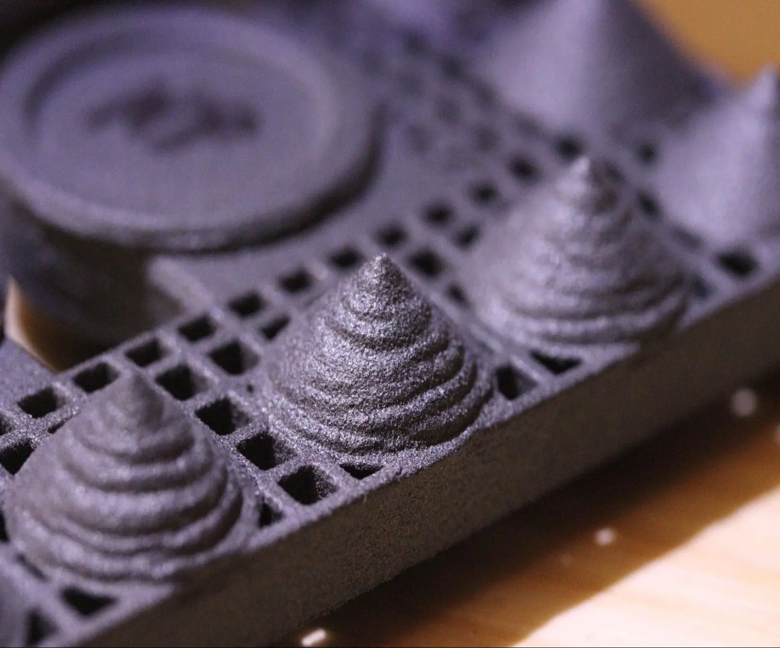

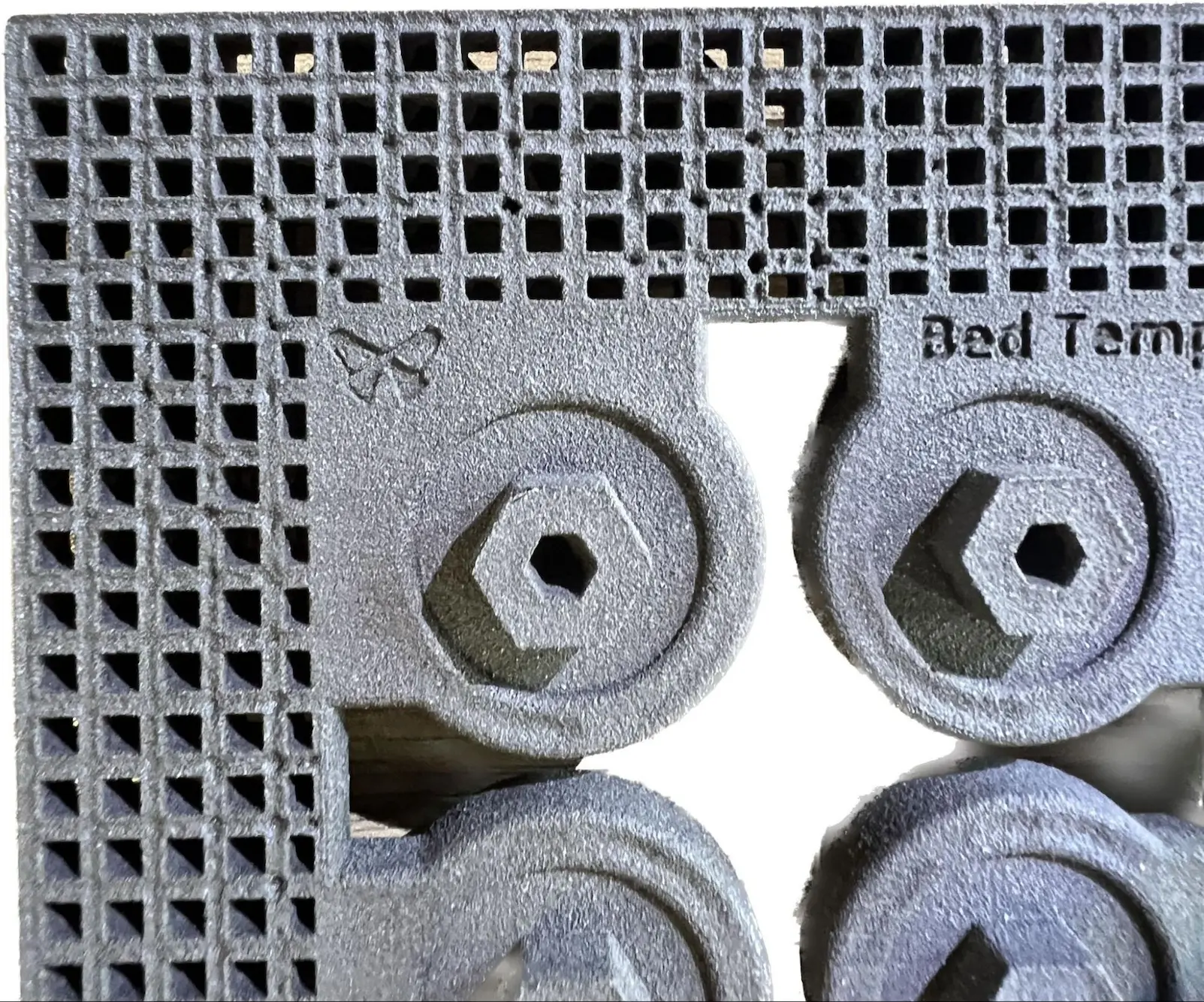

To determine the appropriate temperature offset for your printer, look for two things:
  • More than one instance but less than six instances of orange peel on a single plaque. This is most visible on the cones.
  • No pitting. This is most visible on the side of the plaque opposite the cones.
Rotate the plaques to inspect the cones from all angles. Orange peel appears as a slightly layered surface on the cones. Pitting appears as a tiny dot on the opposite side of the plaques.

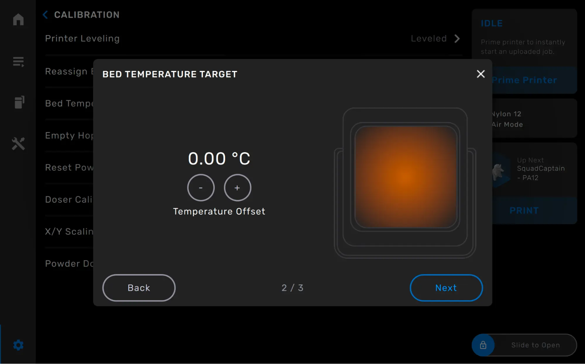

  1. Ensure that the printer is not running a print job and is currently Idle. The Bed Temperature Target can only be adjusted before a print, not while the print is running.
  2. Tap the gear icon on your printer’s touchscreen. The Settings screen appears.
  3. Tap Calibration. The Calibration screen appears.
  4. Tap Bed Temperature Target. A screen with information about the target temperature appears.
  5. Tap Next. The Bed Temperature Target screen appears.
alttext
  1. Tap + or - to increase or decrease the Temperature Offset.
  2. When you are done adjusting the Temperature Offset, tap Next. Confirm the new offset and tap Set.
