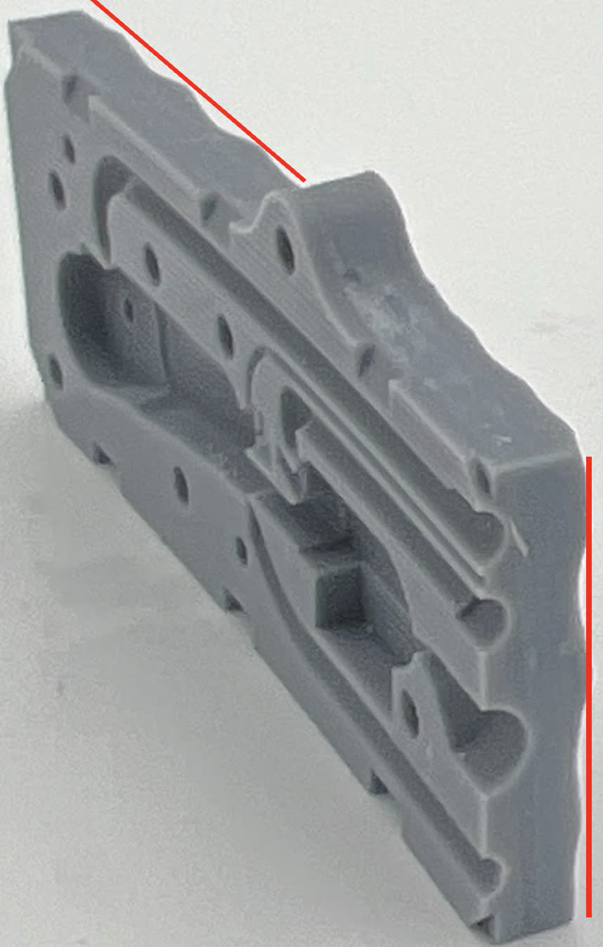

Print directly on the build platform
Print parts directly on the build platform whenever possible. This requires at least one flat face, though having small chamfers around the edges of that face may help for part removal. Parts printed directly to the build platform will generally have the least amount of warpage and shrinkage, in addition to using fewer supports.
Since the build platform constrains shrinkage, bottom layers will often be oversized in the XY plane. You may need to adjust your models if a perfect fit is critical. You can still support a part printed directly on the build platform by changing the raft type to None, taking advantage of both the supports and the build platform.

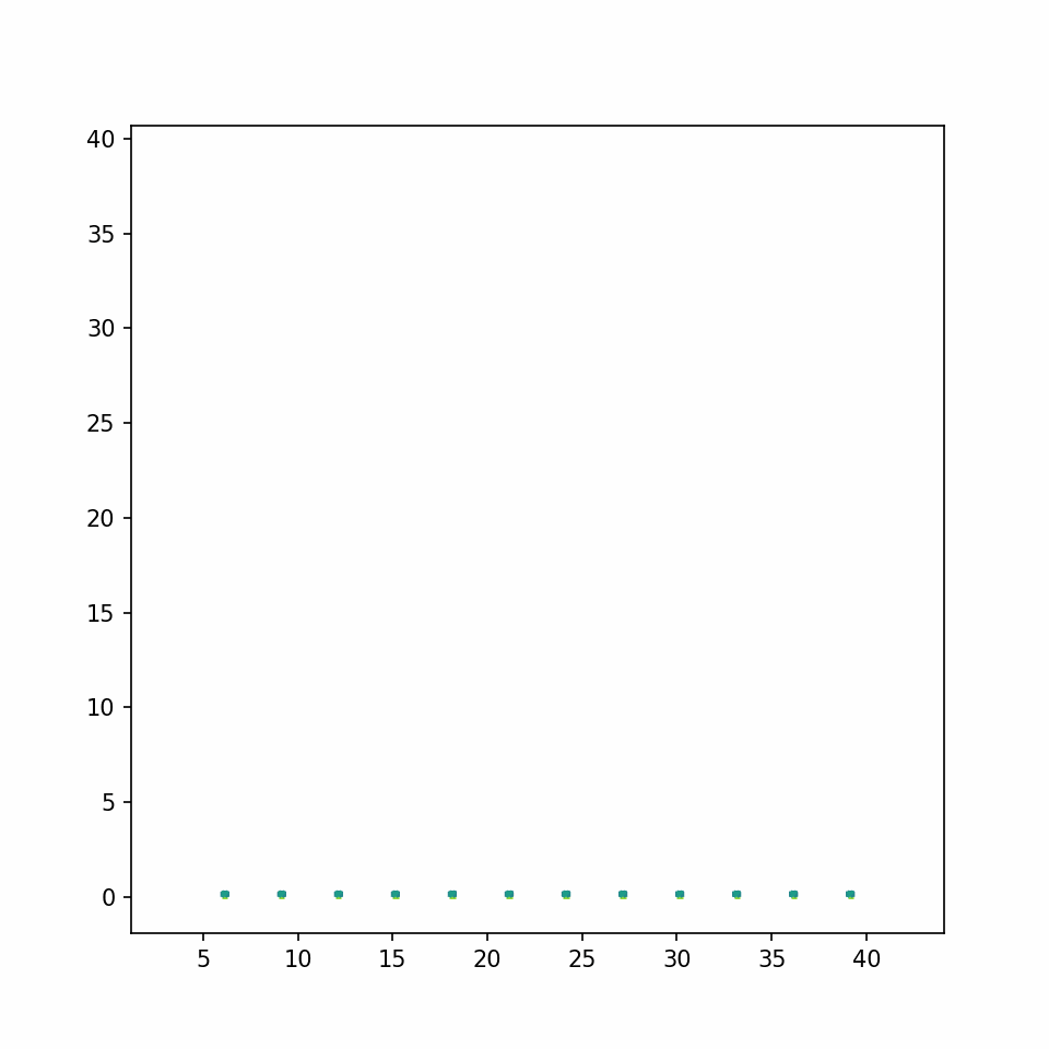

Shrinkage from sudden changes in cross-sectional area (also known as “H-bar shrinkage”)
H-bar shrinkage example
Improper model orientation that can cause H-bar shrinkage

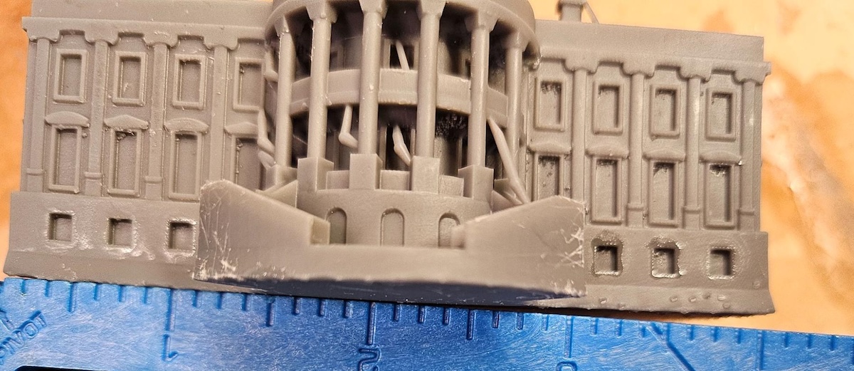

Bat-winging
Part showing bat-winging
Improper model orientation that can cause bat-wingingFaces tilted at a shallow angle relative to the build platform may exhibit “bat wing” distortion, where the part curls away from the build platform at the ends of its long axis. This is caused by insufficient support density. Large spans between the support touchpoints allow for deformation due to printing forces.
Orient parts more vertically. If that is impossible, increase support density and ensure that the touchpoints are spaced evenly.
Download the FORM file to test the part yourself.
Model oriented to avoid bat-winging

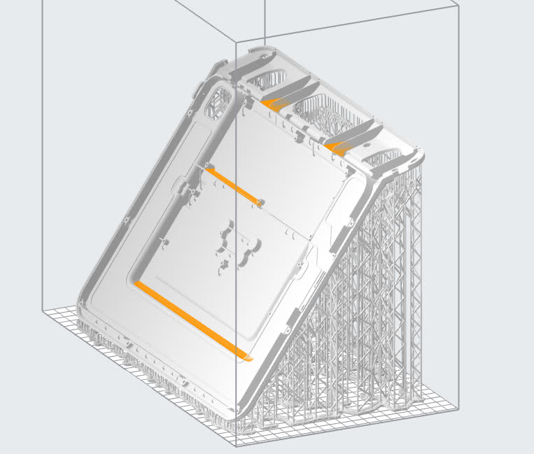

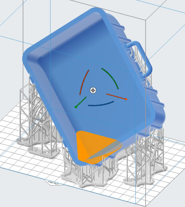

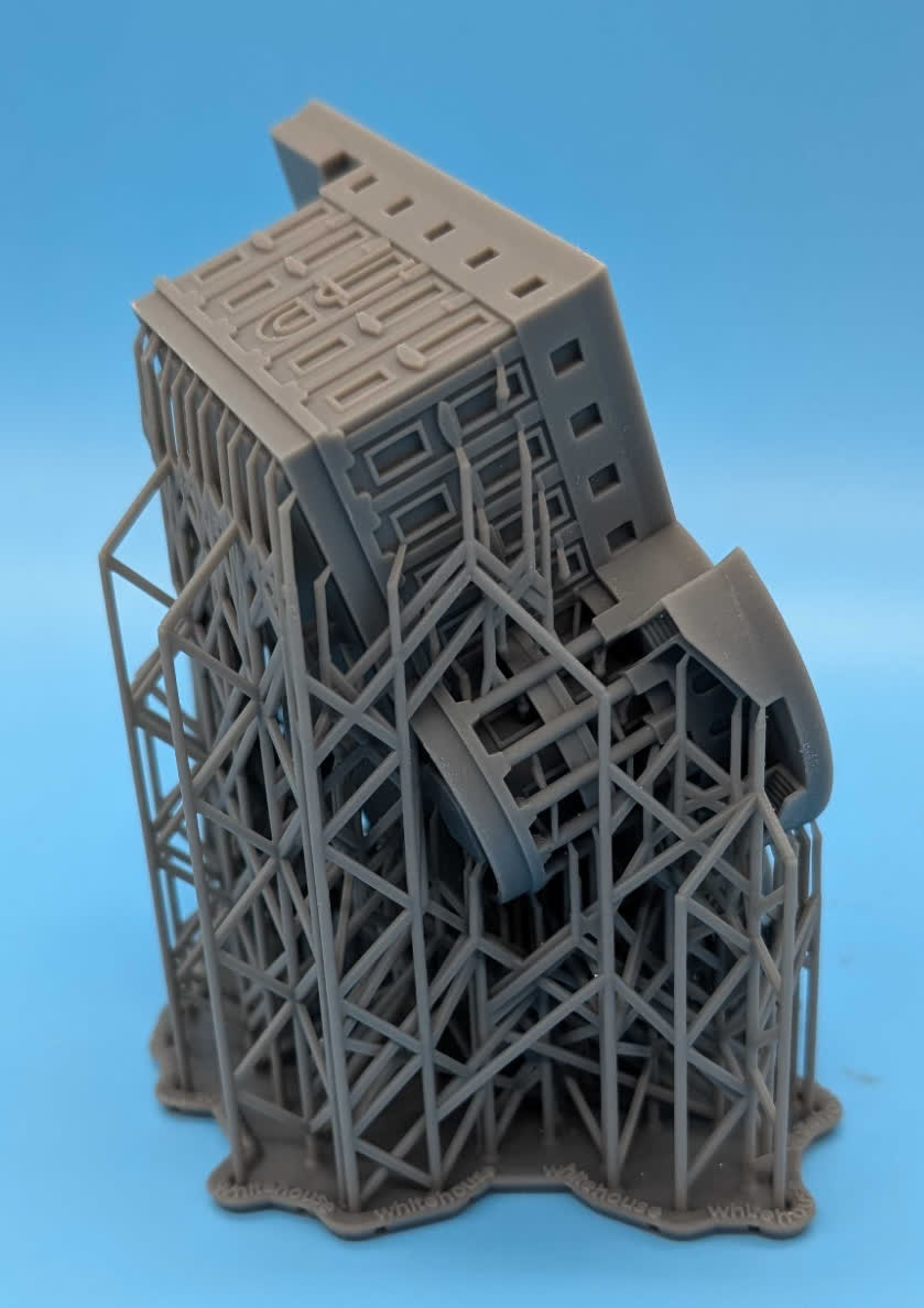

Example 1: Case
This model has multiple geometric and aesthetic features that can make it challenging to properly orient and successfully print. Key considerations for orienting this part include:
  1. H-bar shrinkage risk: The geometry, while not a true H-shape, still creates overhangs that can lead to shrinkage.
  2. Merging vertical features: Several sections of the part merge along the Z-axis, which can cause print defects.
  3. Large cupped areas: These may introduce minor issues but are less critical than the points above.
  4. Aesthetic and mating surfaces: The part must connect cleanly to a separate lid and maintain a high-quality appearance.
Case model in PreForm

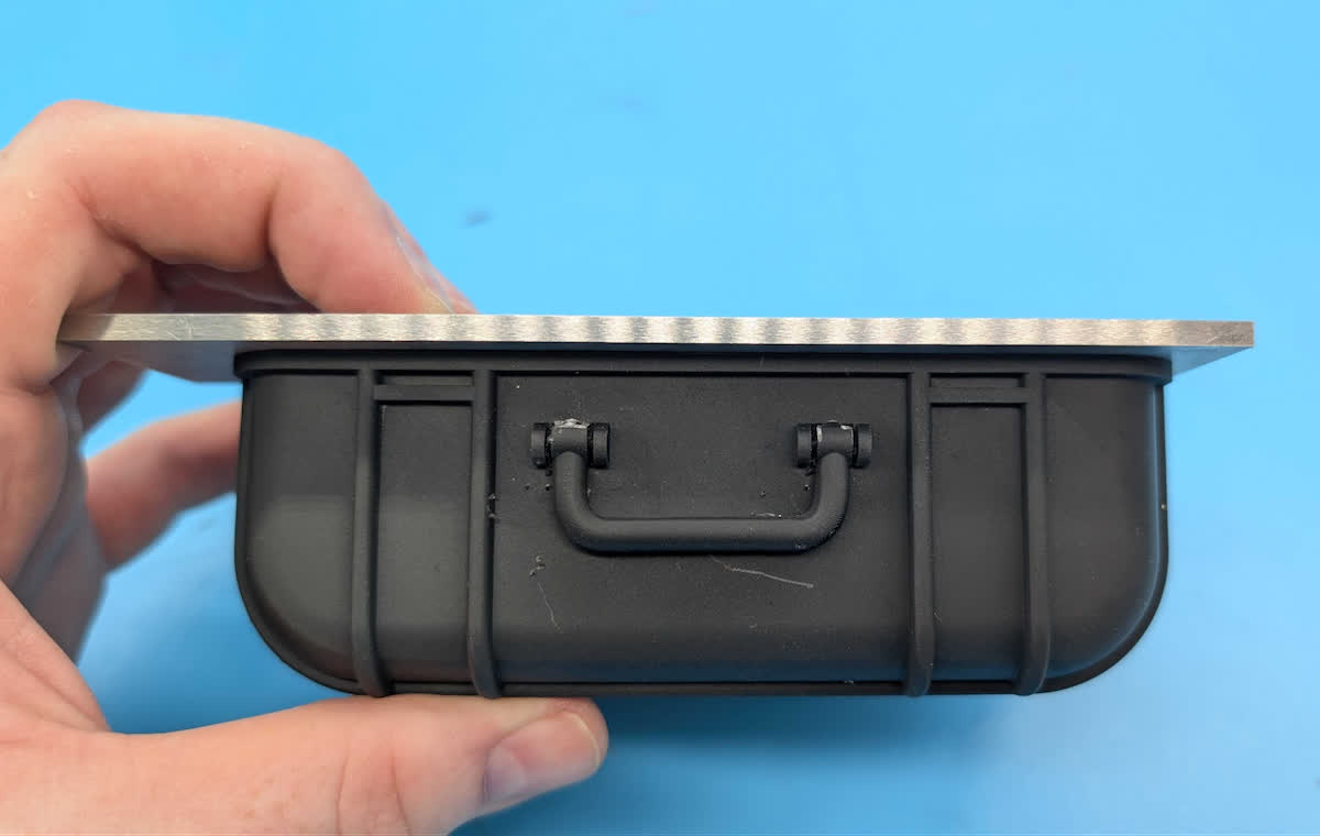

Ideal orientationReasonsPrinted partFlatness
Recommended orientation for a case
This orientation generally reduces H-bar shrinkage and warping as well as the number of merging features in the part.
This orientation does introduce a cup. To avoid related surface defects, add a drain hole.

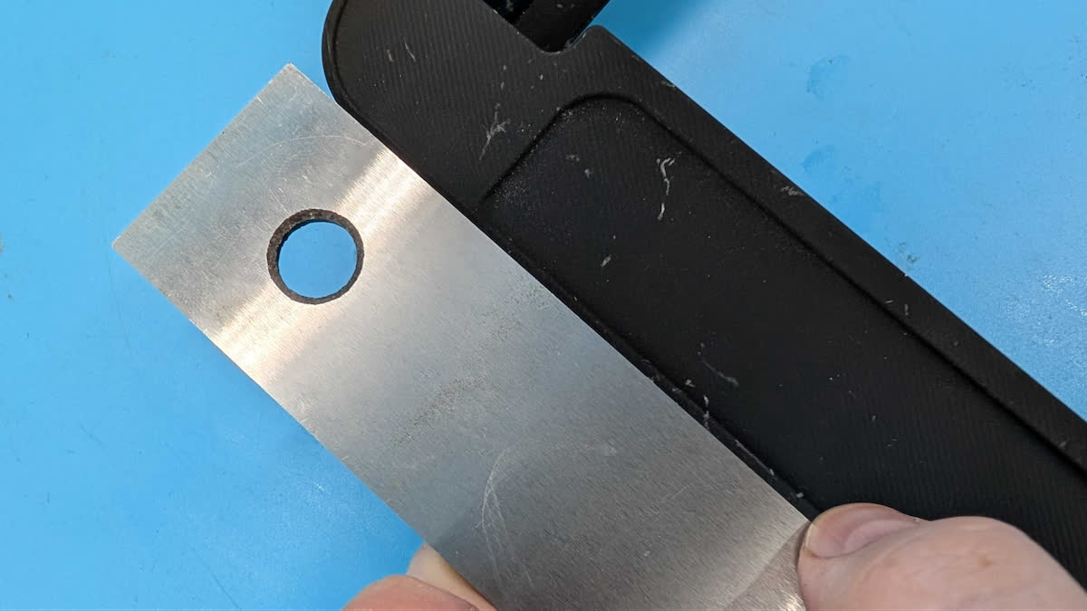

Printed case in the recommended orientation
Case with no warpage
Front of the case printed in the recommended orientation with no warp, shown with a machining parallel for reference.

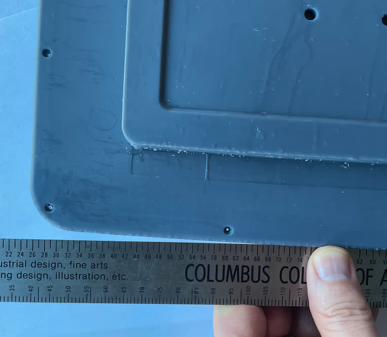

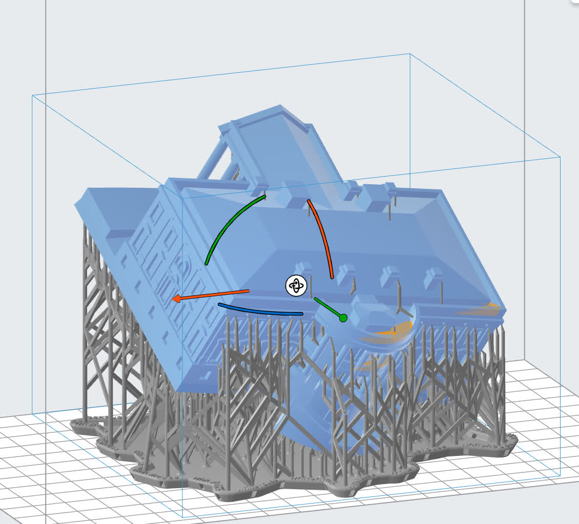

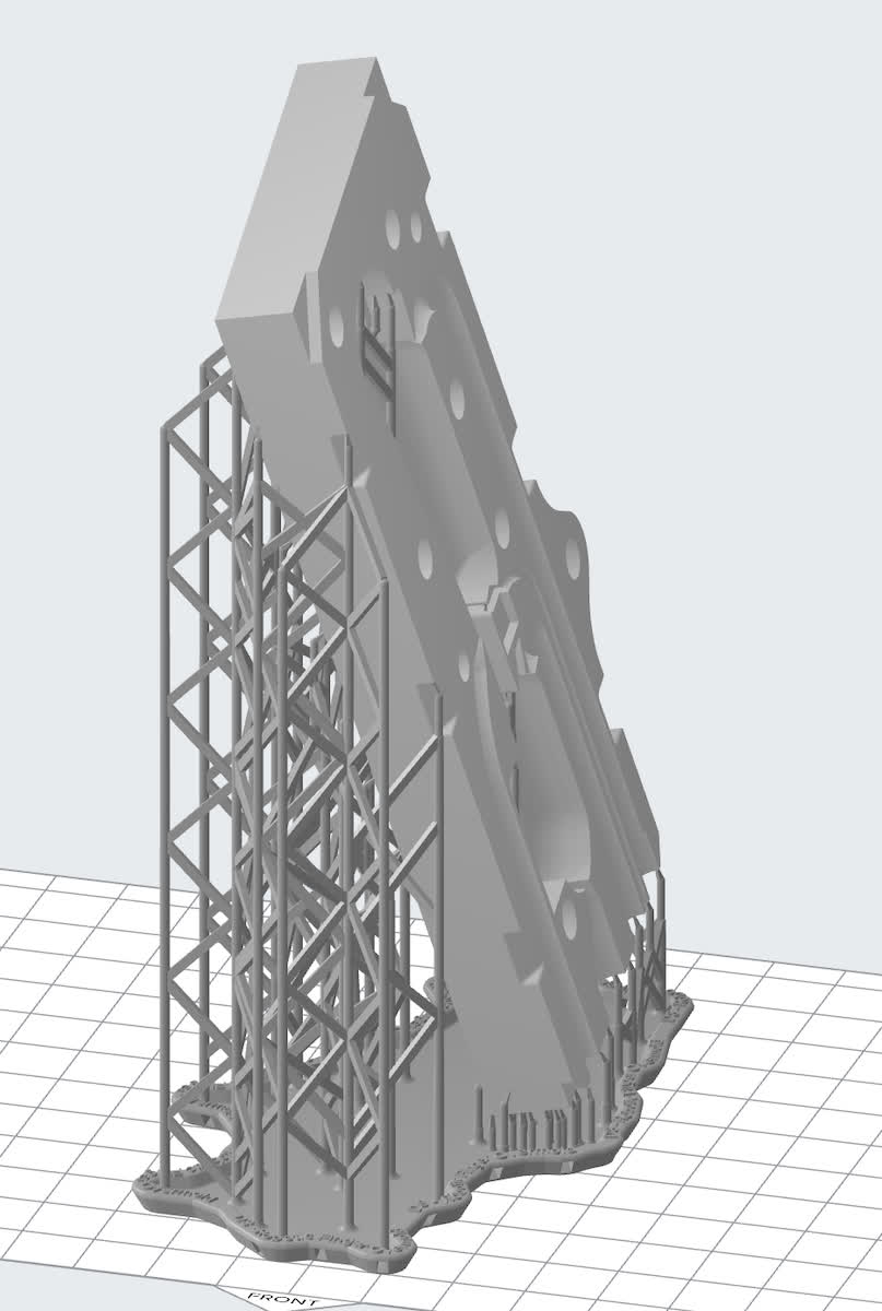

Example 2: Form 2 printer base
This part can curl dramatically when printed nearly flat or when angled only in a single direction. When it is printed at an angle relative to both the X- and Y-axis, the warpage is dramatically reduced.
Printed Form 2 printer base
Recommended orientation for a Form 2 printer base
Shrinkage and internal stresses can cause the entire part to curl upwards, away from the build platform. This is especially noticeable on bottom surfaces.
Tilting the part in both the X- and Y-axis reduces the cross-sectional area change as the ribs are printed.

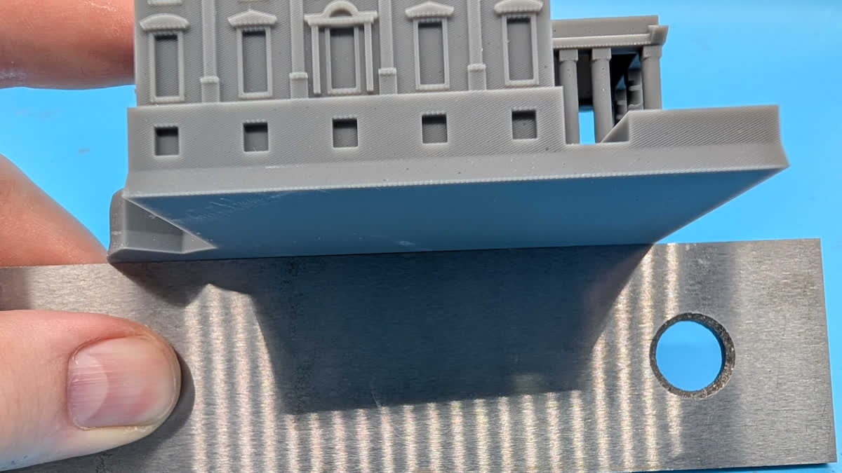

Printed Form 2 printer base in the recommended orientation

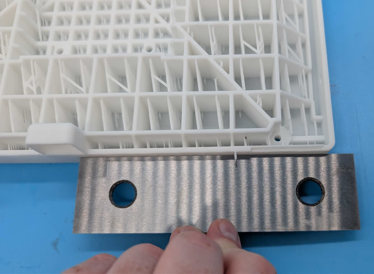

Form 2 printer base with no warpage
Edge of the part printed in the recommended orientation, shown with a machining parallel for reference. There is still some slight shrinkage along the longest axis. Ideally, that edge would have been tilted at 45°, but that would not fit in the printer’s print volume.

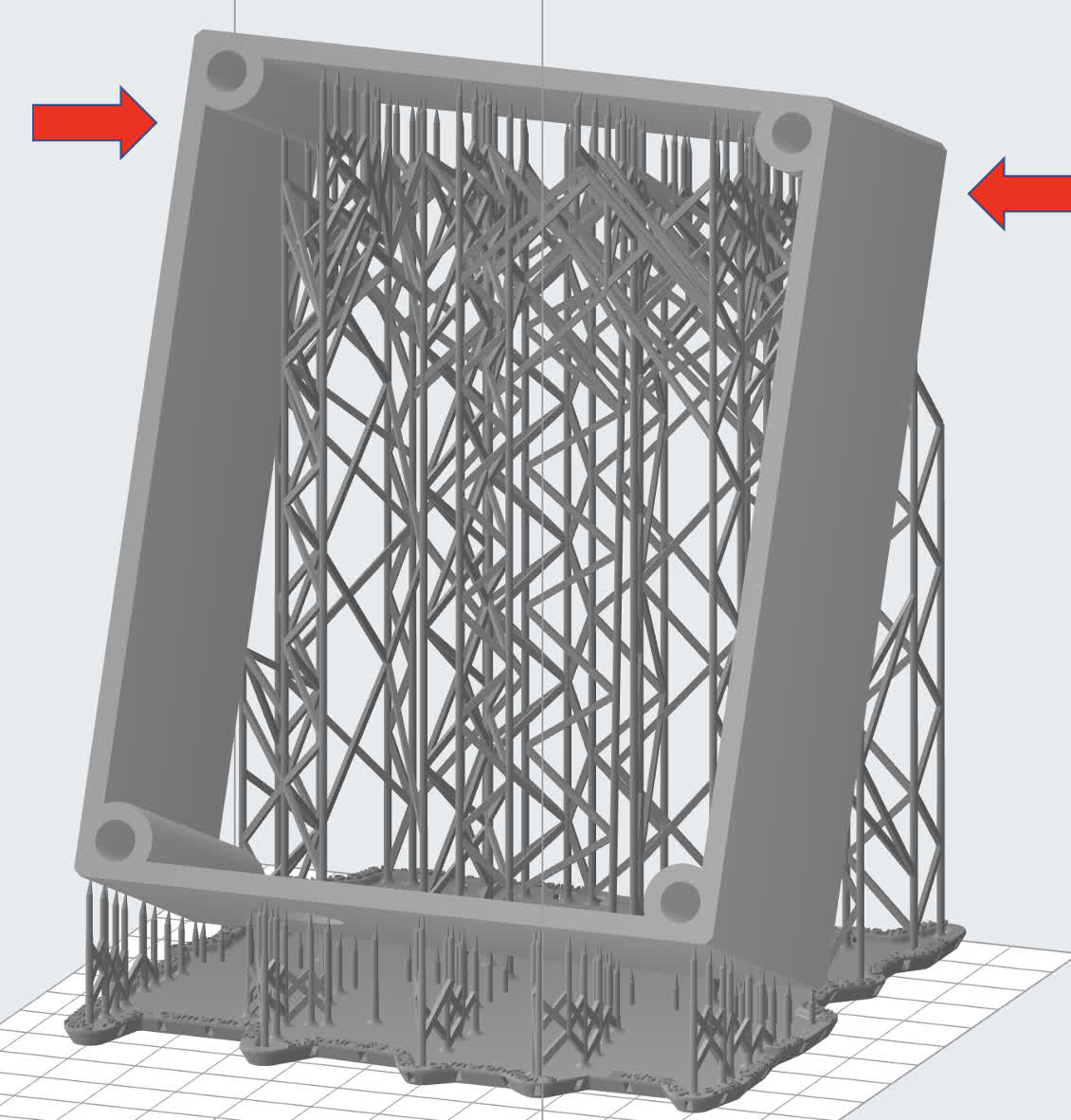

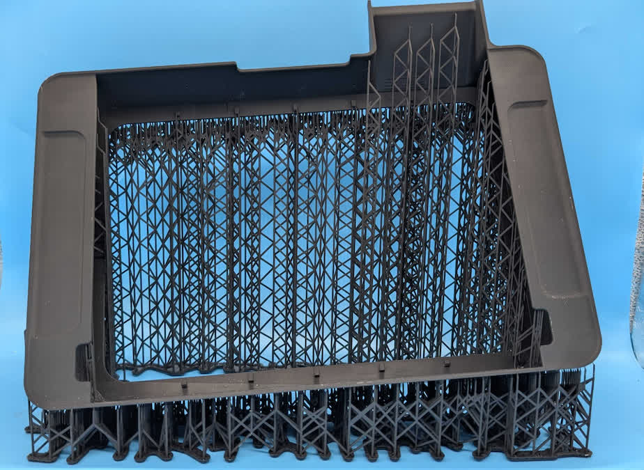

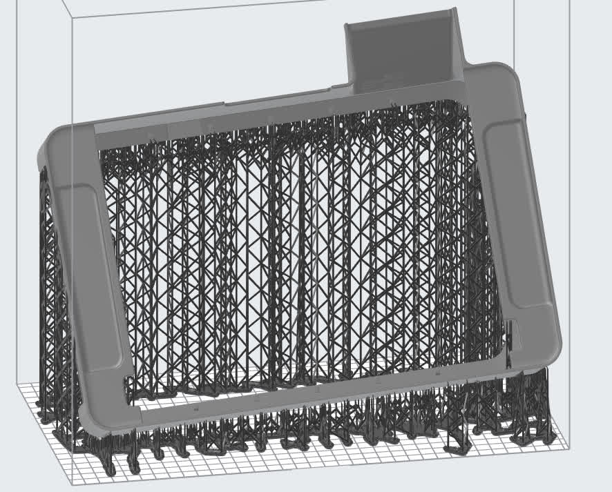

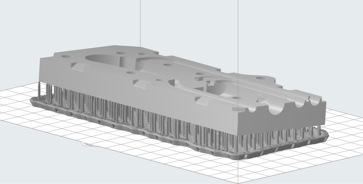

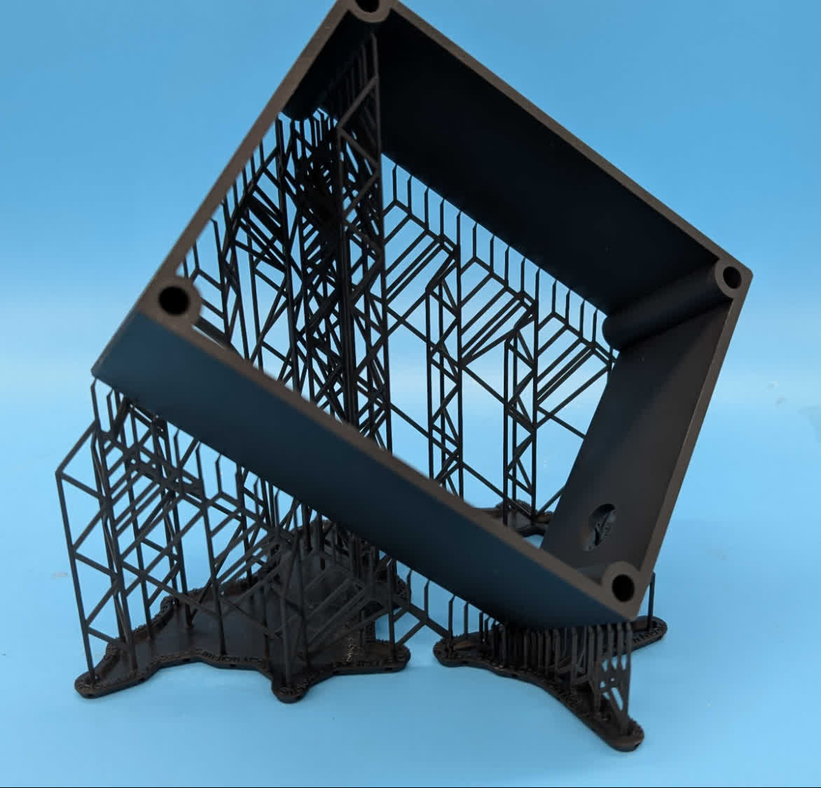

Example 3: Resin tank frame
This part nearly fills the print volume of the Form 4L, constraining the possible orientations. Rotating about a single axis creates a strong H-bar at the top of the part, resulting in buckled corners. To avoid this, use as much of the second axis as possible.
Printed resin tank frame
Recommended orientation for a resin tank frameMinimizes changes in cross-sectional area between layers and avoids any larger merging features.Printed resin tank frame in the recommended orientation
Resin tank frame with no warpage
Edge of the part printed in the recommended orientation with no warp, shown with a machining parallel for reference.
