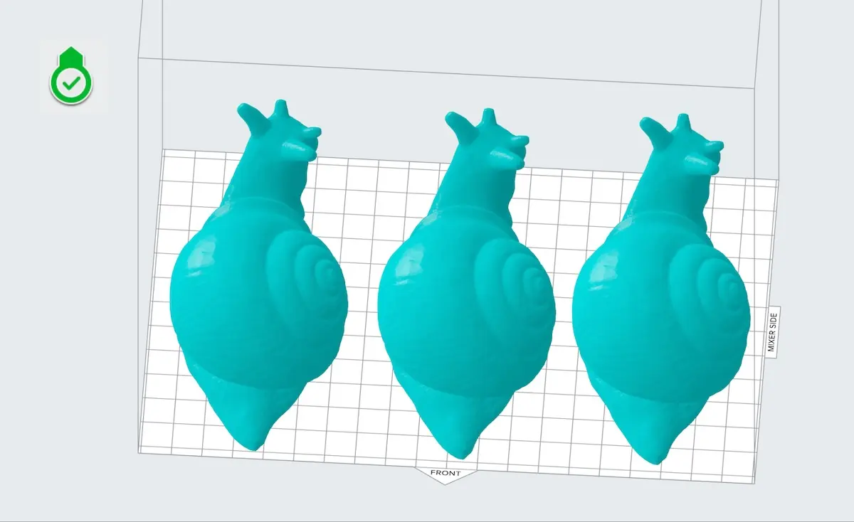

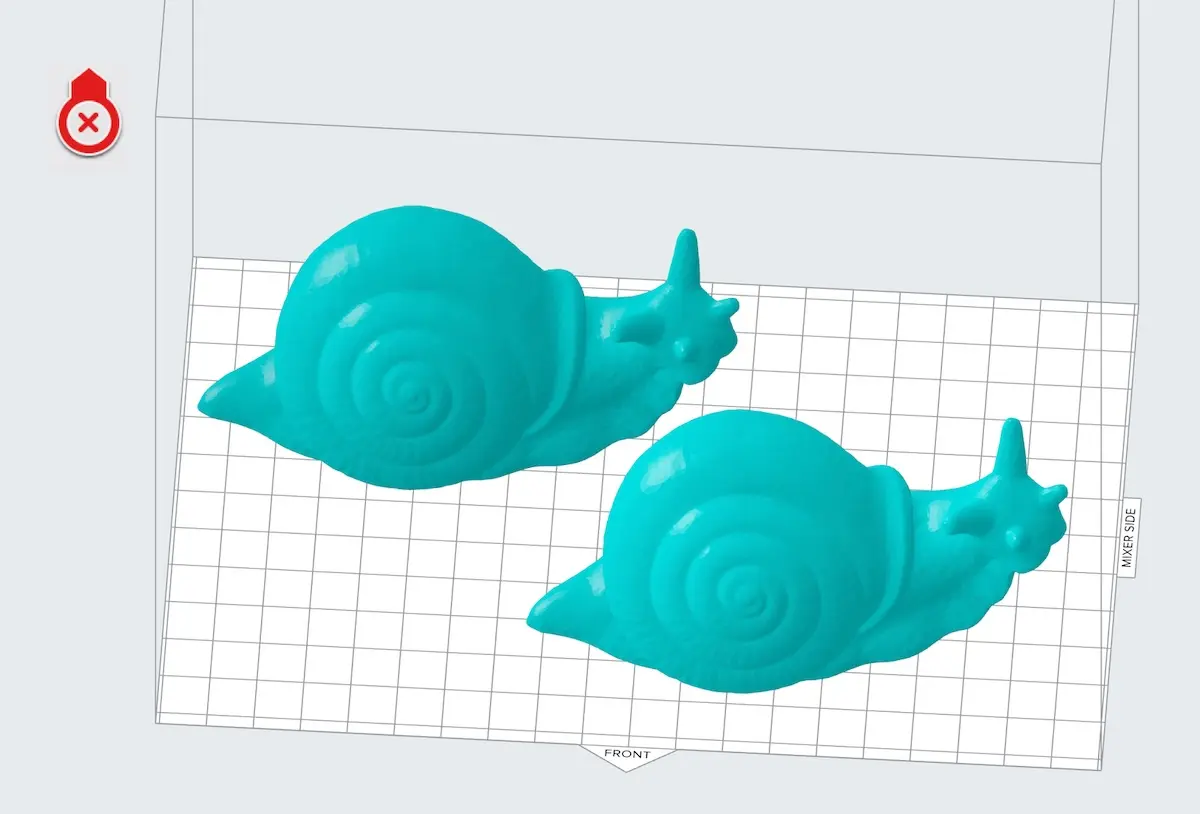

Orient models perpendicular to the front of the build platform
Align the long edge of the models perpendicular to the bend axis of the build platform so that parts are more likely to release. Place models perpendicular to the front of the build scene for easy part removal as the surface flexes.
Parts oriented parallel to the long axis of the Form 4L Flex Build Platform
Parts oriented parallel to the short axis of the Form 4L Flex Build Platform

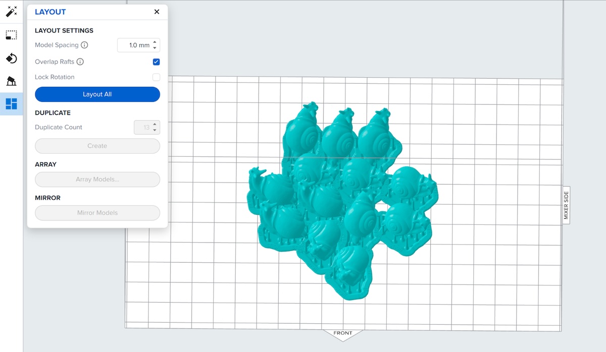

Overlap support rafts on smaller parts
Overlapping rafts of parts to be printed on a Form 4L Flex Build Platform
Note:
Avoid using mini-rafts with the Form 4L Flex Build Platform. The surface area on mini-rafts is too small to release from the flexible print surface when it bends.

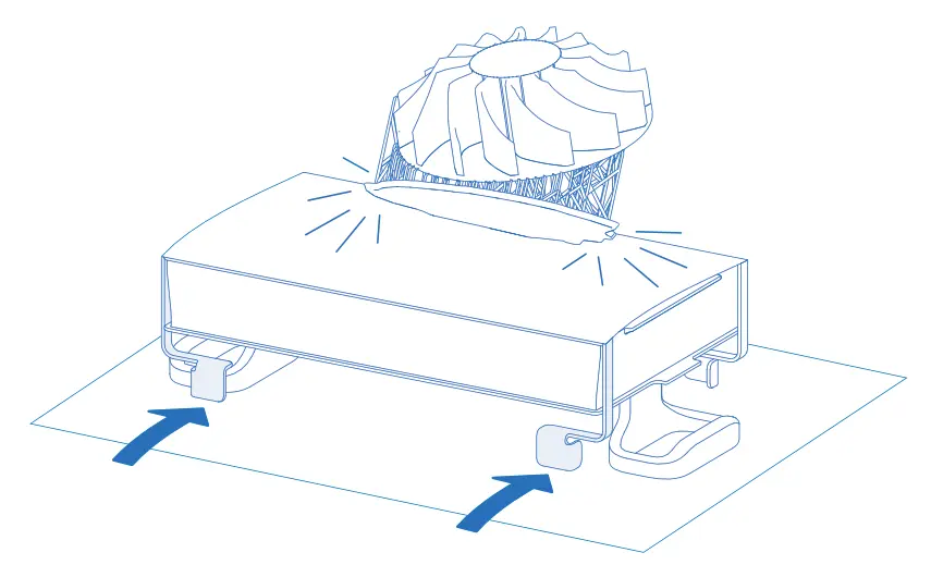

For large parts:
  1. After washing, mount the build platform onto the build platform jig with the printed parts facing up.
  2. Gradually push the part release tabs nearest you forwards with your thumbs.
  3. Parts separate from the build platform as the surface bends.
Removing large parts from the Form 4L Flex Build Platform

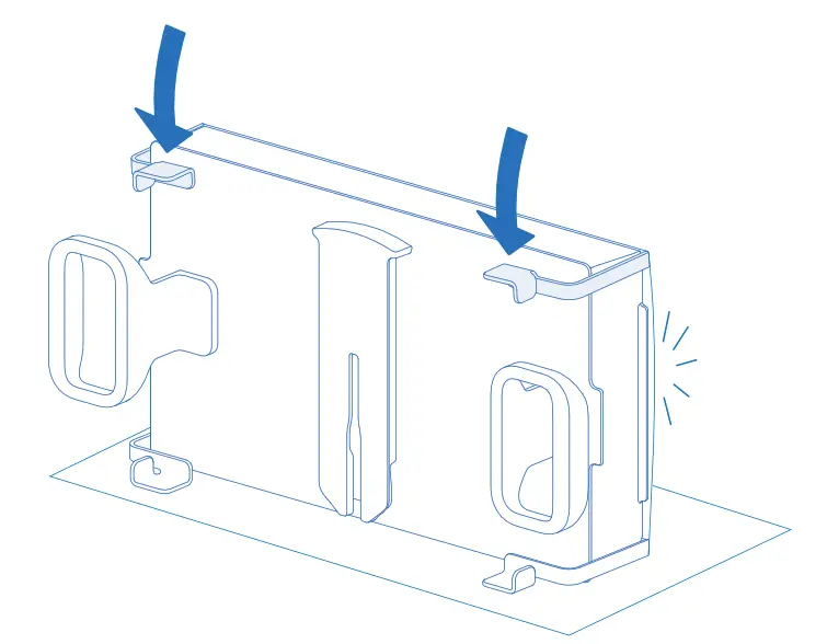

  1. Place the build platform on its side with the printed parts facing away from you.
  2. For better control during part removal, cover the parts with a paper towel to contain them.
  3. Gently press down on the top two part release tabs towards the center of the build platform.
  4. Parts separate from the build platform as the surface bends.
Removing small parts from the Form 4L Flex Build Platform
