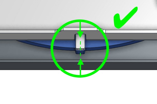

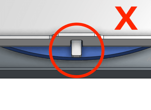

  1. Ensure that the doser plate is oriented such that the metal tabs are aligned. The doser plate is located behind the lower front enclosure panel. If you already replaced these panels after completing the repair, remove them following the instructions in Fuse Sift - Replacing the Doser Assembly [EN]. If the tabs are not aligned, use your hand to rotate the motor gear at the rear of the doser assembly and align the tabs. Take care not to pinch your fingers in the doser gear.
Location of the doser tab in the Fuse Sift
Correct orientation of Fuse Sift doser before calibration
Incorrect orientation of Fuse Sift doser before calibration
