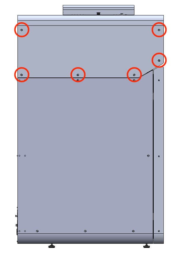

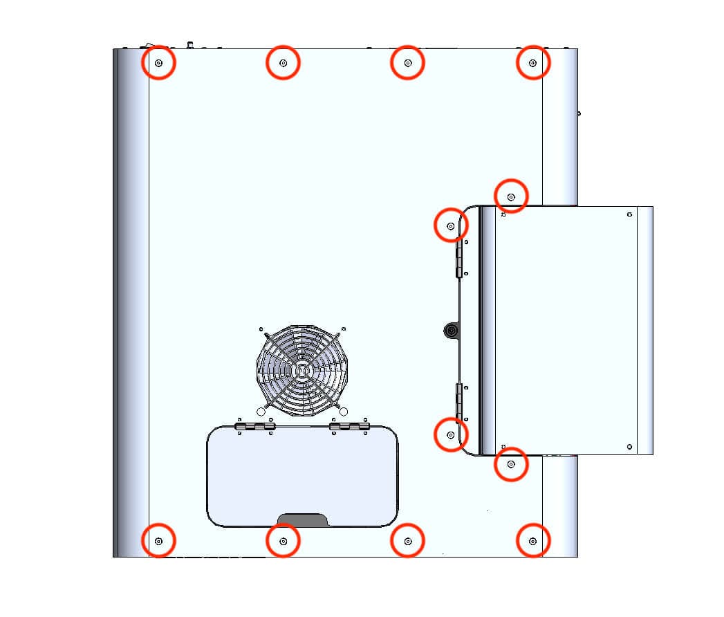

Using a 2.5 mm hex driver, remove the 26 top panel screws securing the top panel to the printer. Set the screws aside.

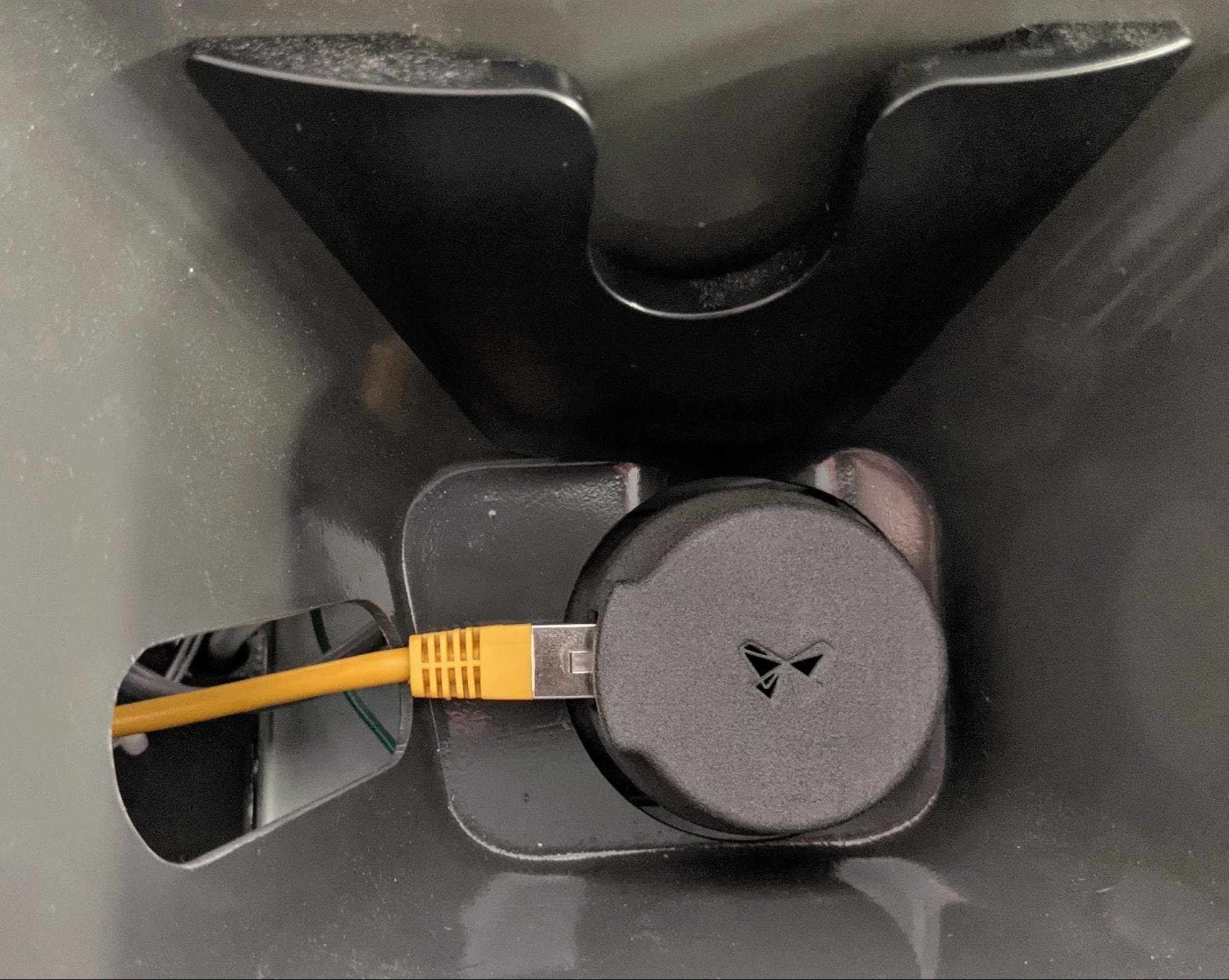

Step 1: Remove the IR sensor
Grip the IR sensor cap and pull. The IR sensor is held in place with magnets and comes out with little force.
Step 2: Unplug the IR sensor ethernet cable
Unplug the IR sensor ethernet cable. Feed the ethernet cable through the plastic shroud so that it drops into the printer. Set the IR sensor aside on a flat surface with the sensor window facing up. If your printer does not have a nitrogen supply, skip ahead to Step 8: Unscrew the upper cooling shroud.

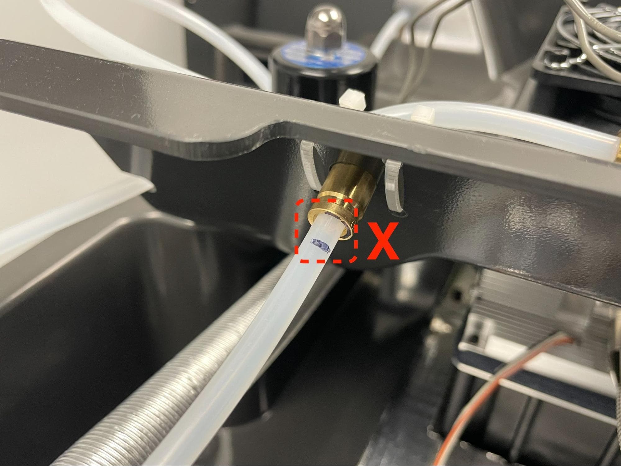

Step 4: Mark the N2 downstream tube (Fuse 1+ 30W only)
Using a permanent marker, mark the N2 downstream tube to indicate its install depth while connected to the N2 T-splitter.
Step 5: Decouple the N2 downstream tube (Fuse 1+ 30W only)
While pulling on the N2 downstream tube, push the brass ring down to decouple the tube from the N2 T-splitter.

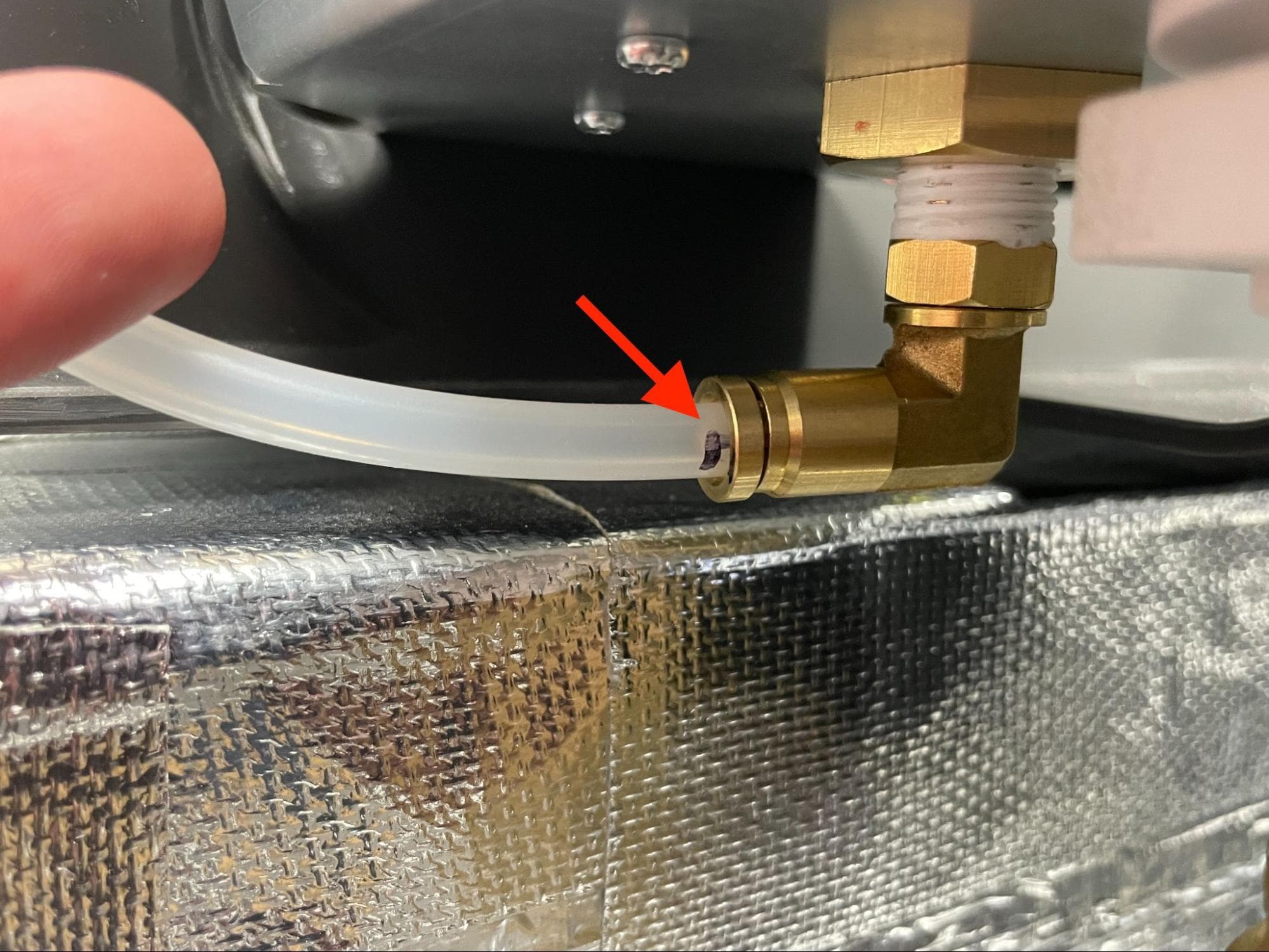

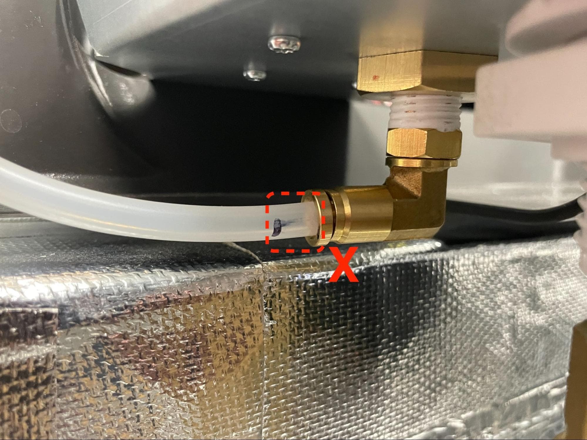

Step 6: Mark the N2 intake tube (Fuse 1+ 30W only)
Using a permanent marker, mark the N2 intake tube to indicate its install depth while connected to the N2 intake plenum.
Step 7: Decouple the N2 intake tube (Fuse 1+ 30W only)
While pulling on the N2 intake tube, push the brass ring down to decouple the tube from the N2 intake plenum.

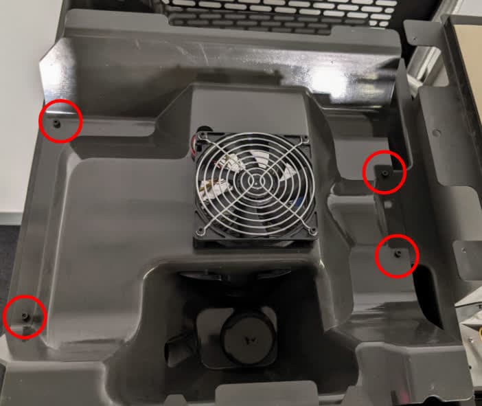

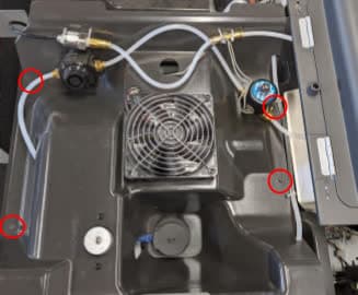

Using a 3.0 mm hex driver, remove the four screws securing the upper cooling shroud to the printer. Newer units also contain four washers. Set the screws and washers, if present, aside.

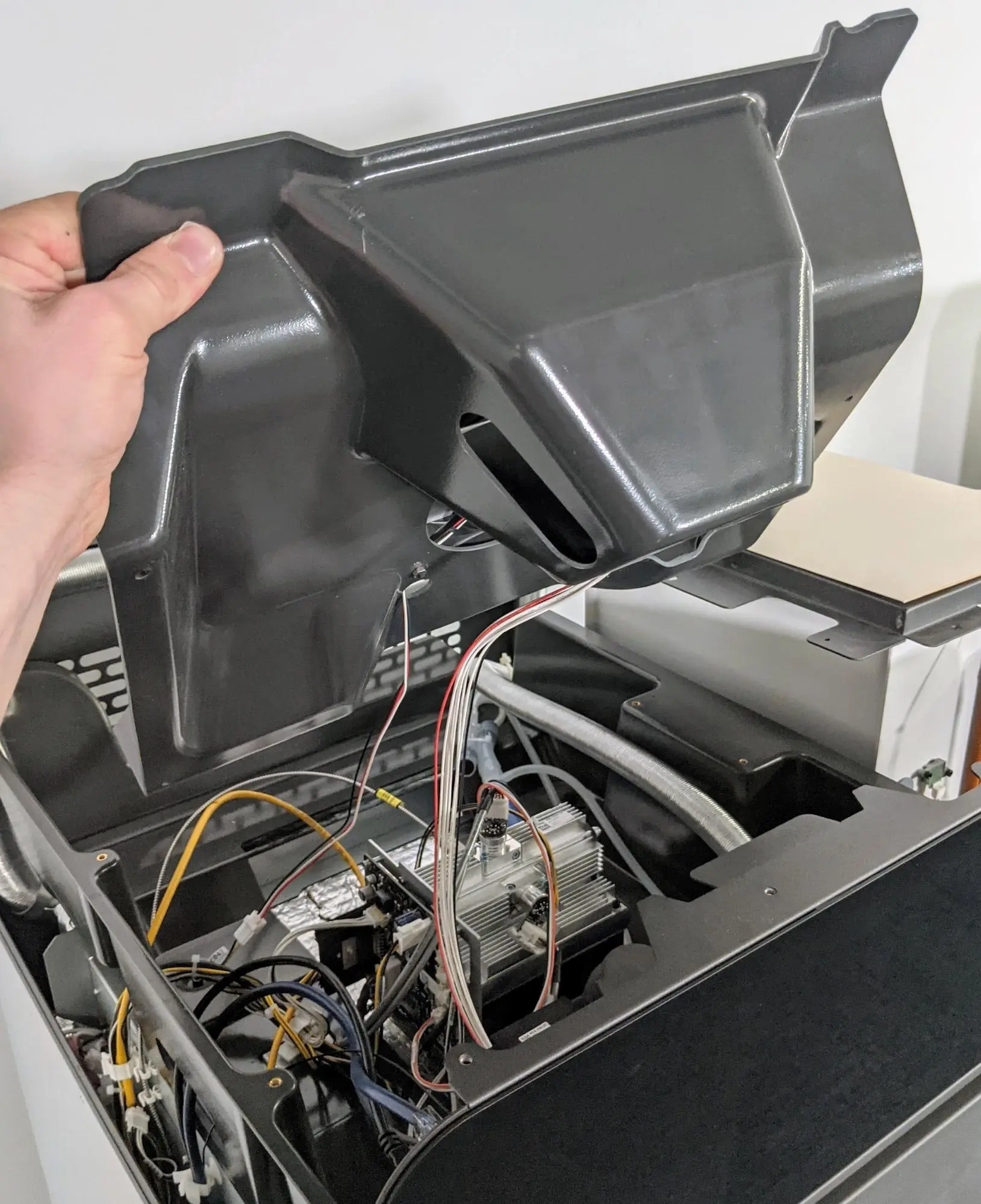

Step 9: Lift the upper cooling shroud
Gently lift up but do not separate the front edge of the plastic shroud from the top of the printer to access the attached cables. Take care not to pull on the cables, as this may damage them.

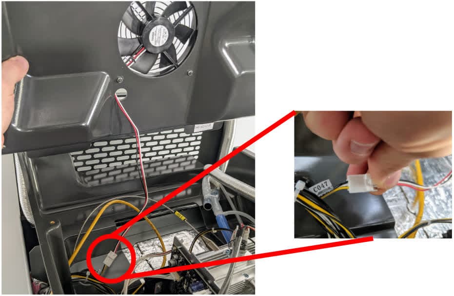

Step 10: Disconnect the fan cable from the upper cooling shroud
Disconnect the fan cable labeled CO47 by squeezing the plastic latch and gently pulling the connectors away from each other. Do not pull on the wires.
Tip:
Formlabs recommends having one person hold the upper cooling shroud while another person unplugs the cables.

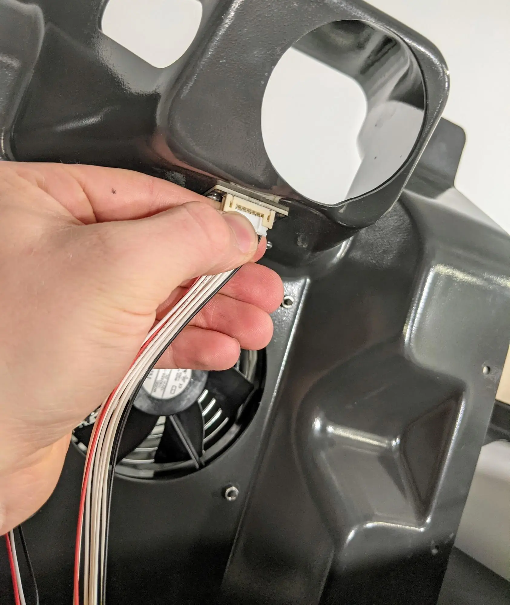

Step 11: Unplug the RFID reader cable from the upper cooling shroud (Fuse 1 only)
Grip the plastic connector on the RFID reader cable and pull directly away from the upper cooling shroud. Do not pull on the wires.

Step 12: Remove the upper cooling shroud
Once all the cables are disconnected, lift the upper cooling shroud away from the machine. Set the upper cooling shroud aside.

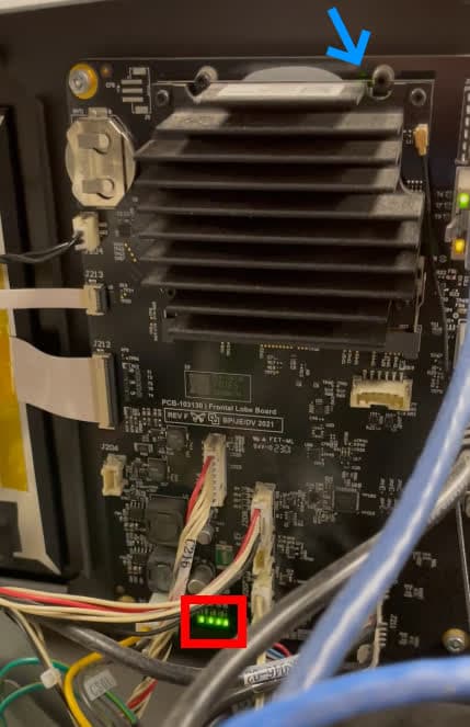

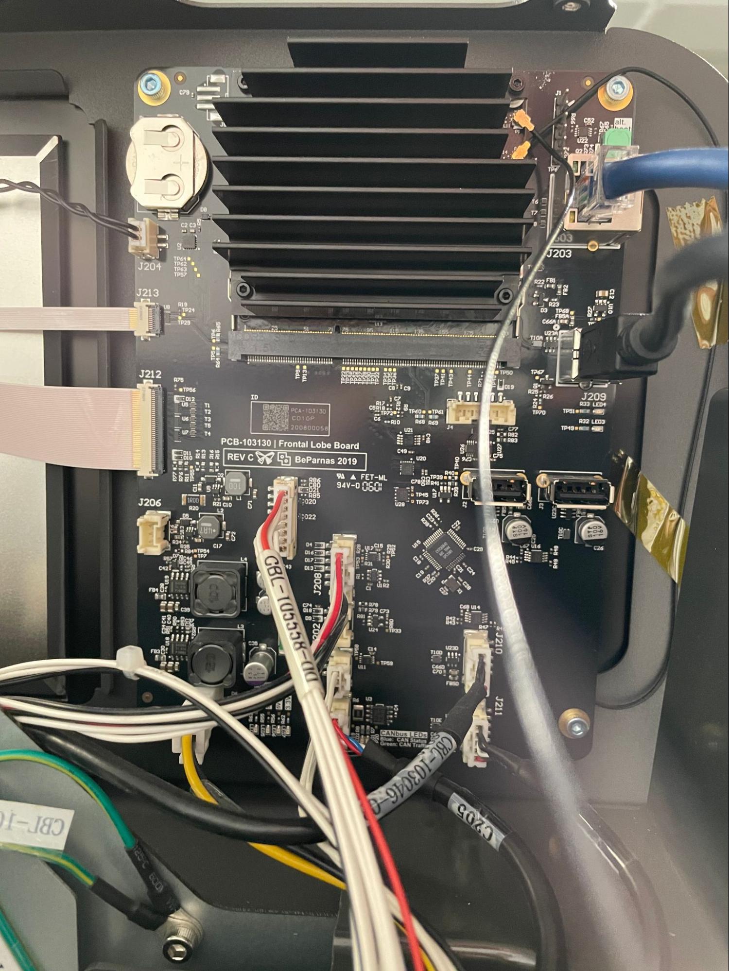

Step 2: Locate the motherboard
Locate the motherboard (also known as a Frontal Lobe board or FoLoBo) on the side of the printer opposite the hopper. It is mounted to the back of the front display panel, and has visible USB and Ethernet connections.
Fuse 1 generation motherboard
Step 3: Inspect the motherboard for illuminated LEDs
The motherboard has two sets of indicator LEDs: one blinking LED behind the SOM at the top of the motherboard and four green LEDs at the bottom. From left to right, the bottom LEDs are labelled:
  • 24V
  • 5V (int)
  • 5V (ext)
  • 3.3V
Inspect the motherboard for illuminated LEDs. Note which LEDs are illuminated, blinking, or off. Take a video of the motherboard LEDs for reference to give to Formlabs Support or your certified service provider.
Fuse 1 generation motherboard LED locations
  • If all LEDs are performing normally: The motherboard and SOM are operating normally.
  • If the SOM LED does not turn on or blink: The SOM may be damaged.
  • If the 24V LED is not illuminated: The PostRock Board may be damaged.
  • If the 5V (int) or 5V (ext) LEDs are not illuminated: The motherboard may be damaged.
  • If the 3.3V LED is not illuminated: The SOM may be damaged.

Step 1: Reconnect the RFID reader cable to the upper cooling shroud (Fuse 1 only)
With one person holding the upper cooling shroud above the printer, reconnect the RFID reader cable into the white connector. The cable will only enter the connector in the correct orientation. Be careful not to bend the pins in the connector. Do not pull on the wires.

Step 4: Secure the upper cooling shroud to the printer
Thread one screw and washer, if present, into each of the four screw holes in the upper cooling shroud. Using a 3.0 mm hex driver, tighten the screws until finger tight. If your printer does not have a nitrogen supply, skip to Step 9: Inspect the IR sensor lens.

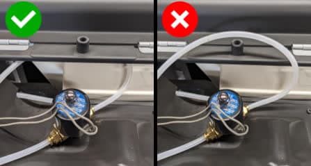

Step 5: Tuck the N2 tube underneath the hopper shroud (Fuse 1+ 30W only)
Tuck the N2 tube connected to the T-splitter and N2 valve under the hopper shroud flange.

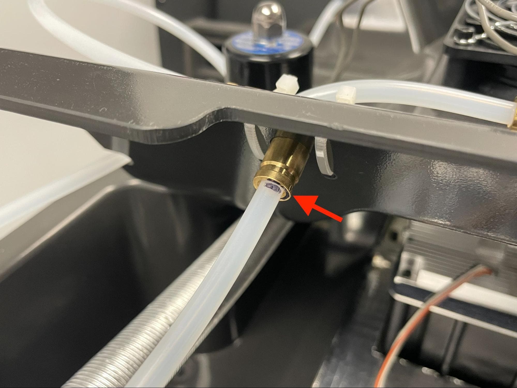

Step 7: Insert the N2 downstream tube into the T-splitter (Fuse 1+ 30W only)
Inserting the N2 downstream tube into the T-splitter
Insert the N2 downstream tube into the middle fitting of the brass N2 T-splitter. Ensure the depth indicator mark aligns with the fitting’s release ring.
Step 8: Insert the N2 intake tube into the intake plenum (Fuse 1+ 30W only)
Insert the N2 intake tube into the N2 intake plenum’s brass fitting. Ensure the depth indicator mark aligns with the fitting’s release ring.

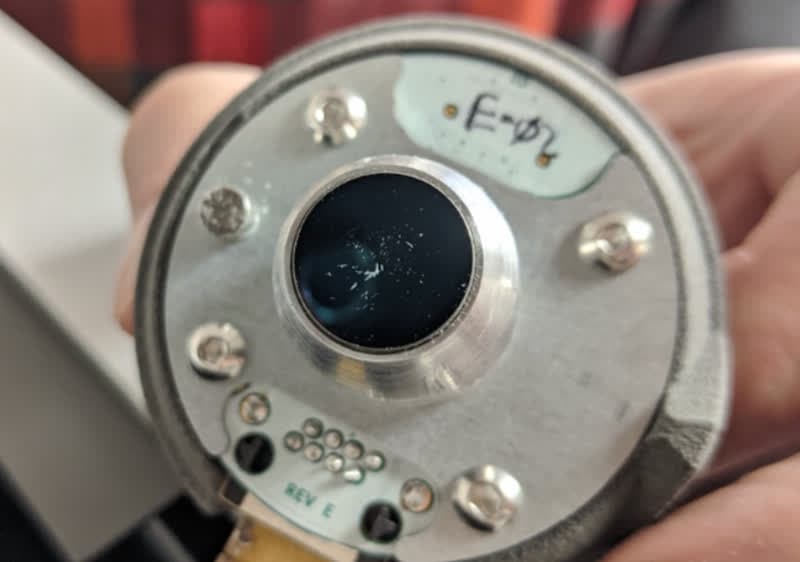

Inspect the IR sensor lens for debris. Clean the IR sensor lens with ethanol and PEC*PAD if needed. Check the lens to ensure that there are no streaks and that the contamination has been fully removed.

Step 10: Reinstall the IR sensor and ethernet cable
Reconnect the ethernet cable to the IR sensor, then push the IR sensor cap into the mount.
