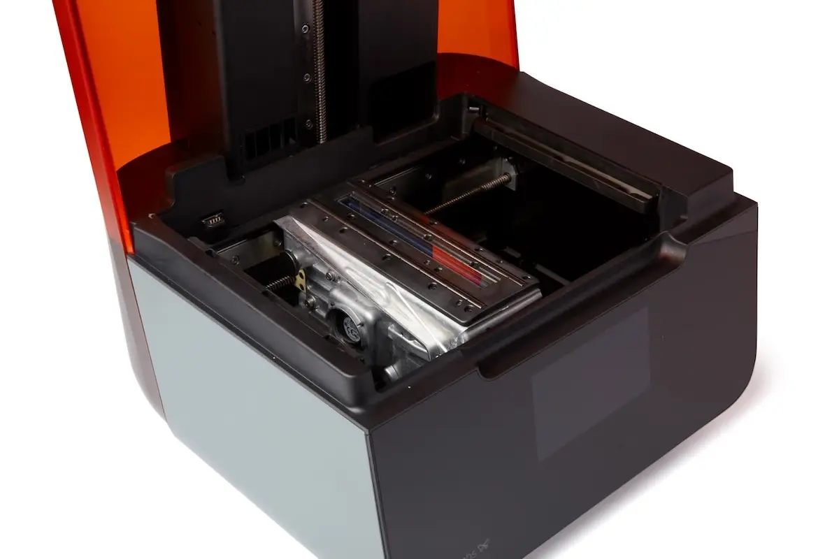

Step 1: Move the LPU to its maintenance position
Tap the wrench icon to access the Settings screen, then tap Maintenance > Motor Moves. The Motor Moves screen appears. Tap and hold Left (<) to move the LPU housing to the middle of the printer cavity. Other controls on this screen fully sweep the LPU housing across the printer cavity and control the build platform carriage.

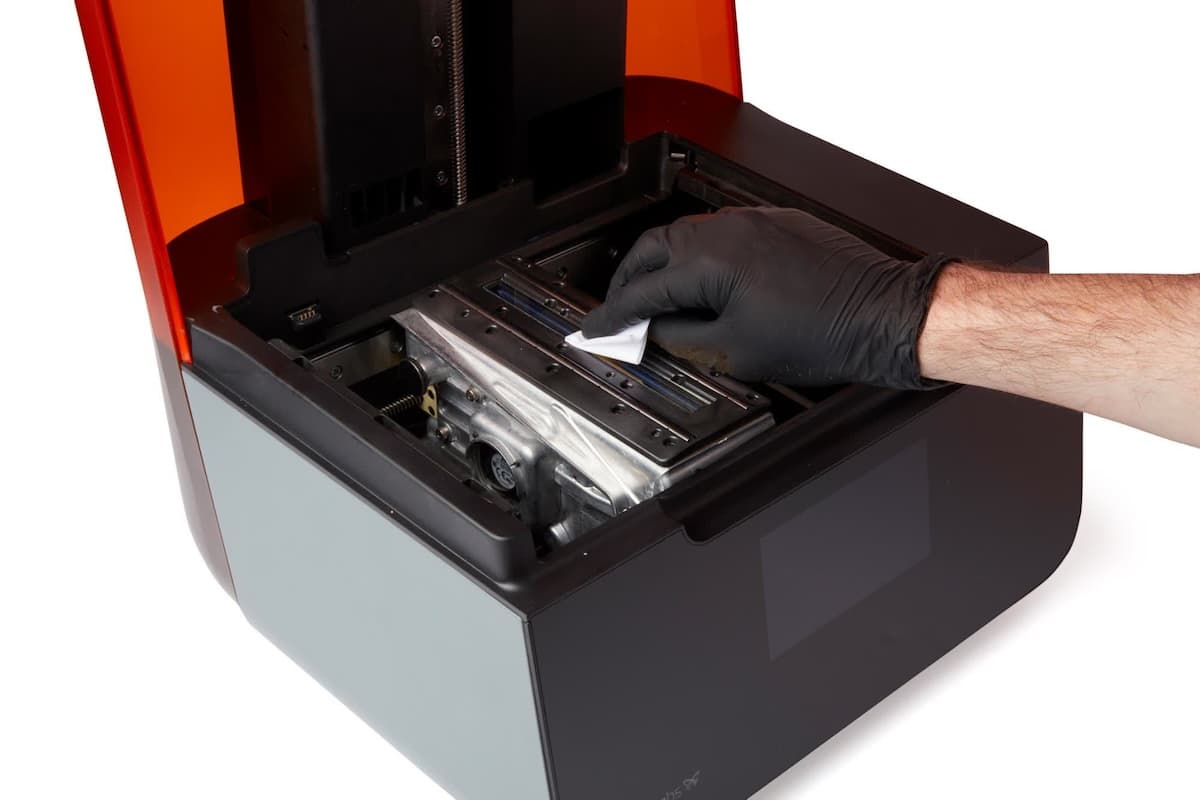

Step 3: Inspect and clean the optical window
Inspect the optical window and the top of the LPU housing for liquid resin. If any liquid resin is present, clean it using a small amount of IPA with a clean microfiber cloth or low-fiber paper towel. Move the cloth slowly to allow the IPA to dissolve the resin. Starting from the far end of the window, wipe slowly, pulling the wipe toward you. Make multiple passes until the entire surface is clean. Allow the surface to dry before using additional IPA with PEC*PADs to wipe the glass surface.

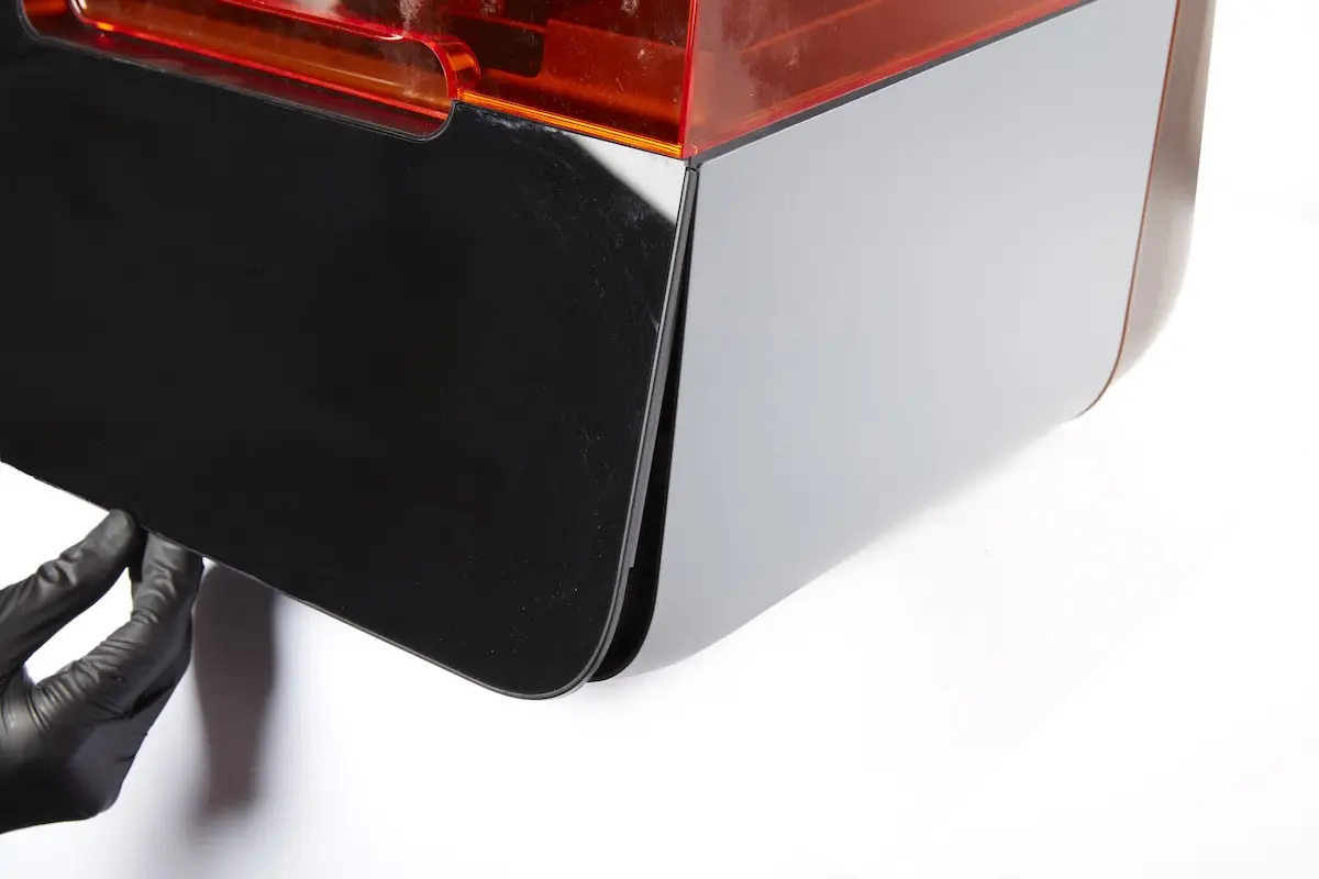

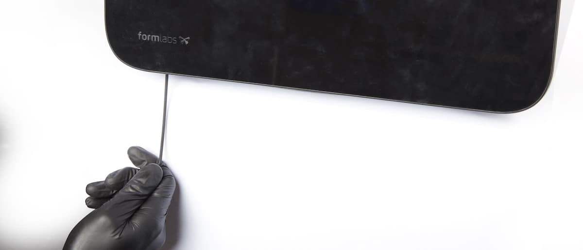

Step 1: Remove the display screws
Place the printer at the front of your work surface so that the front edge of the printer overhangs the front edge of the work surface. Locate the two 2.5 mm hex screws at the front of the bottom shell. These screws secure the display to the printer frame. Use a 2.5 mm hex driver to loosen the two screws. Remove the screws and set them aside.
NOTICE:
Once the two display screws are removed, the display assembly is no longer secured to the printer frame. To prevent damage to the display ribbon cable, read the remaining steps in this guide before continuing.

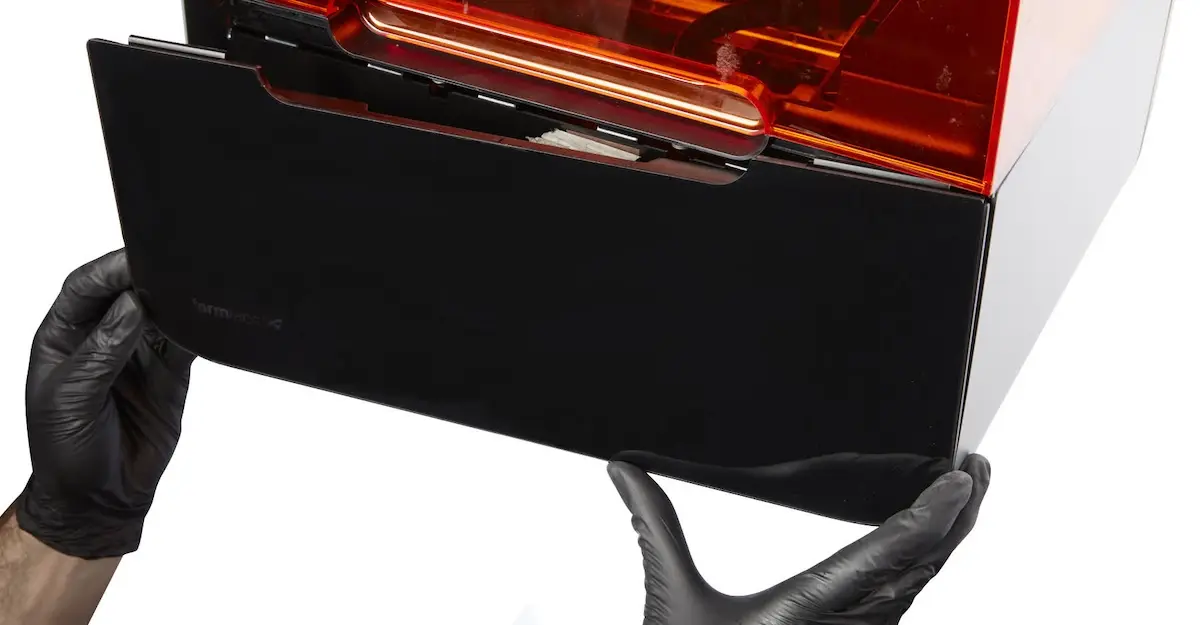

Step 2: Separate the display assembly from the printer frame
The top of the display assembly is held to the printer frame via a set of plastic tabs. Tilt the bottom of the display assembly slightly away from the printer, then lower the display assembly to separate it from the printer frame.

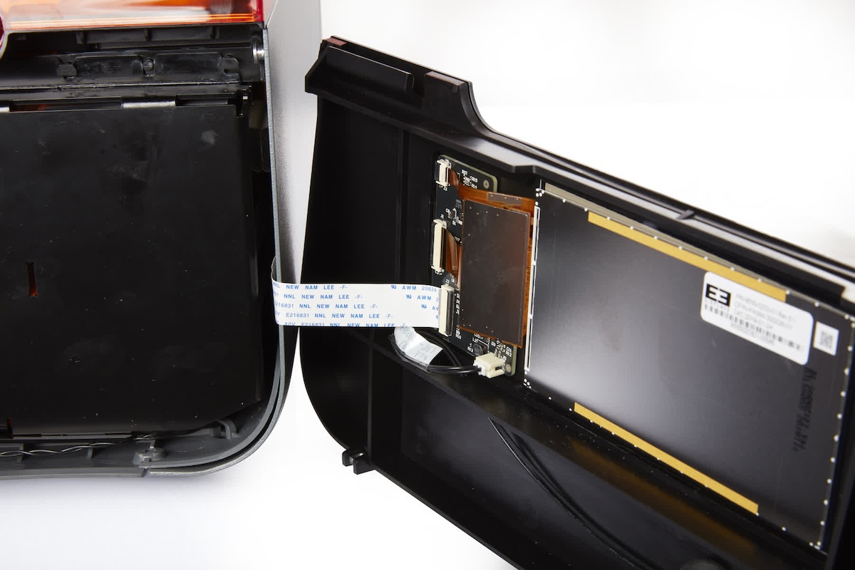

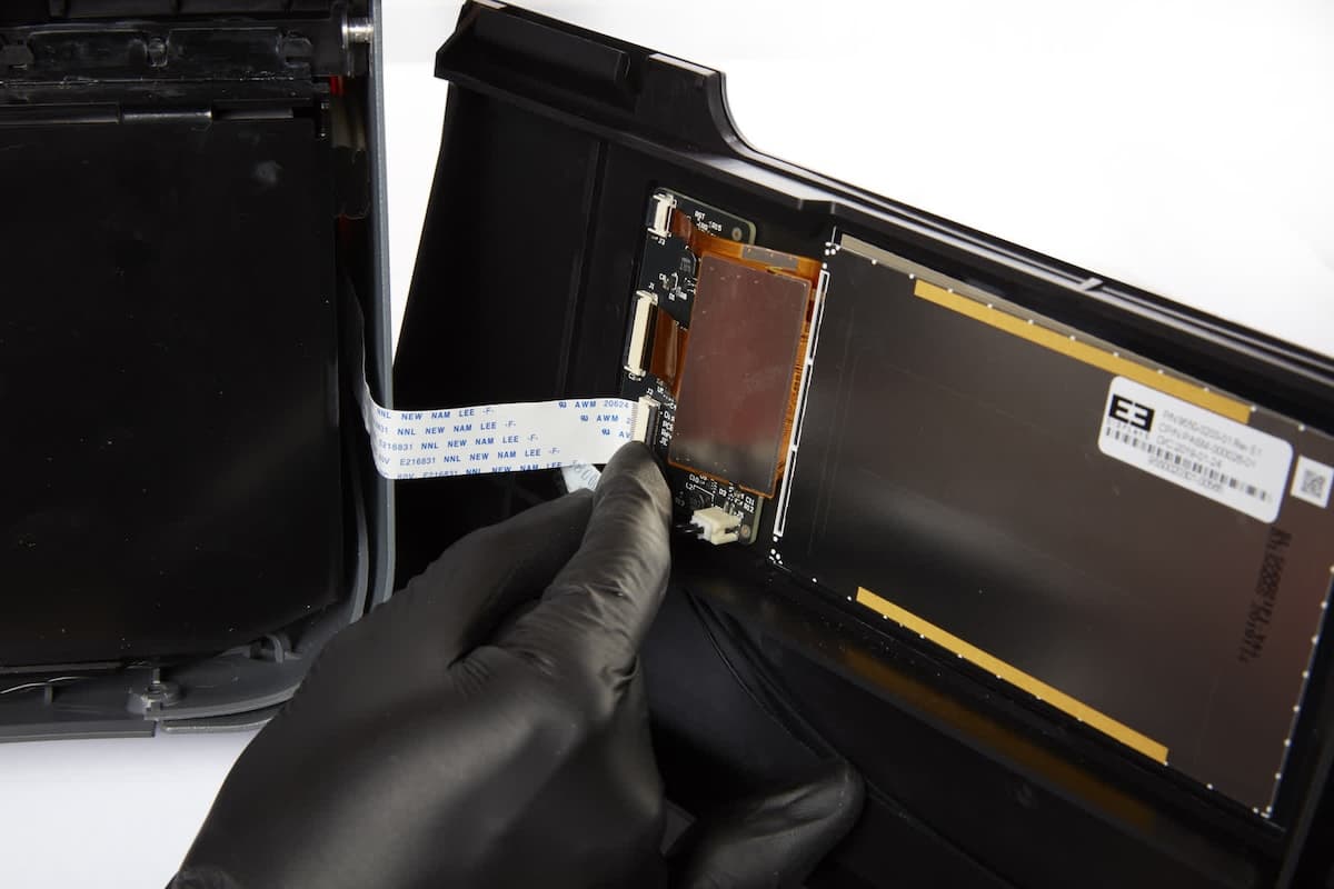

Step 3: Rotate the display assembly
The display ribbon cable connects the display assembly to the printer motherboard. Rotate the display assembly to the right to access the display ribbon cable connector.
NOTICE:
Do not pull on the ribbon cable or pull the display assembly away from the printer. Doing so may damage the display ribbon cable.
The display ribbon cable is secured in the connector with a latch. Lift the latch away from the display assembly to free the display ribbon cable.
Remove the display ribbon cable from the connector and set the display assembly aside.

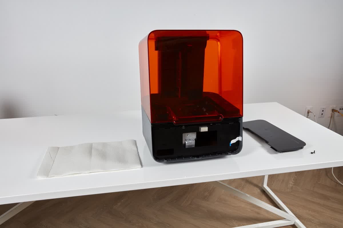

Draining the printer
Overview: Drain any liquid resin out of the bottom shell of the printer.
Step 1: Prepare the workspace
Place a layer of paper towels or other absorbent material in front of the printer.

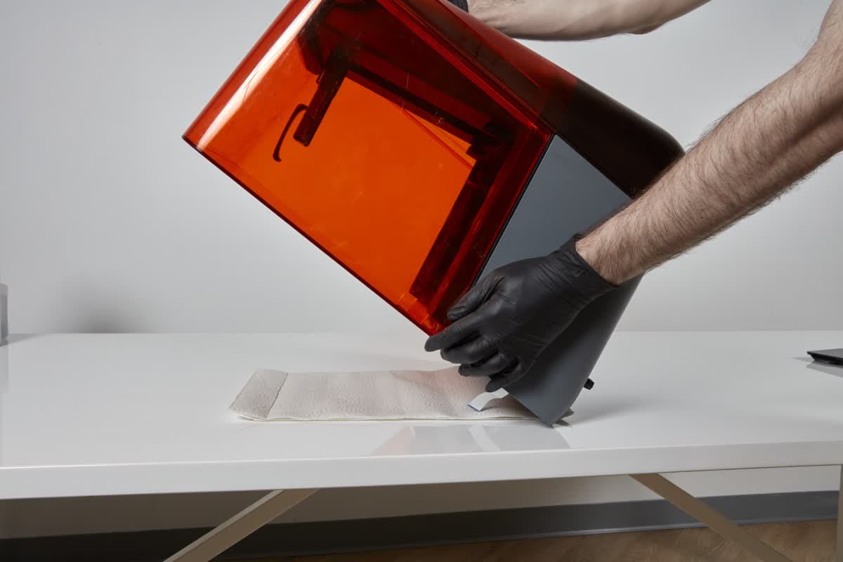

Step 2: Drain the printer
Gently tip the printer forward until it rests face-down on the paper towels. Be sure not to fold or pinch the display ribbon cable and that it is kept away from the paper towels and liquid resin. Leave the printer face-down until it is fully drained.
Step 3: Clean the workspace
Tilt the printer back onto its feet. Collect the paper towels for disposal. Using fresh paper towels, clean any remaining liquid resin on your work surface or the face of the printer.
Always dispose of resin and any supplies contaminated with it according to the SDS. Put the container of soapy water and any soiled paper towels or swabs in a window or other sunny space so that the resin cures in ambient light. Once the resin cures, it can be disposed of with regular household waste.

Step 1: Reconnect the display ribbon cable
Insert the display ribbon cable into the connector on the display assembly, ensuring that the ribbon cable is not twisted or folded.
Step 2: Secure the latch
Rotate the latch towards the display assembly to lock the display ribbon cable in place.
Step 3: Install the display assembly
Insert the tabs on the top edge of the display assembly underneath the top shell of the printer. Tilt the bottom edge of the display assembly towards the printer until it lies flush with the bottom shell and side shells. Ensure that the display ribbon cable is not caught between the display assembly and the printer frame.
Step 4: Secure the display assembly
Thread the two 2.5 mm hex screws into the holes at the front of the bottom shell. Use a 2.5 mm hex driver to tighten the screws until snug.
