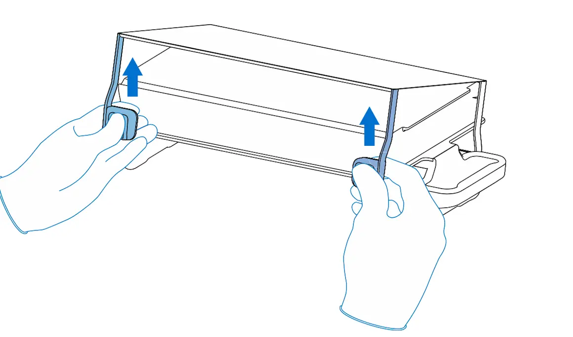

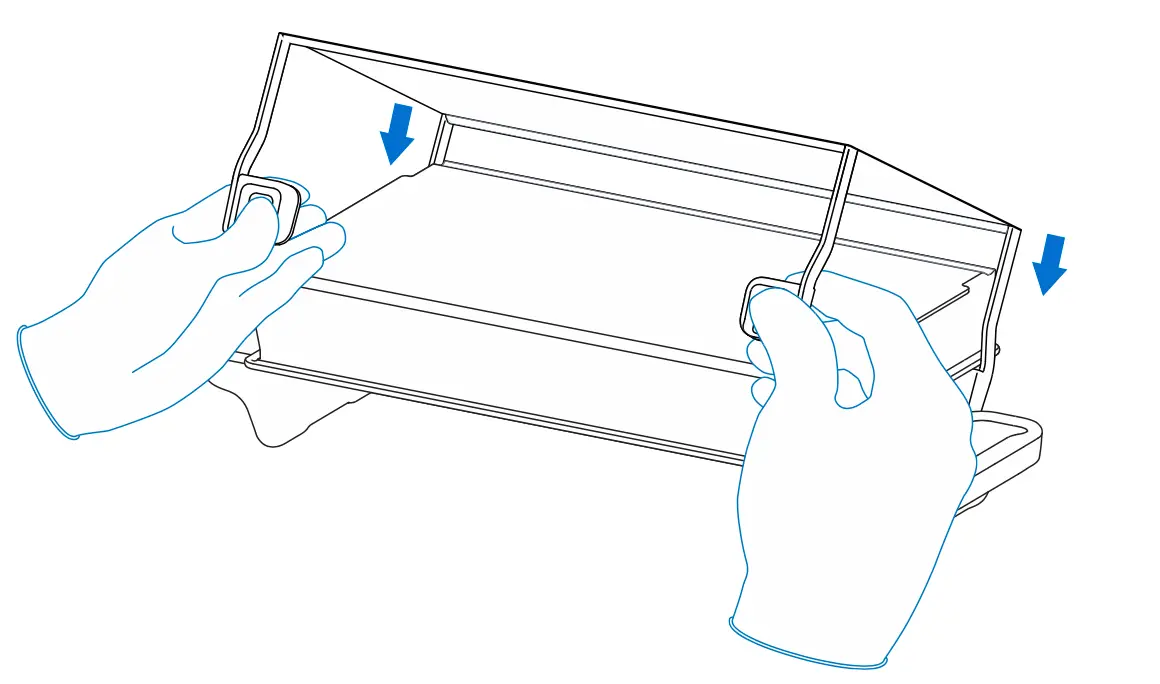

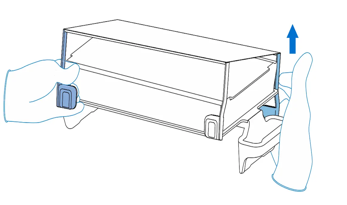

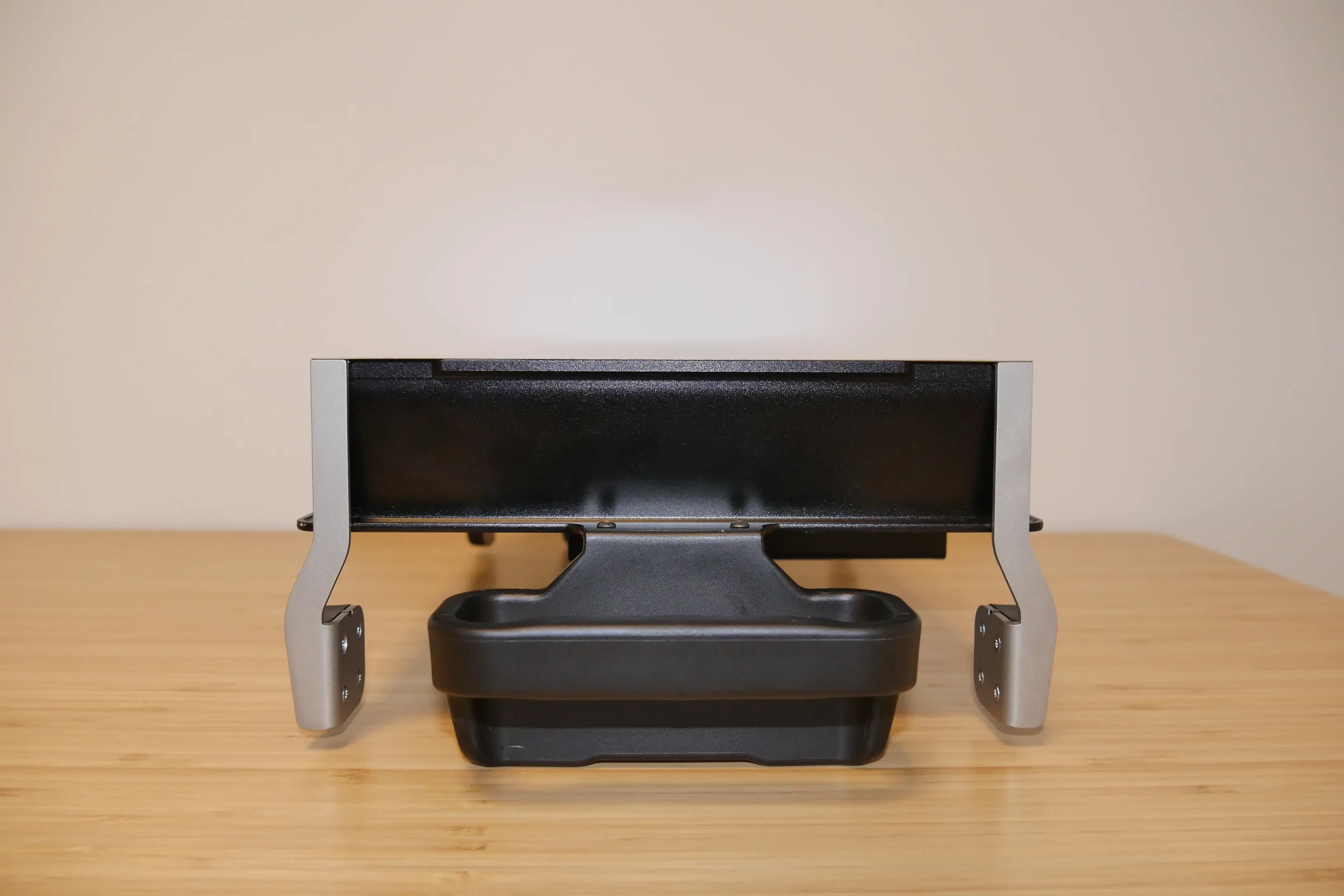

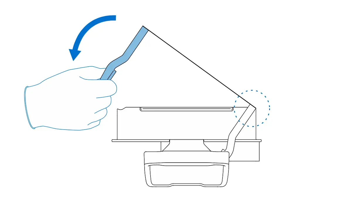

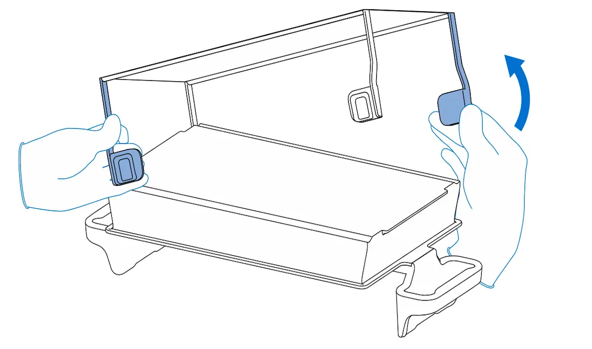

If you are changing resins between prints, remove the print surface from the build platform body to make sure all surfaces are thoroughly cleaned.
Caution:
To prepare your Build Platform 2L for a new print with a different resin:
Step 1: Remove the print surface
Step 2: Clean the Build Platform 2L
Step 3: Reinstall the print surface
