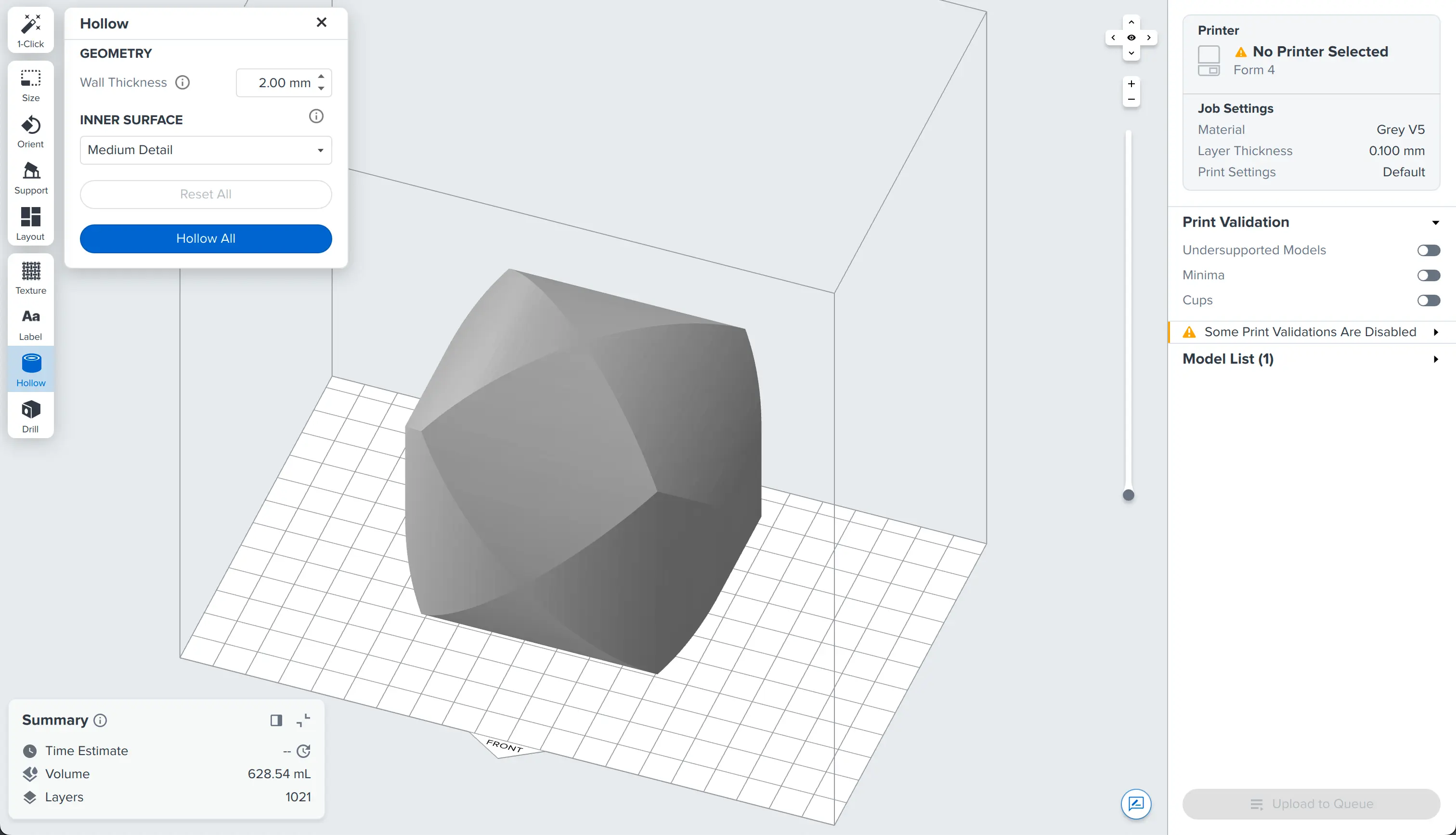

To hollow models using the Hollow tool:
  1. Click Hollow on the toolbar to the left of the 3D scene. The Hollow panel appears.
  2. Set your desired Wall Thickness. Model regions thinner than twice the selected Wall Thickness will not be hollowed.

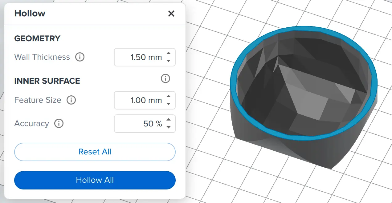

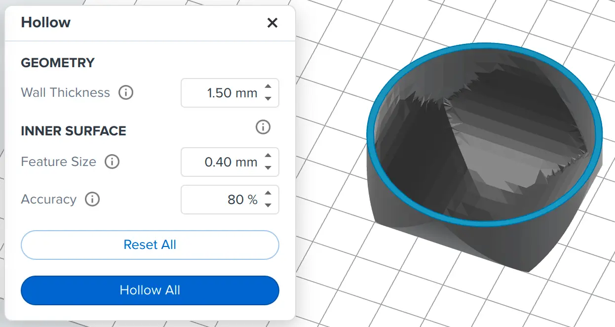

  3. Use the Feature Size and Accuracy parameters to set the level of detail for the inner surface of the hollowed model.
    • Feature Size: Reducing it smooths internal surfaces, but PreForm may take longer to hollow the model and generate a larger FORM file.
    • Accuracy: How closely internal features match outer features depending on Wall Thickness. Increasing Accuracy improves the quality of the internal surfaces of the hollowed model, but it may take longer to hollow the model.
A model hollowed using the default settings
A model hollowed with high inner surface detail.

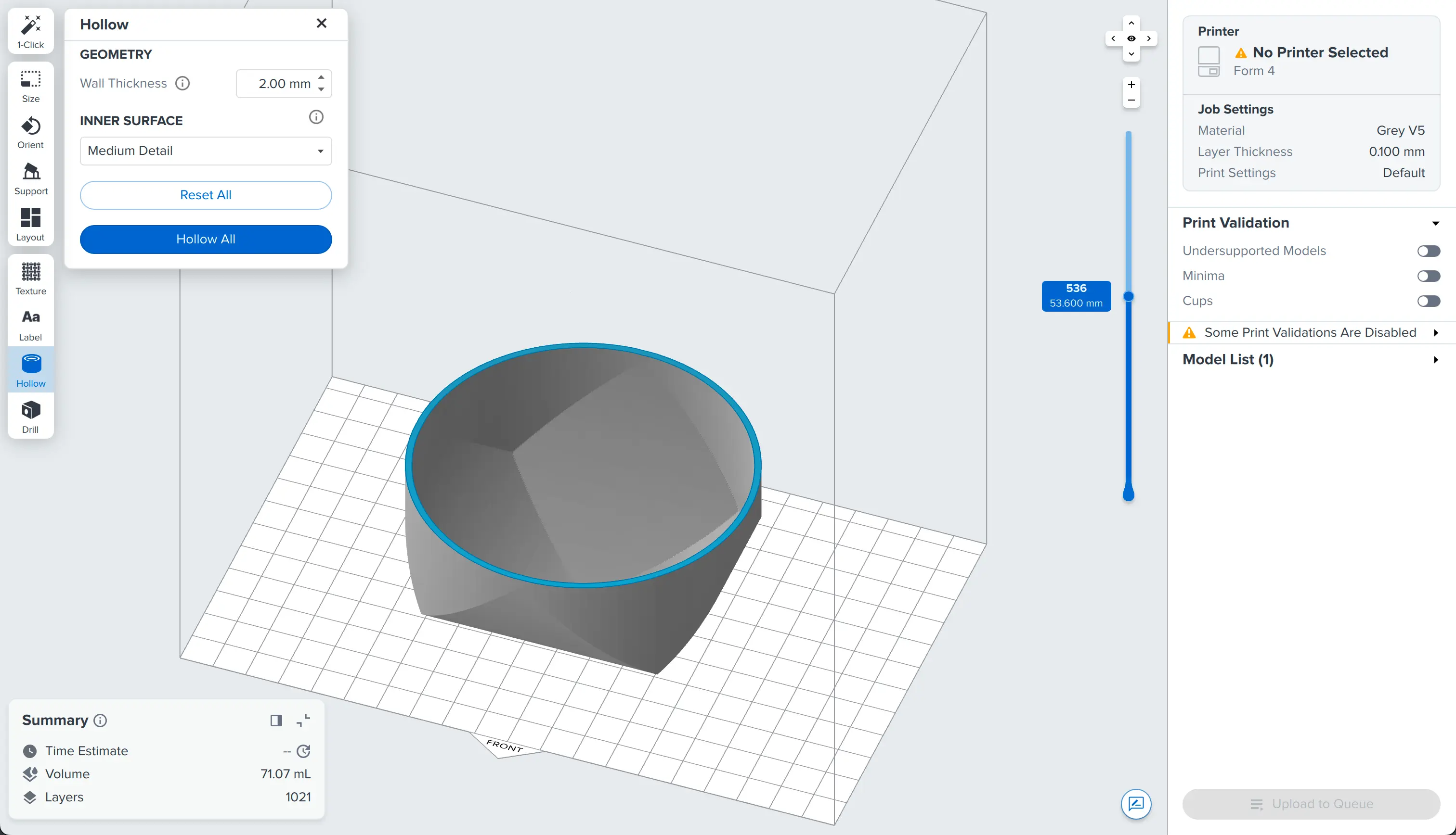

  1. To hollow all open models, ensure that no models are selected and click Hollow All.
  2. Select one or more models and click Hollow Selected to hollow only the selected models.
    • Click Reset All or Reset Selected to restore the original models.
Model hollowed using PreForm
