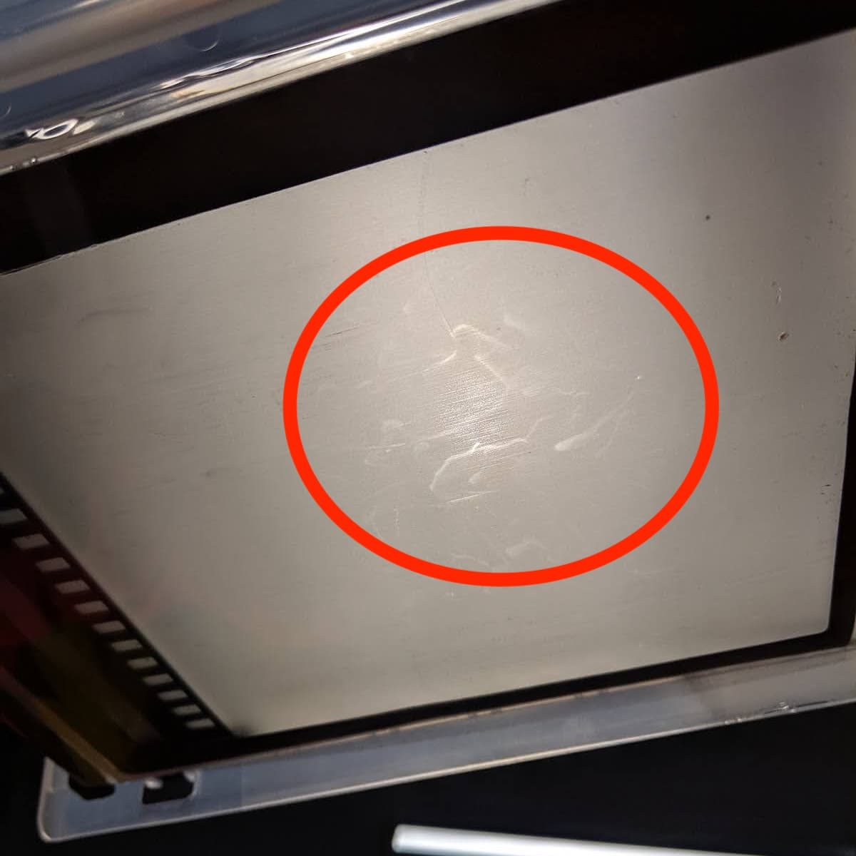

Marks on lower film (polishing)
During a print, the two tank film layers rub against one another. Over time, this friction can polish the film and make it appear clearer than the film in an unused tank. This is a normal result of printing and does not damage the tank or affect print quality.
Polishing marks on a Form 3 resin tank

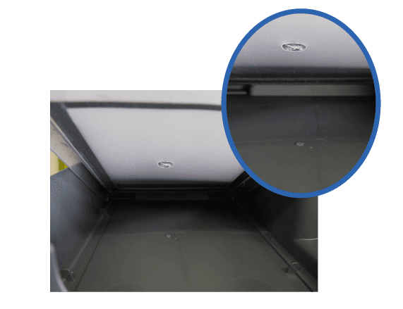

Resin caught between film layers (optical coupling)
Holes in the resin tank film layers may be hard to spot as the air gap between the layers makes the tank bottom appear translucent. Usually, only the top layer of film is punctured. If this happens, resin can leak into the gap between the two layers. Resin trapped between the two film layers forms a transparent blemish in the resin tank. Cured resin or air bubbles may also stick to the inside of the tank near the puncture.
Resin caught between film layers in a Form 3 resin tank
Resin does not spill into the printer unless both film layers fail. To prevent a possible resin spill, dispose of damaged tanks immediately. Do not attempt to print around the damage. If you have any questions about the tank damage, please contact Formlabs Support.

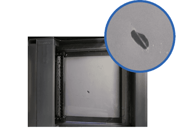

Gouges and punctures through both film layers
Gouges and punctures damage both layers of a resin tank's film. A gouged or punctured tank requires immediate disposal and replacement. Gouges and punctures in the resin tank film not only bend light and prevent the laser from curing resin properly during normal printing, but also present a leak risk. Resin may leak out of the tank, leading to damage to your printer. If you have any questions about the tank damage, please contact Formlabs Support.
Top view of a puncture in a Form 3 resin tank
Bottom view of a puncture in a Form 3 resin tank
Common causes for gouges and punctures include:
  • Using a sharp tool inside the tank
  • Using excessive force to scrape the tank
  • Print failures

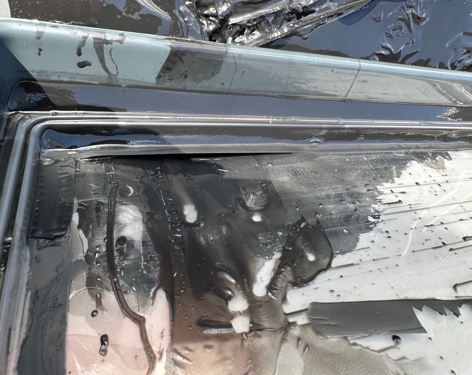

VHB tape tearing
Over time, exposure to resin weakens the VHB tape that secures the tank film to the tank frame. This issue is especially prevalent in tanks used with materials that require a lot of mixing (e.g., Durable Resin, Flexible 80A Resin, and Elastic 50A Resin), tanks used with chemically aggressive resins, and tanks that have reached their maximum lifetime. The tape may peel off the tank frame and float inside the resin tank or attach itself to a printed part.
For more information about chemically aggressive resins and tank lifetime, see:
If you see the VHB tape peeling in printed parts or in the resin tank itself, immediately dispose of and replace the resin tank. If you have any questions about the tank damage, please contact Formlabs Support.
VHB tape peeling off the tank frame and into the resin tank

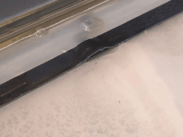

VHB tape failure
The adhesive that secures the VHB tape to the tank's film can degrade over time, especially from exposure to chemically aggressive resins in tanks that have reached their maximum lifetime. While the majority of the tape may stay intact, any separation can cause resin to leak between the layers of the tank film or spill into the printer.
If you see the VHB tape separating from the tank film, immediately dispose of and replace the resin tank. If you have any questions about the tank damage, please contact Formlabs Support.
VHB tape separating from the tank frame

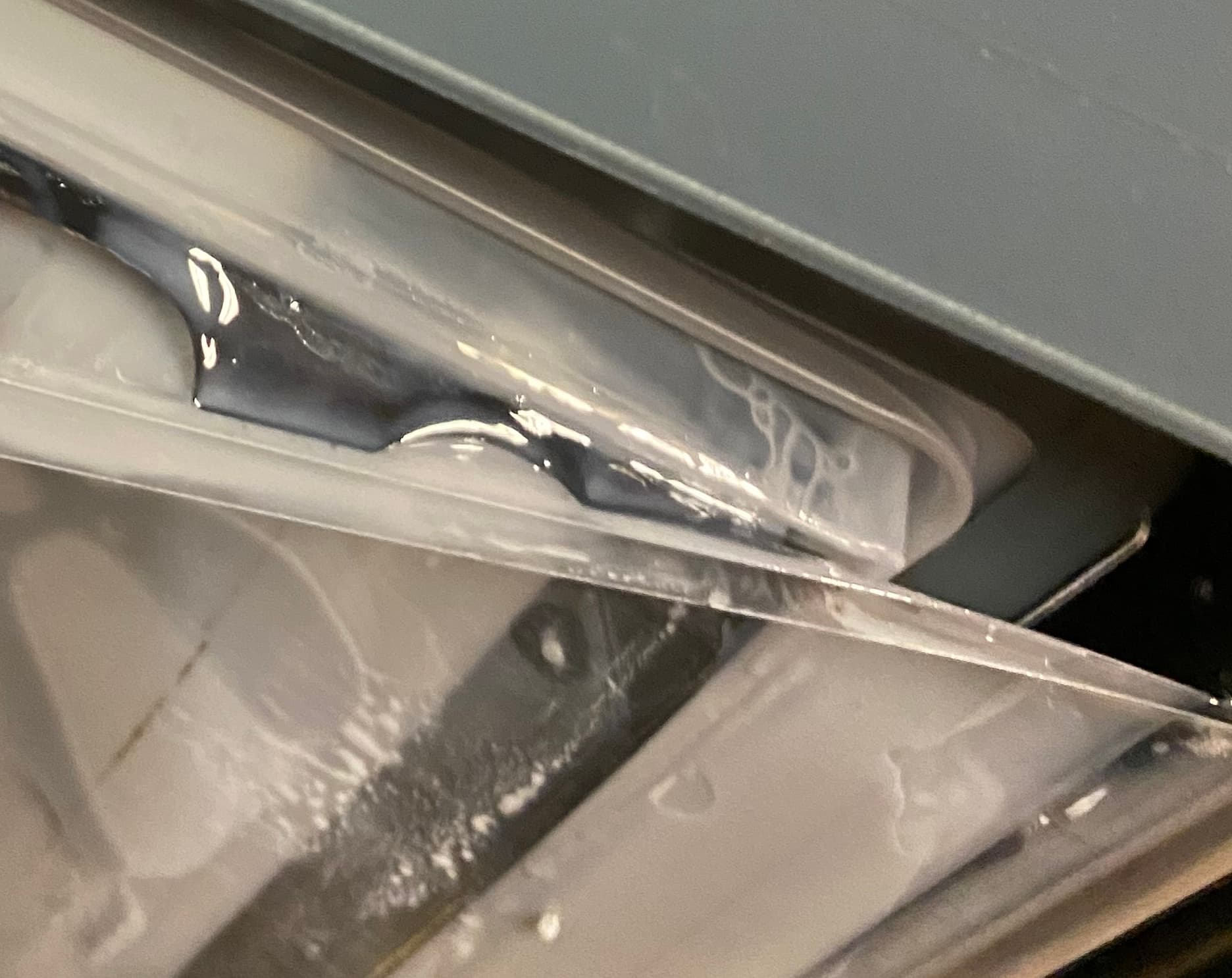

Significant VHB tape separation
In rare cases, the adhesive that secures the VHB tape to the tank film fails completely, even after short-term use of a resin tank. This significant separation can cause extensive resin spills inside and outside the printer.
If you see the VHB tape separating from the tank film, immediately dispose of and replace the resin tank. Make sure to clean up any resin spills before continuing to print.
Tank film peeling off the tank frame
Resin spill due to VHB tape separation
