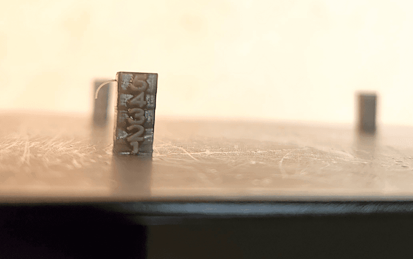

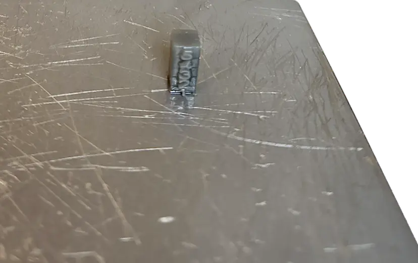

“Overcompression” describes a print defect in which reduced space between the build platform and resin tank causes the initial layers to be very thin. The rest of the part prints, but the initial layers are flattened and may be very difficult to remove from the build platform.
alttext
alttext
Tip:
Some compression is normal. The first few layers will always be thinner than the rest of the part.
Visual symptoms
  • The raft is compressed and thinner than expected.
  • Parts are especially difficult to remove.
  • The raft is completely flat and supports are significantly shorter than expected.
