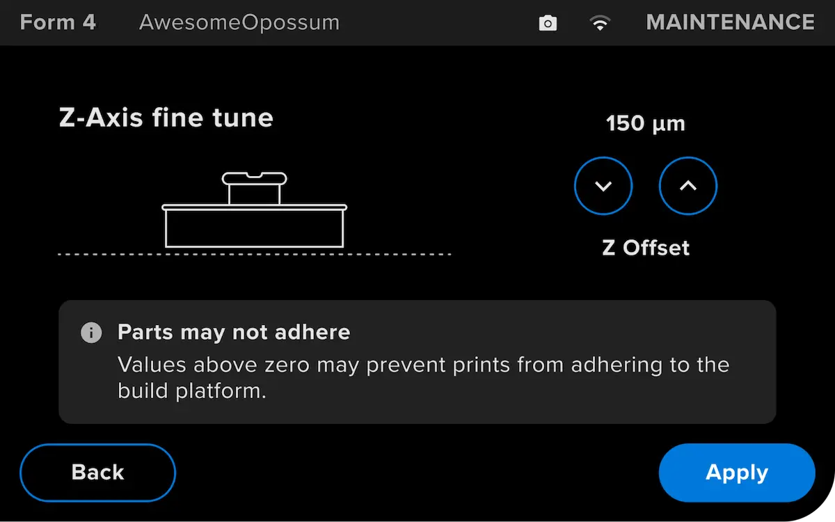

Fine tune the Z-axis
Z-Axis Fine Tuning changes the height of the build platform above the tank’s flexible film before the first layer adheres to the build platform. Small adjustments adding to the build platform’s height may correct Z-compression in models.
Tip:
Your PreForm settings do not change when adjusting the Z-axis.
To fine tune the Z-axis on a Form 4 or Form 4L generation printer:
  1. Update the printer’s firmware.
  2. Ensure that the printer is not running a print job and is currently Idle.
  3. Tap the gear icon on the printer’s touchscreen. The Settings screen appears. Tap Tools > Calibration > Z-Axis Fine Tune.
  4. Tap the ˄ button above Z Offset to raise the default position of the build platform and increase the value in increments of 50 µm. The highest available Z Offset value is 1000 µm.
    • Depending on your printer’s firmware version, the value may be displayed as an integer or with multiple decimal places.
  5. Start by changing the Z Offset value to 50 µm. Tap Apply to save the value and return to the Settings screen.
  6. Print small models to test the change and continue to adjust the value until models print with consistent supports and rafts.
Tip:
Adjust the build platform height in increments of 50 µm, then print small models to test the change and continue to adjust the value until models print with consistent supports and rafts.
Note:
Using the Align build platform calibration tool resets the Z Offset value to 0 µm.

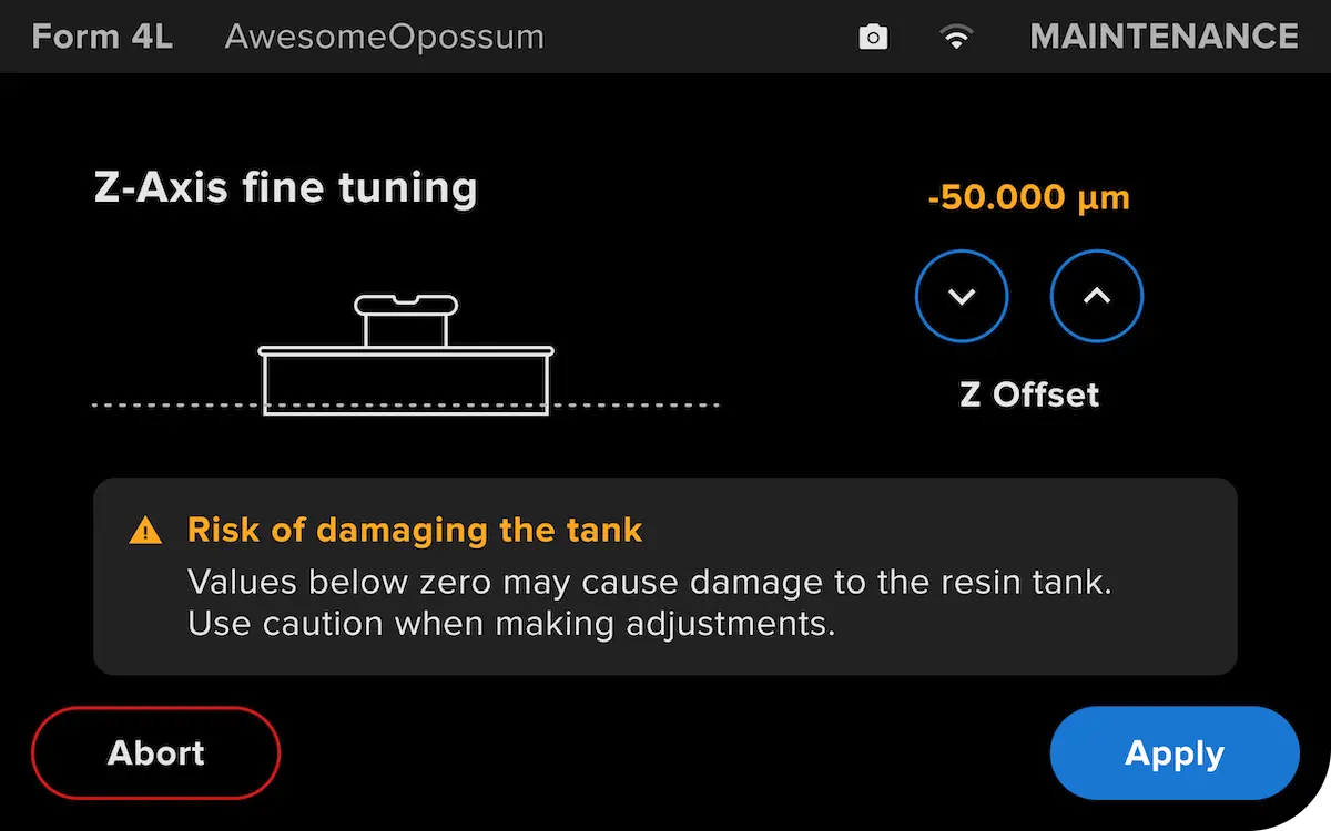

Correcting non-adherence
Prints that run without an error but leave the build platform empty are examples of non-adherence. This can be corrected by either lowering the build platform or by recalibrating the Z-axis.
Note:
Make sure that your firmware and PreForm versions are up to date. To check your printer’s firmware version, refer to the support article Checking the firmware version for Formlabs SLA printers. To update your PreForm version, refer to the FAQ article How do I update PreForm?.
Z-Axis Fine Tuning changes the height of the build platform above the tank’s flexible film before the first layer adheres to the build platform. Small adjustments lowering the build platform’s height may correct non-adherence in models.
Tip:
When adjusting the Z-axis your PreForm settings do not change.
To fine tune the Z-axis on a Form 4 generation printer:
  4. Tap the ˅ button above Z Offset to lower the default position of the build platform and decrease the value in increments of 50 µm. The lowest available Z Offset value is -1000 µm.
  5. Start by changing the Z Offset value to -50 µm. Tap Apply to save the value and return to the Settings screen.
  6. Print small models to test the change. Continue to adjust the value until models print with consistent supports and rafts.
Tip:
Adjust the build platform height in increments of -50 µm, then print small models to test the change and continue to adjust the value until models print with consistent supports and rafts.
Note:
alttext
