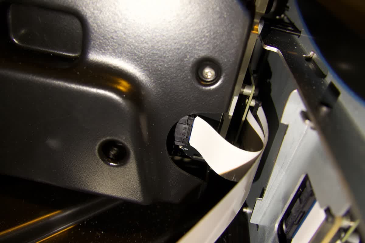

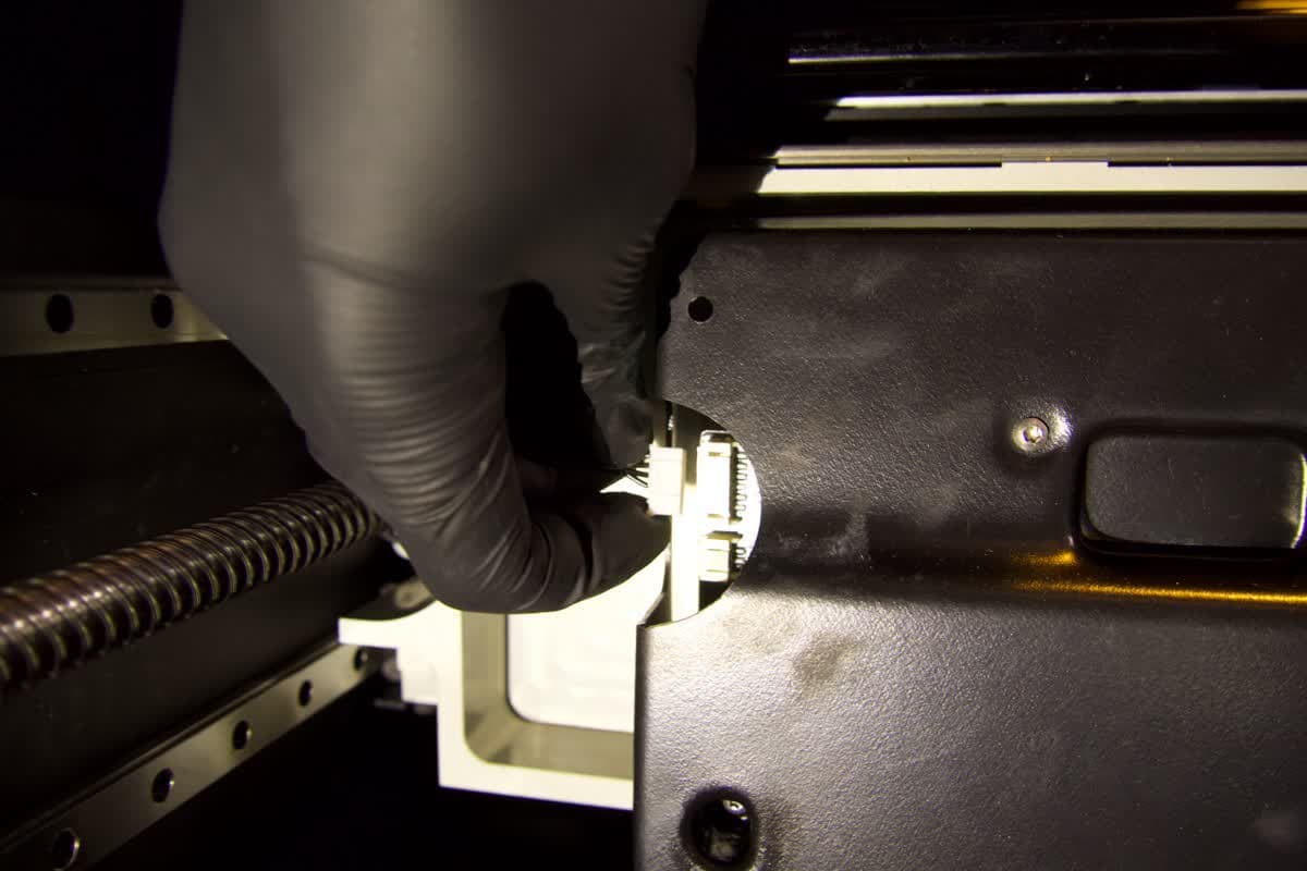

Step 2: Disconnect the ribbon cable

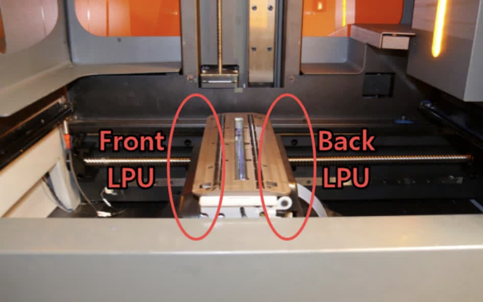

Both LPUs have a ribbon cable connected to it. The front LPU, accessible from the left side of the LPU housing, has its ribbon cable connected to the end of the LPU oriented toward the front of the printer. The rear LPU, accessible from the right side of the LPU housing, has its ribbon cable connected to the end of the LPU oriented toward the rear of the printer. Locate the ribbon cable for the LPU you are replacing.
NOTICE:
The LPU ribbon cable is delicate. Do not bend, fold, or otherwise damage the ribbon cable.

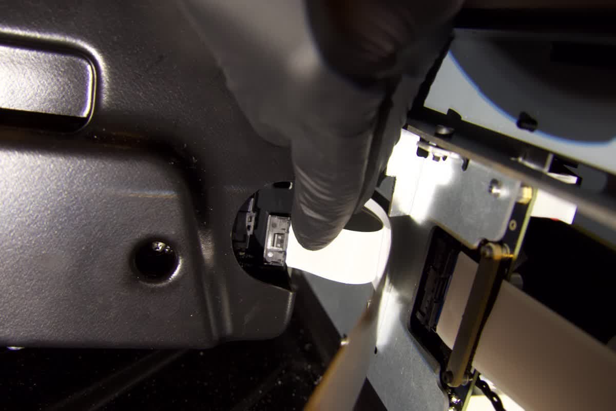

There is a small tab at the base of the ribbon cable plug. Press it inward, toward the cable/LPU, and gently pull on the plug to disconnect the ribbon cable from the LPU. You may find it easier to use a small plastic tool, such as a pair of tweezers, to press on the tab.

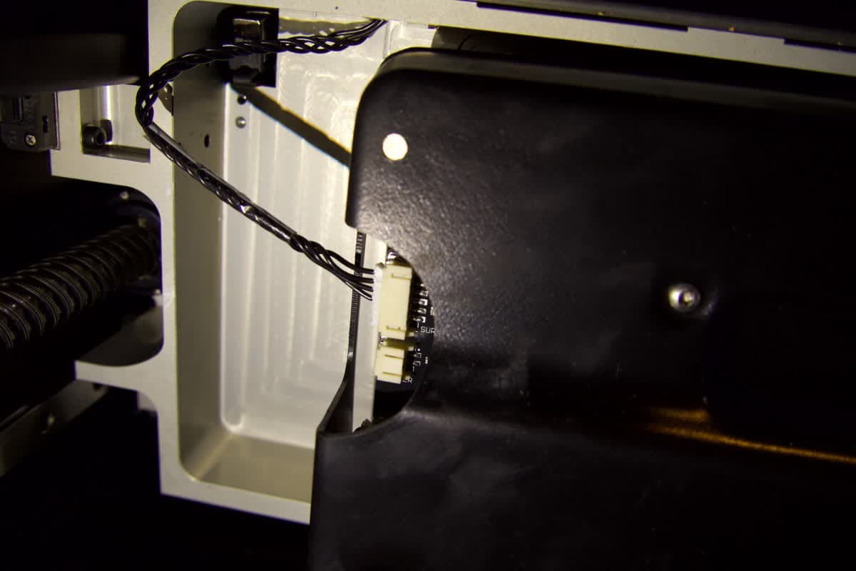

Step 3: Disconnect the cable harnesses
Aside from the ribbon cable, the front LPU has one cable harness connected to the end of the LPU oriented toward the back of the printer. The rear LPU has two cable harnesses connected to the end of the LPU oriented toward the front of the printer. Locate the remaining cable(s) for the LPU you are replacing.
Disconnect each cable by gripping its plug and gently pulling it away from the LPU.

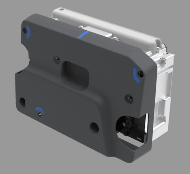

Locate the three LPU mounting screws, marked in blue on the LPU’s plastic cover. Use the provided LPU tool to fully loosen the three screws.
The screws are captive and will remain attached to the LPU when fully loose. If any of the captive screws come out of the LPU, thread them back into the LPU before continuing.

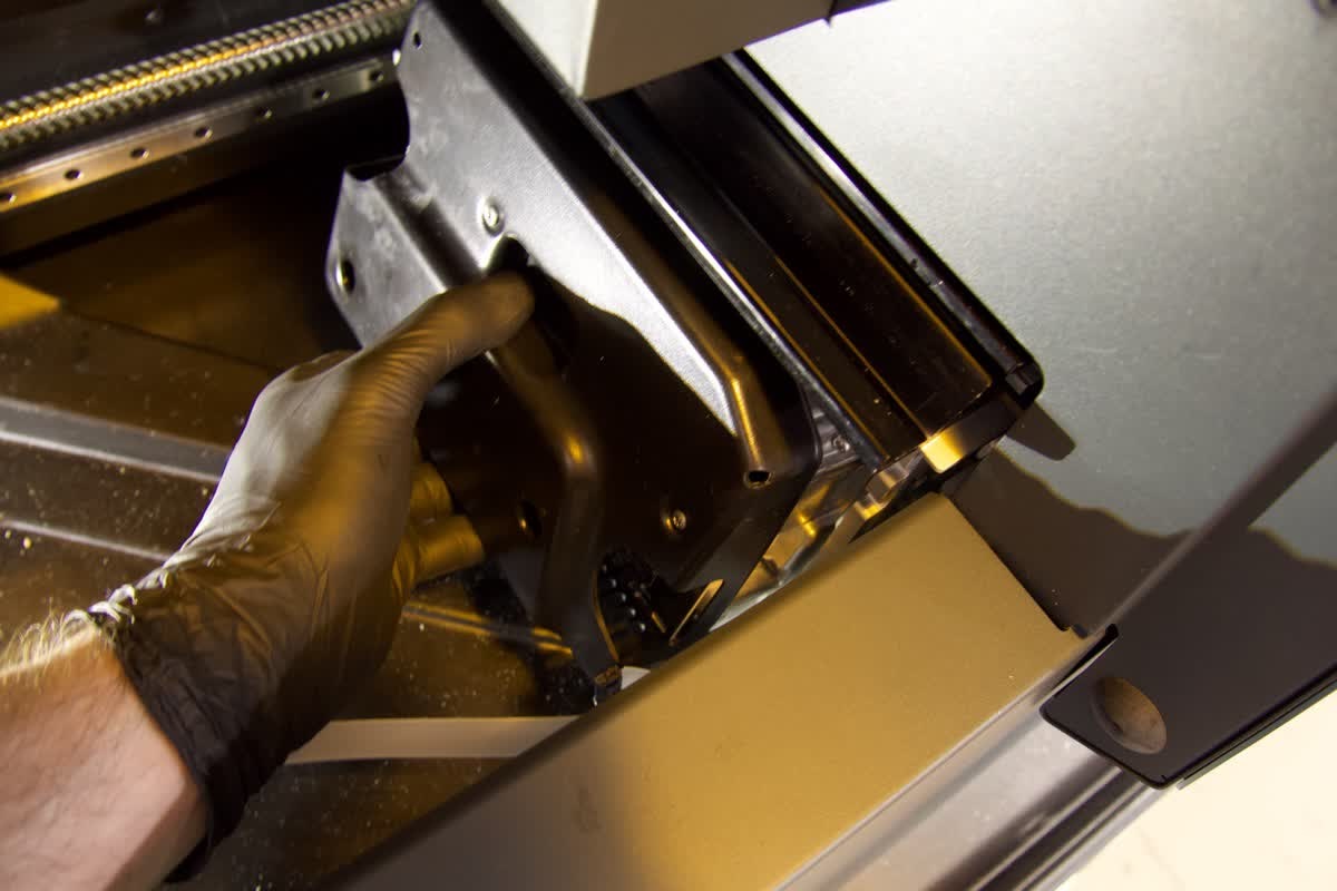

Grip the LPU’s plastic cover. Unseat the LPU from the LPU housing by gently pulling horizontally away from the LPU housing. Do not pull on the LPU’s circuit board.
Remove the LPU from the printer and place it aside. If the LPU has resin on it or in it, place the LPU on a paper towel away from the printer to avoid contaminating other surfaces.

Grip the replacement LPU and bring it toward the LPU housing, with the blue mark on the top of the LPU cover aligned with the corresponding mark on the LPU housing.
Angle the top edge of the LPU toward the LPU housing, then seat the top edge of the LPU against the top edge of the LPU housing. Swing the bottom edge of the LPU down so the LPU is upright and press the LPU into the LPU housing. When properly installed, the LPU sits stably in the LPU housing.
