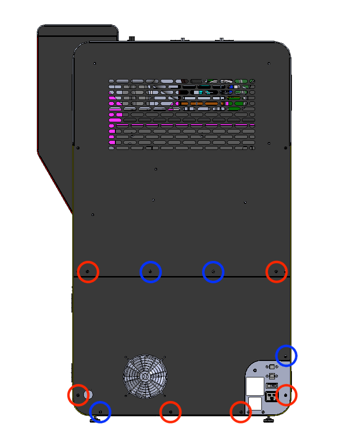

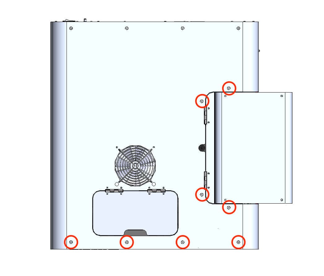

Step 1: Remove the lower rear panel screws
The six black lower rear panel screws are circled in red. The four chrome lower rear panel grounding screws are circled in blue.
Using a 2.5 mm hex driver, remove the six black panel screws and the four chrome panel grounding screws securing the lower rear panel to the printer. Set the screws aside, taking care to separate the black and chrome screws for later reinstallation.

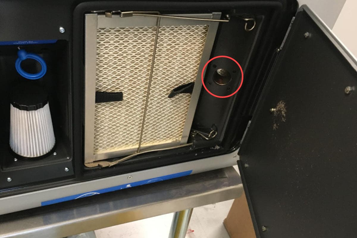

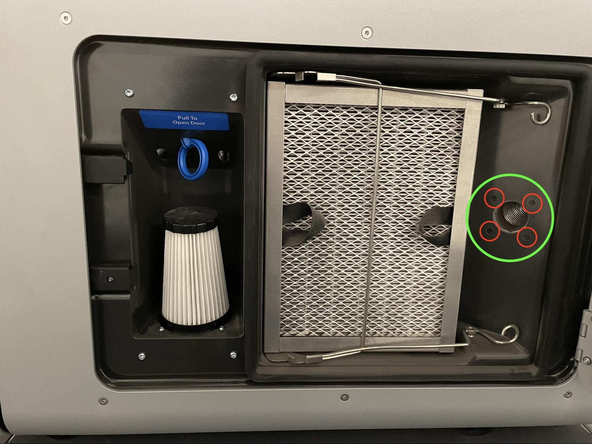

Step 5: Locate the exhaust inlet
Open the filter cabinet door on the printer. Locate the exhaust inlet on the right side of the cabinet.
Step 6: Remove the exhaust inlet screws
Using a 2.0 mm hex driver, remove the four screws attaching the exhaust inlet to the filter cabinet. Set the screws aside.

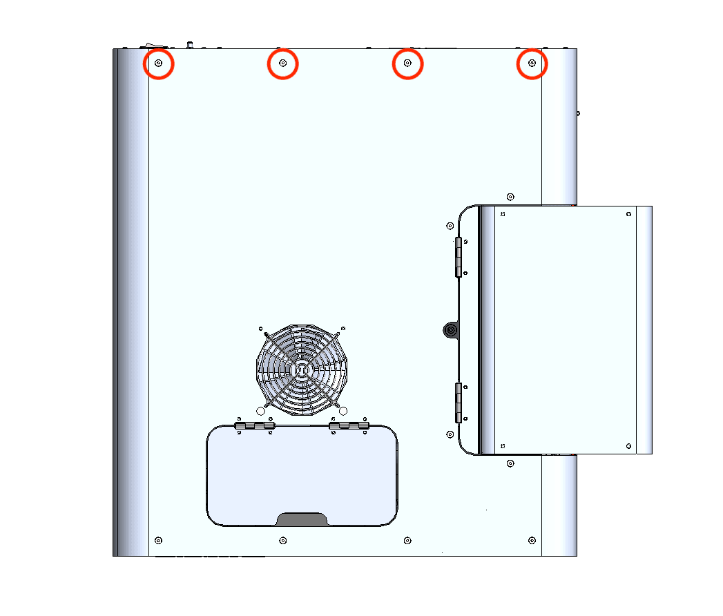

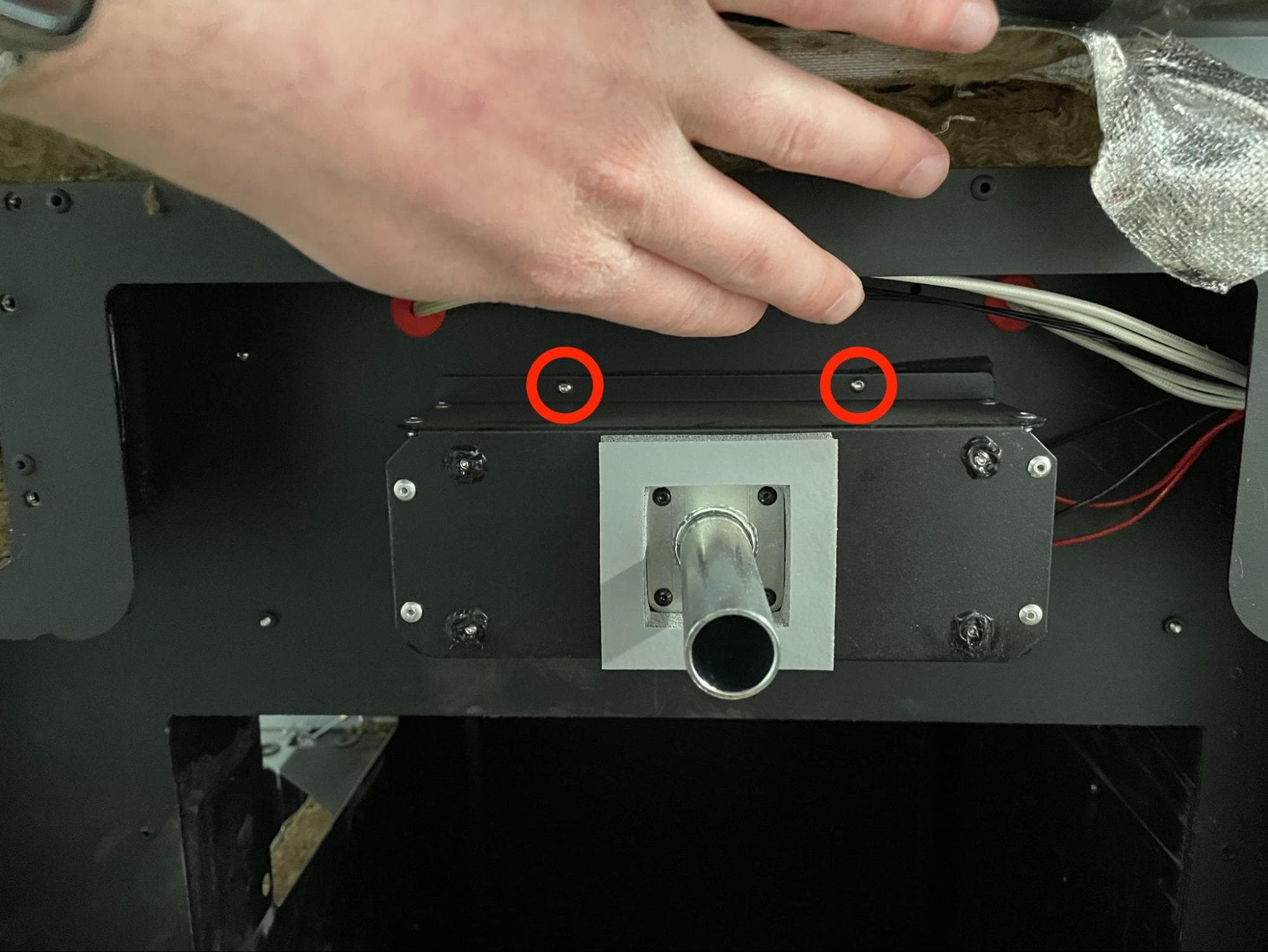

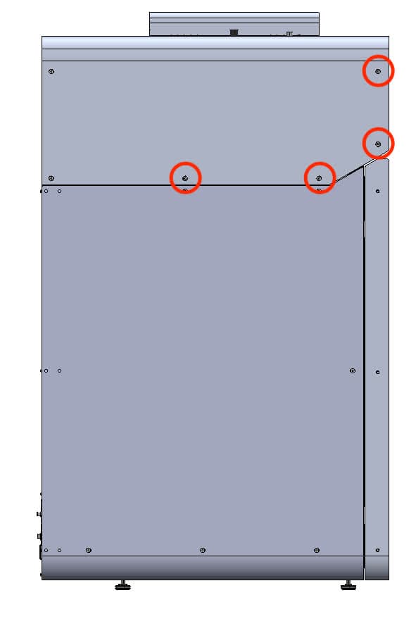

Step 7: Remove the upper rear panel screws
The two black upper rear panel screws are circled in red. The two chrome upper rear panel grounding screws are circled in blue.
Using a 2.5 mm hex driver, remove the two black panel screws and two chrome panel grounding screws securing the upper rear panel to the printer. Set the screws aside, taking care to separate the black and chrome screws for later reinstallation.

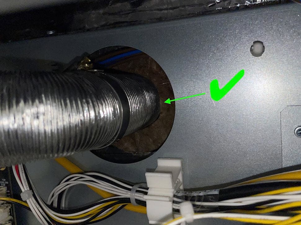

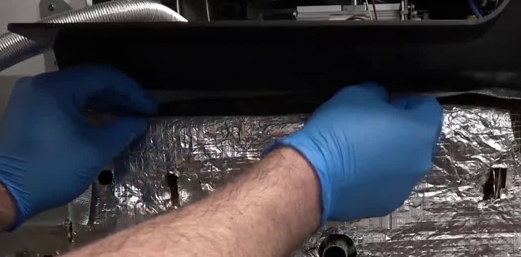

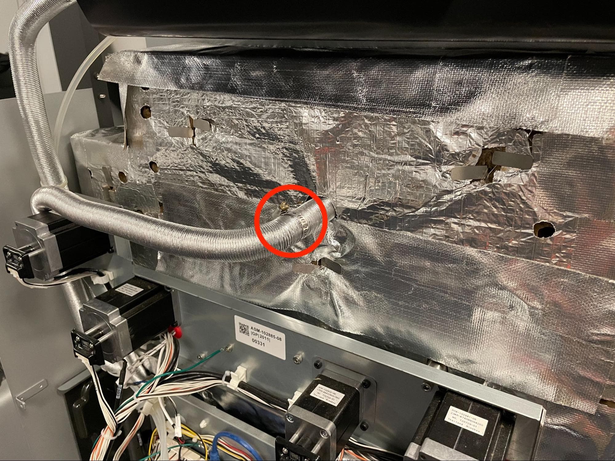

Step 1: Loosen the air duct ring clamp
If you have not already, put on a N95 or better respirator, a pair of safety glasses and a pair of nonreactive nitrile gloves. Use a 6.5 mm slotted screwdriver to loosen, but do not remove, the ring clamp screw securing the duct to the air heater inlet.
Step 2: Separate the air duct from the air heater inlet
Slide the duct off of the inlet. Gently move it away from the rear insulation panel.

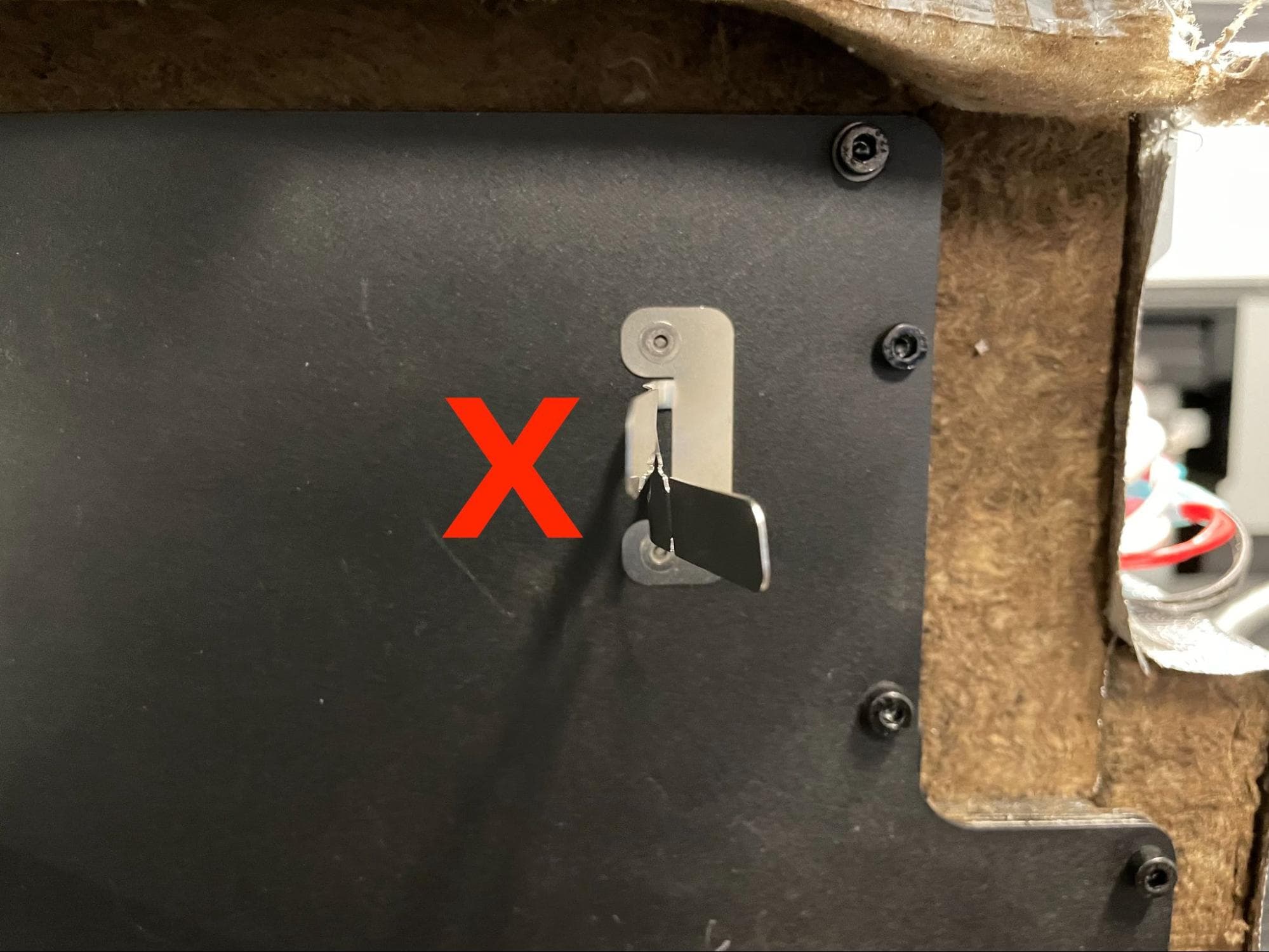

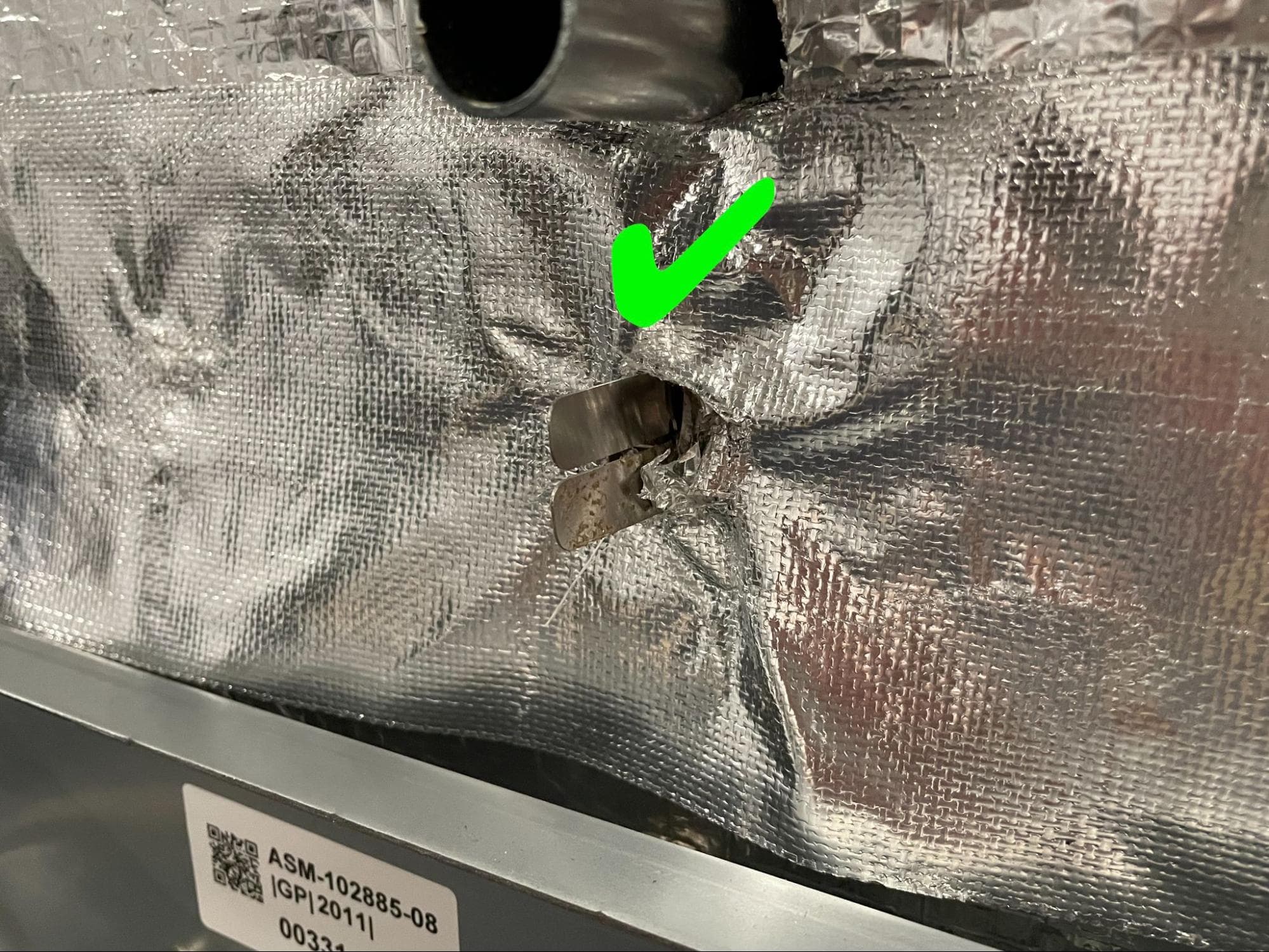

Notice:
Ensure that both halves of each tab are parallel to each other. If they are not, they will shred the insulation as the panel is removed.

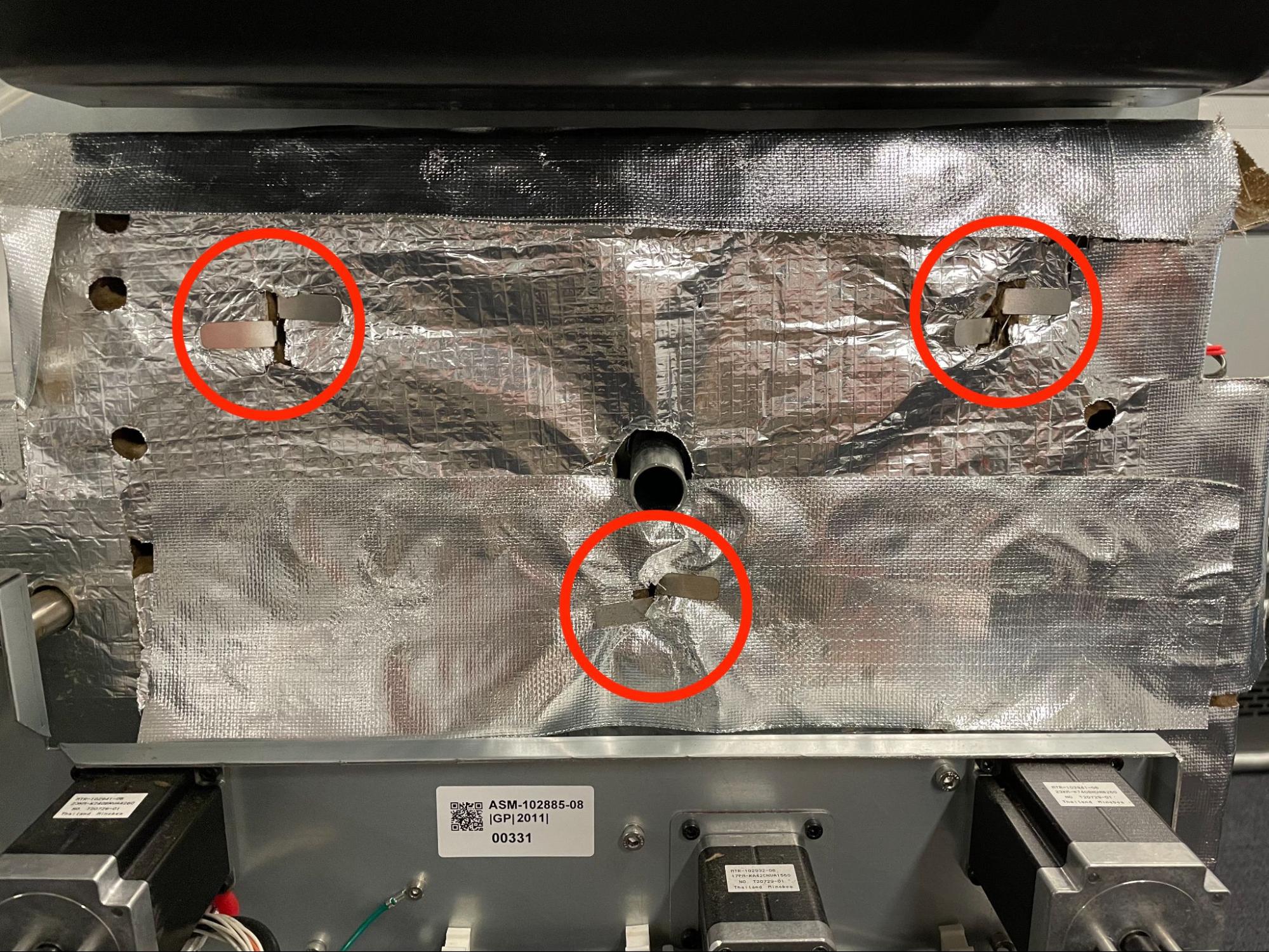

Step 3: Open the insulation retention tabs
Straighten the three metal retention tabs securing the rear upper insulation panel.

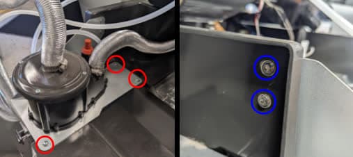

Step 4: Move the nitrogen plenum
Using a T20 Torx driver and a 2.5 mm hex driver, remove the three T20 screws and two M3 socket head screws that secure the nitrogen plenum to the printer. You do not need to remove the plenum assembly; it only needs to be loose to allow clearance for the insulation and access panel to be removed.

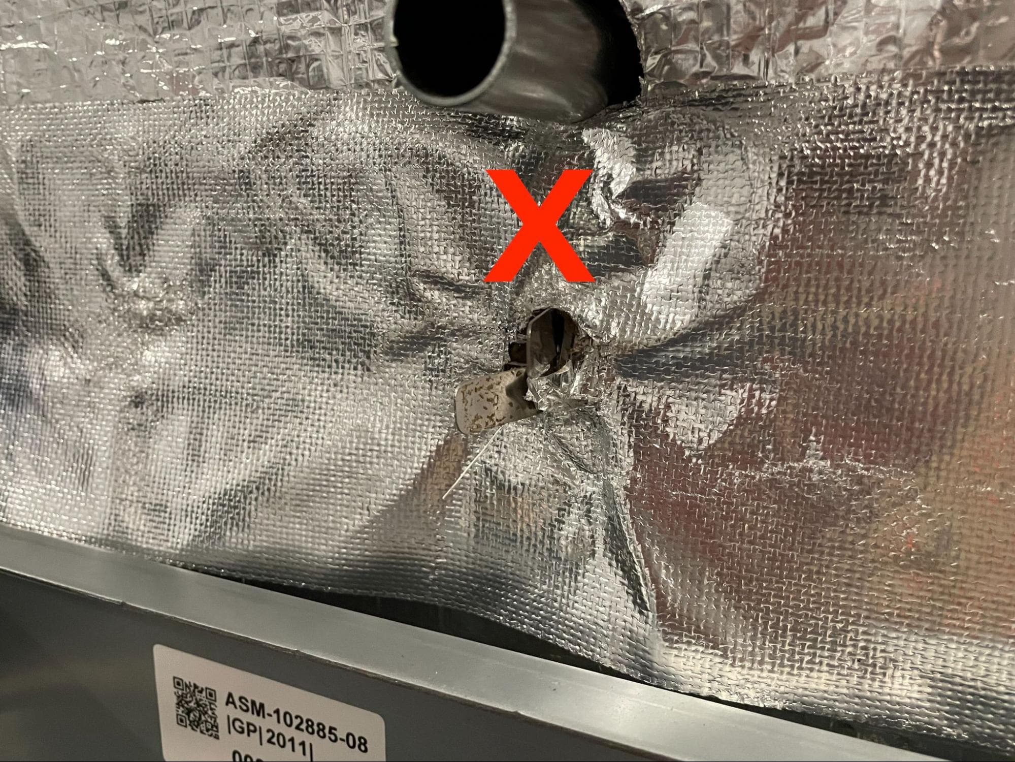

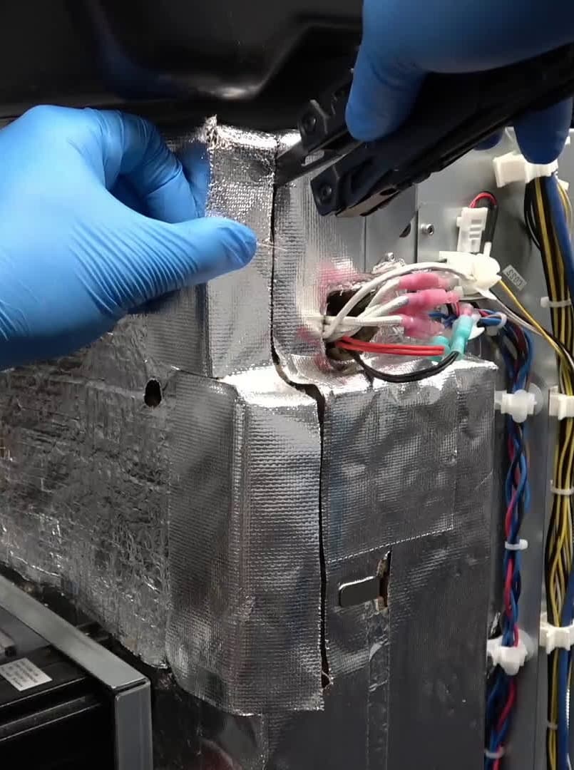

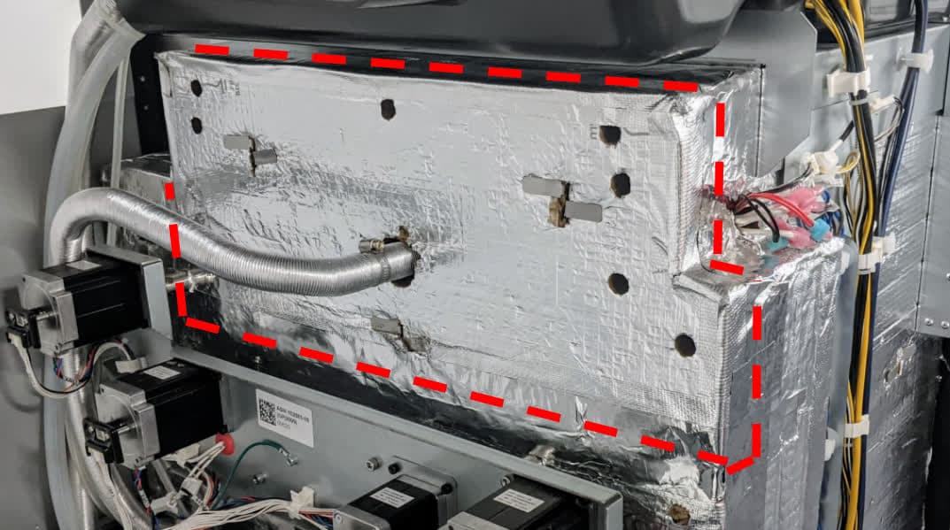

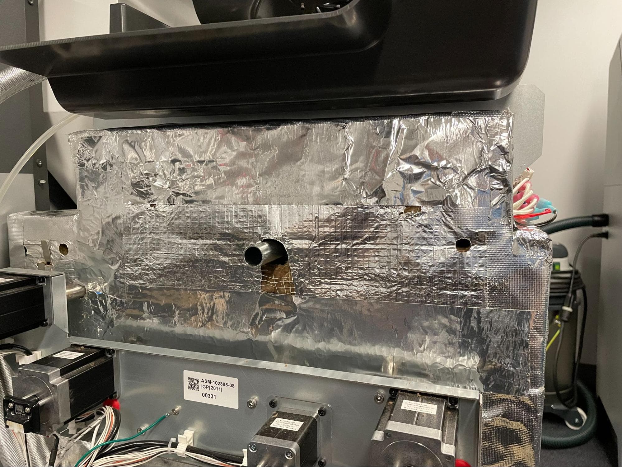

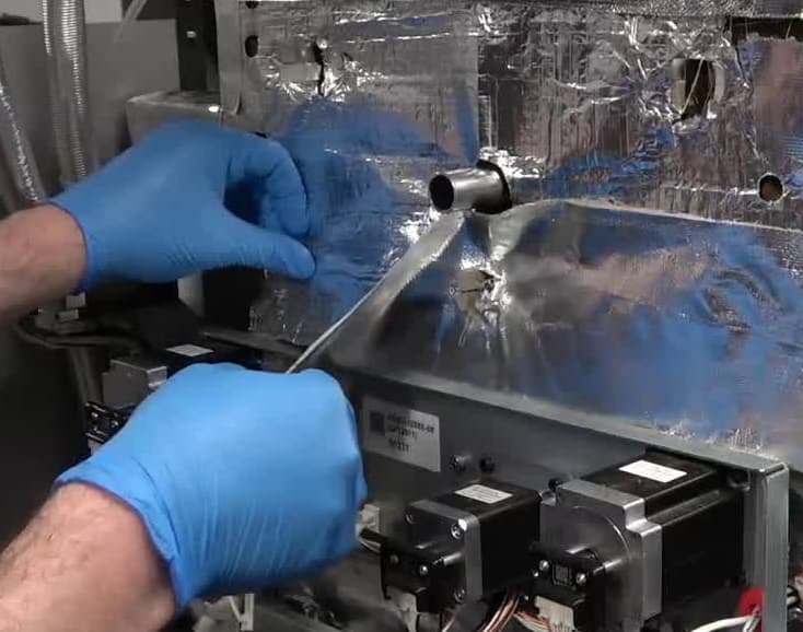

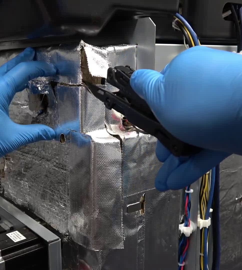

Step 5: Cut the insulation foil tape
Remove the insulation and inner rear panels
Feel along the insulation for the seams identified in the above image. Use a utility knife to cut along these seams and release the insulation panel.
Note:
You only need to cut through the foil tape securing the insulation panel in place; the insulation itself is already cut to size.
Alternatively, locate an edge of the existing foil tape and begin peeling it away from the insulation panel. It will still be necessary to cut the top corner pieces of foil tape in order to separate the panel from the printer.

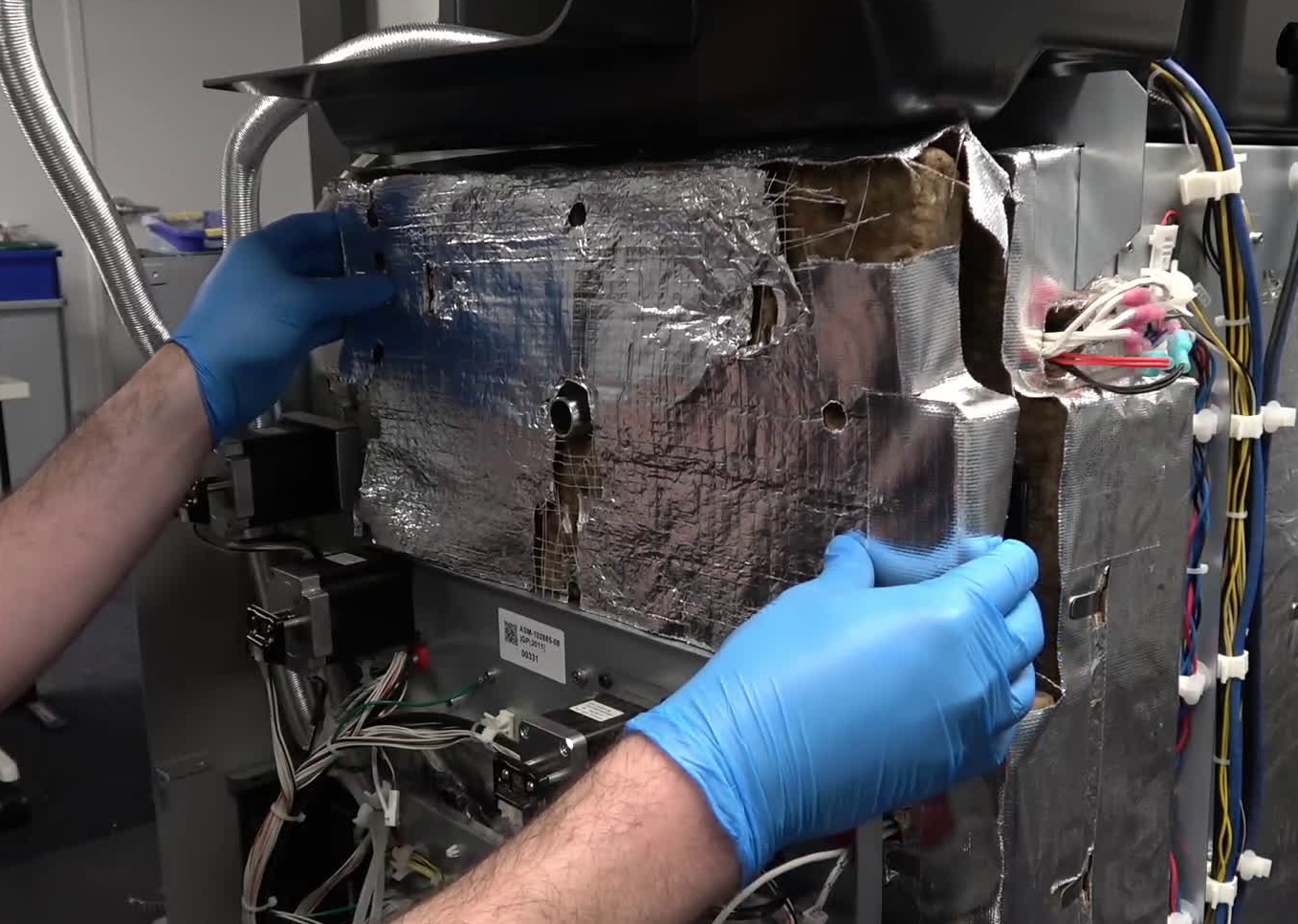

Step 6: Remove the insulation panel
Carefully pull the insulation panel away from the printer.
Notice:
Avoid abruptly removing the insulation panel, as it may begin flaking apart.

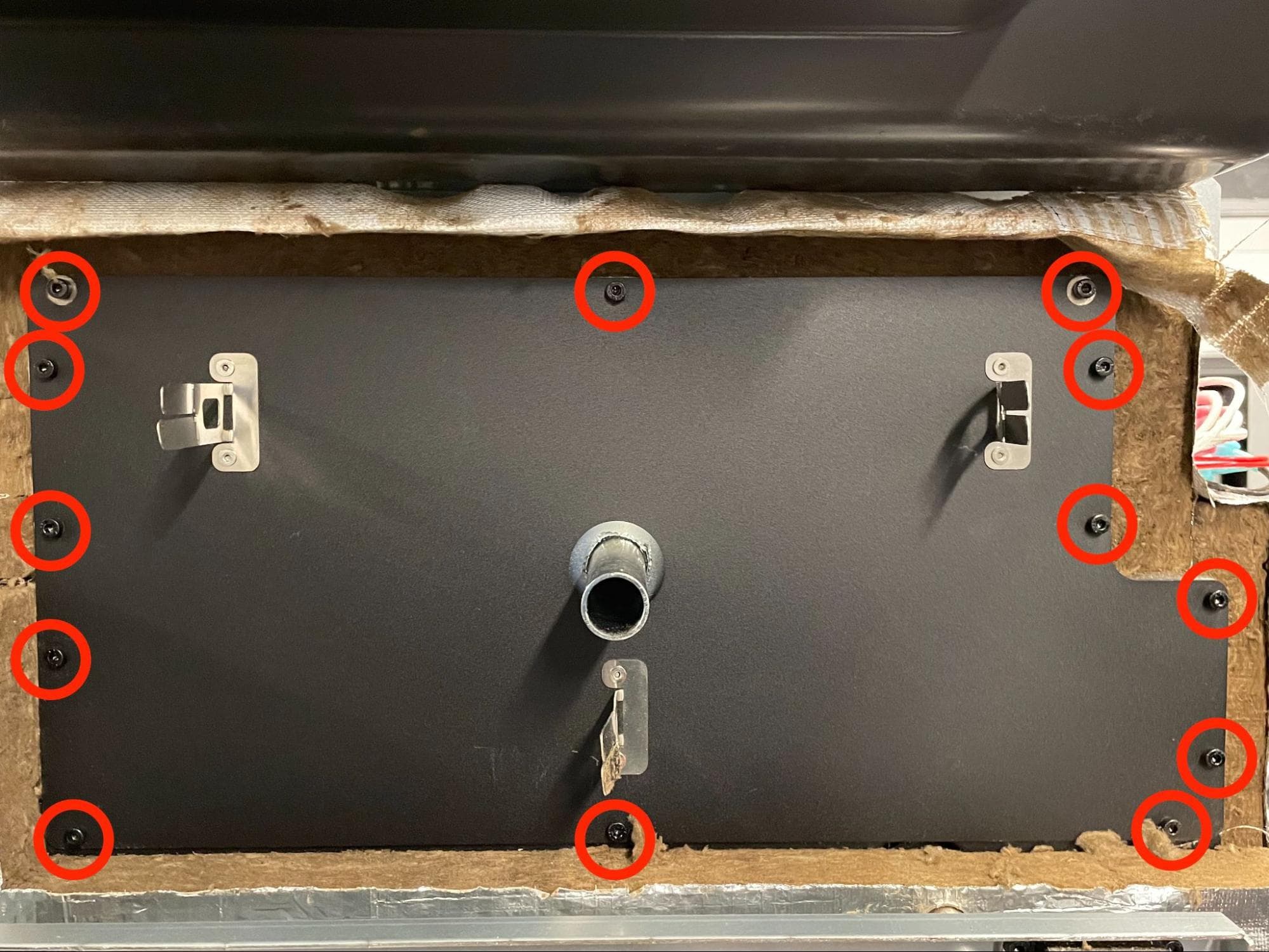

Step 7: Remove the inner rear panel screws
Use a 3 mm hex driver to remove the 13 8.0 mm M4 socket head screws that secure the inner rear panel to the printer.

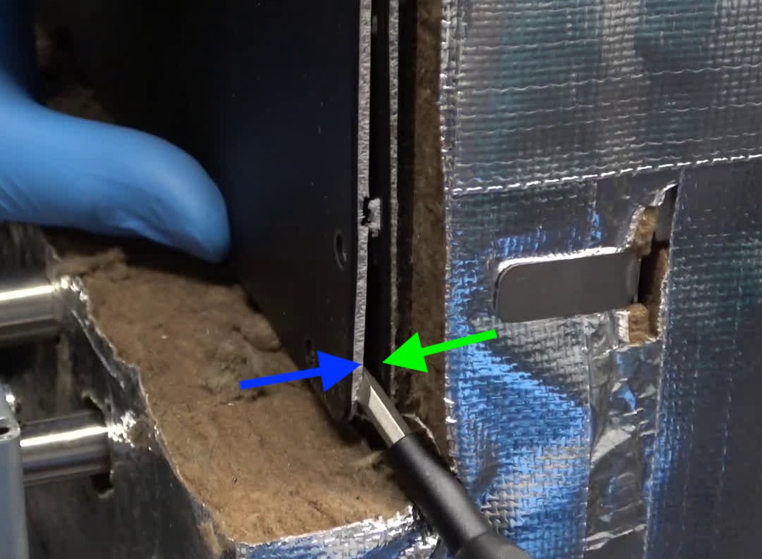

Step 8: Separate the inner rear panel from the printer
Use a 6.5 mm slotted screwdriver to separate a corner of the inner rear panel from the inner back plate. Ensure that the driver is inserted between the gasket and second black steel plate.
Notice:
Avoid gouging the gasket as much as possible. If it is damaged, it will need to be replaced.

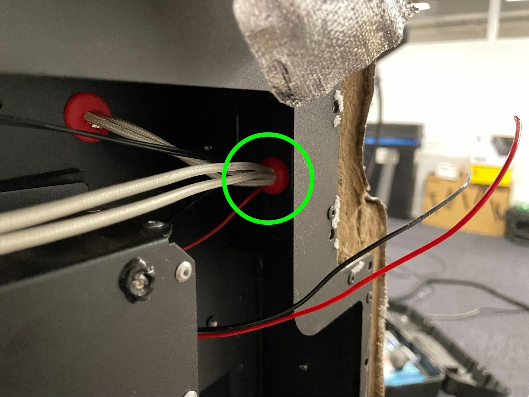

Step 3: Feed the air heater wires through the printer frame
Pull the air heater wires back through the silicone grommet to free them from the printer’s frame.

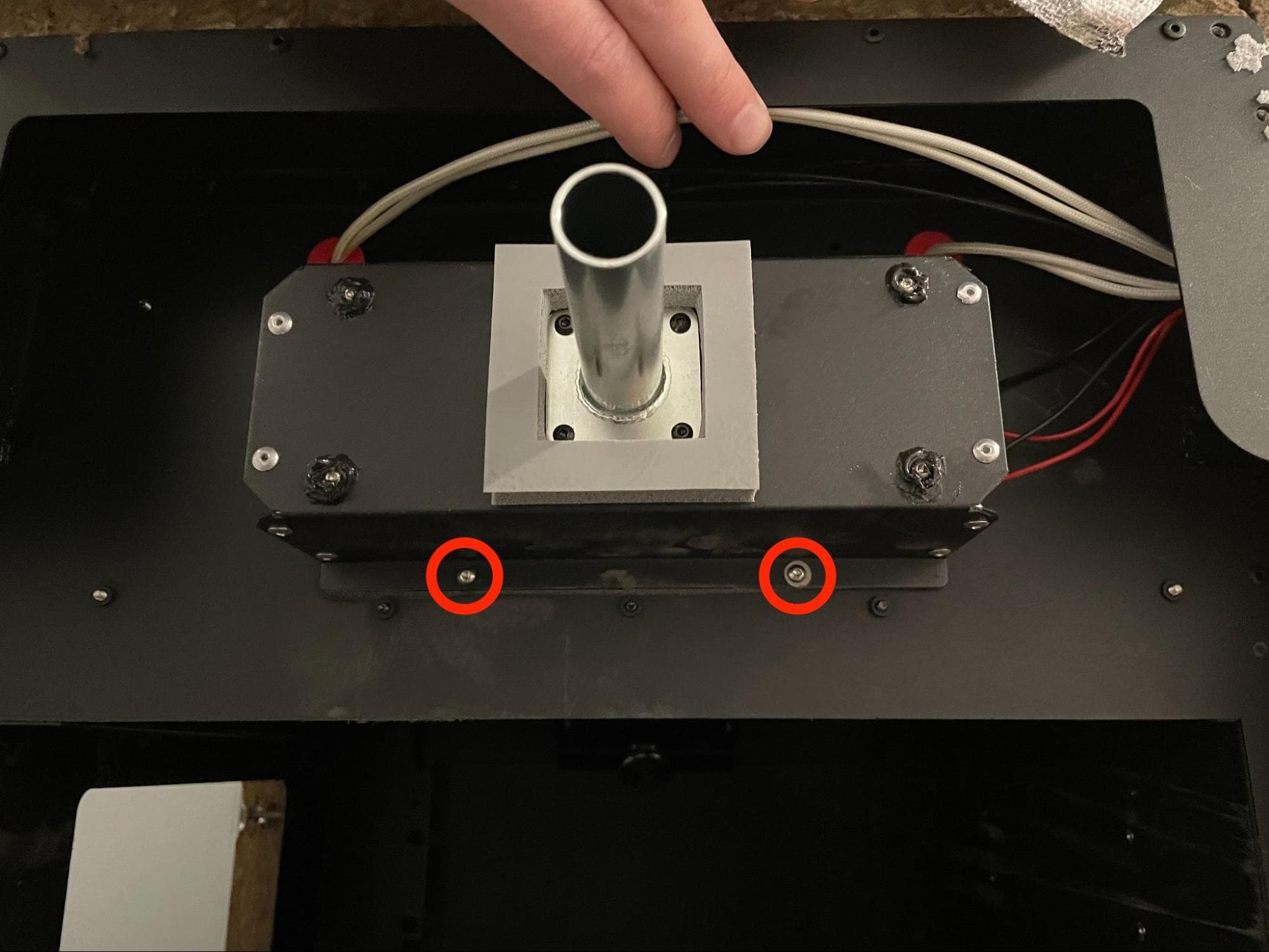

Step 4: Remove the air heater screws
Remove the original air heater assembly
Use a 2 mm hex driver to remove the four 6 mm M3 button screws securing the air heater assembly to the printer frame. Do not use a ball-end hex driver, as it will strip these screws. Only use a flat-end hex driver.

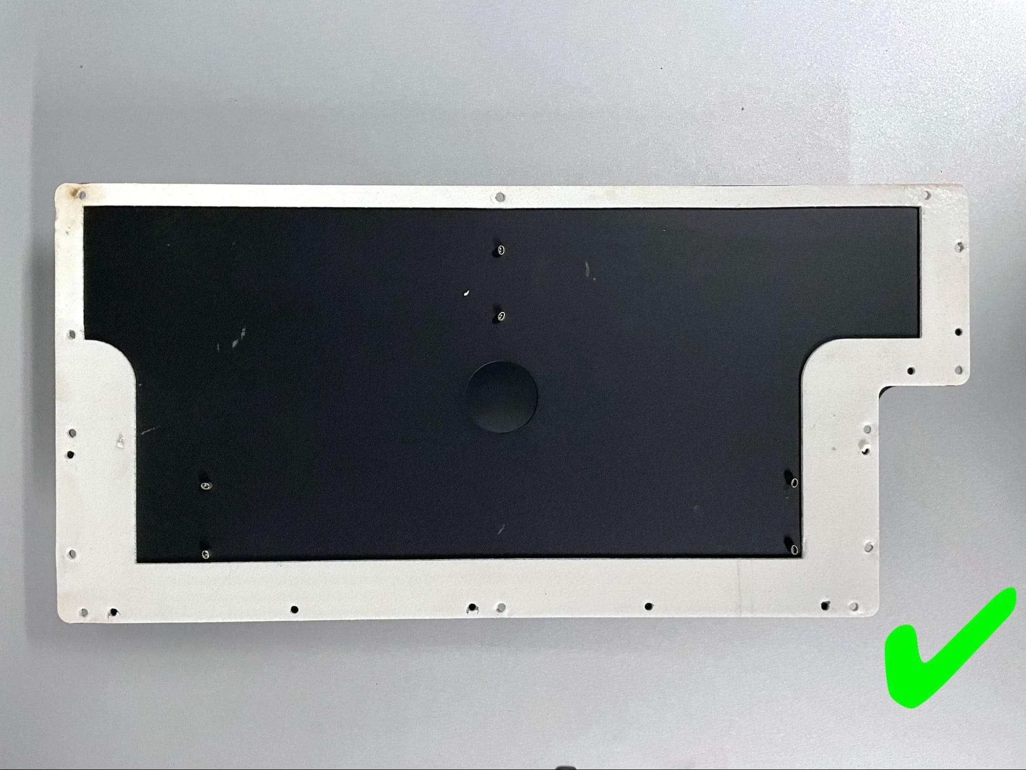

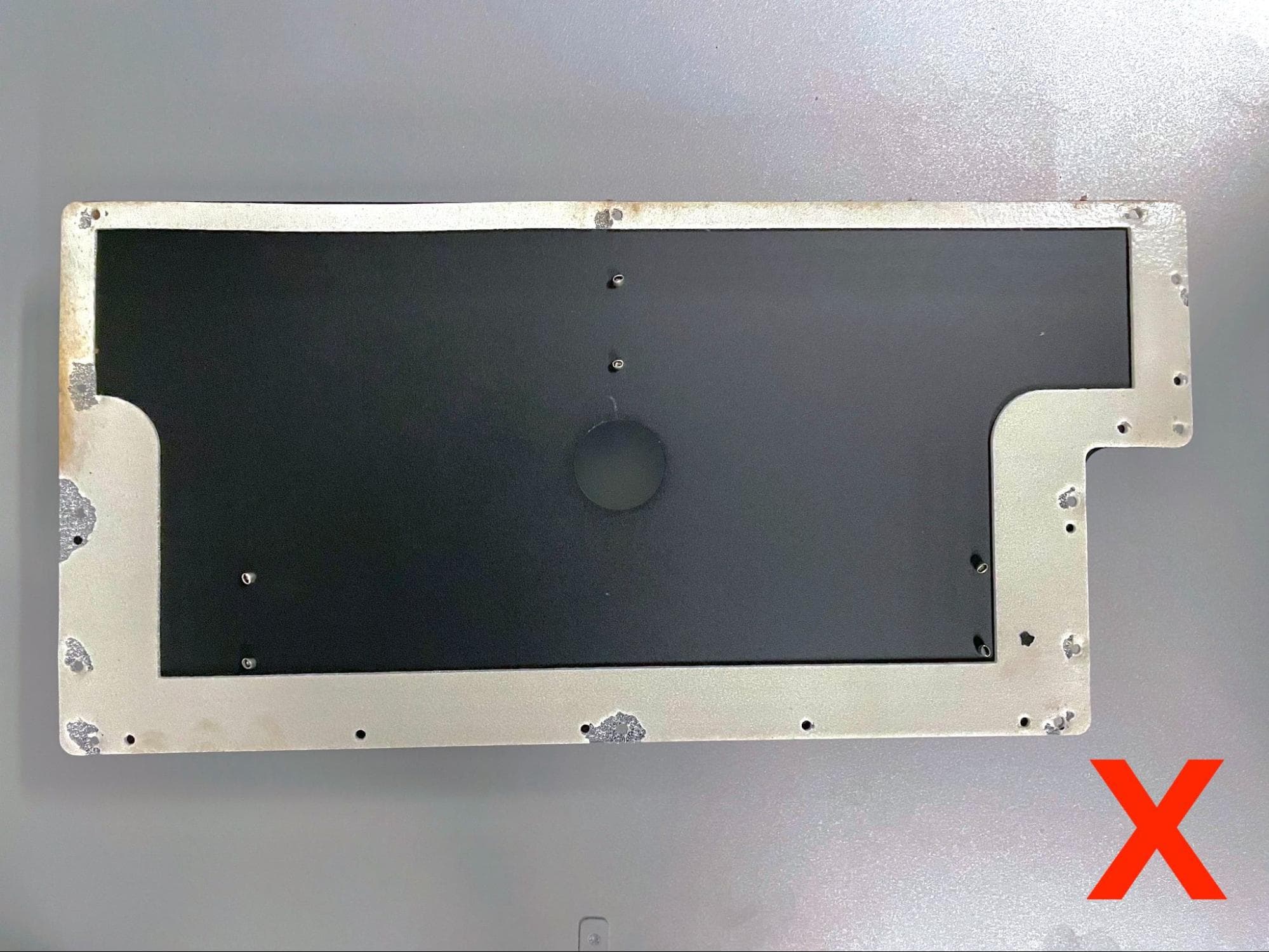

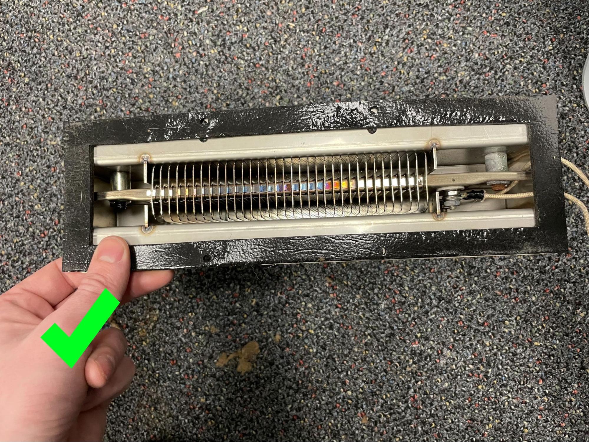

Step 1: Check the air heater gasket
Put on a pair of clean nitrile gloves. Check that both the gasket around the heater assembly and the heater fins are clean.
Use a bulb blower to dust off any insulation or contaminants from the air heater assembly. Do not touch the heater fins or the insulation with bare skin. If any insulation is pressed in between any of the fins, use a pair of tweezers to extract it.

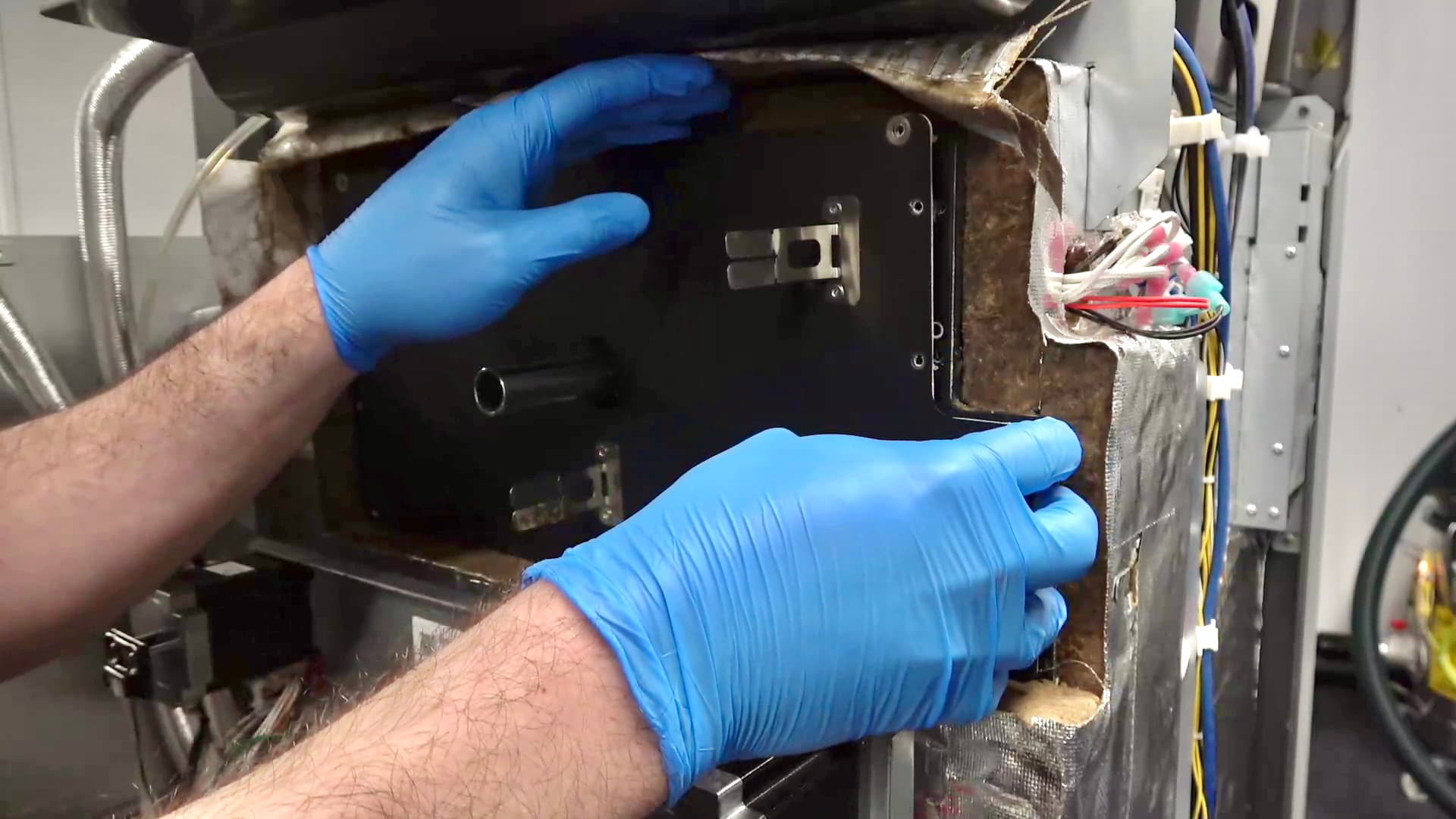

Step 2: Align the air heater
Align the new air heater assembly with the corresponding screw holes on the back of the printer. Orient the air heater with its wires extending towards the buffer side of the printer.
Step 3: Secure the air heater
Install the new air heater assembly
Thread one 6 mm M3 button screw into each of the four screw holes in the air heater. Using a flat-end 2 mm hex driver, tighten until snug. Do not use a ball-end hex driver, as it will strip these screws.

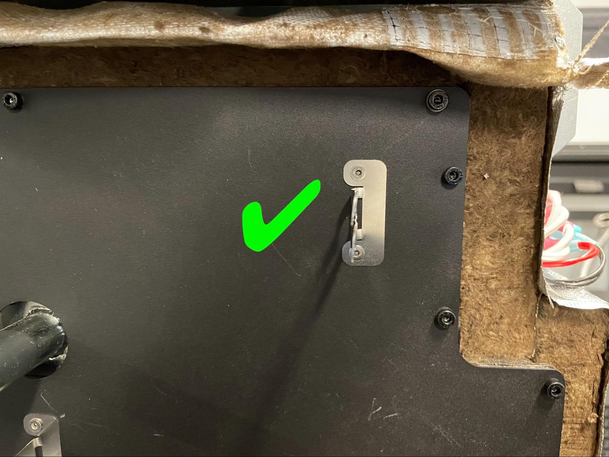

Step 3: Prepare the retention tabs
Replace the inner rear and insulation panels
Straighten the three metal retention tabs that secure the rear upper insulation panel to the back of the printer. Ensure that both halves of each tab are parallel to each other. If they are not, they will shred the insulation as the panel is removed.
Step 4: Mount the insulation panel
Slide the upper rear insulation panel in place and fold the tabs over to secure it.

Step 5: Seal the insulation panel in place
Use 100 mm (4 in) foil tape to cover any seams around the rear insulation panel. If the previous tape was peeled off instead of cut, replace the entire piece.
Step 6: Mount and secure the air heater duct
Slide the air heater duct back onto the inlet pipe, then tighten the ring clamp to secure the duct.
Step 7: Secure the nitrogen plenum
Using a T20 Torx driver and a 2.5 mm hex driver, reinstall the three T20 screws and two M3 socket head screws that secure the nitrogen plenum to the printer.

Step 1: Align the upper rear panel with the printer
Lift the upper rear panel and align it with the four screw holes on the top of the printer.
Step 2: Secure the upper rear panel top screws
Thread the four 6.0 mm screws into each of the screw holes on the top of the printer. Using a 2.5 mm hex driver, tighten the screws until finger tight. You may need to adjust the exhaust duct to correctly position the upper rear panel.

Step 5: Secure the upper rear panel grounding screws
Thread the panel screws into the indicated screw holes on the upper rear panel. Refer to the image for the correct locations of the black and chrome screws. Using a 2.5 mm hex driver, screw in the two black panel screws and two chrome grounding screws securing the upper rear panel to the printer.
Notice:
The placement of the chrome screws is critical to the printer's electrical grounding. Incorrect placement may lead to printer damage.

Step 8: Secure the exhaust inlet screws
Open the filter cabinet door on the printer. Thread the four 8.0 mm screws into the screw holes. Using a 2.0 mm hex driver, screw in the four exhaust duct screws until finger tight.
Step 9: Check the exhaust duct seal
To ensure there is no gap between the exhaust duct’s mounting plate and the filter cabinet housing, shine a flashlight or other light source around the exhaust inlet inside the filter cabinet. If any light is visible behind the filter cabinet, the duct is not properly sealed. If necessary, use a 2.0 mm hex driver to tighten the exhaust duct screws. Close the filter cabinet door when finished.
Step 10: Secure the lower rear panel grounding screws
Thread the panel screws into the indicated screw holes on the lower rear panel. Refer to the image for the correct locations of the black and chrome screws. Using a 2.5 mm hex driver, screw in the six black panel screws and four chrome panel grounding screws securing the lower rear panel to the printer.
Notice:
