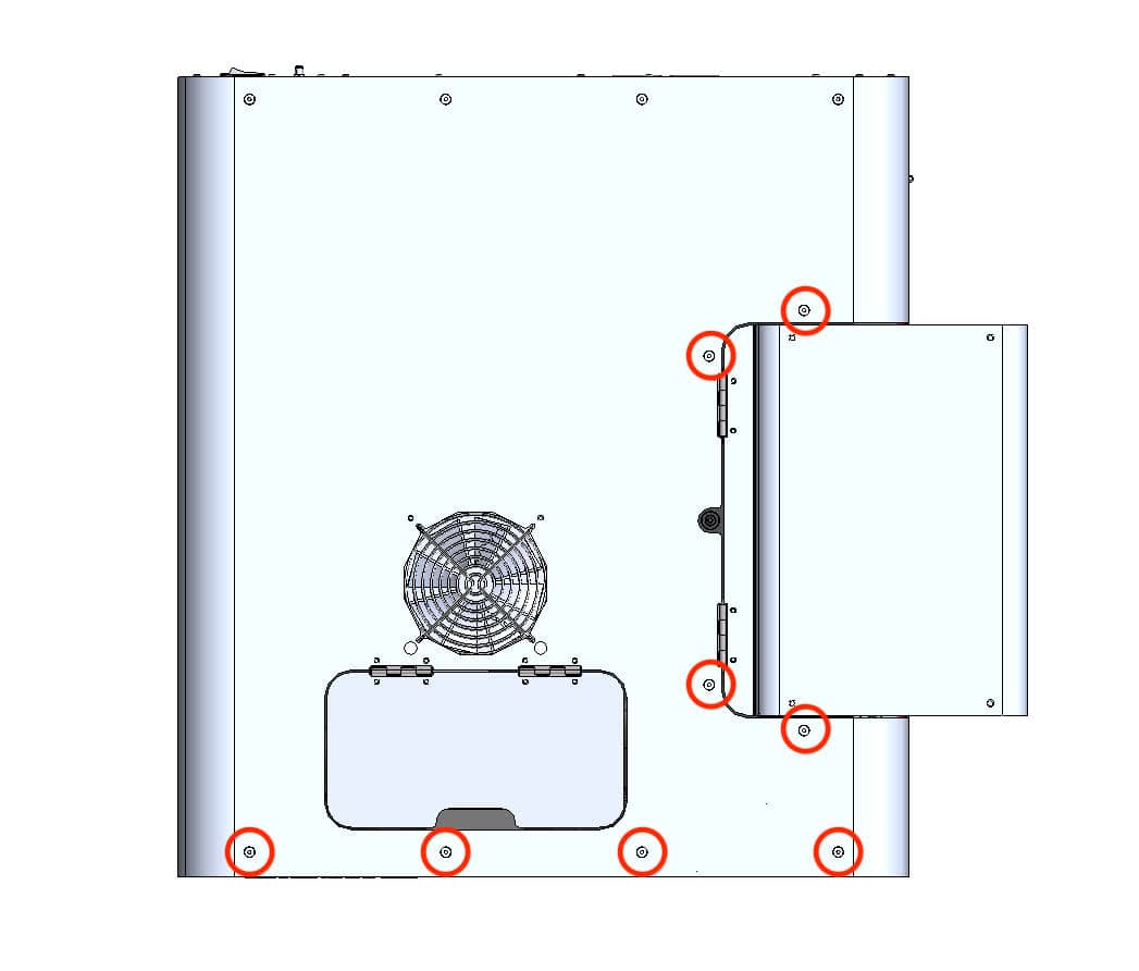

Step 1: Remove the lower rear panel screws
The six black lower rear panel screws are circled in red. The four chrome lower rear panel grounding screws are circled in blue.
Using a 2.5 mm hex driver, remove the six black panel screws and the four chrome panel grounding screws securing the lower rear panel to the printer. Set the screws aside, taking care to separate the black and chrome screws for later reinstallation.

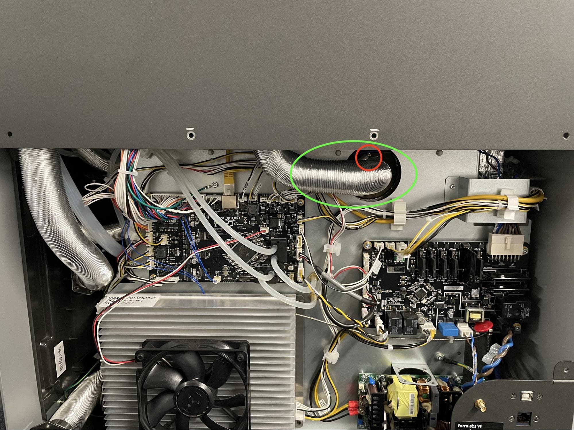

Step 3: Locate the exhaust duct and ring clamp
Locate the ring clamp attached to the exhaust duct in the center of the printer.
Step 4: Loosen the ring clamp screw
Using a 6.5 mm flathead screwdriver, loosen the ring clamp screw. Do not remove the screw. Pull the exhaust duct away from the exhaust pipe.

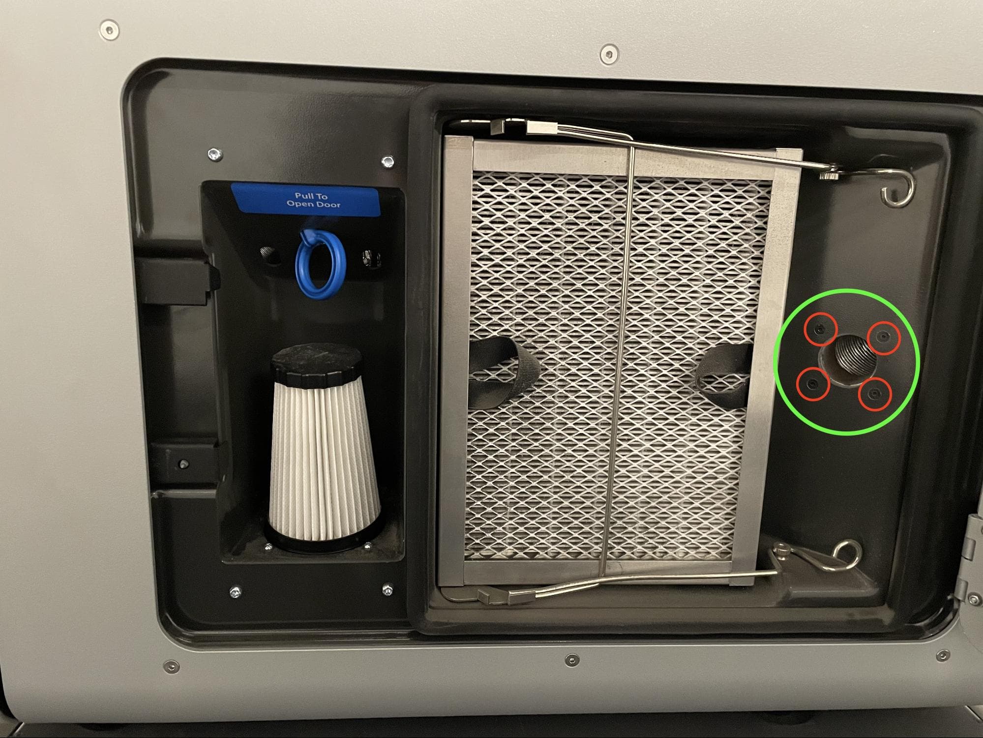

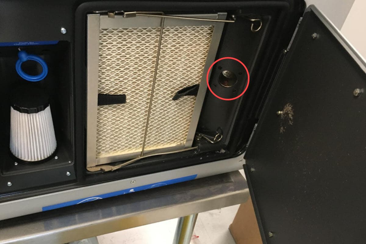

Step 5: Locate the exhaust inlet
Open the filter cabinet door on the printer. Locate the exhaust inlet on the right side of the cabinet.
Step 6: Remove the exhaust inlet screws
Using a 2.0 mm hex driver, remove the four screws attaching the exhaust inlet to the filter cabinet. Set the screws aside.

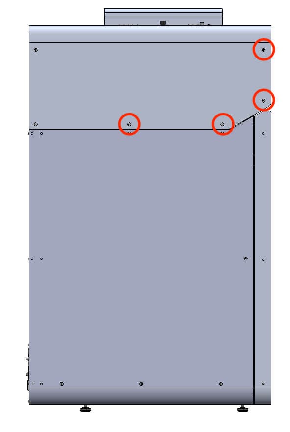

Step 7: Remove the upper rear panel screws
The two black upper rear panel screws are circled in red. The two chrome upper rear panel grounding screws are circled in blue.
Using a 2.5 mm hex driver, remove the two black panel screws and two chrome panel grounding screws securing the upper rear panel to the printer. Set the screws aside, taking care to separate the black and chrome screws for later reinstallation.

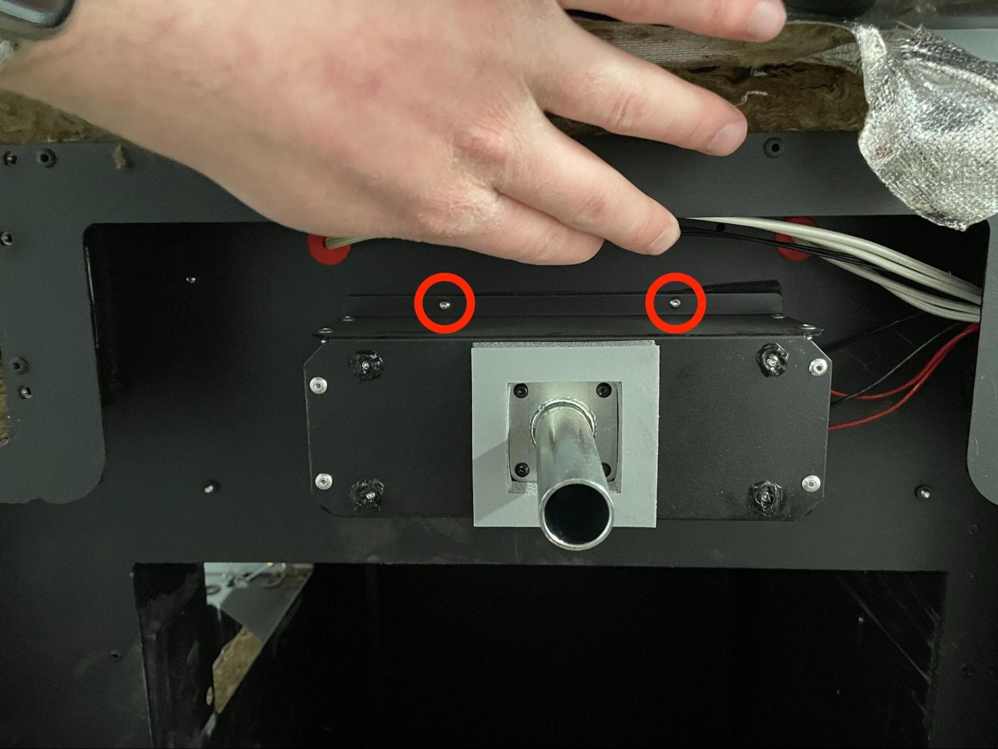

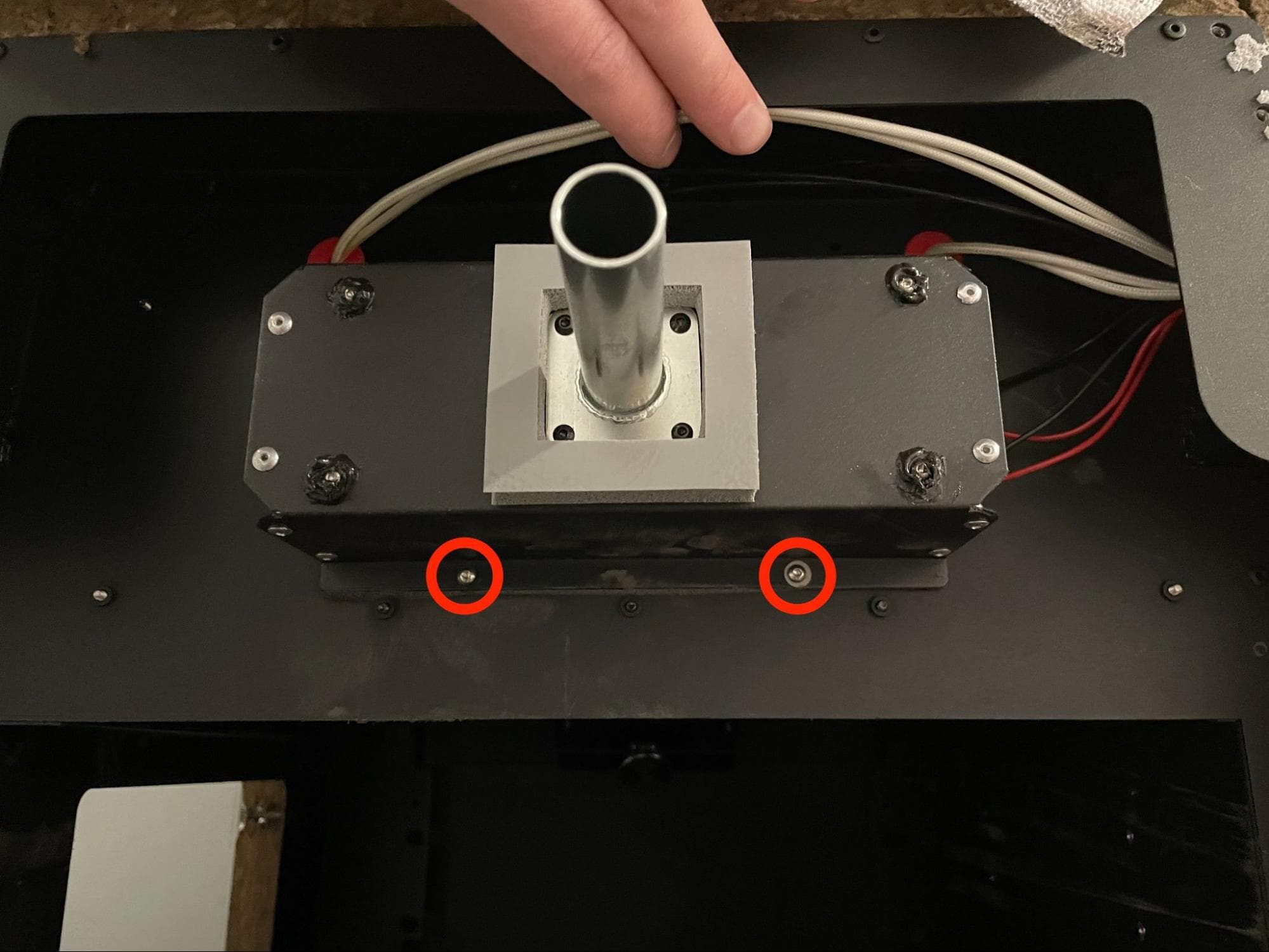

Step 8: Remove the upper rear panel screws
Using a 2.5 mm hex driver, remove the eight screws securing the upper rear panel to the printer:
  • Two 6 mm screws on the buffer side of the printer
  • Four 6 mm screws on the top of the printer
  • Two 6 mm screws on the hopper side of the printer

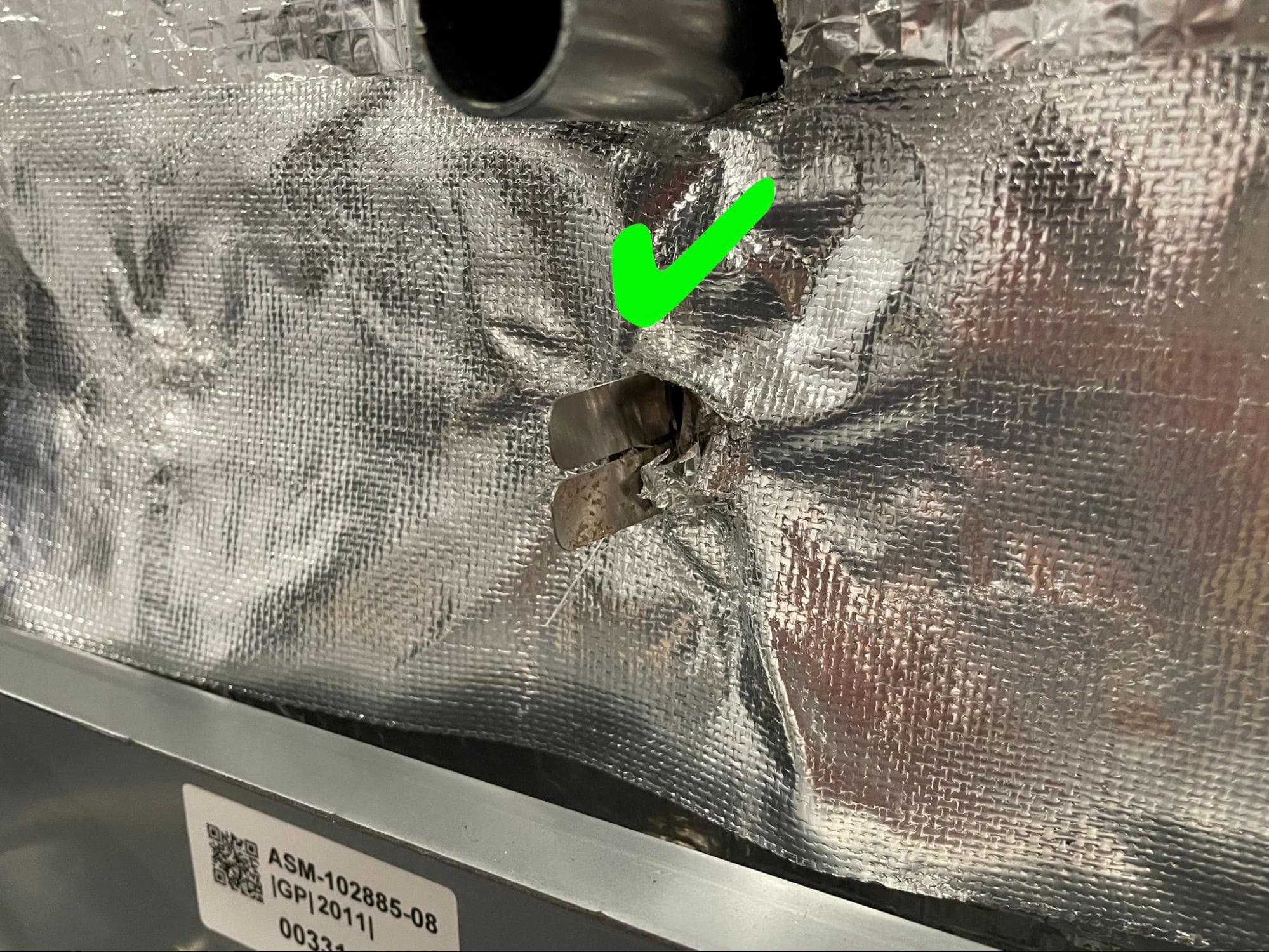

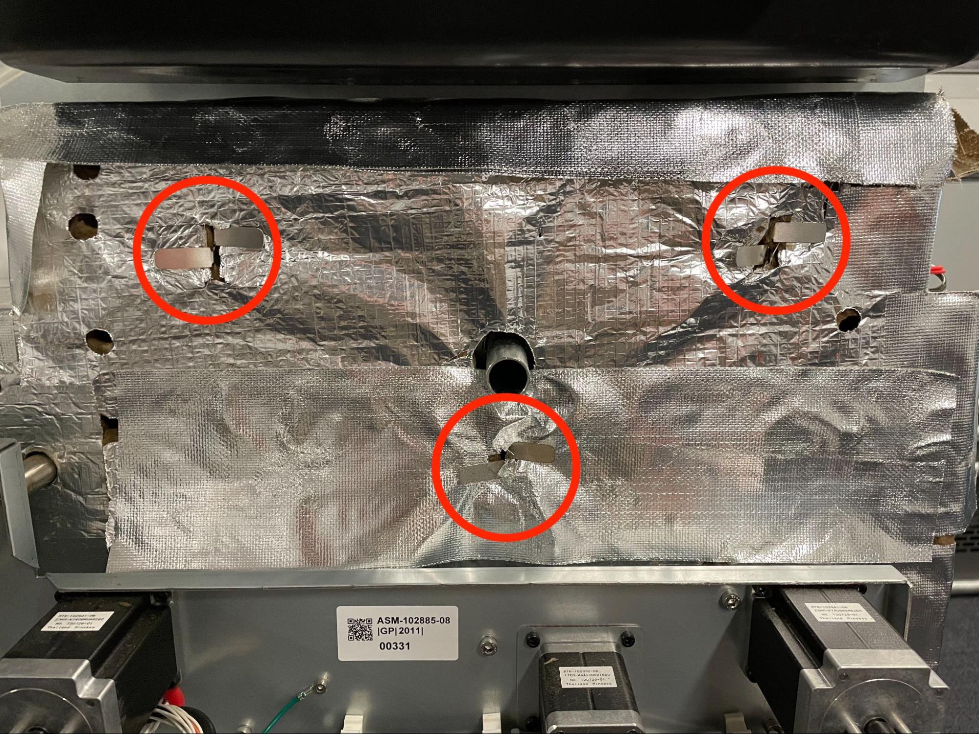

Step 3: Open the insulation retention tabs
Straighten the three metal retention tabs securing the rear upper insulation panel.
Remove the insulation and inner rear panels
Notice:
Ensure that both halves of each tab are parallel to each other. If they are not, they will shred the insulation as the panel is removed.

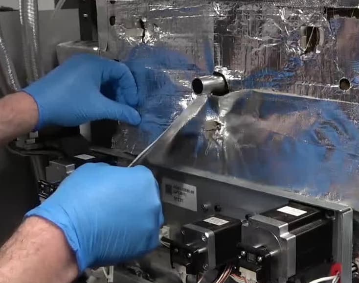

Step 4: Cut the insulation foil tape
Feel along the insulation for the seams identified in the above image. Use a utility knife to cut along these seams and release the insulation panel.
Note:
You only need to cut through the foil tape securing the insulation panel in place; the insulation itself is already cut to size.
Alternatively, locate an edge of the existing foil tape and begin peeling it away from the insulation panel. It will still be necessary to cut the top corner pieces of foil tape in order to separate the panel from the printer.

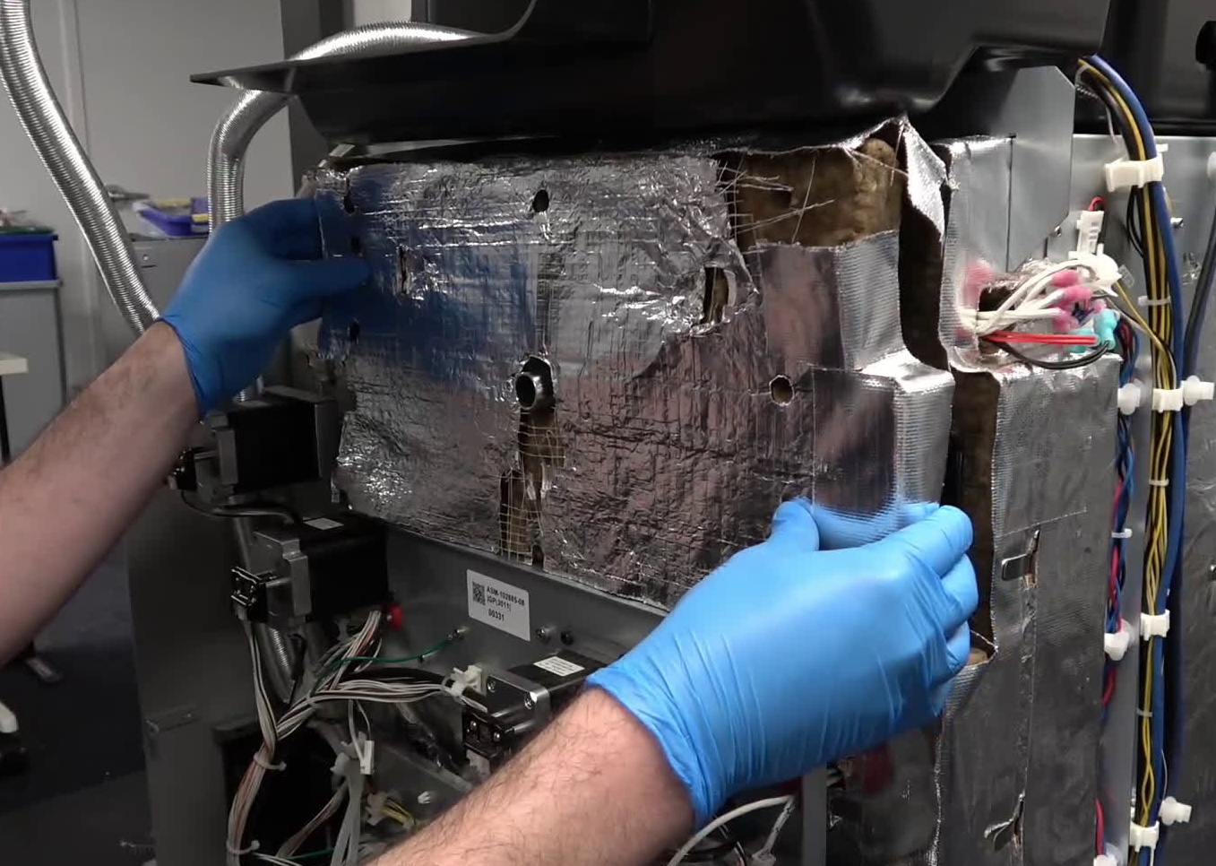

Step 5: Remove the insulation panel
Carefully pull the insulation panel away from the printer.
Notice:
Avoid abruptly removing the insulation panel, as it may begin flaking apart.

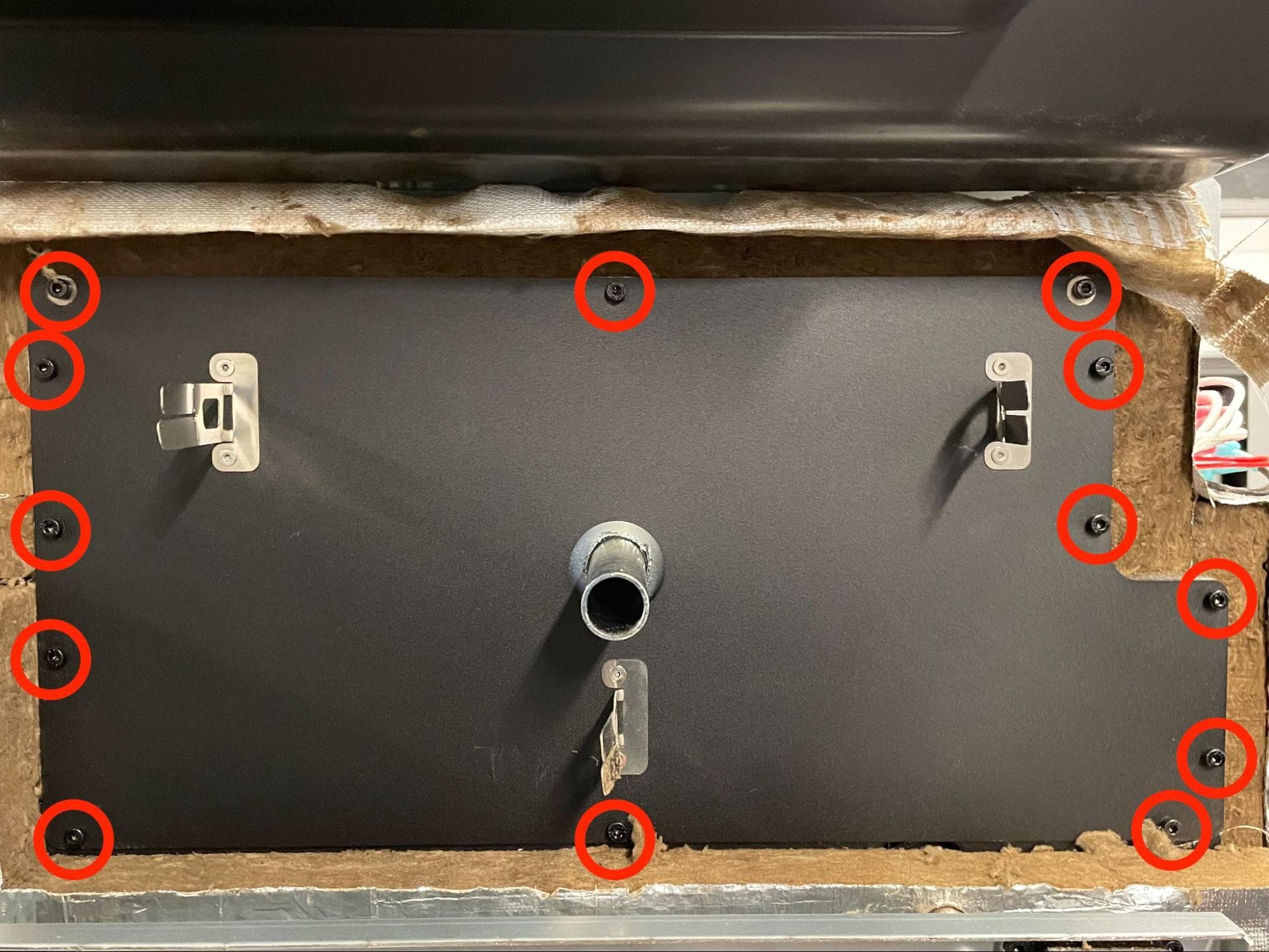

Step 6: Remove the inner rear panel screws
Use a 3 mm hex driver to remove the 13 8.0 mm M4 socket head screws that secure the inner rear panel to the printer.

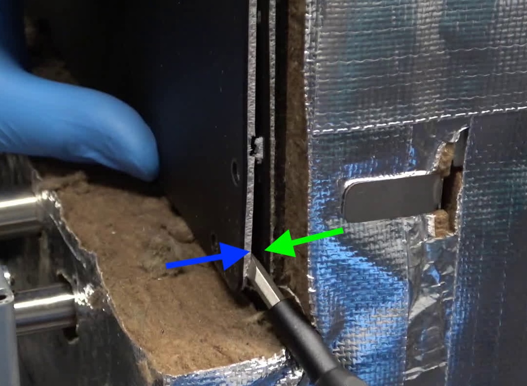

Step 7: Separate the inner rear panel from the printer
Use a 6.5 mm slotted screwdriver to separate a corner of the inner rear panel from the inner back plate. Ensure that the driver is inserted between the gasket and second black steel plate.
Notice:
Avoid gouging the gasket as much as possible. If it is damaged, it will need to be replaced.

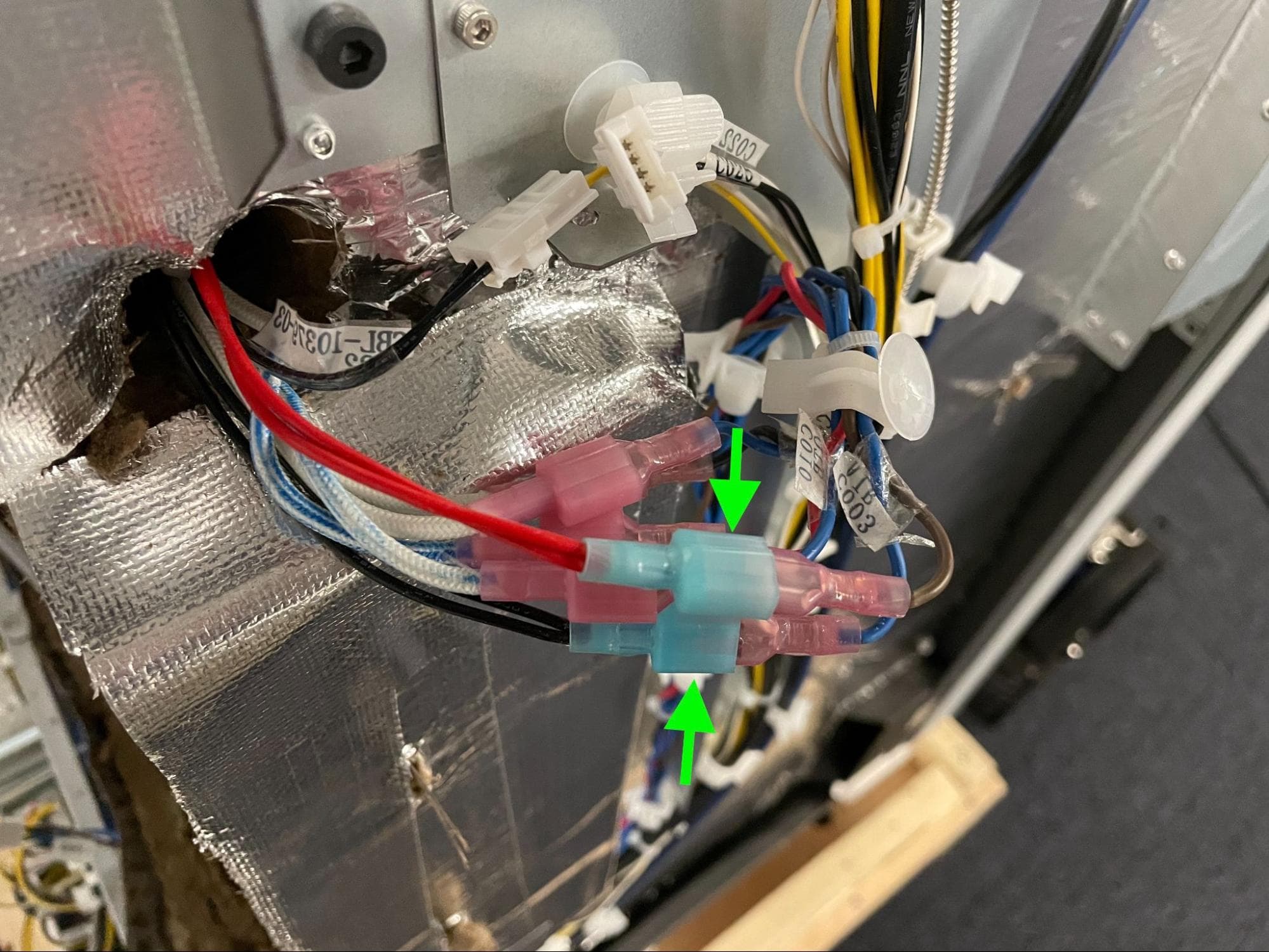

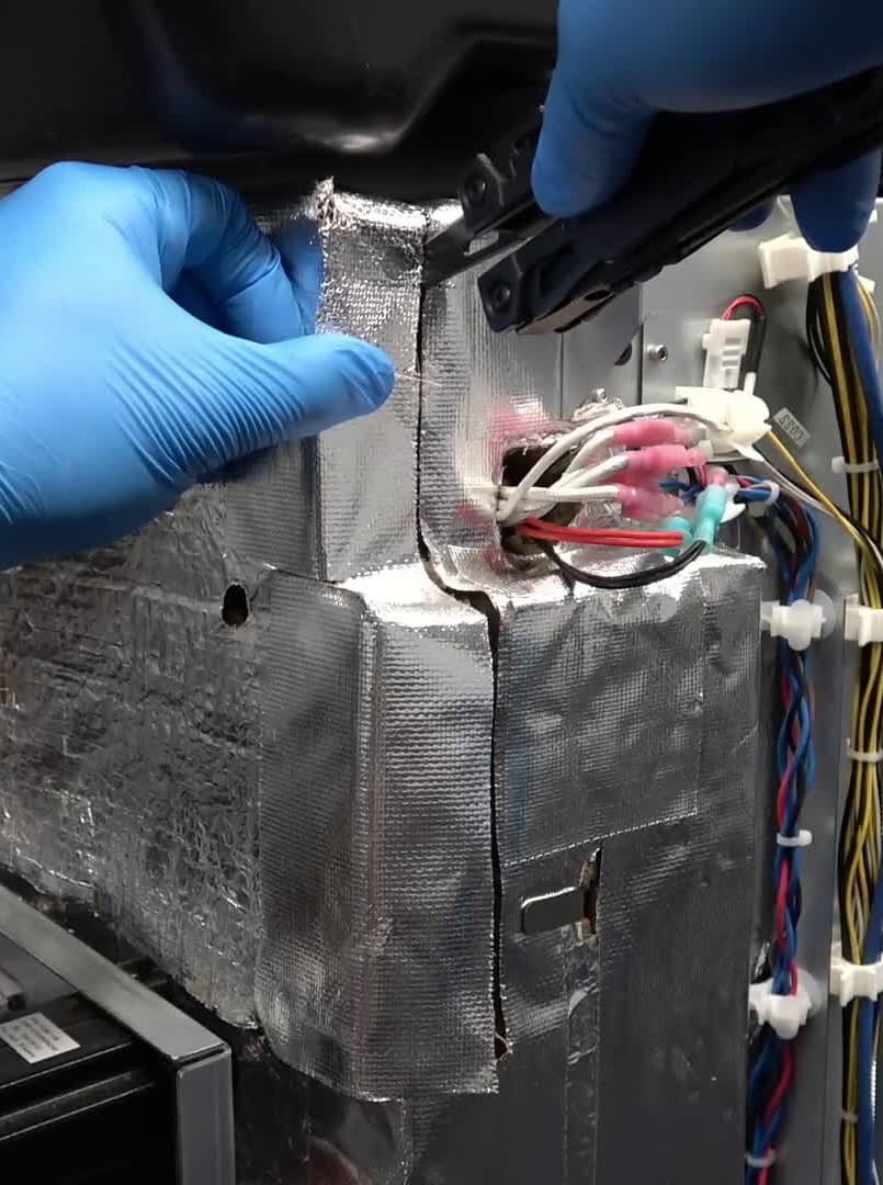

Step 1: Disconnect the air heater wires
Locate and disconnect the two blue spade connectors that are connected to the harness labeled C003 AIR, located on the buffer side of the printer.
Remove the original air heater assembly

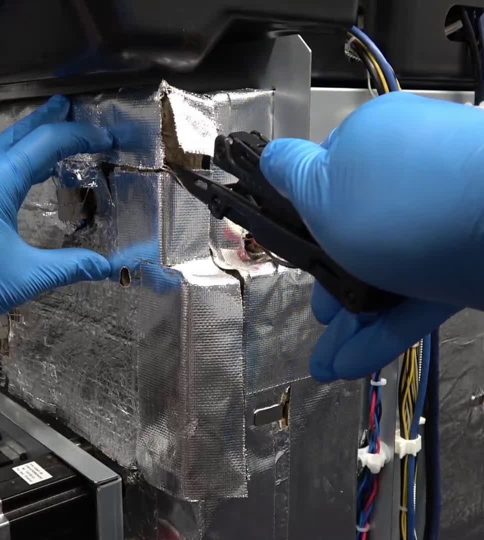

Step 2: Cut the air heater wires to remove the spade connectors
Cut both sets of cables at the base of each blue connector.

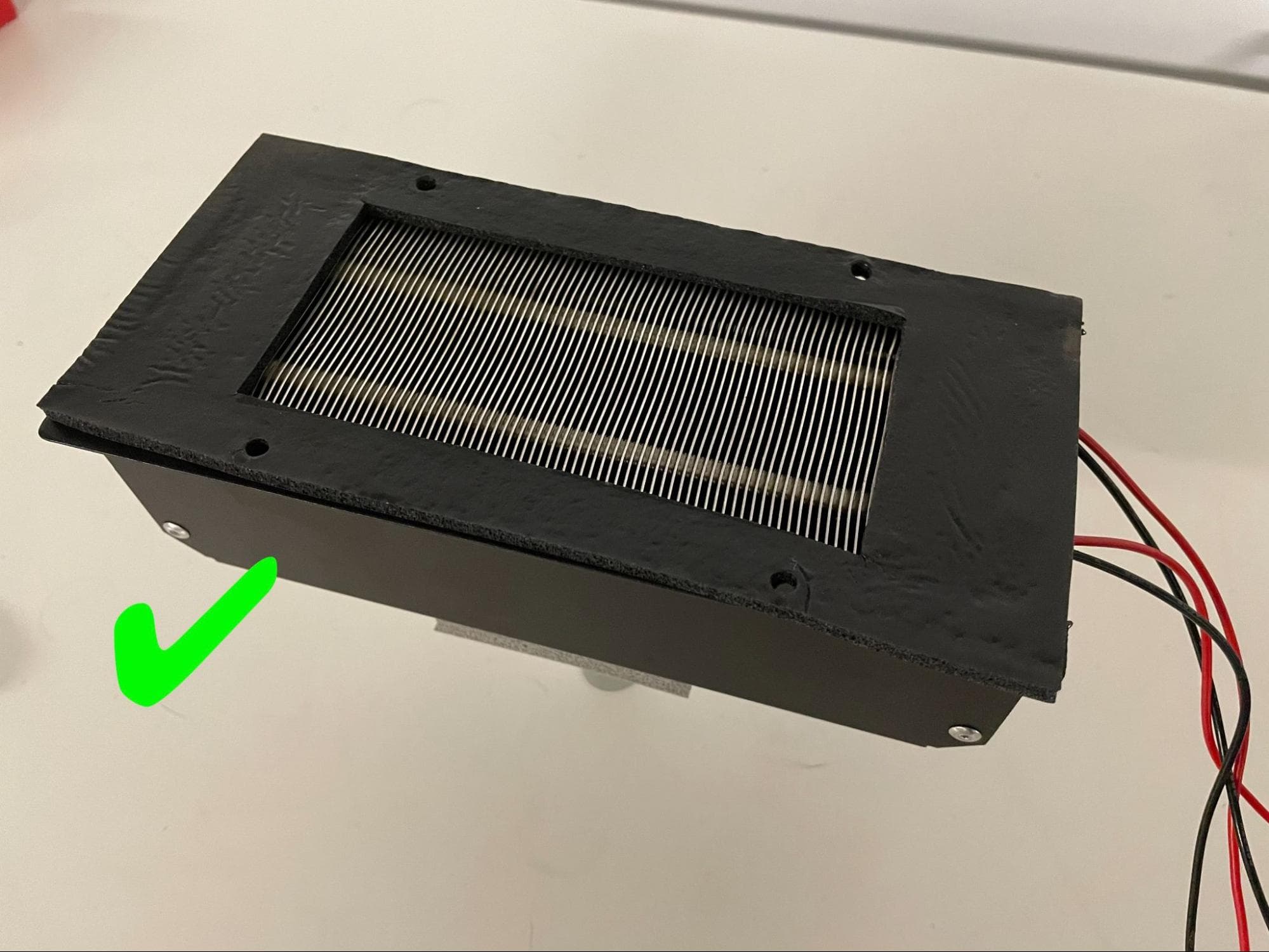

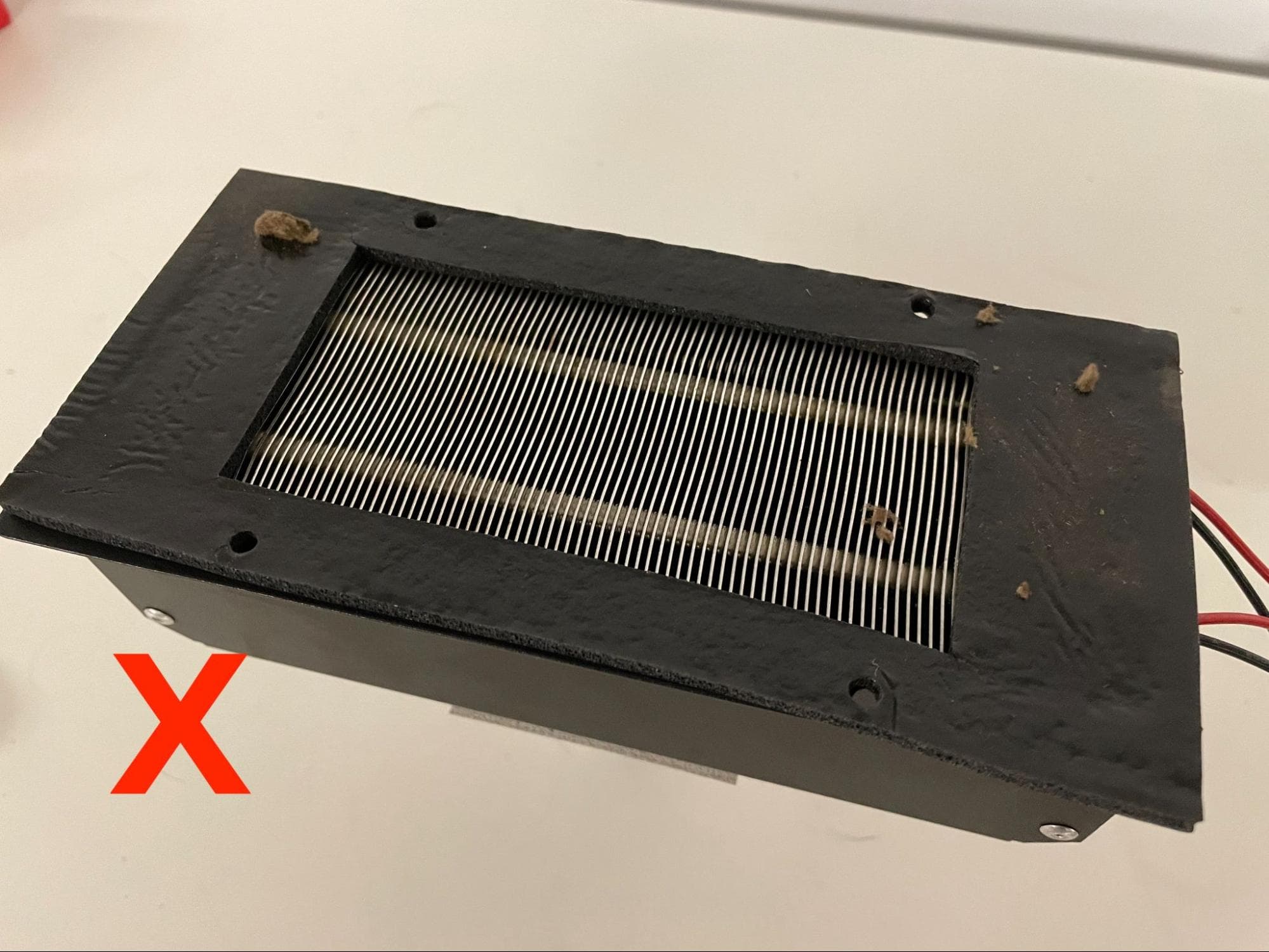

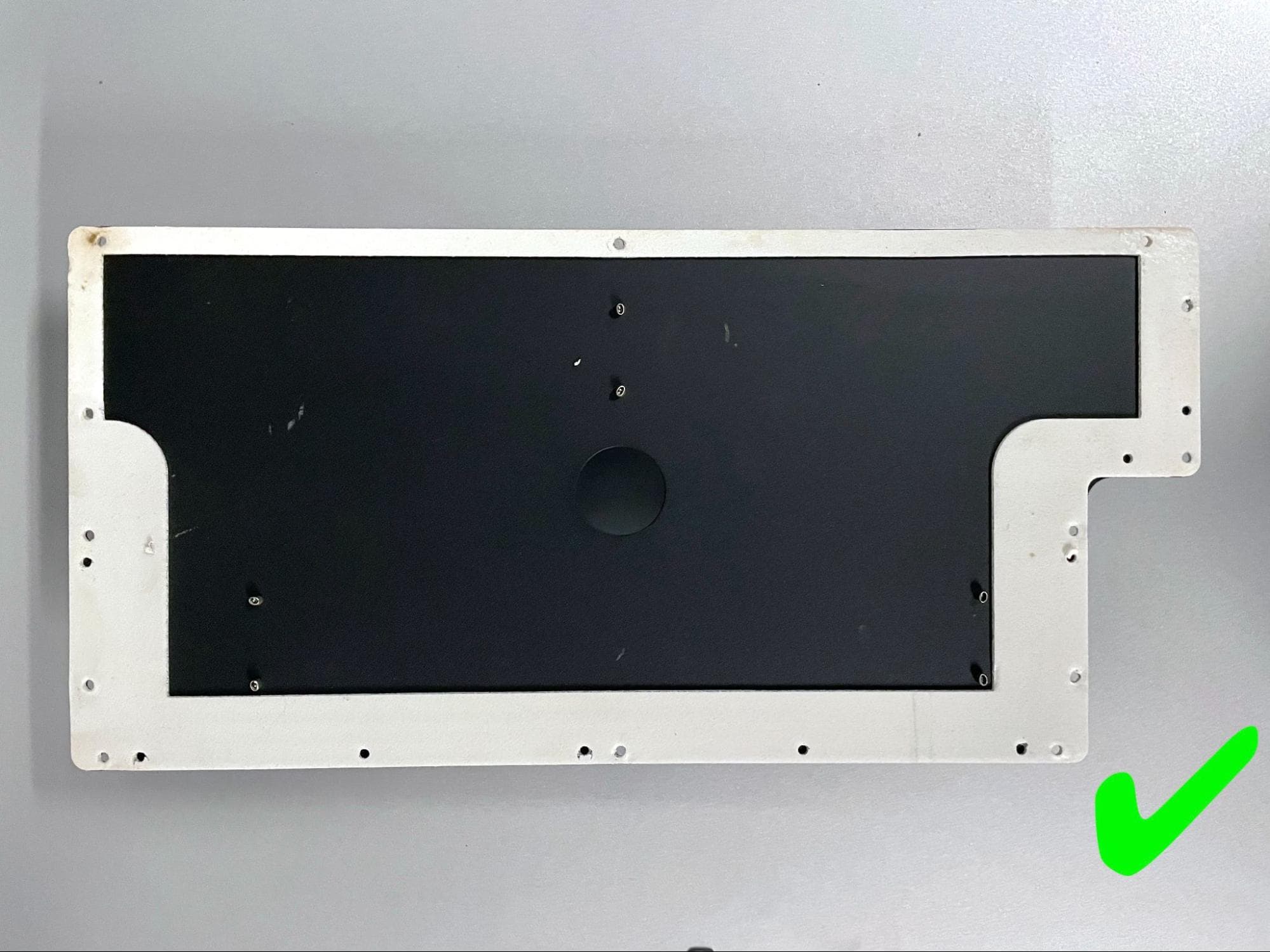

Step 1: Check the air heater gasket
Install the new air heater assembly - Gasket Check 1
Install the new air heater assembly - Gasket Check 2
Put on a pair of clean nitrile gloves. Check that both the gasket around the heater assembly and the heater fins are clean.
Use a bulb blower to dust off any insulation or contaminants from the air heater assembly. Do not touch the heater fins or the insulation with bare skin. If any insulation is pressed in between any of the fins, use a pair of tweezers to extract it.

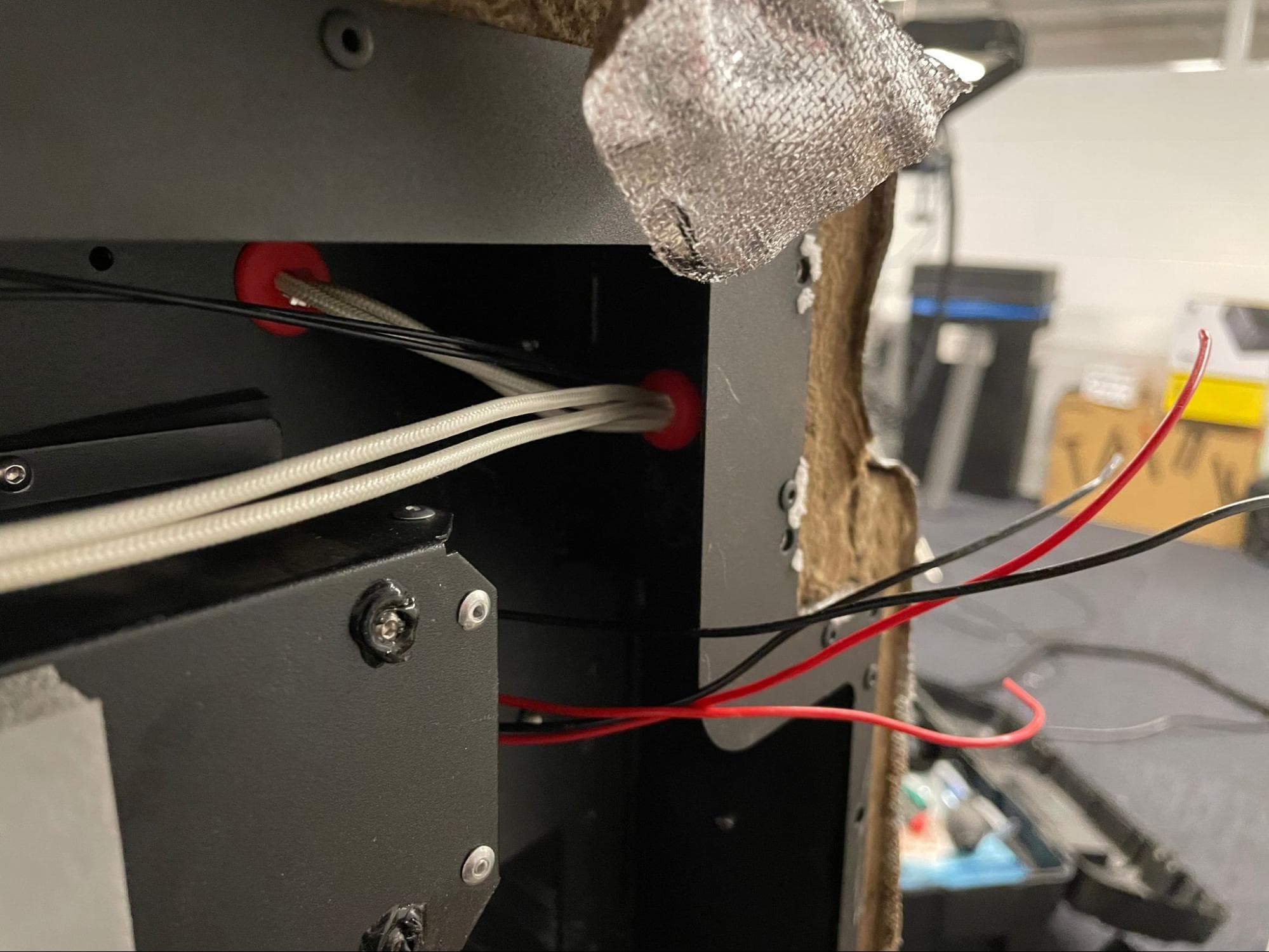

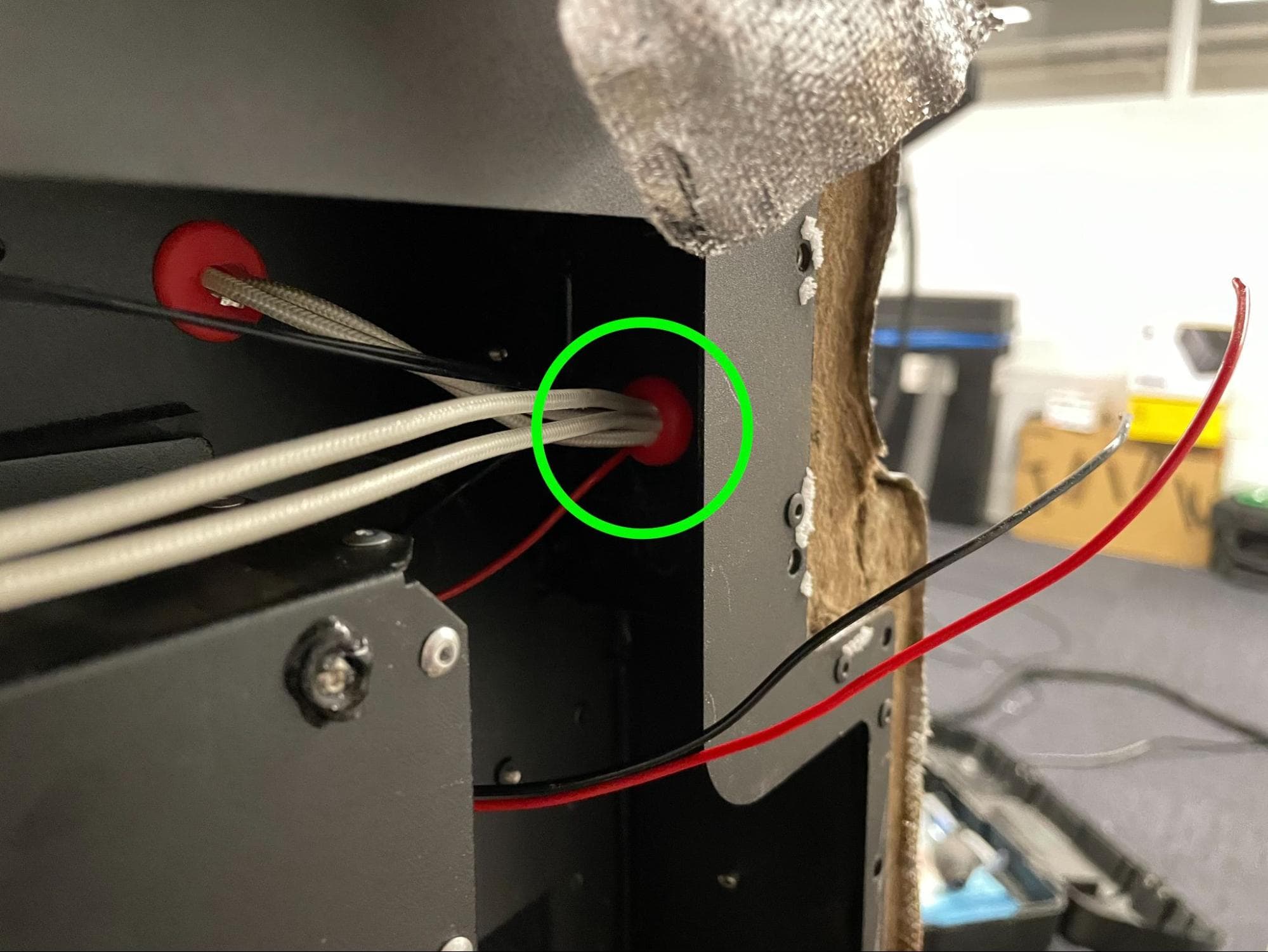

Step 4: Feed the air heater wires through the printer frame
Route the new air heater wires back through the red silicone grommet out to the buffer side of the printer. Pull any remaining wire slack out.
Install the new air heater assembly - Routing Wires

Step 6: Crimp new connectors onto the air heater wires
Install the new air heater assembly - Crimping 1
Install the new air heater assembly - Crimping 2

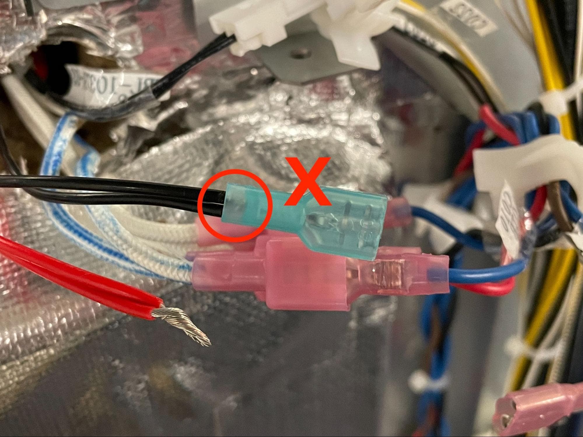

Insert each twisted set of wires into a new spade connector. Ensure that the conductors are not exposed and the cables are inserted so the insulation butts up against the inner base of the connector.
Load the primed connector into the crimping tool’s 16–22 AWG die. Before crimping, recheck the position of the wires within the connector. Crimp the connector until the tool springs back open, then repeat the crimp a second time.
Repeat for the remaining set of wires and second spade connector.

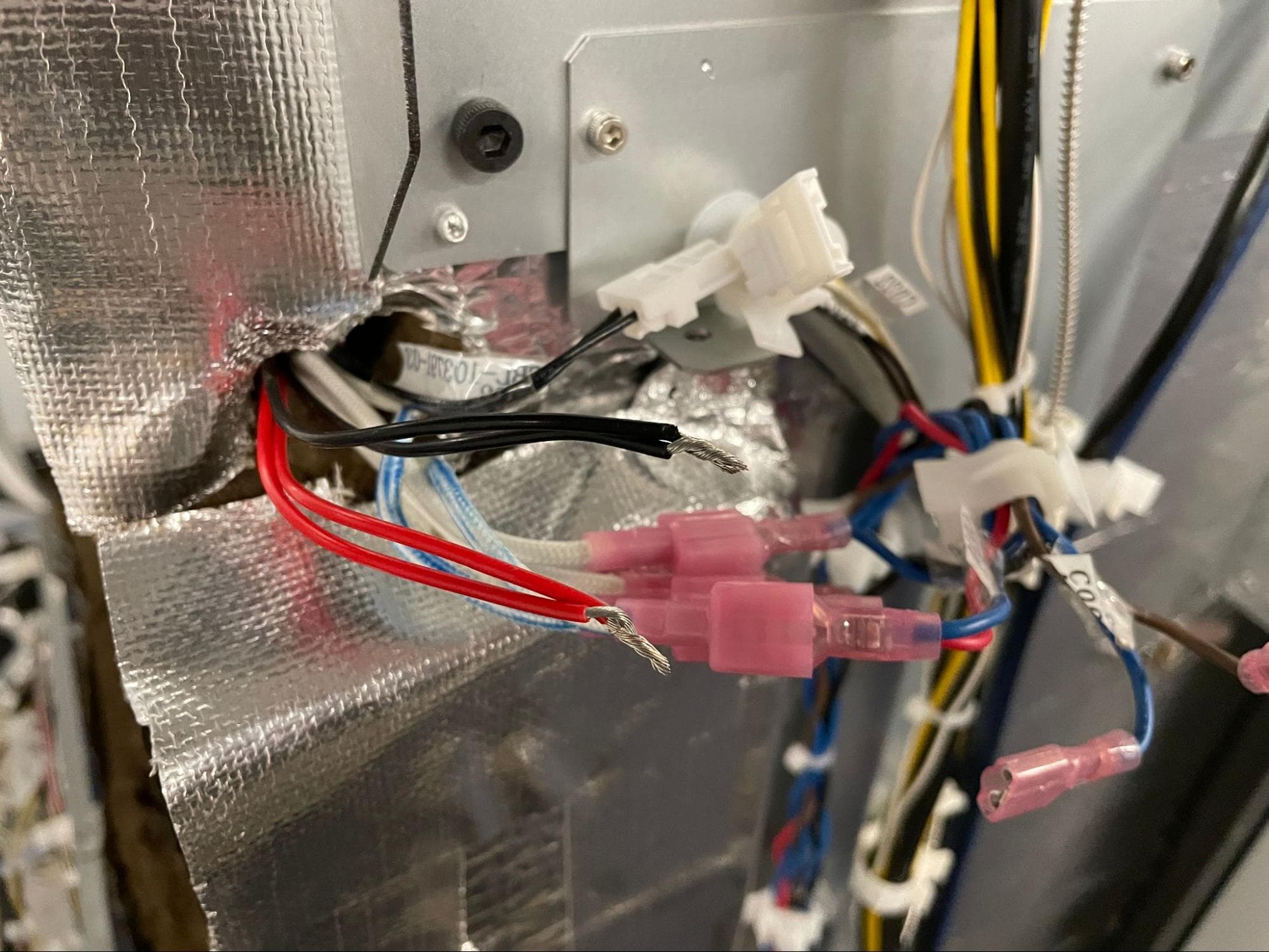

Step 7: Reconnect the air heater wires
Attach the connectors from the air heater to those on the harness labeled C003 AIR. The polarity does not matter, so the red and black wires may be connected to either the blue or the brown wires in the harness.
Step 8: Secure the air heater wires
Resecure the air heater wires into the cable clamp.
Install the new air heater assembly - Reconnect & Secure

Slide the upper rear insulation panel in place and fold the tabs over to secure it.
Replace the inner rear and insulation panels
Step 5: Seal the insulation panel in place
Use 100 mm (4 in) foil tape to cover any seams around the rear insulation panel. If the previous tape was peeled off instead of cut, replace the entire piece.

Step 6: Mount and secure the air heater duct
Slide the air heater duct back onto the inlet pipe, then tighten the ring clamp to secure the duct.

Step 1: Align the buffer-side panel with the printer
Lift the buffer-side panel and align its screw holes with those in the printer frame, as shown.
Step 2: Secure the buffer-side panel
Thread one 6 mm M4 countersunk screw into each of the four marked screw holes in the buffer-side panel. Using a 2.5 mm hex driver, tighten until snug.

Reinstalling the rear panels
Overview: After installing the replacement air heater RTD, reinstall and secure the rear panels.
Step 1: Align the upper rear panel with the printer
Lift the upper rear panel and align it with the four screw holes on the top of the printer.
Step 2: Secure the upper rear panel top screws
Thread the four 6.0 mm screws into each of the screw holes on the top of the printer. Using a 2.5 mm hex driver, tighten the screws until finger tight. You may need to adjust the exhaust duct to correctly position the upper rear panel.
Step 3: Secure the buffer side panel screws
Thread the two 6 mm screws into the screw holes on the buffer side and the two 6 mm screws into the screw holes on the hopper side. Using a 2.5 mm hex driver, tighten the screws until snug.
Step 4: Secure the hopper side panel screws
Thread the two 6mm screws into the holes on the hopper side. Using a 2.5 mm hex driver, tighten the screws until snug.
Step 5: Secure the upper rear panel grounding screws
Thread the panel screws into the indicated screw holes on the upper rear panel. Refer to the image for the correct locations of the black and chrome screws. Using a 2.5 mm hex driver, screw in the two black panel screws and two chrome grounding screws securing the upper rear panel to the printer.
Notice:
The placement of the chrome screws is critical to the printer's electrical grounding. Incorrect placement may lead to printer damage.
Step 6: Slide the exhaust duct into position
Slide the end of the exhaust duct with the ring clamp back onto the exhaust pipe. Ensure the exhaust duct presses against the insulation panel.
Step 7: Tighten the exhaust duct ring clamp
Using a 6.5 mm flathead screwdriver, tighten the ring clamp until finger tight.

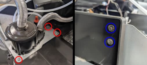

Step 8: Secure the exhaust inlet screws
Open the filter cabinet door on the printer. Thread the four 8.0 mm screws into the screw holes. Using a 2.0 mm hex driver, screw in the four exhaust duct screws until finger tight.
Step 9: Check the exhaust duct seal
To ensure there is no gap between the exhaust duct’s mounting plate and the filter cabinet housing, shine a flashlight or other light source around the exhaust inlet inside the filter cabinet. If any light is visible behind the filter cabinet, the duct is not properly sealed. If necessary, use a 2.0 mm hex driver to tighten the exhaust duct screws. Close the filter cabinet door when finished.
Step 10: Secure the lower rear panel grounding screws
Thread the panel screws into the indicated screw holes on the lower rear panel. Refer to the image for the correct locations of the black and chrome screws. Using a 2.5 mm hex driver, screw in the six black panel screws and four chrome panel grounding screws securing the lower rear panel to the printer.
