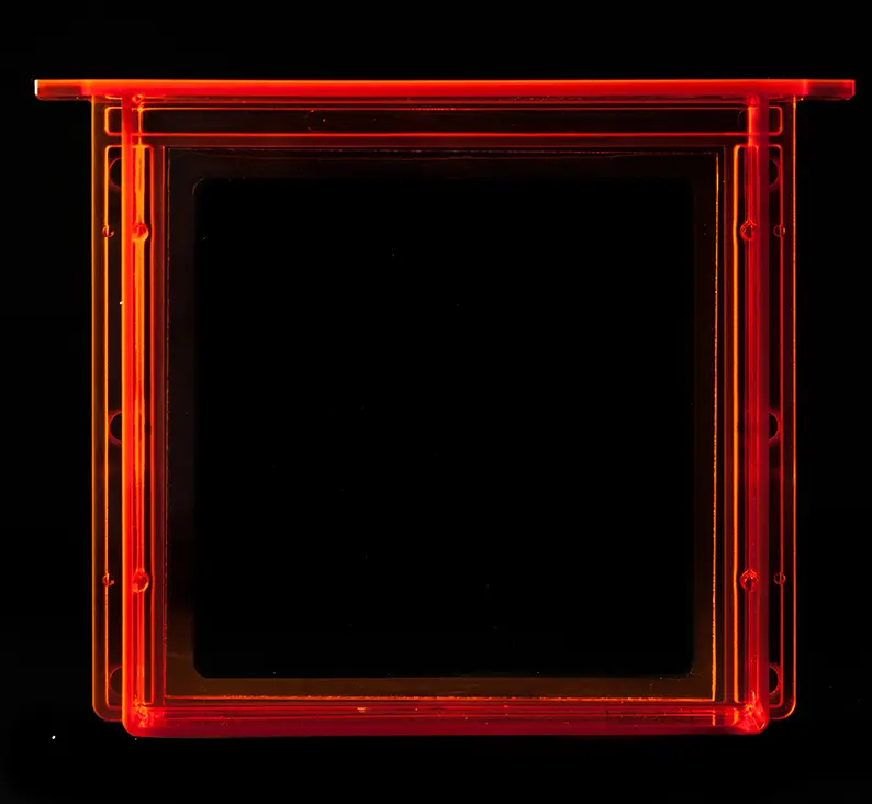

A Form 1+ resin tank with a clear window and no marks
For successful prints, it's essential to use a transparent tank, free of any marks, scratches, fingerprints, or smudges.

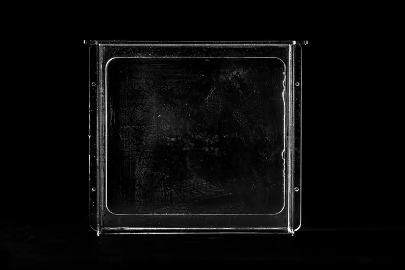

Scratches
A scratch in the elastic layer or optical window may cause striations across a portion of the build platform. This is because the scratch can deflect or block the laser from reaching the designated position during the build. If the scratched area cannot be avoided, the tank should be replaced.
Gouges
If the elastic layer is gouged, the laser will not properly travel through the layer, bending the light path in the wrong direction, away from the point that is set to be cured. A gouge is indicated by a piece torn away from the layer and may result from improperly scraping the resin tank between builds. A gouged tank requires replacement.

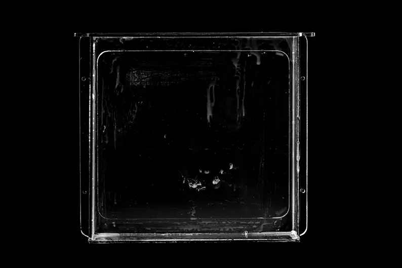

Clouding and settled pigment
Over time, the resin tank can develop cloudy or foggy regions in the elastic layer. This may happen for a variety of reasons, especially in spots of heavy laser or peel activity. For this reason, it’s important to make full use of all regions of the build platform. Cloudy regions can also develop where pigment has settled. Sometimes, clouding can be reduced or removed by carefully moving the scraper against the elastic layer.

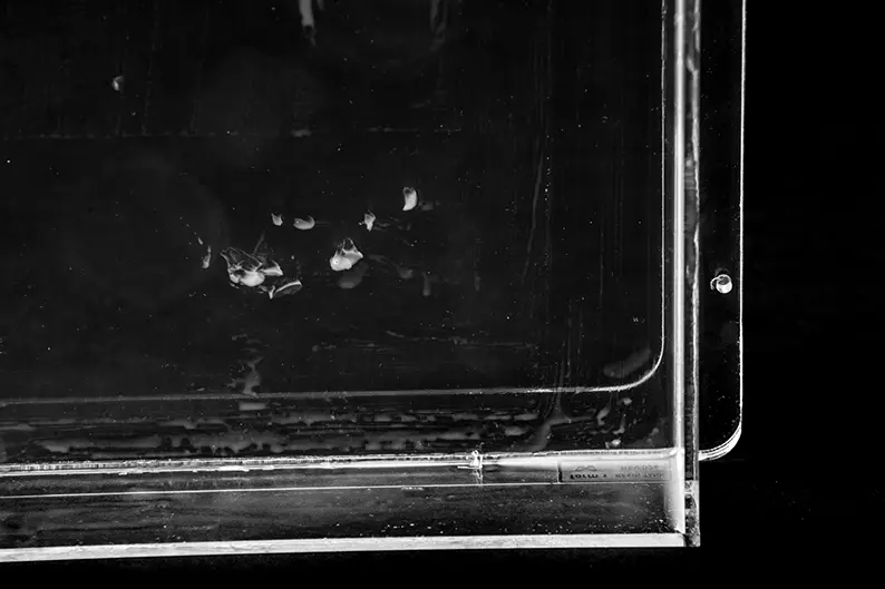

Cured resin
In some print failures, resin may cure against the silicone, rather than to the build platform. It is always important to care for the resin tank and gently scrape the silicone between builds. If you find small pieces floating or thin sheets of resin on the silicone, follow our instructions for cleaning your resin tank.
