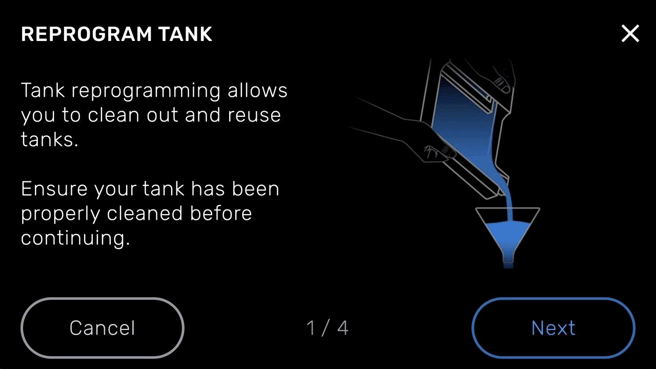

  1. Tap Reprogram Tank. The Reprogram Tank screen appears.
Reprgram Resin Tank screen

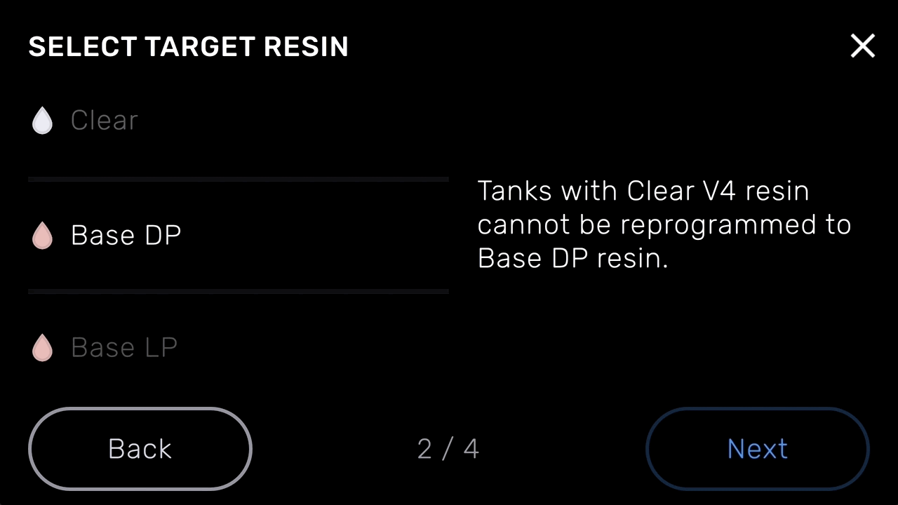

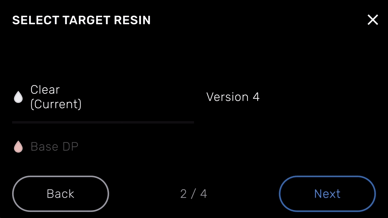

  1. Tap Next. The Select Target Resin screen appears.

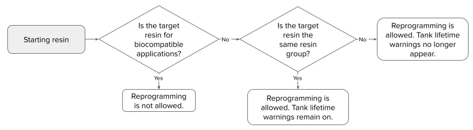

Decision tree showing resin tank reprogramming options

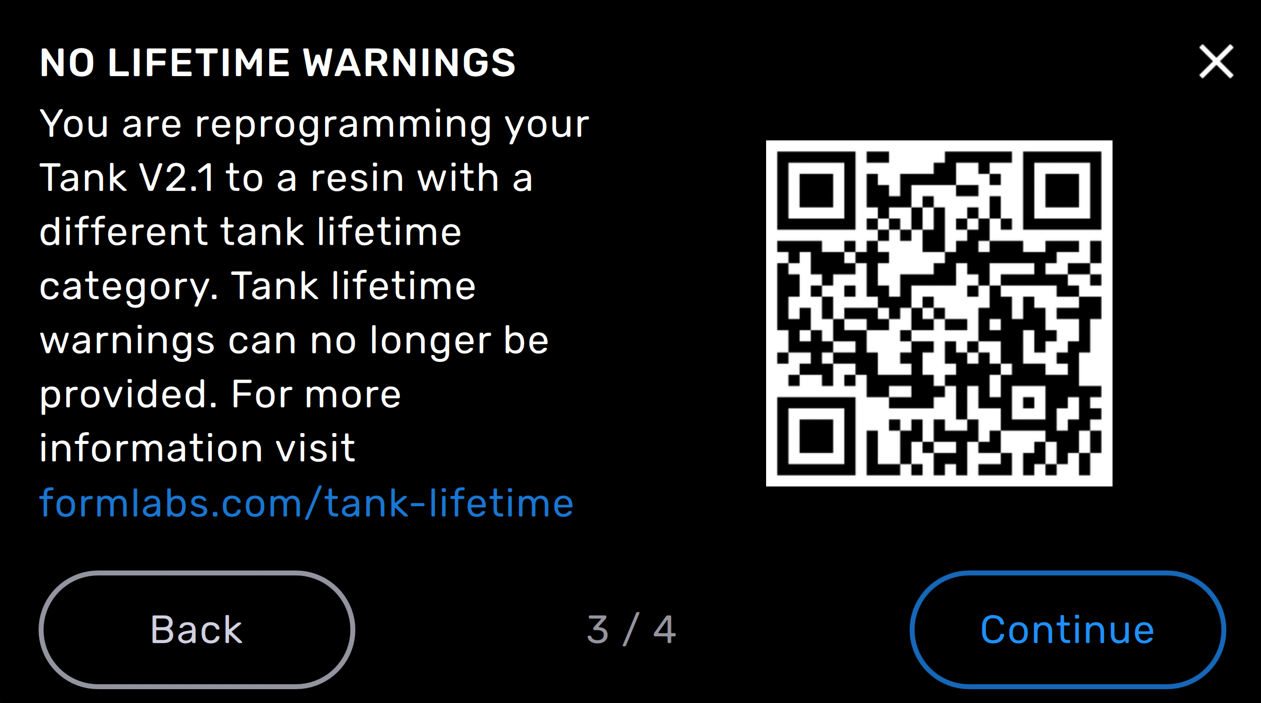

Reprogramming a resin tank with aggressive or moderately aggressive resins disables tank lifetime warnings. Consult the resin chart in Resin tank lifetime and monitoring (Form 3/Form 3B) for more information about the estimated maximum lifetime of your resin tank.

Under any of these circumstances, the Next button becomes unavailable:
  • To comply with biocompatibility regulations, a Form 3/Form 3B resin tank cannot be reprogrammed to a Target Resin that is for biocompatible applications.
  • Form 3/Form 3B resin tanks that previously held resins for biocompatible applications may be reprogrammed into a standard or moderately aggressive Target Resin. This process is irreversible and the resin tank is no longer suitable for Formlabs resins for biocompatible applications.
  • To use a Formlabs resin for biocompatible applications, insert a new and unused resin tank into the printer.

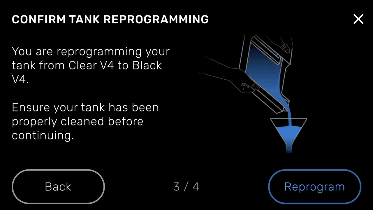

  1. Once you have selected the Target Resin, tap Next. The Confirm Tank Reprogramming screen appears.
  1. If the information on the Confirm Tank Reprogramming screen is correct, tap Reprogram. The printer reprograms the inserted resin tank to the Target Resin.

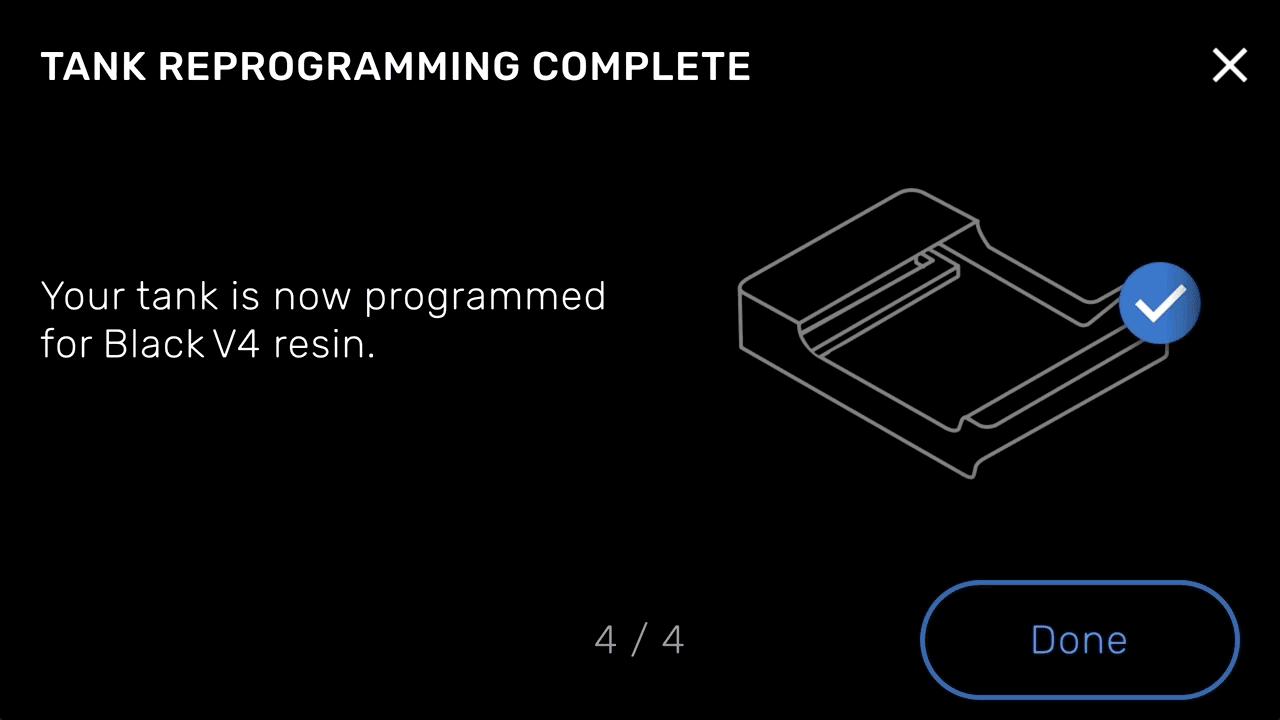

  2. Tap Done. The Maintenance menu reappears and you can continue printing.
Resin tank reprogramming complete
