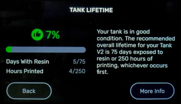

Checking remaining lifetime
To check the remaining lifetime of a resin tank:
  1. Tap the printer icon on the printer’s touchscreen. The printer’s current status appears.
  2. Tap the section of the touchscreen labeled with the tank type to go to the Tank Details screen.
  3. The Tank Details screen will report the remaining lifetime of your resin tank.
Remaining Form 3 resin tank lifetime
