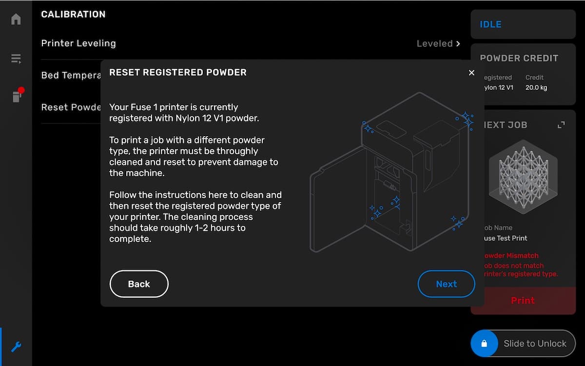

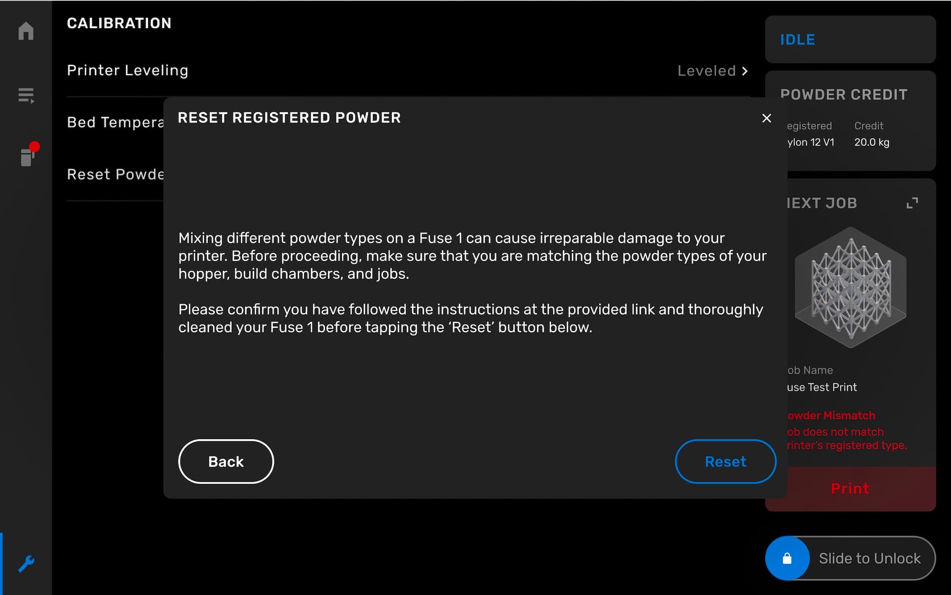

On the Reset Registered Powder screen, the machine warns you that failing to clean out all powder before switching materials can lead to print failures or permanent damage. Read the instructions on this screen and tap Next.
The Fuse 1's powder switching workflow, screen 1

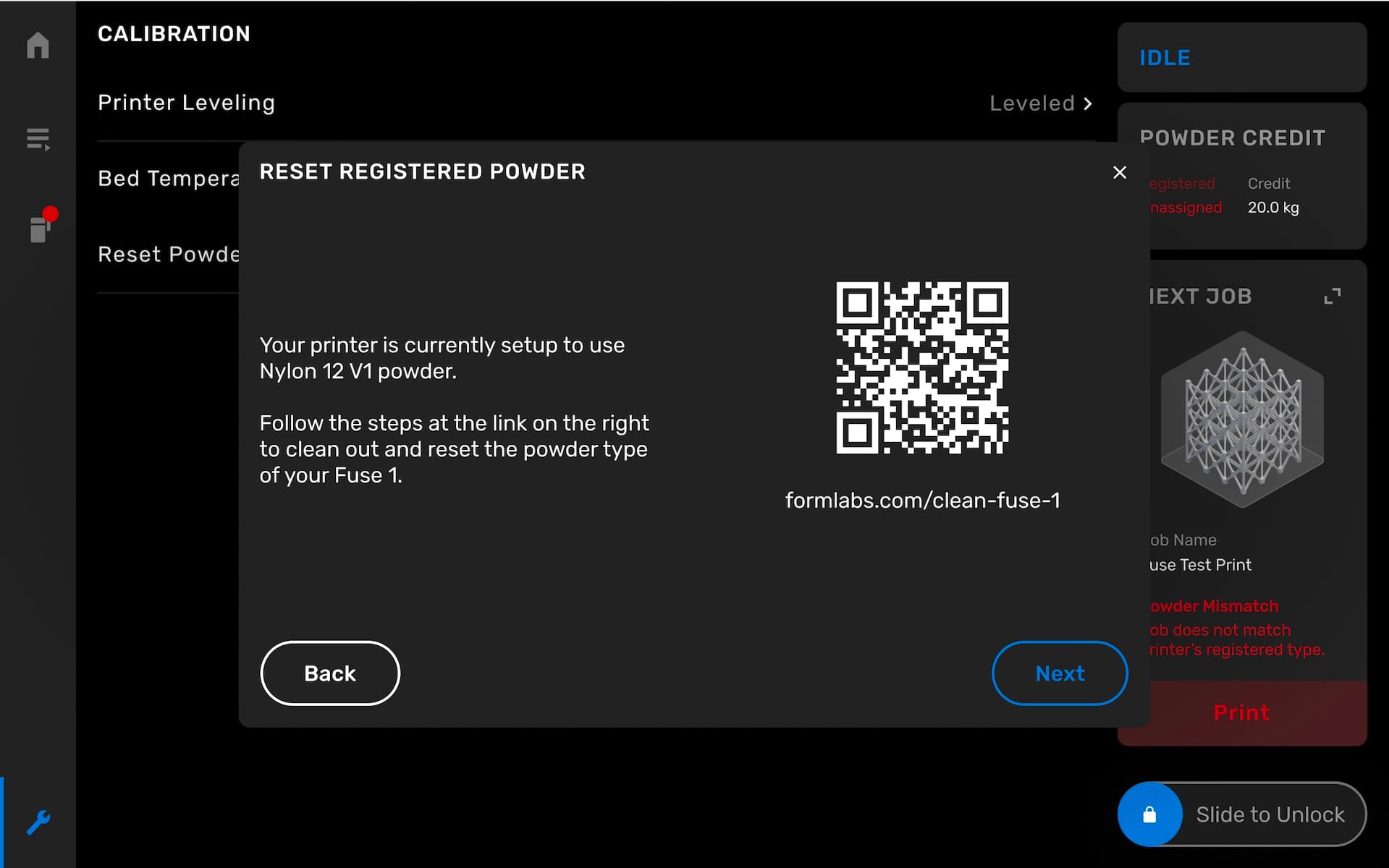

Follow the link on the touchscreen or go to the support article Cleaning all powder out of a Fuse 1 generation printer. Carefully follow all steps in the article and fully clean the machine before proceeding. After cleaning the machine, return to the Reset Registered Powder screen and tap Next to continue.
The Fuse 1's powder switching workflow, screen 2
Confirm that the printer is fully clean and tap Reset. The registered powder type is reset and the machine can be used with a new powder type.

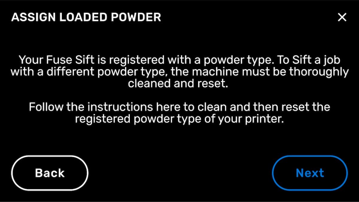

On the Assign Loaded Powder screen, the machine warns you that failing to clean out all powder before switching materials can lead to print failures or permanent damage. Read the instructions on this screen and tap Next.
Fuse Sift's powder switching workflow, screen 1

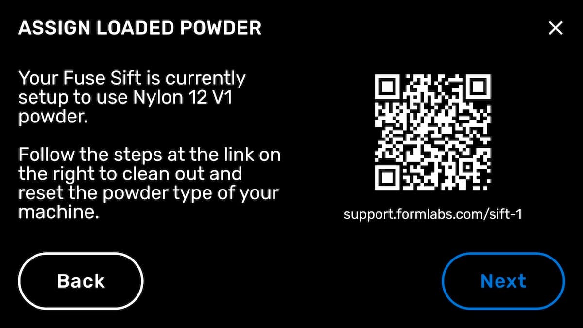

Follow the link on the touchscreen or go to the support article Cleaning all powder out of a Fuse Sift. Carefully follow all steps in the article and fully clean the machine before proceeding. After cleaning the machine, return to the Assign Loaded Powder screen and tap Next to continue.
The Fuse Sift's powder switching workflow, screen 2

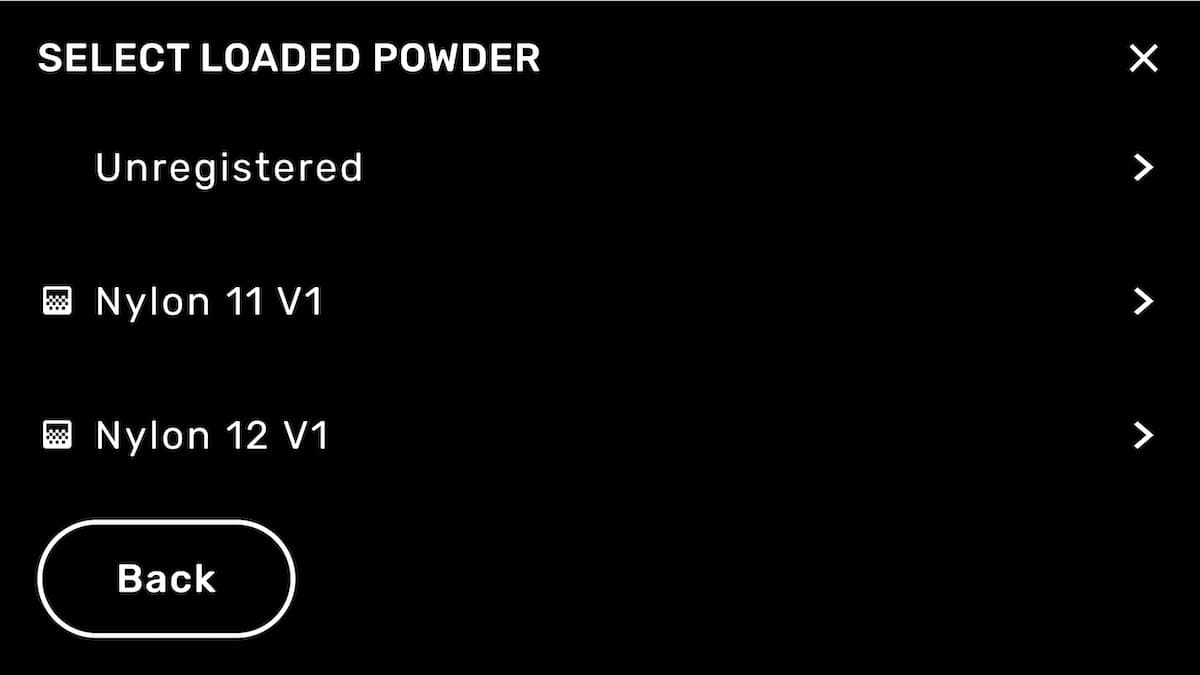

Tap the type of powder to be used with the machine.
The Fuse Sift powder's switching workflow, screen 3

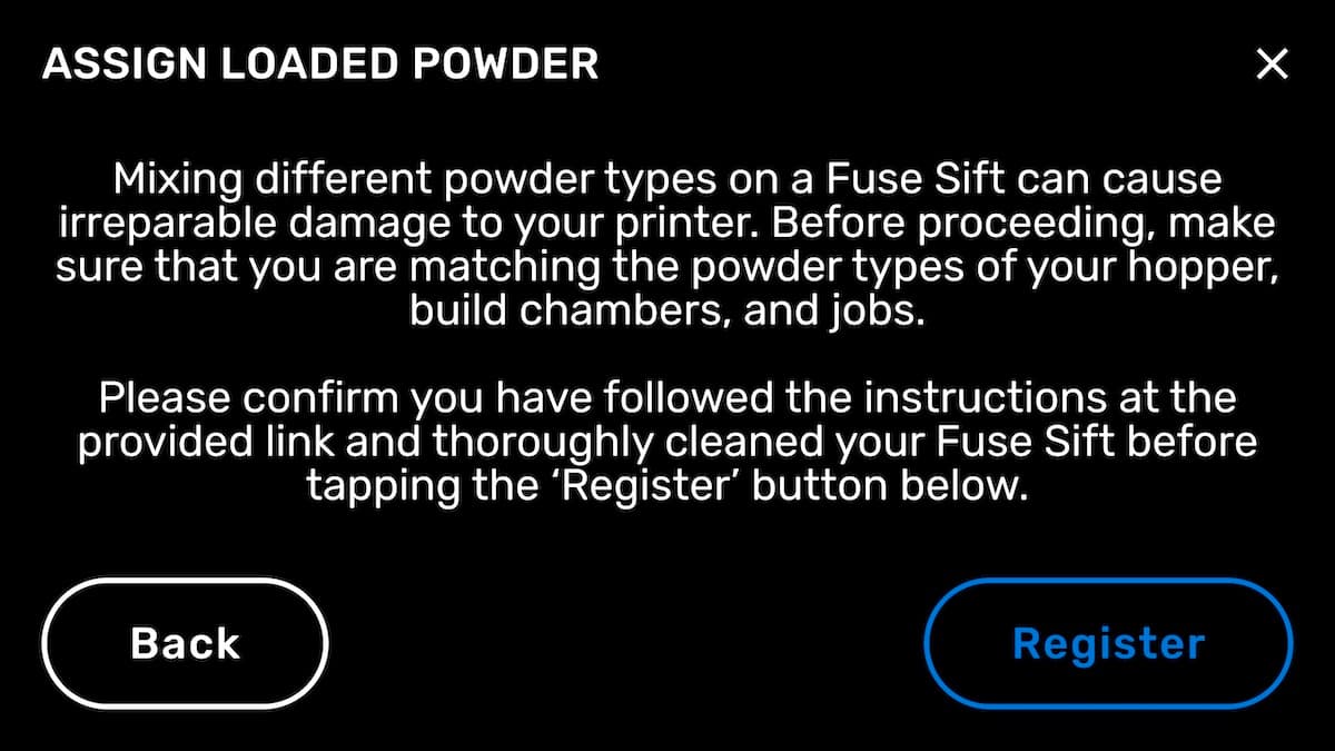

Confirm that the machine is fully clean and tap Register. The registered powder type is reset and the machine can be used with a new powder type.
