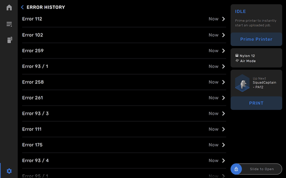

Viewing past error messages
To view a list of recent error messages:
  1. Tap the gear icon on the bottom left of the printer's Home screen. The Settings screen appears.
  2. Tap System. The System screen appears.
  3. Tap Error History. The Error History screen appears, showing a list of error codes and how long ago each occurred.
Fuse 1 generation Error History list
Note:
Errors are stored in the Error History list for 30 days.

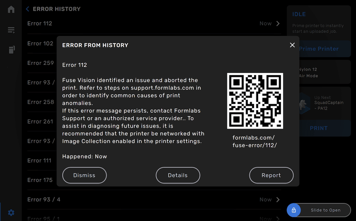

  1. Scroll through the list of error codes on the touchscreen.
  2. Tap an error code. A screen appears with more information about the error.
Information about a Fuse 1 generation error message
Viewing a relevant support article
The Formlabs Support site has details and troubleshooting steps for a wide variety of Fuse 1 generation error codes. While viewing a past error message, scan the QR code on the touchscreen with your smartphone to access support content for that error.

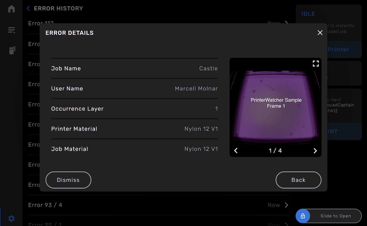

Viewing error message details
Some error messages are triggered by data from the printer’s sensors. This data can be useful when troubleshooting the error message, either on your own or when working with Formlabs Support or your certified service provider. While viewing a past error message, tap Details to view relevant sensor information when available.
Fuse 1 generation error message details
For example, Fuse 1 generation Error 261 indicates an error with one of the printer or build chamber’s Resistance Temperature Detector (RTD) sensors or the printer’s infrared (IR) sensor. The sensor values include temperature readings at the time of the error. In the example above, the reported bed temperature is higher than the other sensor readings, implying that the IR sensor may be at fault.

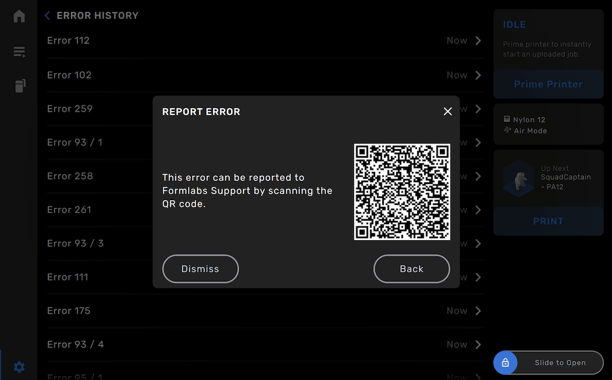

Creating a support case
To open a support case with Formlabs Support for a specific error:
  1. While viewing a past error message, tap Report. The Report Error screen appears.
  2. Scan the QR code on the touchscreen with your smartphone to access a case creation form. This form is prepopulated with information about your printer and the error message you are reporting.
Reporting a Fuse 1 generation error message
