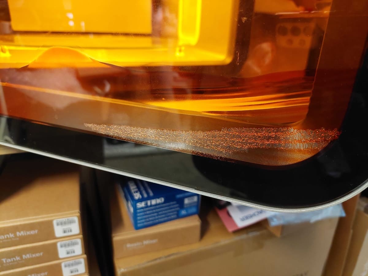

Post-curing parts that are still wet after washing with Resin Washing Solution can damage your equipment. On Form Cure V1 and Form Cure L V1 units, the reflective film on the inner walls will fog and become less effective. On Form Cure V2 and Form Cure L V2 units, the film on the inner face of the door will bubble and peel.
Symptoms
  • Film on inner face of Form Cure V2 or Form Cure L V2 door bubbling
  • Film on inner face of Form Cure V2 or Form Cure L V2 door peeling
  • Form Cure V2 or Form Cure L V2 door has clear sections
Form Cure L V2 unit showing bubbling from Resin Washing Solution
