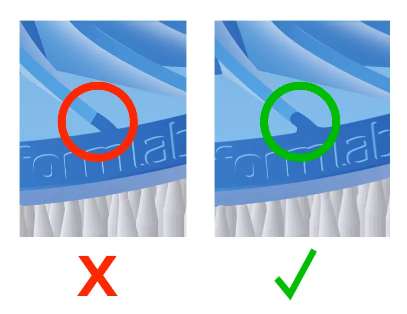

Filleting
alttext
Orientations with large changes in cross sectional areas are at risk of cracking. Fillet internal edges to avoid stress concentrations and decrease cracking.
Minimum: 1 mm fillet radius
Recommended: 2 mm or more
